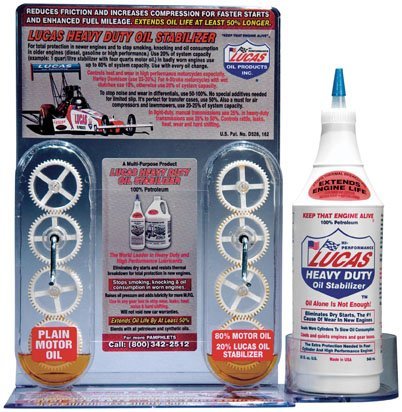

    If you go to any auto parts store and look for the little Lucas display. Spin the little handle on both sides. You'll notice the side with the Lucas/Oil mix is considerbally harder to turn than the side with plain oil. That's what is happening to your oil pump. I'm sure Lucas products have their place. I'm sure they work great in small simple engines, like for lawn mowers. But our engines are far more complex with tiny passeges for the VVT amongst other lubrication points.
    Itchyfeet likes this.
