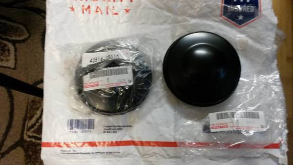

    I have the front diff and 4x4 hub assemblies. CV axles, grease caps and new seals will arrive on 1/18. I'll start posting pics this weekend.

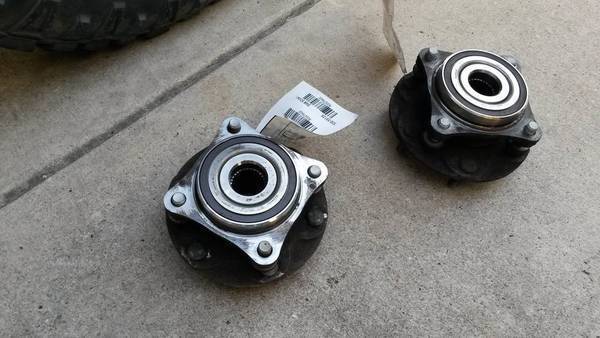

    Got my hubs.

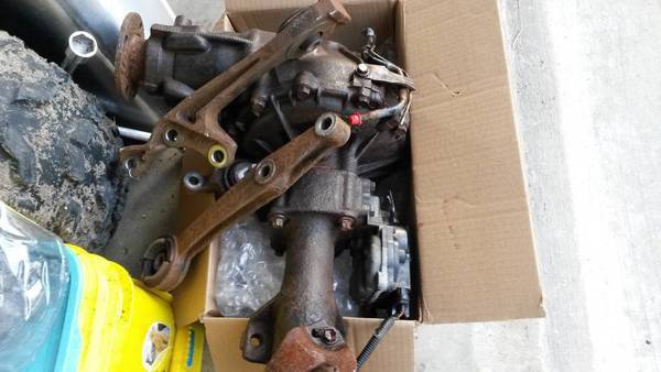

    Got my clamshell (includes acuator) - it has some surface cancer - bought it on ebay from upstate NY salvage yard. Insides appear good. Mounting brackets also have some surface cancer.. Started to wire-wheel all of it and spray it down with wd40. Its looking better. Will definitely replace front flange.

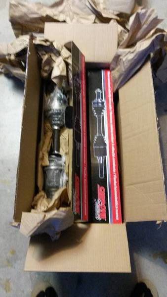

    White and purple truck showed up this morning. CVs from rockauto. Yes they are Cardone Select. I intend to eventually replace with rebuilt OEM Yota CVs, but rock was the quickest and cheapest so I could get this project moving. They will be spares when I get some OEM's done.

    Grease caps delivered as well. They been in my mailbox since saturday. It might be game-on this weekend...

    I would have painted it with some rustoleum after removing the rust with the wire wheel. Paint will last longer than wd40. Now you will have to use some de-greaser to get the wd40 off before you paint.
    I just had to remove my front diff and axles to fix a cracked frame. That bracket on the top of the diff with the vacuum line and breather line has to be installed after the diff is lifted into place and it is a Bitch to get installed. You need really small hands.

    Yup, that was my intent... i wanted to let the wd sit on it a few days, then wire wheel again- clean it with purple or simple green, then paint.
