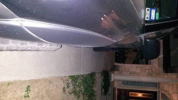

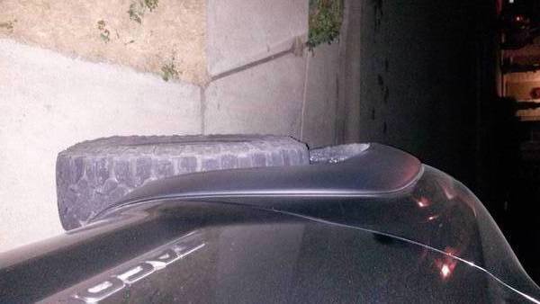

    1" spacers went on this morning. Has nothing to do with this project other than allowing larger meats in the future.
    Tilt head 90* to the left. I tried to adjust... Sorry y"all.

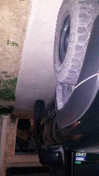

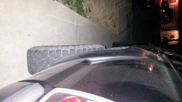

    More spacer install pics that you have to tilt your head for..

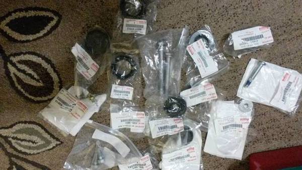

    All the hardware showed up finally. Bolts, nuts, spacers, pads, washers, seals...
