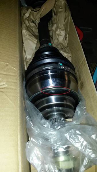

  13. Feb 10, 2014 at 7:39 AM
    #53
    lucky
    lucky [OP] Well-Known Member
    Jun 21, 2008
    #7468
    488
    NB, TX
    07 PreRunnerX4
    Had a close look at the new CVs I bought from rockauto. New seals are already in place.
