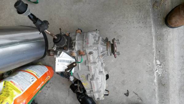

    Long break in the action. Update... Yesterday bought 4x4 hubs from Bama, 07 FJ xfer case, front drive shaft and another clamshell with actuator. I also picked up some OEM CVs that I'll have rebuilt at a local shop. I'll be using the new aftermarket CVs for the time being.

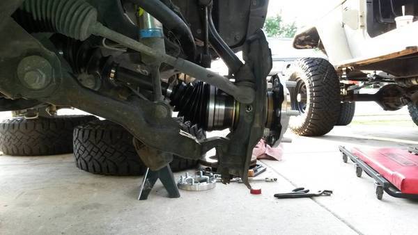

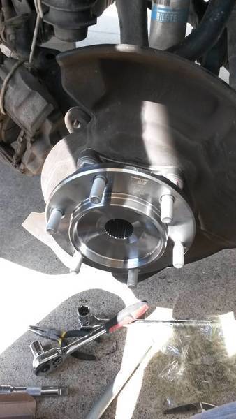

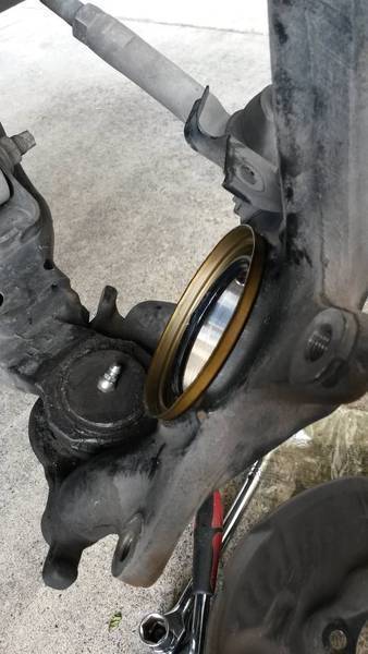

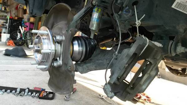

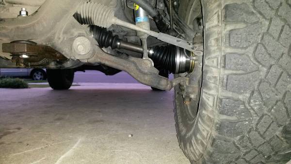

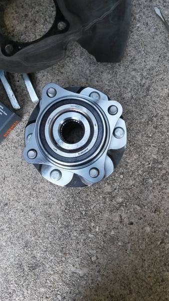

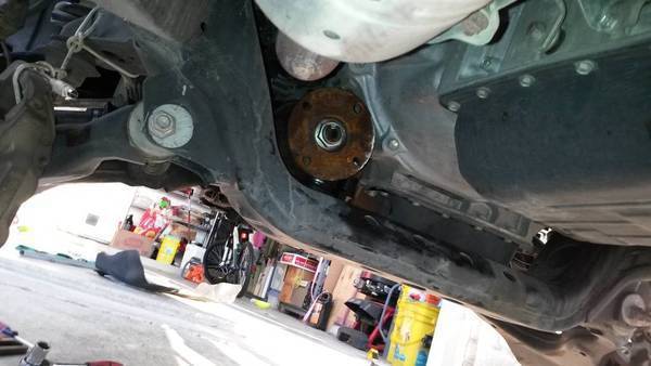

    Update. Got some work done today. Diff, CV's, and BamaToy1997 4x4 Hub assemblies installed. Went pretty smooth, although I accidentally broke the speed sensor on passenger side. Price for replacement at A-Zone was $233. I still need to run my switch to the ADD and route the breather hoses to somewhere high in the engine bay.
    Pre-runner hubs out - new seal pressed in.
    New 4x4 Hubs from BamaToy1997 - Thanks Bill, they're awesome!
    Hub on.
    Clamshell set.
    Cvs in.
    All back together!
    Hopefully in the next week or so I can do the twin sticks on my xfer case. Then swap transmission, build new crossmember and shortne rear driveshaft. More to come.

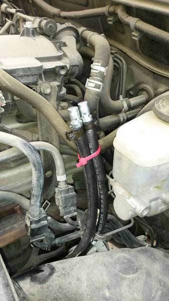

    Breathers...
