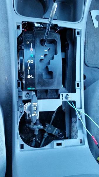

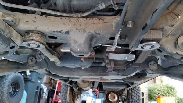

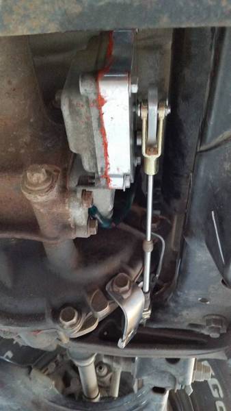

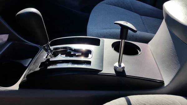

    cAble ADD almost done. The axle side of the cable is done. A few touch ups yet to do in the cab.
    Its pretty well protected.
    Inside shot.
    ADD off.
    ADD engaged.

    This is pretty neat...does the stock 4x4 shifter still work?

    Yes. Its going in the classifieds....

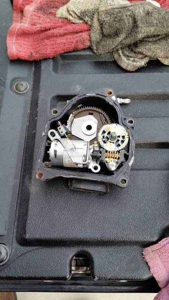

    So that's the electronic actuator.
    I like what you've done with it.

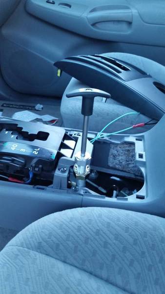

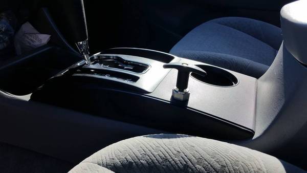

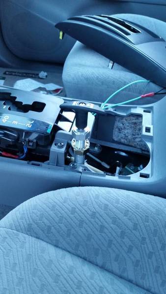

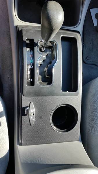

    Cable operated ADD Inside done. I plan on running my elocker by cable also. ANother twist-lock t-handle will be in here before too long.
    Off
    Engaged

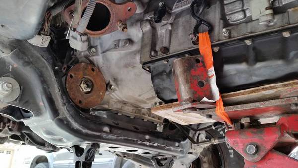

    NO turning back now.

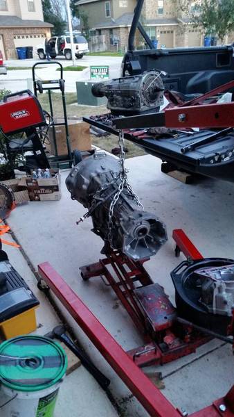

    a750e is OUT.
    a750f going in tomorrow.

    Looking good Lucky, that manual ADD actuator you made is pretty impressive. Honestly, I was having a few doubts about your project until I saw that, now I'm confident you'll have no trouble completing the job. Keep up the good work!

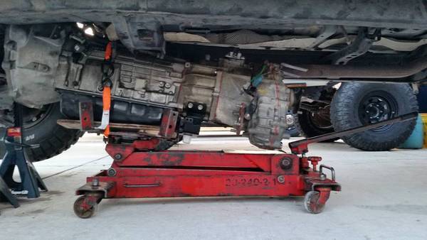

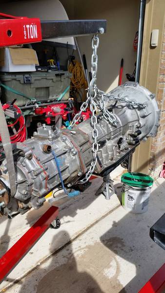

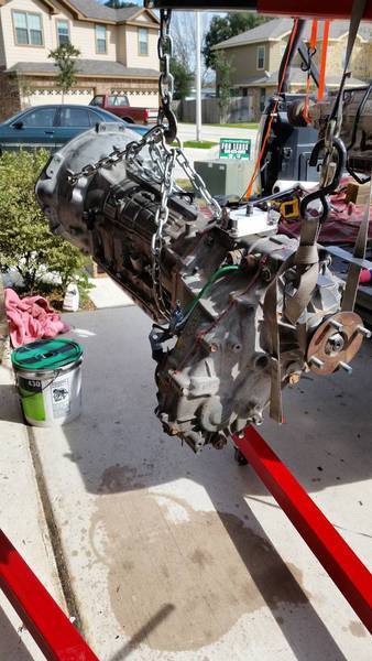

    I got everything bolted up. Did some test fitting to make sure my cable-shifted FJ case was going to clear - it does - and proceeded to stab this sombich. I didnt get it and ran out of time for the day. I'll give it another go tomorrow. The tranny jack I rented has decent control for tilt and twist, but its worn out and doesnt roll very smoothly.
    All together
    Waiting for tomorrow

    Successfully stabbed and bolted up. Still have to torque the flywheel/tc bolts, put starter back on and weld up my crossmember.
    Although I did some test fitting for the cable mechanism for the x-fer case, once I was completely bolted up, I didnt have the clearance I thought I was going to have. Ended up doing some trimming and had to make a hole in the tunnel. Would have been better off with traditional twin-sticks bent and re-routed like everyone else has done, but my cables are still going to work.
