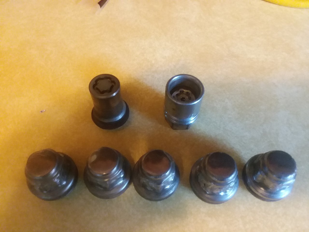

    I just got one of the stuck lug nuts off. They are a two piece. The covers on all of them are in bad shape. I took the keyed one off with a 21 mm. The one I just got off I had to pound on a 22mm. I'm going to jack it back up and try to see if the same technique will work on the rest.
    One thing is for sure I am replacing them all with a 1 piece lug.

    Good news.
    All lug nuts have been removed. The wheel was still stuck but a 2x4 and a sledge hammer fixed that. Front left brakes are fine and will easily last the rest of the summer. All studs are fine as well
    I did take a look at some of the other lugs on the other tires. They all look a lot better than these 5. But I tried two just to see if the 21mm socket would fit over them. One it did, the other it did not.
    I have arranged for a ride to the parts store tomorrow. I am going to buy 5 of the cheapest lug nuts that will fit. I can then re-attach the tire and drive the truck again with confidence that the wheel will not fall off, until I decide to remove it again.
    I am also going to go on-line and find 20 lug nuts that are a 1 piece design. When they show up here I will replace all of the non-locking lugs nuts on the truck. I'll keep the cheap ones from the auto-parts store as spares.
