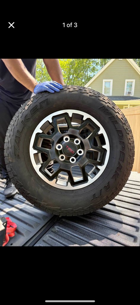

    I recently bought a set of four new 2025 Toyota Tacoma TRD Tires with OEM Rims for my 2023 Tacoma Access Cab.
    When installing them, I discovered a hub bore mismatch between the two model years—so I added spacers. But here's where things got complicated:
    • The 2023 lug nuts are too small for the OEM 2025 rims.
    • The 2025 lug nuts don’t have the correct thread for my 2023 Tacoma.
    I initially thought I'd need 12×1.5 OEM lug nuts, but according to the KSP website, those only fit up to the 2022 model year. I’ve emailed them for clarification but haven't heard back yet.
    Has anyone dealt with this before? What lug nut size or style would work with 2025 Tacoma OEM rims on a 2023 Access Cab

    These spacers (adapters) are specifically to do exactly this. At 1.25" (32mm) thick, they will also take the '24-'25 wheel's ~55mm offset down to 22-23mm, right close to what the stock TRD OR wheels for a 2023 are.

    Use specially designed wheel spacers for this purpose. The spacers have the correct bore/lip diameterd to remain hubcentric, and M14 studs to use 4th gen OE lugnuts
    https://spacerexperts.com/products/...-cruiser-tacoma-4runner-or-older-6-lug-tundra
    https://lugnutguys.com/products/whe...tundra-6-lug-oe-wheels-1-5-thick-14x1-5-studs

    You have a couple different options.
    1-Use the spacers you have but get a machine shop to press the studs out of them and reem them out to .625" and then press in some m14-1.5 studs. Then use stock m14-1.5 lug nuts.
    2-Return those spacers and get 4 of these: https://www.spidertrax.com/whs036G?sc=2&category=9982
    3-Sell those wheels and get some wheels you like that don't need spacers.
