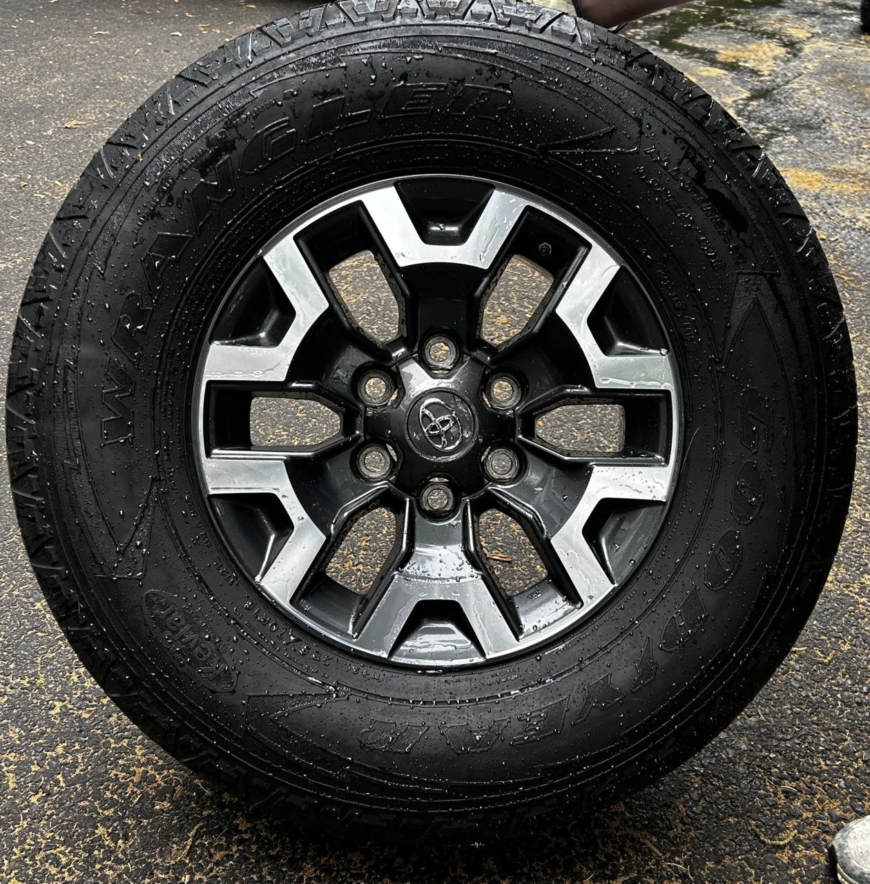

    Just bought some 2018 off-road wheels and I was going to put them on a 2023 sr. I read over lots of threads and it seems like all of the different Toyota wheel options is complicated. Anyone able to help me with finding oem style or oem lug nuts for these? IMG_7219.jpg

    I think those are part number PT076-60200-02
    Just FYI. Google search in the pn might bring some options for you.

    Just order a set of Gorilla 12mm x 1.5 mag seat lugs for Tacoma and call it a day.

    Gorilla Automotive 73137TB Chrome Toyota Mag Style Lug Nut - Bag of 4 (12mm x 1.50 Thread Size)
    https://a.co/d/j2o4qDw
    I assume I would need mag set then like this?
