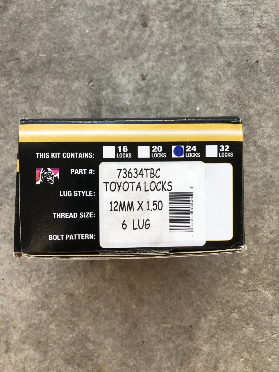

    For what it's worth, the black on those sold on eBay will not last and Gorilla sells black lugs.

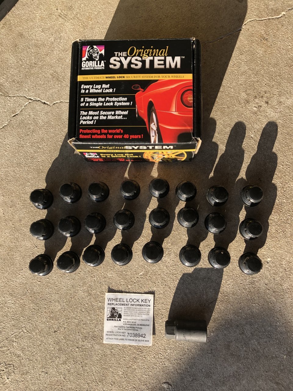

    Jay
    NJ
    2017 Tacoma TRD Sport
    This is what you want. I have them. They are all locked.

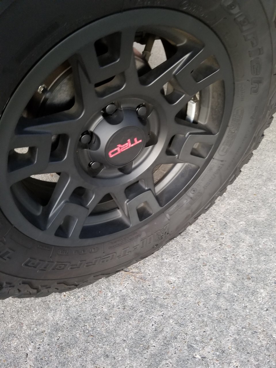

    Thanks for the pics - black on black is the way to go for the look I want.
    I didn't even consider the black valve stems though........hmmmmmmmm.......

    Guys. Unless you want to risk a wheel flying off, you should NOT be using acorn lugs with the TRD Pro Sema wheels. Go with the gorilla kit posted above or cheaper equivalent oem style mag seat lugs.
