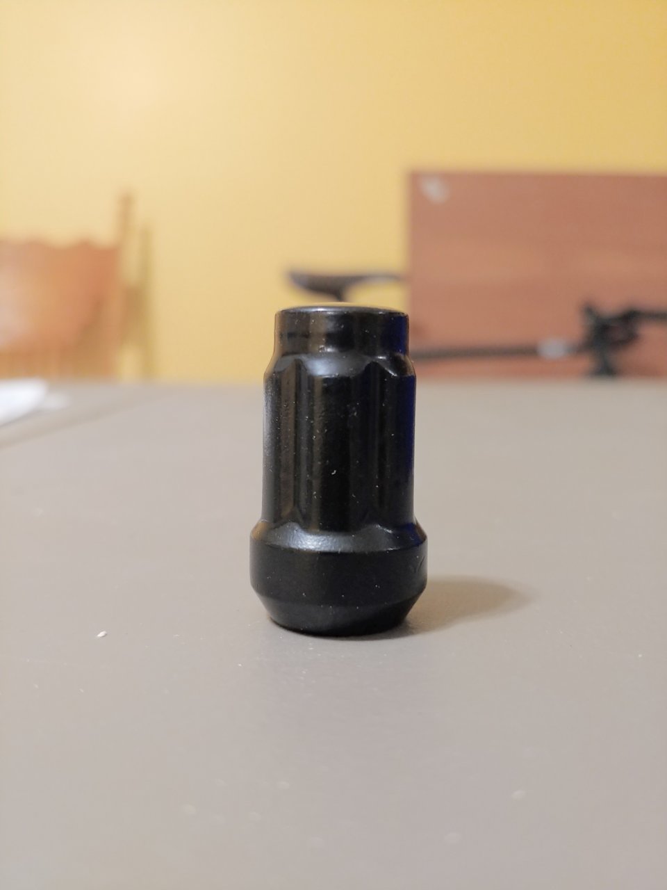

    I purchased these lugs but I believe they won't get enough bite on the threads:
    Spline lugs (19mm diameter)

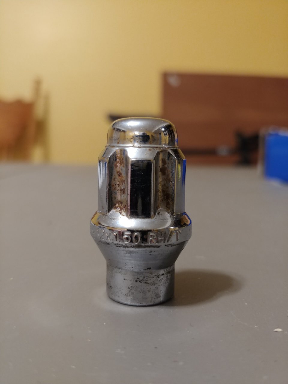

    I got these from a friend but I want black lugs:
    Spline ET lugs (21mm diameter)

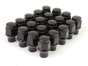

    Tonight I purchased these via the eBay sale but I'm worried they are too large in diameter to fit in the lug holes:
    3/4" Hex ET lugs (23mm diameter)
    Does anyone by any chance know the diameter of the lug nut holes themselves or can give some guidance? Are spline lugs necessary?
