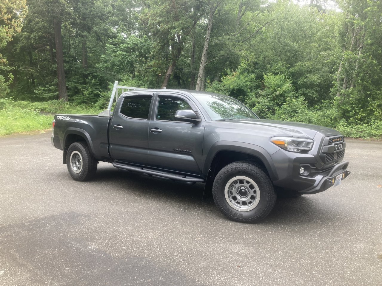

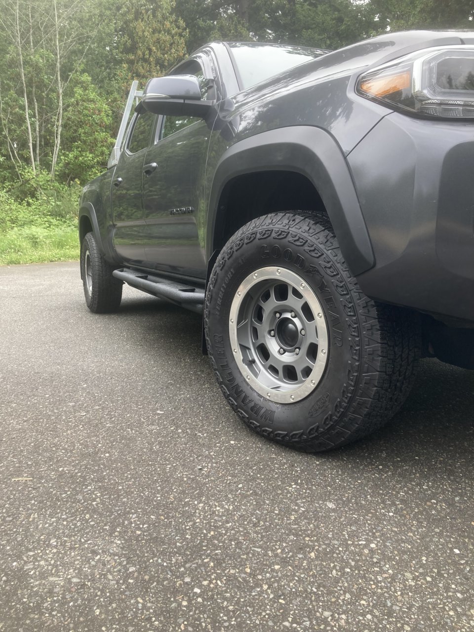

    Update: replaced stock 2023 TRD Off-Road wheels (part # 42611-04161) with TRD T/X Baja wheels (part # PTR56-35220-F3). OEM lug nuts had to be replaced with conical lug nuts for the Baja rims; replaced with Mcgard part # 65357. Also had to replace valve stems for the 2-part TPMS. The center caps come separate from the rims (Toyota part # PT280-35220-G0) and they are on a national back order right now.
    If you are thinking about doing this mod there are some additional costs other than the rims, but it is worth it in my opinion. The Baja rims add some attitude to the look of your rig.
