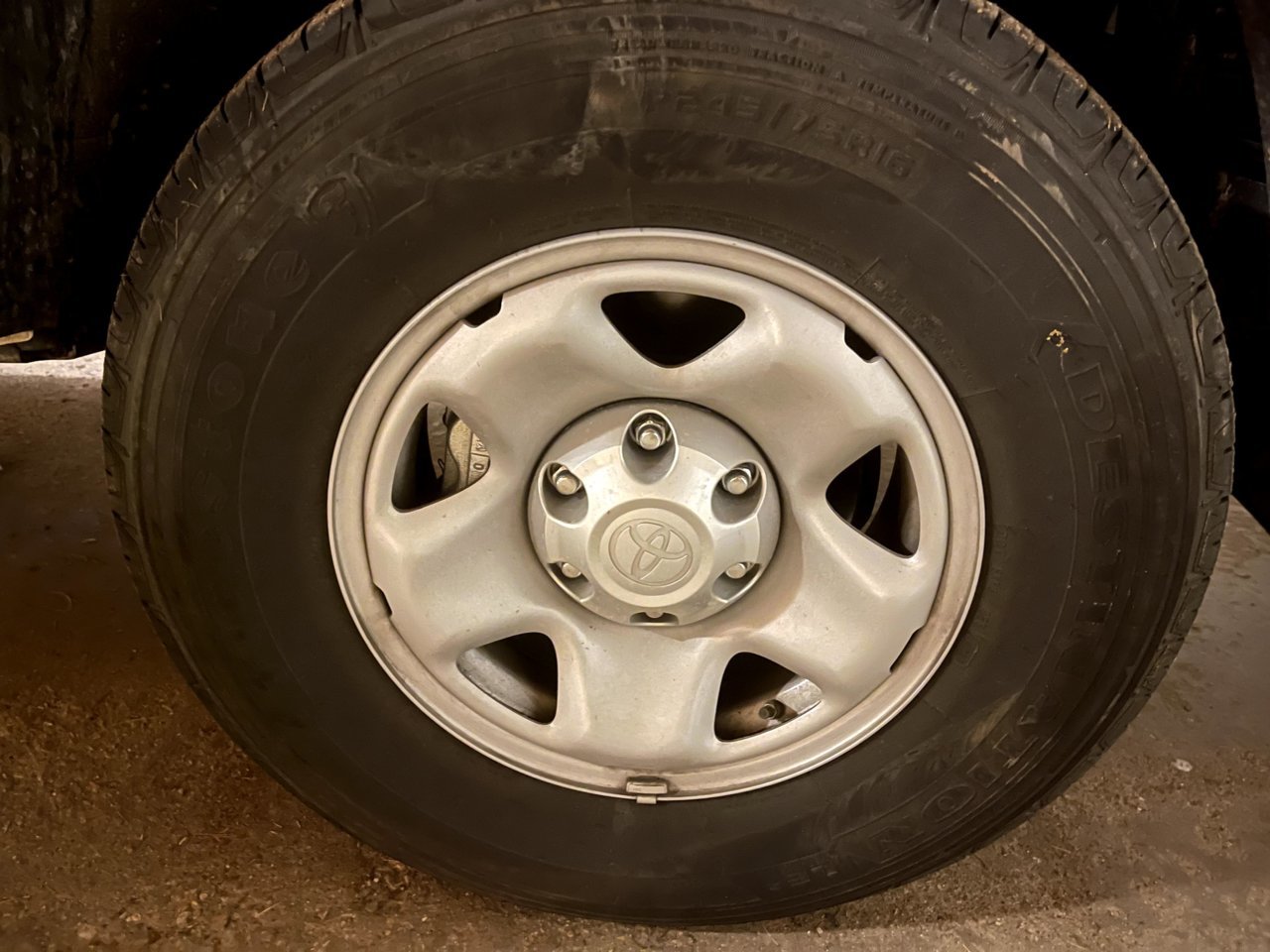

    Hello, I own a tacoma SR 20201, with this stock steel wheels
    And I bought this alloy wheels from a 2018 TRD tacoma
    but the lug nuts don't seem to fit with the new wheels. Could someone tell me what kind of nuts are needed? thank you!

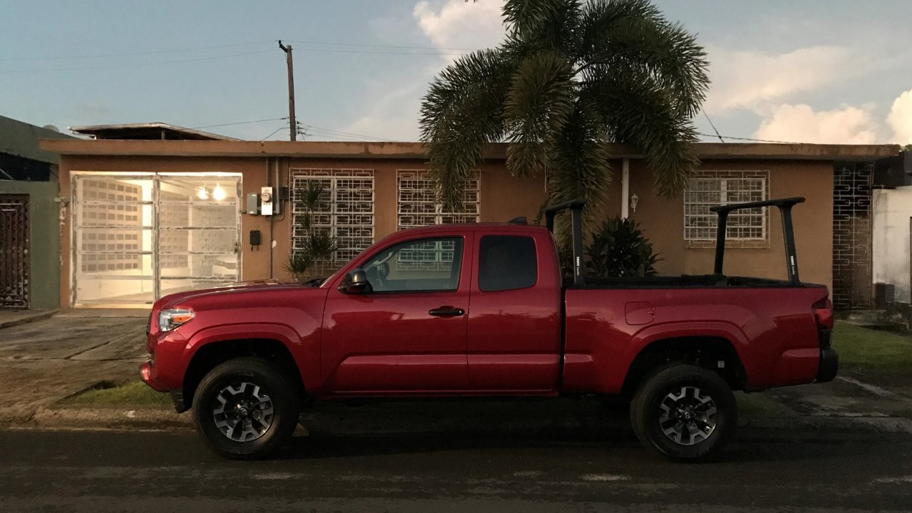

    You need a different style lug nut.
    Look for the "Mag" type lug nut. It will have a shoulder to fit the lug hole in the wheel and a captured flat washer that will mate with the face of the wheel.
