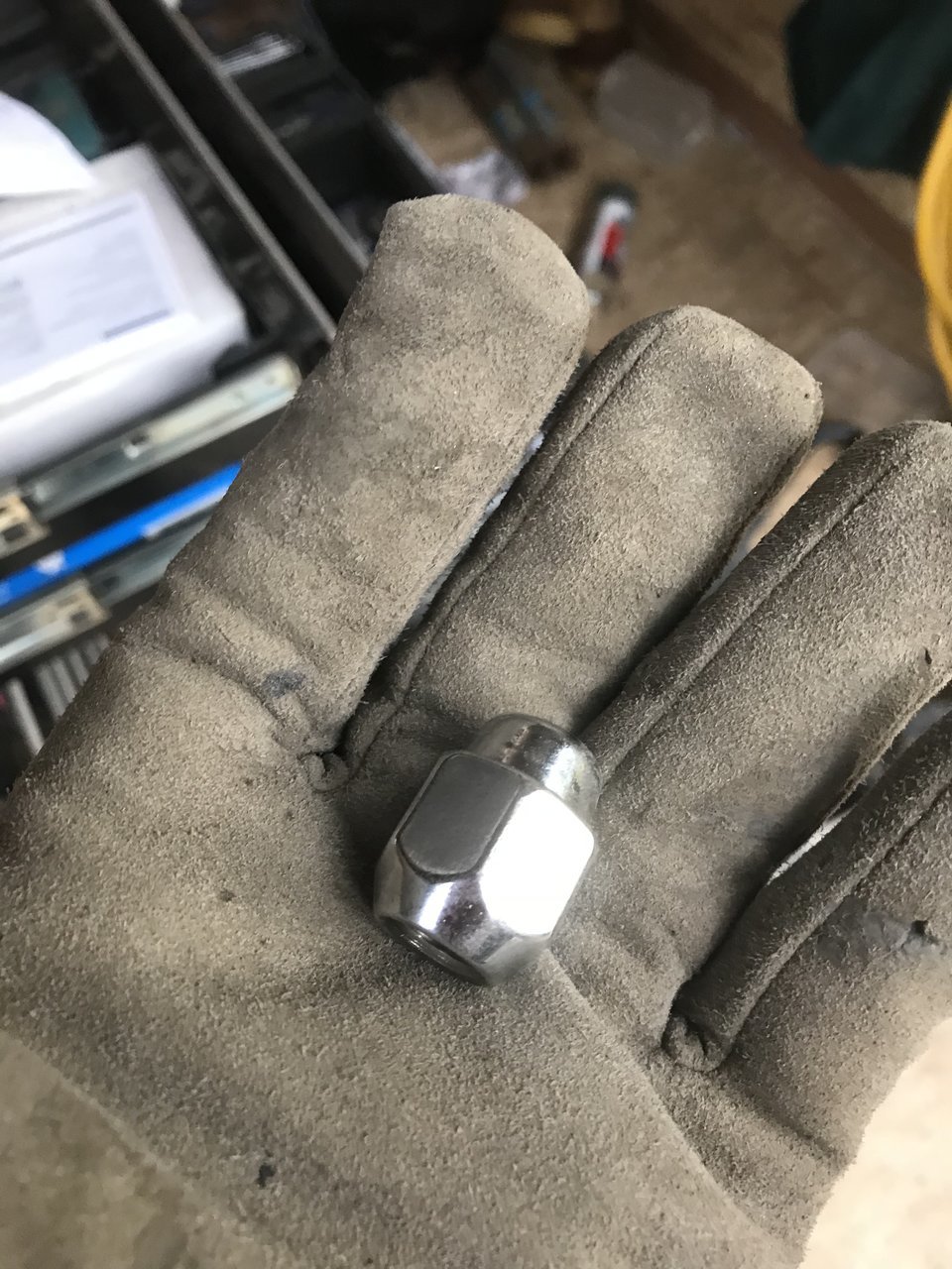

    You want the conical seat lugs for the steelies. These are what I bought at my local auto store

    What he said, but your aluminum wheel mag lug nuts have the acorn on them so you can use them on steel wheels.

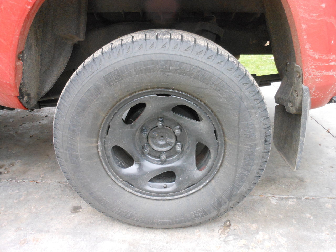

    I bought a set of black chrome "acorn" nuts for my black winter wheels....!! :thumbsup: Hard to see under all that crap, but they ART there...hehe
