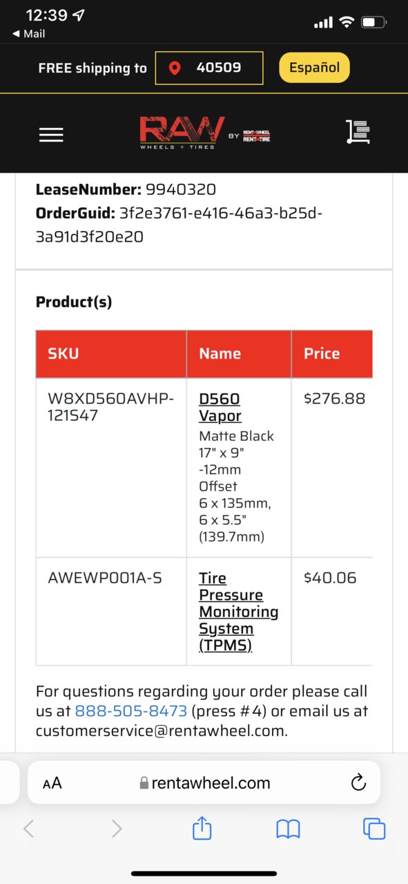

  9. Jan 12, 2022 at 9:41 PM
    tgoodson1814
    tgoodson1814 [OP] Member
    Dec 28, 2021
    #385731
    8
    Taylin
    2022 Tacoma SR double cab
    this is what I got guys

    Leasing wheels? And they don't provide the correct lugnuts? :eek:
    Again, either have them tell you what you need or go look at the wheel, where the lug will seat, and determine if it's tapered or flat.

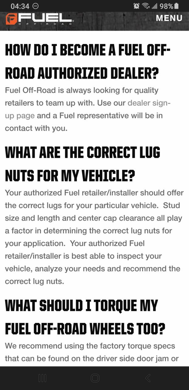

    Even Fuel doesn't provide lug nut information.
    I suggest you ask Rent A Wheel what is needed. I would suspect that it would be an acorn style lug nut.

    According to what you posted and what I found when I looked, they are a dual bolt pattern. 6x135mm & 6x139.7mm rim. They will bolt up.
