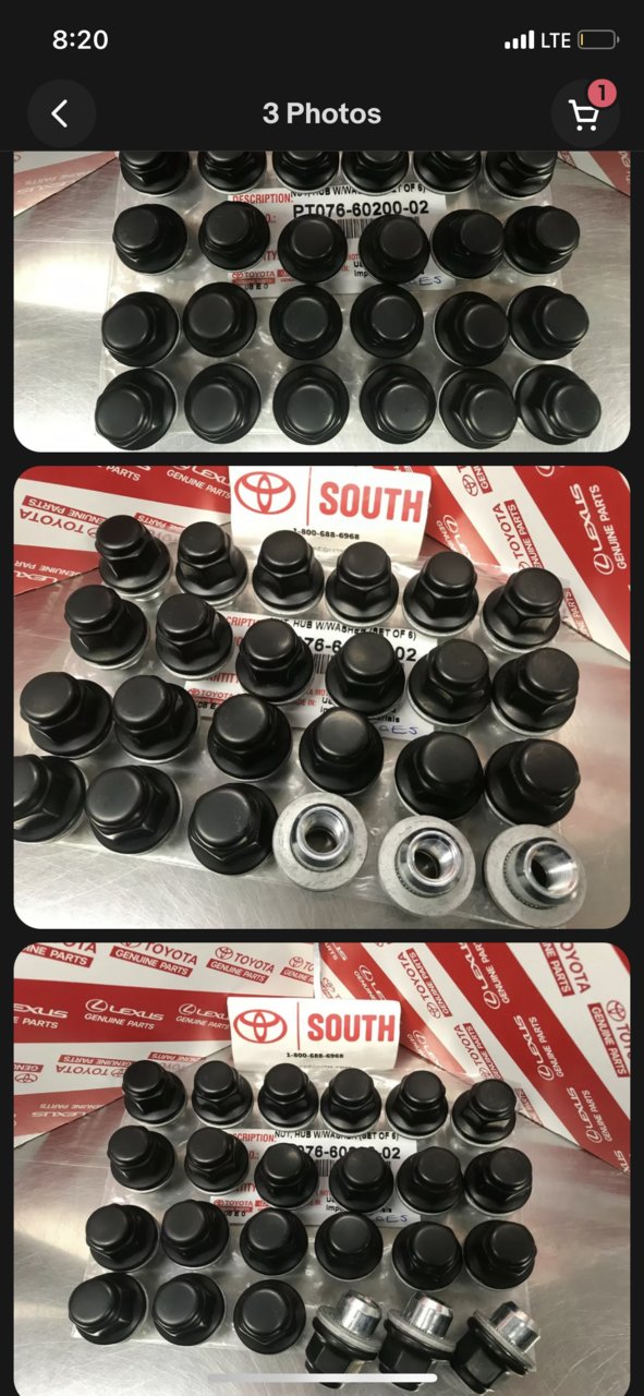

    These are the lugnuts I’m looking at getting

    The lug nuts for the steel wheels are NOT the same as the ones for the Alloy wheels.
    The lug nuts in your picture above are for the alloy wheels. Which came on the Sport and TRD trucks.
    If your current wheels are the OE Stock wheels, those lug nuts should work as well as the ones in the picture above.
    The type lug nut for the Alloy wheels are commonly referred to as Mag Seat.
    @Plain Jane Taco may know a better source to get them then at the dealership.

    Those will be just fine. And don't worry about the length. Some of Toyota's older wheels had deep lug wells and Toyota used a longer nut strickly for aesthetics. The thread engagement between the two lengths is the same. Anymore, Toyota uses the shorter nut on most wheels as the lug well is shallow on most of their current wheels. When in doubt....get the short ones.
    Toyota's alloy wheel lug nuts are often call "shank type". It's important to use them has the washer helps distribute the load evenly across the wheel hat. Toyota wheels are hub centric, so no worries about the nuts not centering the wheel.
    You'll also notice the nuts you pictured are tapered at the bottom as to be compatible with your steel spare wheel.
    Just Google Toyota Shank type lug nut. The size is 12x1.5. Socket size is 21mm
