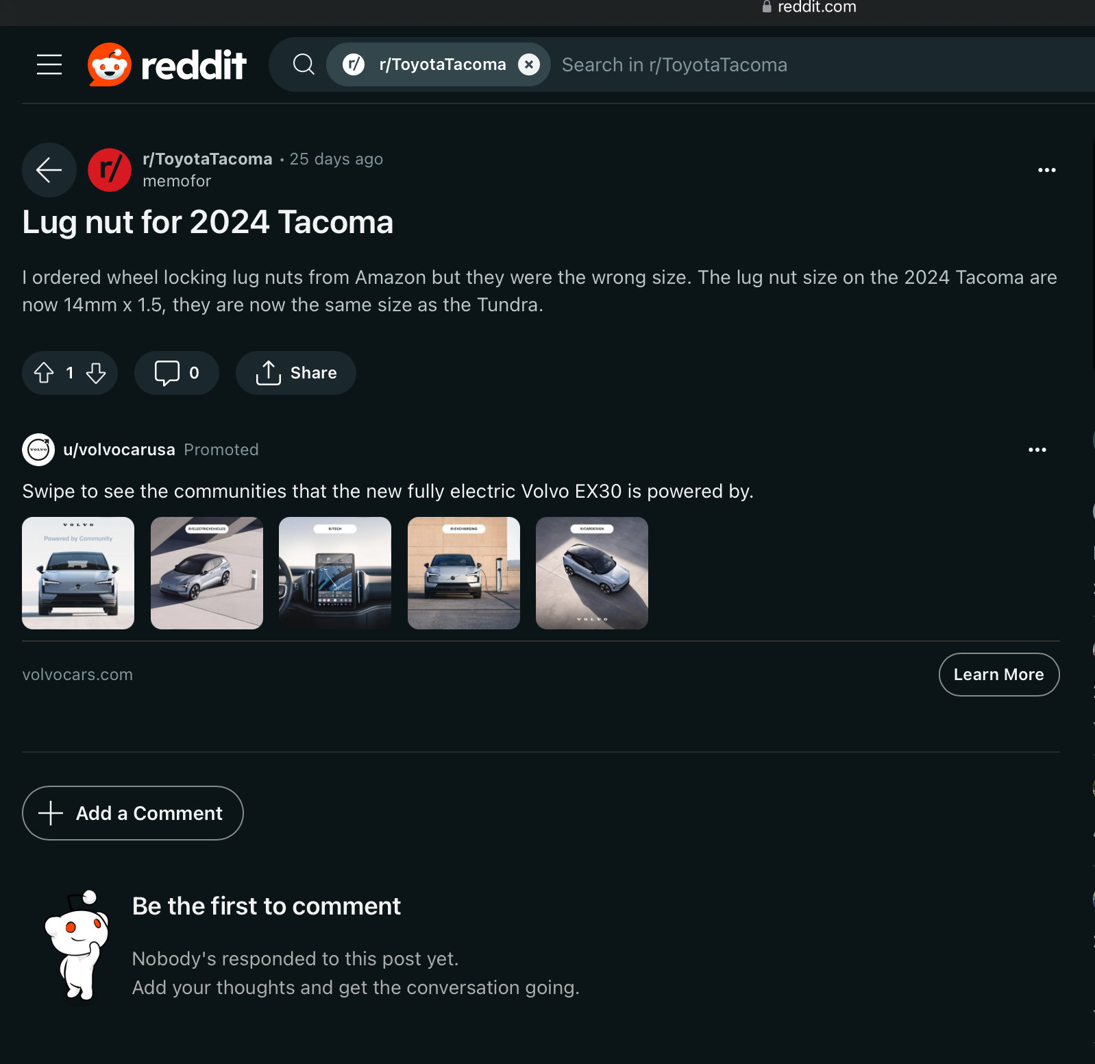

    Plus, a guy on Reddit says they are, see below
    I’d feel comfortable saying they are m14x1.5.
