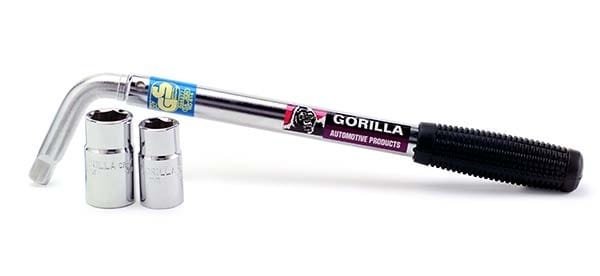

    I carry one of those in each of my vehicles, they are great since they pack up small but give you the leverage you need when removing wheel. I don’t use them at home though, just for side or road/trail flats. The sockets are shit though, so chuck them out and buy the correct one. Something like this if you need thin wall. (Don’t buy thin wall socket unless you absolutely need it)

    That is a 1/2” breaker bar. It just packs up smaller, and is longer (once extended) than the average 1/2” breaker bar. Plus, you can’t buy a quality 1/2” breaker bar for the price of that and you also need an extension on a breaker bar to clear the wheel / tire, with that you don’t since isn’t not 90deg.
    At home I don’t use it, but out on trail/road it’s way better since it’s smaller / lighter / and has more leverage.

    Yes, I have one and it does work great. Collapsed it's short enough to fit in a small tool box but extends enough for good leverage.

    This is what I have too. Fits nicely in the cubby’s under the back seat.

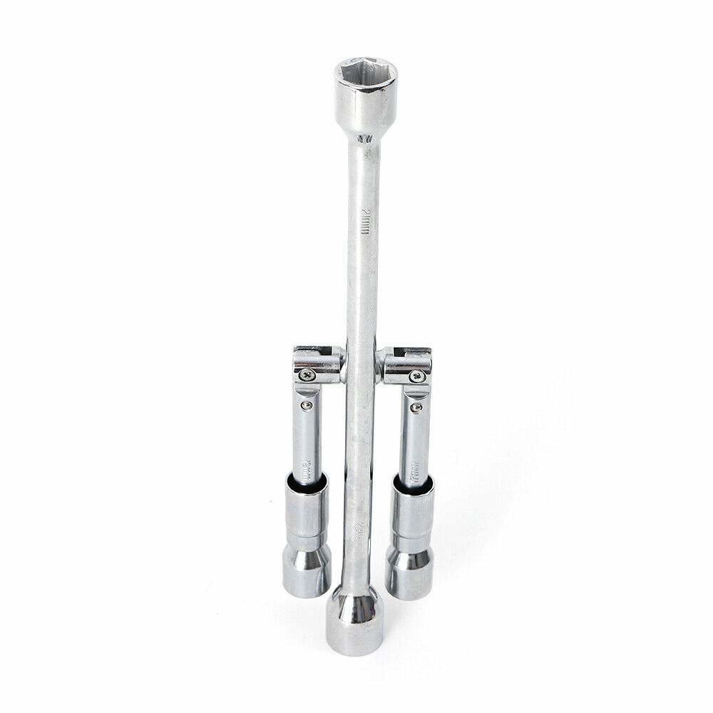

    I have 2 of these with thin wall sockets. Works great. Even bought one to use on the tow truck when I drove for 3a.

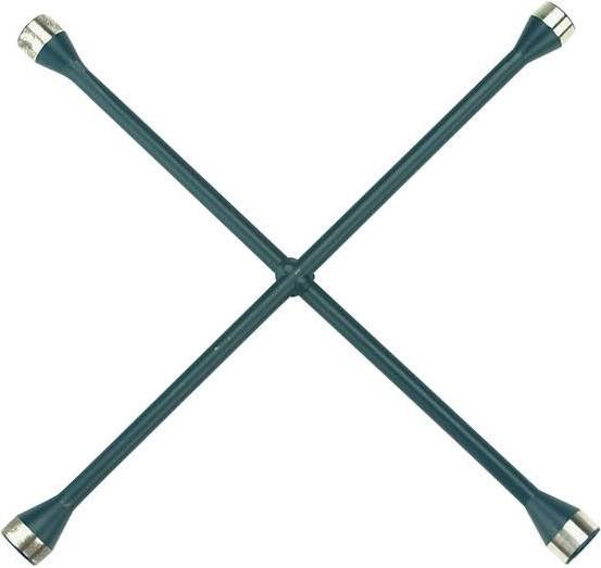

    With real tight lugs you might not get a good "straight" pull with that less than 90 degree bend than a 4way will give.

    Initially, this looked pretty nifty. Then i read the 1 star reviews about how the socket is just press fit on the end and will twist right off with enough torque. Too bad, because it is a great concept if it were done correctly.

    I've always used these. Not for all of the different sockets, one is all you need. But for the ability to push and pull at the same time. shopping.jpg
