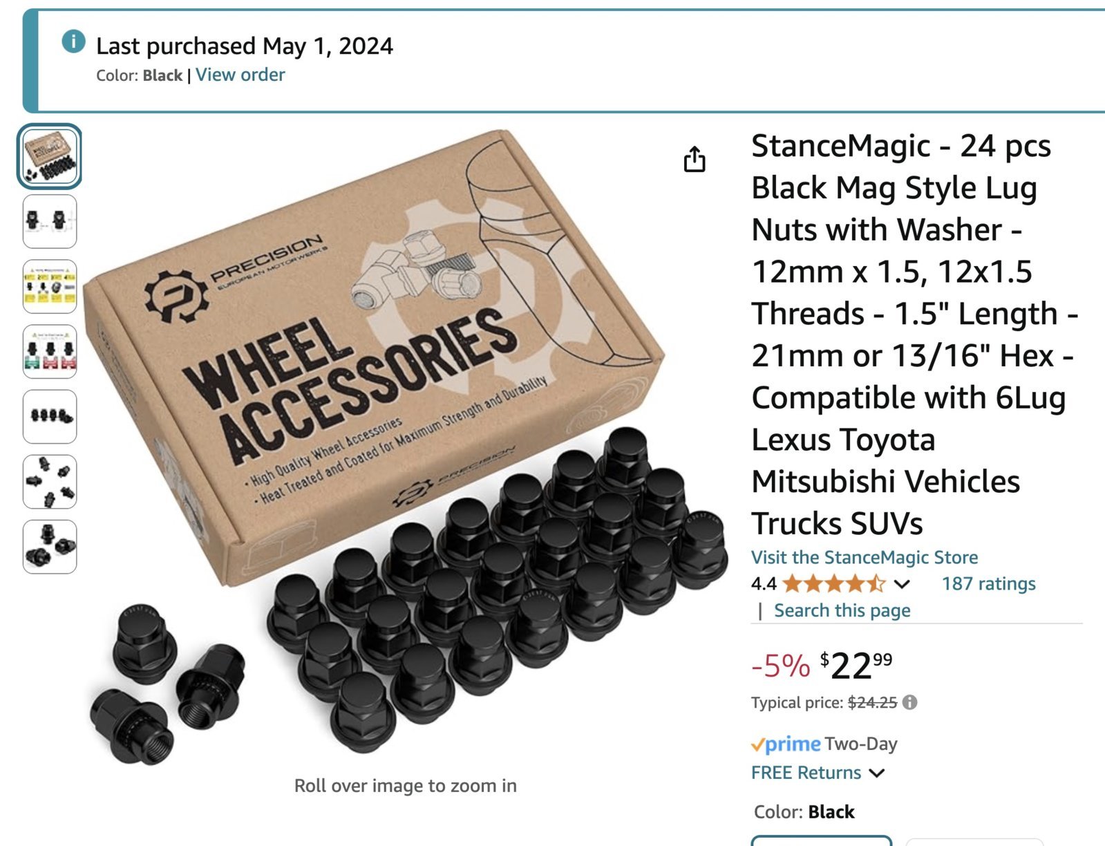

    I typically buy genuine OEM parts but when I saw the price for OEM toyota lugs for alloy wheels -- with their shitty, damage-prone fake-decorative-cap design -- I looked for alternatives.
    I'm carefully testing these inexpensive 3rd-party lugs on my 2014 4.0L 6MT TRD OR with stock 16" Toyota alloy wheels -- 2 of these black nuts per wheel, re-checking the torque regularly. Fit & finish, thread depth, contact, etc. all appear perfect. The body of the nut is solid metal, unlike the OEM toyota lugs. About 850 miles on them so far, with 4 or 5 torque checks so far, and none of them have loosened at all.
    (Regular torque checks at 50, 100, 250, 500 miles.. a pattern I will continue out to 1K, 2.5K, 5K, and eventually 10K miles. If they hold tight to 10K miles I'll consider them fully-qualified and trustworthy.)
    Hard to beat for $23 a set in black or $16 in chrome. They're also ~10-15% heavier than the OEM lug nuts, which I consider a good sign.
    https://www.amazon.com/gp/product/B00ED74XFO/

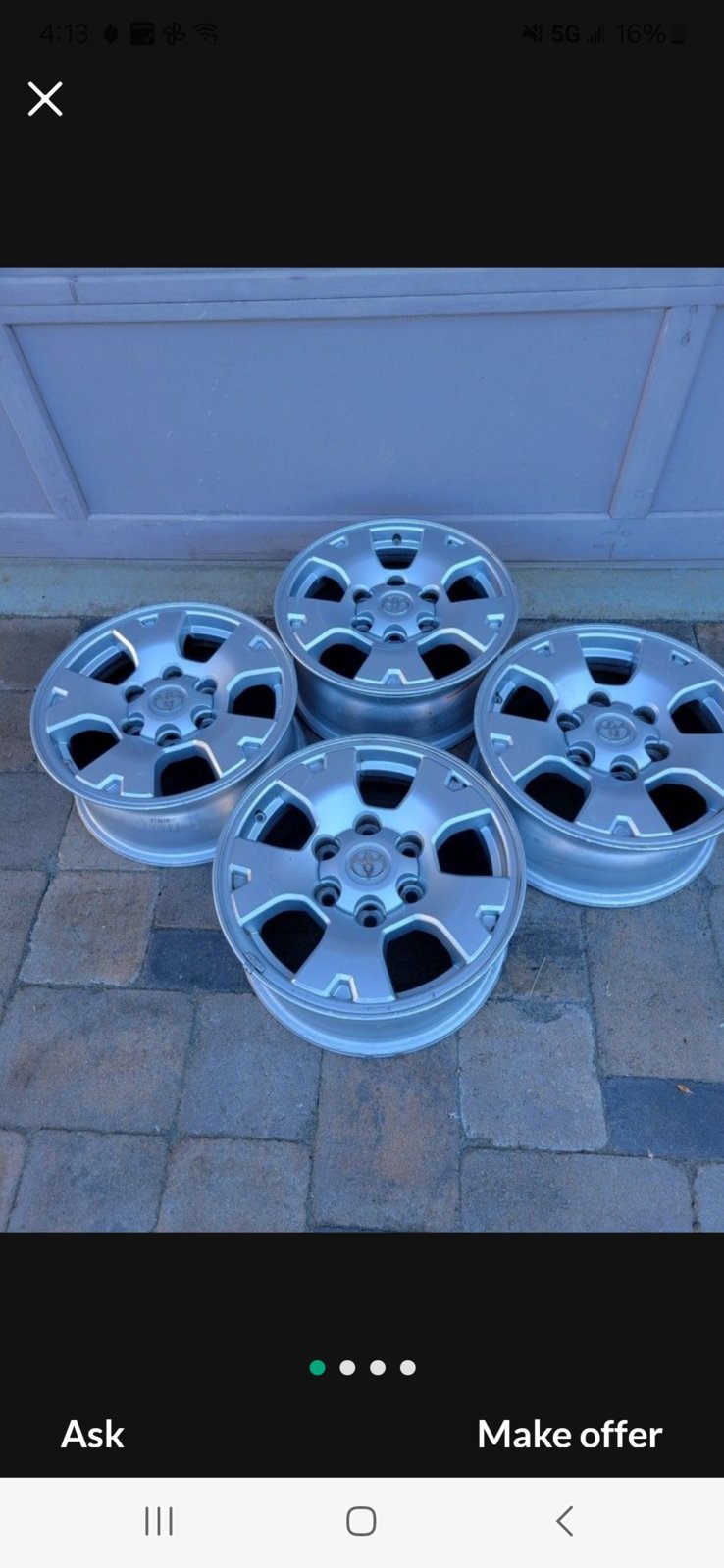

    Here's a pic of one of my alloy wheels, for reference / comparison:

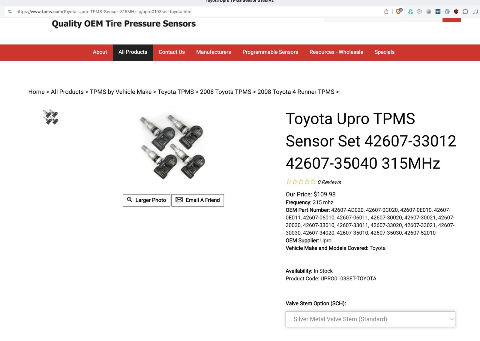

    I don't know if these are "universal programmable" (not sure what that is,) but I recently did new tires myself (remove, TPMS + remount, inflate, balance, mount on vehicle, program TPMS) and these sensors fit perfectly and work perfectly, so far. (About 1,500 miles on them.)
    https://www.tpms.com/Toyota-Upro-TPMS-Sensor-315MHz-p/upro0103set-toyota.htm
    Note, a set contains 4 units, if you want to rotate in a full-size spare remember to buy an extra TPMS for the spare. But also note that some (maybe all?) 2nd gen Tacomas will only register 4 TPMS IDs in the TPMS ecu, so the spare tire TPMS will not work right unless it is manually reprogrammed into the TPMS ECU every time you do a spare rotation. (If you are doing a 5-wheel rotation.)
    I have & use an Autel MaxiSYS MS906TS scantool to do the TPMS reprogram. I'm sure there are other less-expensive TPMS programmers that could work but YMMV as far as exact compatibility w/ your truck.
