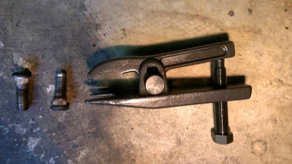

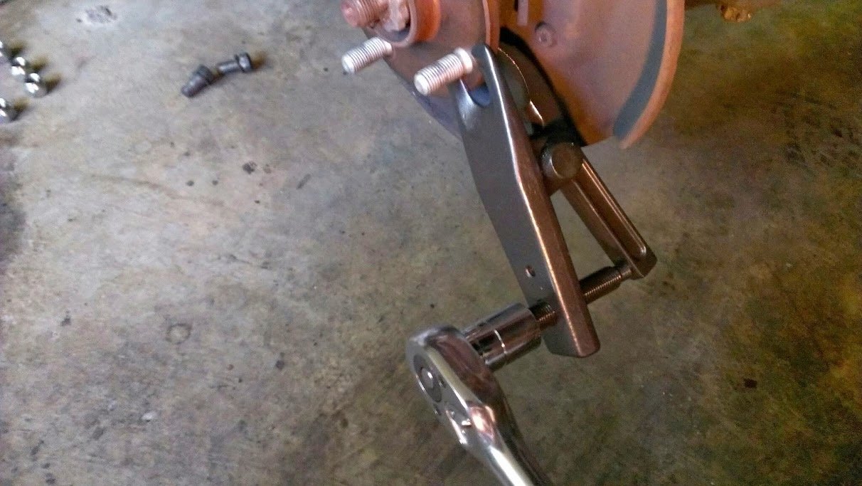

    I’ve also used a ball joint separator with good success. Don’t have to worry about buggering up the new threads. Not my pic found on the interwebs but you get the idea.
