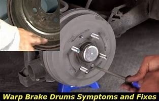

    drum.jpg I've read somewhere in this forum that over torquing the lug nuts can possibly warp the drums.

    That's true but,
    A.) you need to drive around like that for a bit to warp your drums/rotors
    B.) if they were warped you'd feel it.

    So you don't think over torquing is a problem? Drive a ford or Dodge with overtorqued lugs and see how long the rotors last before the brakes start pulsing. Likely the only reason that's not been an issue for you yet is Toyota rotors are very good about not warping but they're not immune to the problem.
