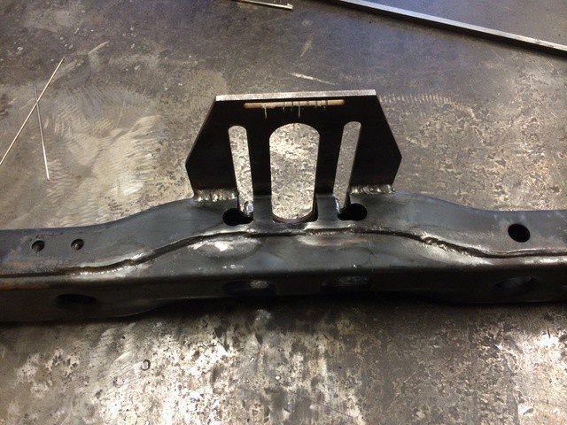

    stayed a couple hours late and TIG welded it up.
    started with 3/16 electrode and wire, but switched up to 1/8 and the weld came out better with twice the heat I started with.
    I also competed the bead from the factory stitch welding.
    Now its ready for powdercoating :cool:

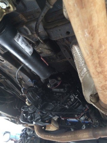

    aaaand the conversion is done.

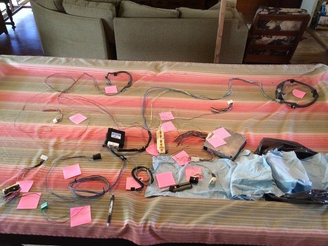

    this is the wiring. I just followed the FSM one by one, figured out where each one goes.
    the 2wd harness and 4wd harness are different. the nice part was the 4wd wires plugged into the blank spots in the 2wd harness.

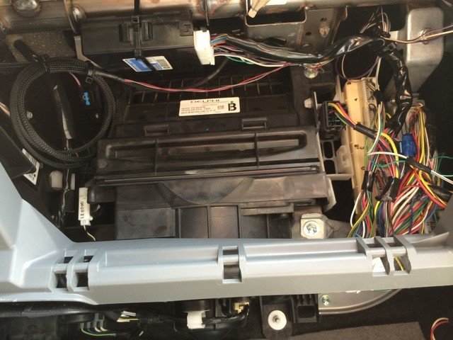

    this is how it looks with all of the wiring installed. I had to add around 10 wires into the existing mess of wires on the ECU and relay junction panel.
    I de-pinned the wires for the rear locker since I maintained the original 2wd locker wiring...saves me the hassle of doing the anytime-locker mod.

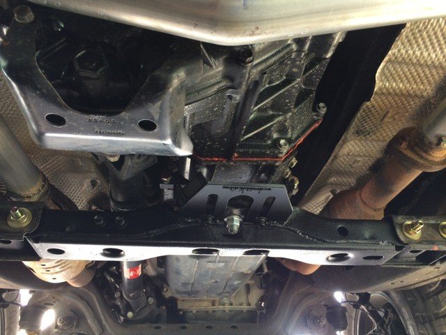

    this is the custom trans support. I used the oem 4wd support and machined out the center of it and made a new mounting plate. welded it up and painted.

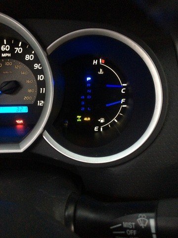

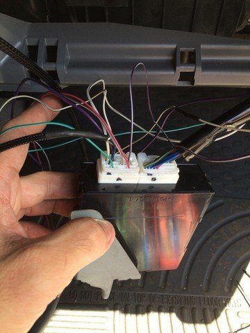

    lights are included on all dash clusters, just needed to add the signal wires in the back.

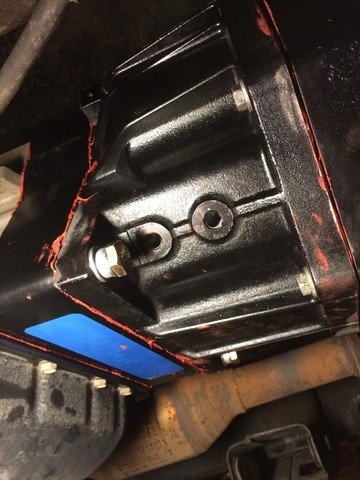

    the inchworm trans adapter.
    had to measure and cut about this much off of the trans output shaft. It would have been easier to install a 4wd transmission.

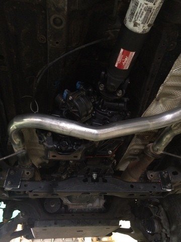

    the y-pipe now.

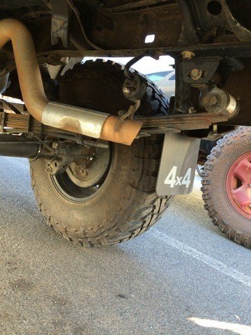

    Installed some ATO shackle flips a little while back, lots of droop with the RCD 5100's
    Cut the exhaust to clear just a little, I'll eventually cut the exhaust a little more and put the TRD tip back on.

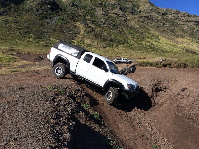

    downhill crawl at Kaena Pt.
    some rocks at Kaena Pt.

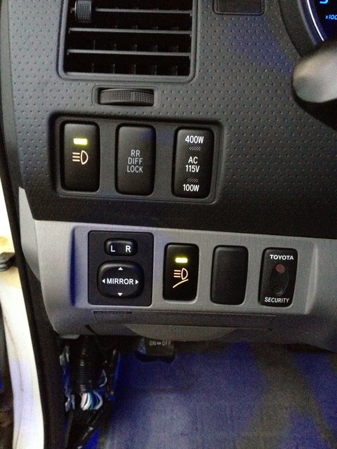

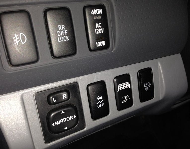

    SRQ- Hyperspots mounted via Relentless hood mounts with homemade aluminum lift spacers.
    wiring new OTRATTW switches, slight pain in the ass, planning for front locker later this year.
    finished install looks like oem :D

    No... This switch that I just got looks OEM :p
    Drops right in too ;)
    seoulja99 likes this.
