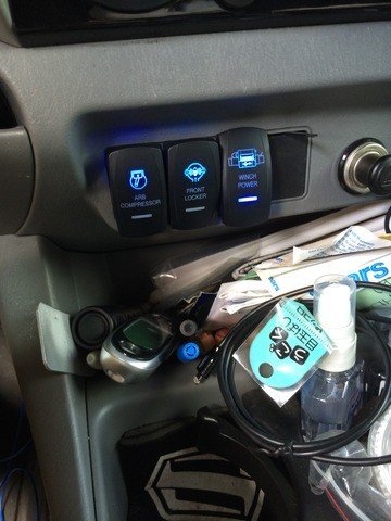

    Yes. When you turn on the parking lights, the text lights up, when you turn on the light bar, the light bar icon lights up :p

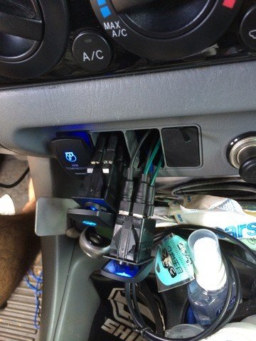

    Looking to do this to. Did you leave the dash in place and just fish all the wires through?

    Yup leave dash in place and run the wire to switch.

    coat hanger used by chance? im planning on running the wire from there to the engine bay, so Im going behind the gas pedal and stuff. You can run it that way?

    U can use that or I used 12gauge solid conductor wire

    What switch are you using to engage the diff actuator?

    The stock 4wd system. I wired in the stock system until I get the fj swap
