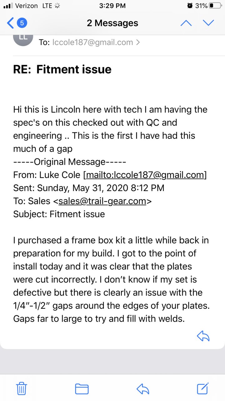

    What do you guys think of this...
    erice likes this.
  10. Jun 3, 2020 at 12:28 PM
    #210
    LukeCC
    LukeCC [OP] Well-Known Member
    Mar 13, 2017
    #213229
    2,445
    Luke
    Southern California (East County)
    2002 LT DCSB
    You can’t seriously look at this photo and think that’s a frame issue and not a fitment issue

    1996 Toyota 4Runner
    Ya, those aren't going to work hahaha
    FlapJack935 and Titus94 like this.

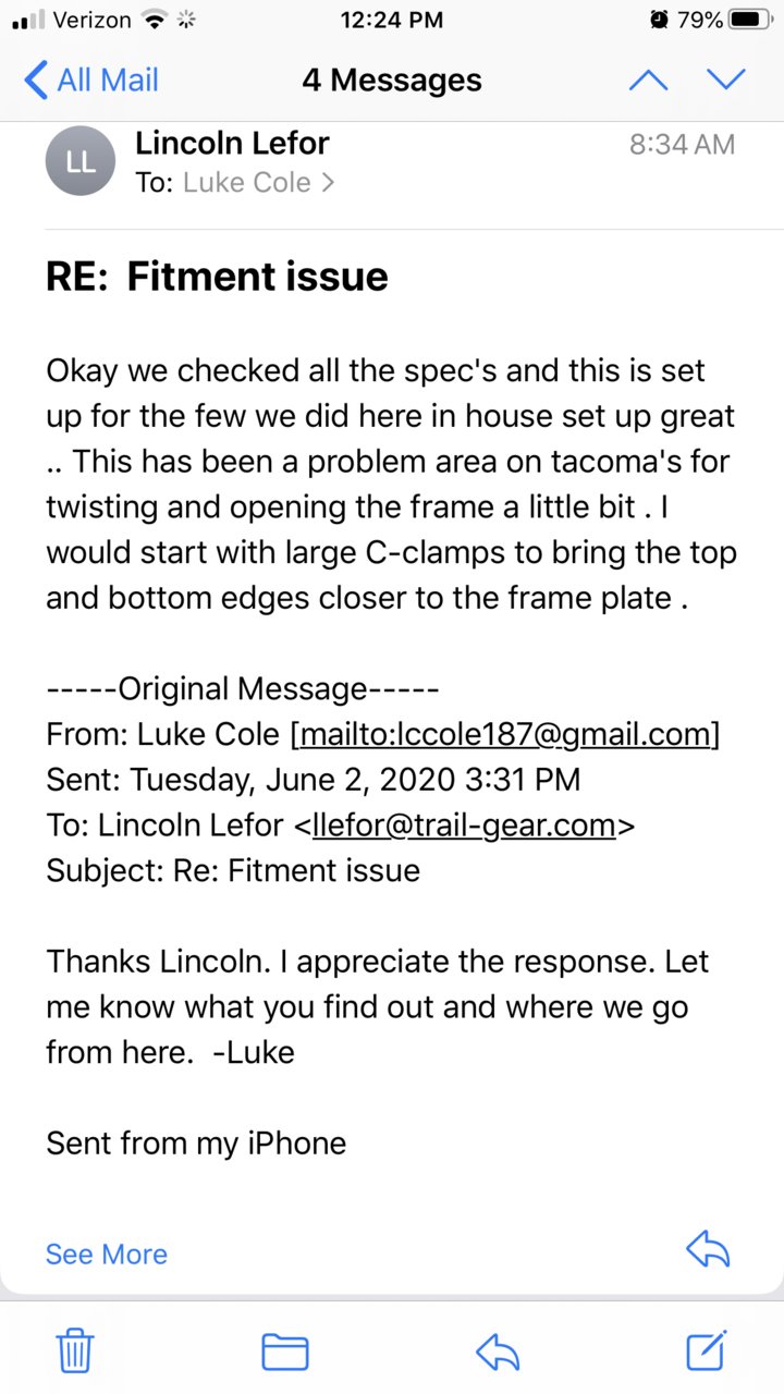

    @LukeCC thats terrible they told you to clamp it.
    An oxy torch with a steady hand could do it also. I would want to build out a proper template in illustrator first and test that puppy out before we put it on a table @Titus94 But thats a good, easier way to go about it.

    For me to warp my frame with c clamps to compensate for their undercut product seems counter intuitive to the whole idea of structural reinforcement.
    i’m wondering if I should take measurements of other first GEN Tacoma frames (@Titus94 @erice) and take pictures. Compare them to mine and send them pictures and say “are all these frames bent and warped in exactly the same places on all three trucks?”
