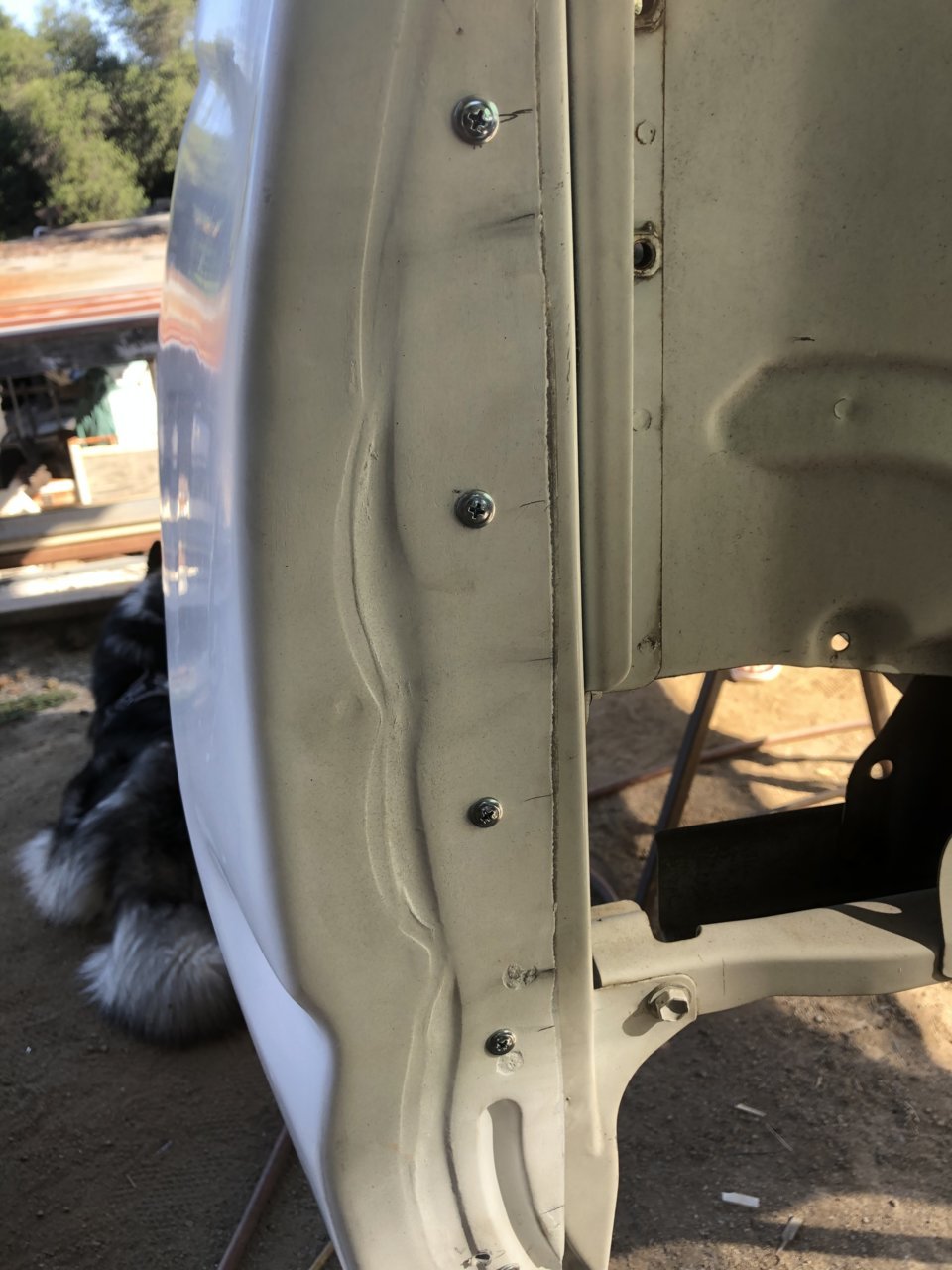

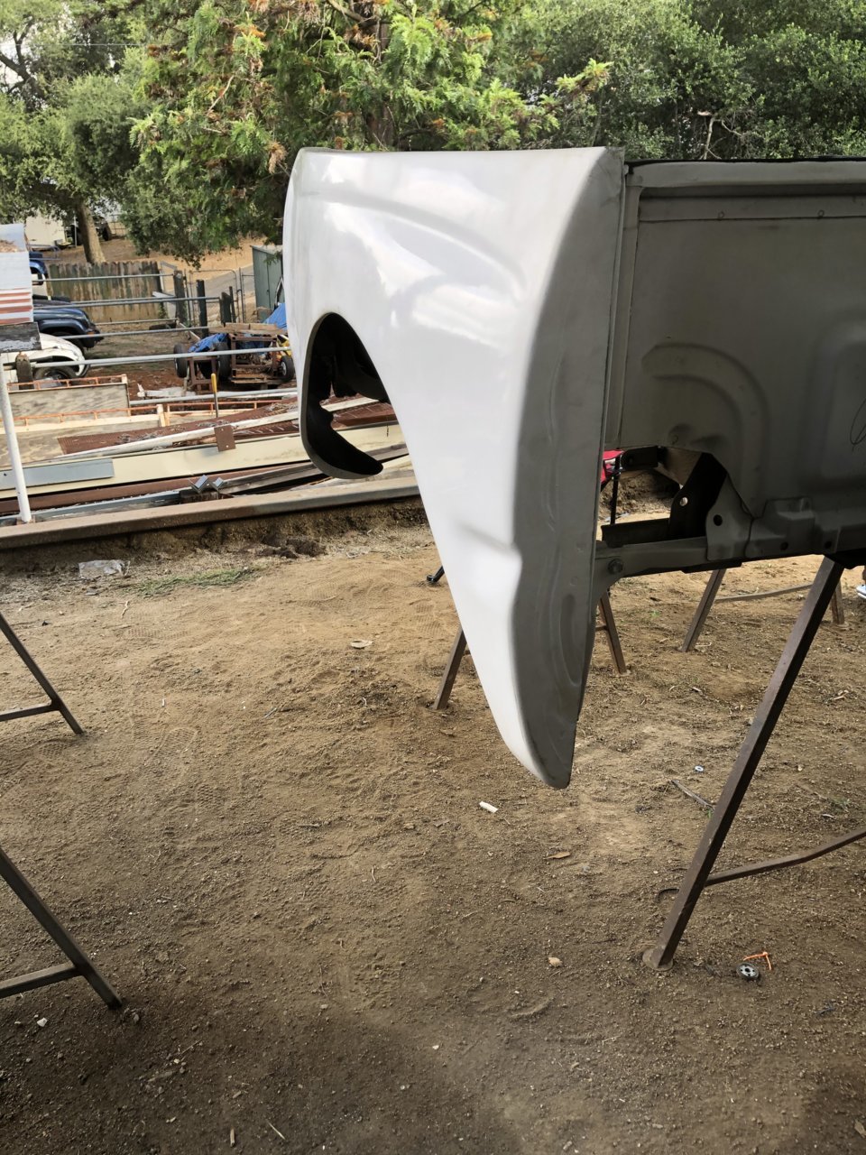

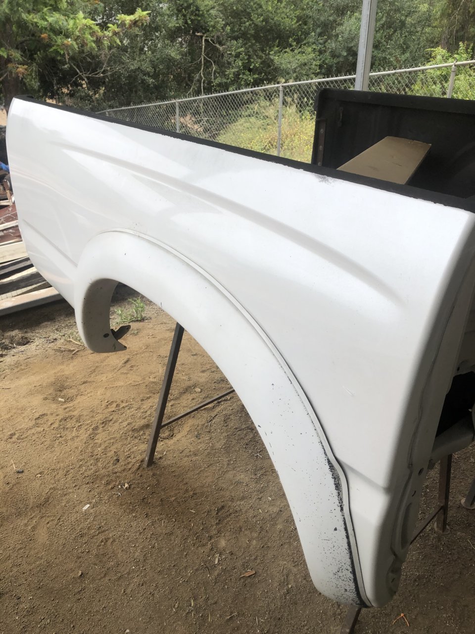

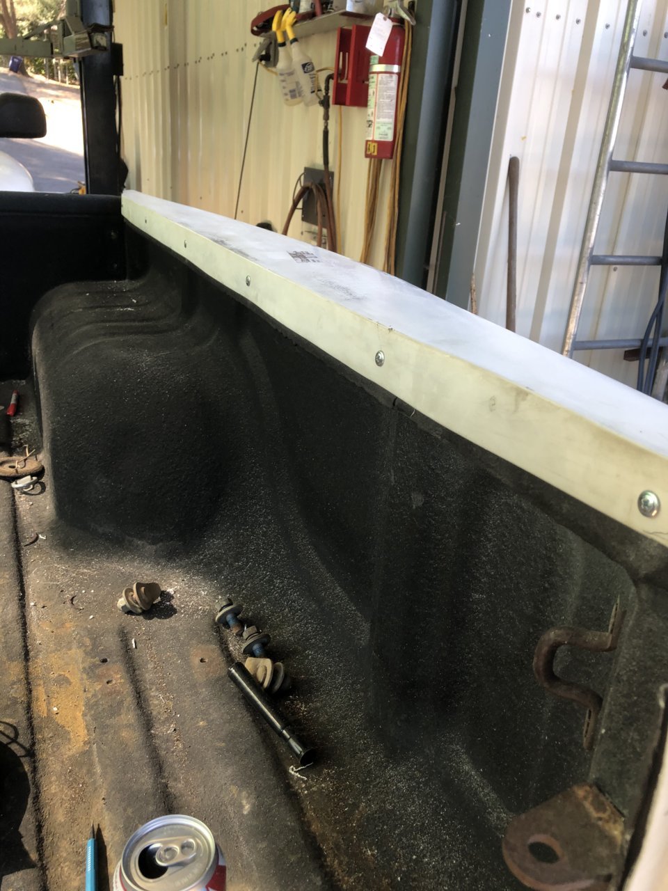

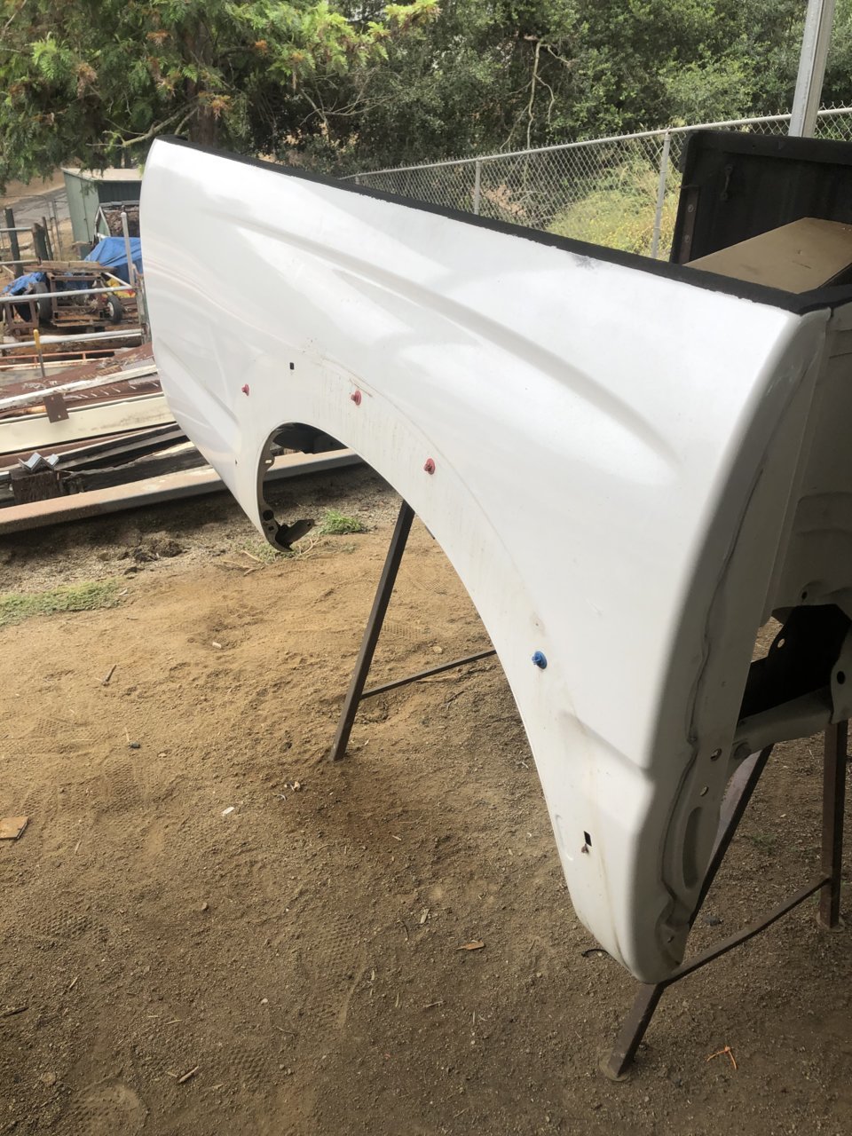

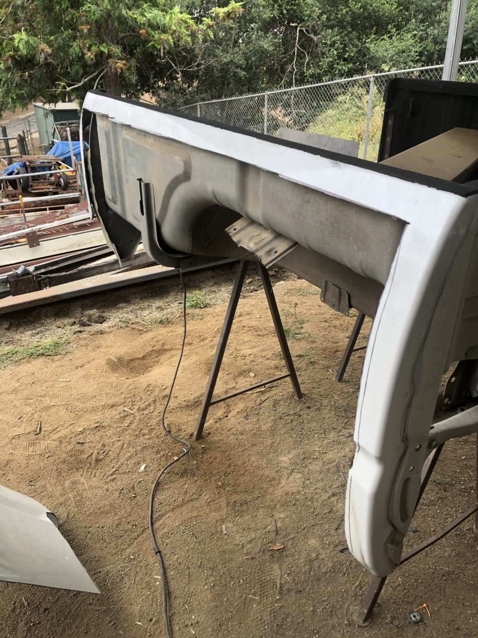

    Got the passenger side fitted and hung. What a PITA. Was more trimming and fitting than I was imagining. A lot of taking it on and off. Got it fitted and moved in to the driver side.
    Got it cut and stopped there. Will hopefully finish tomorrow.

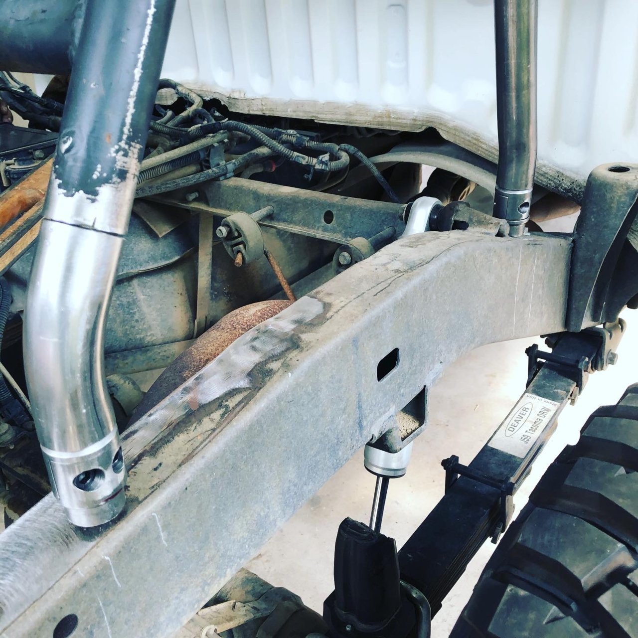

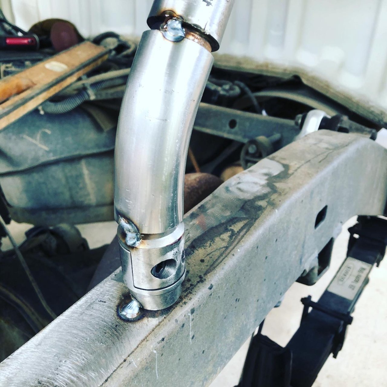

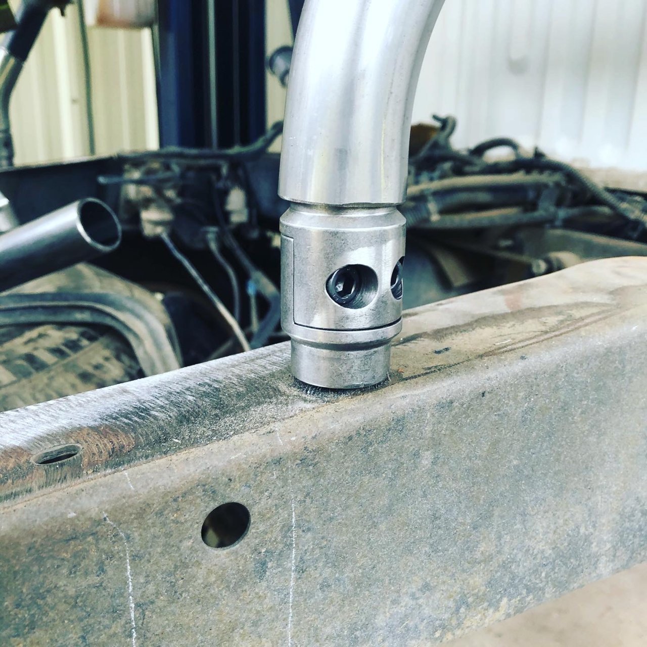

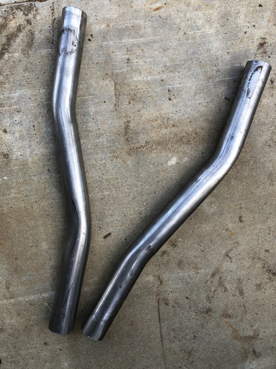

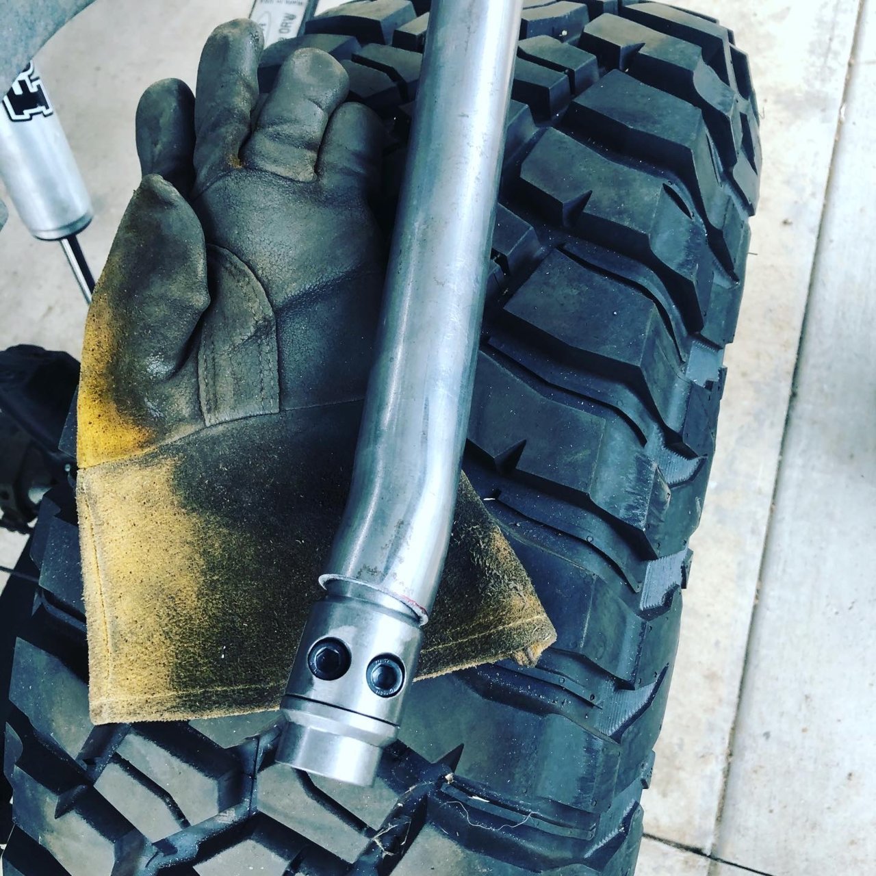

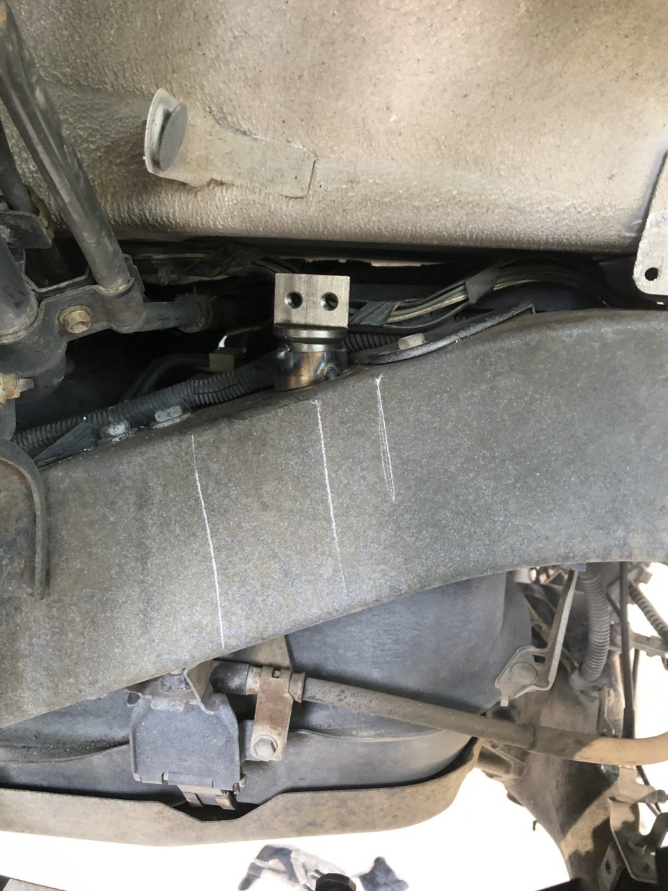

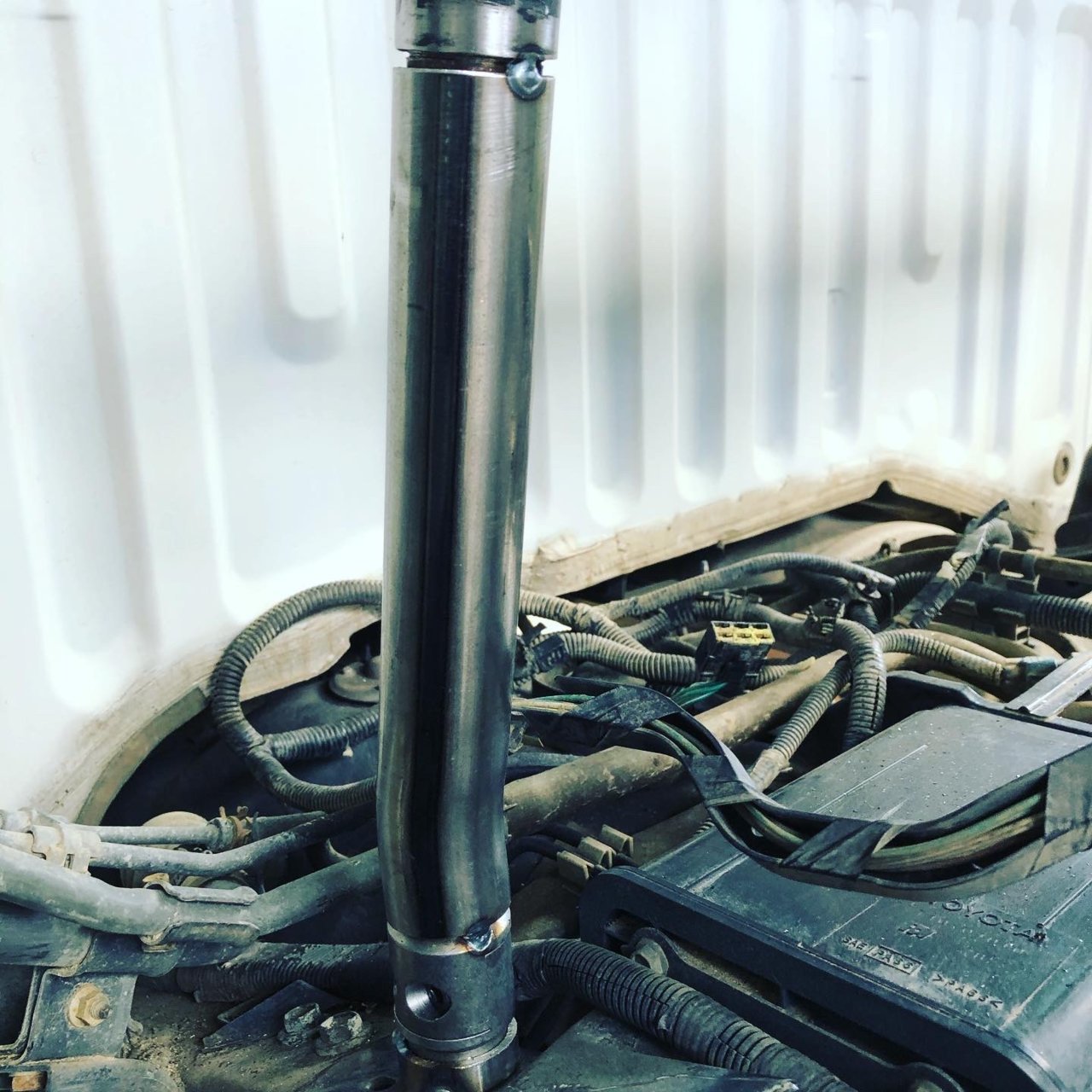

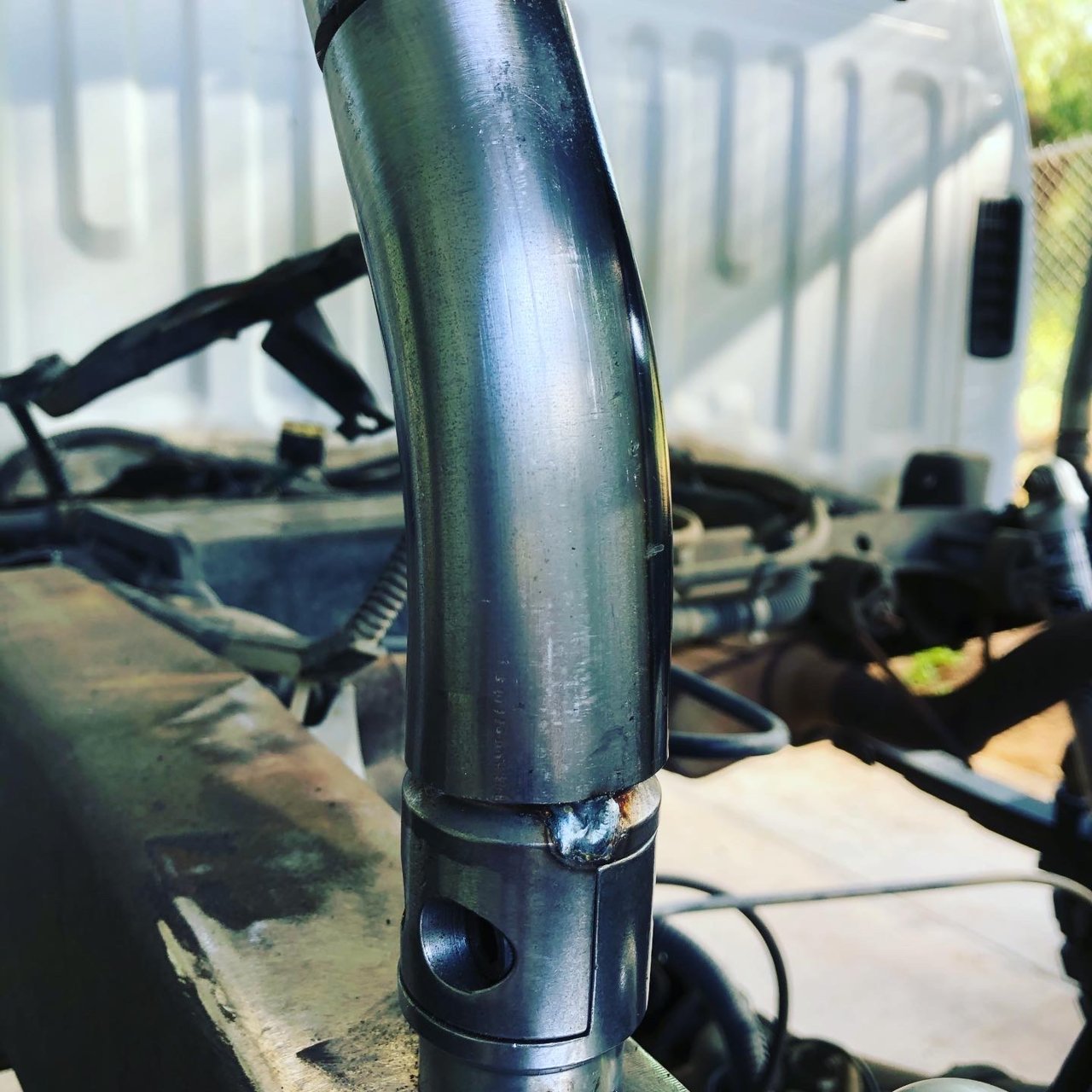

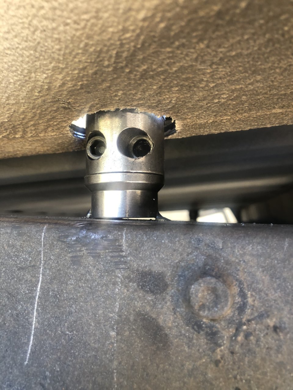

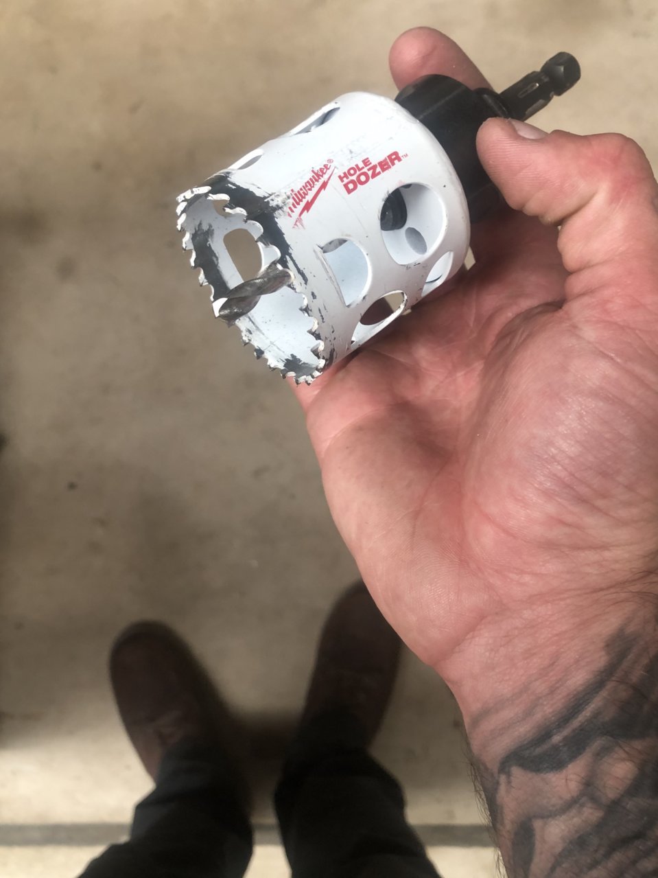

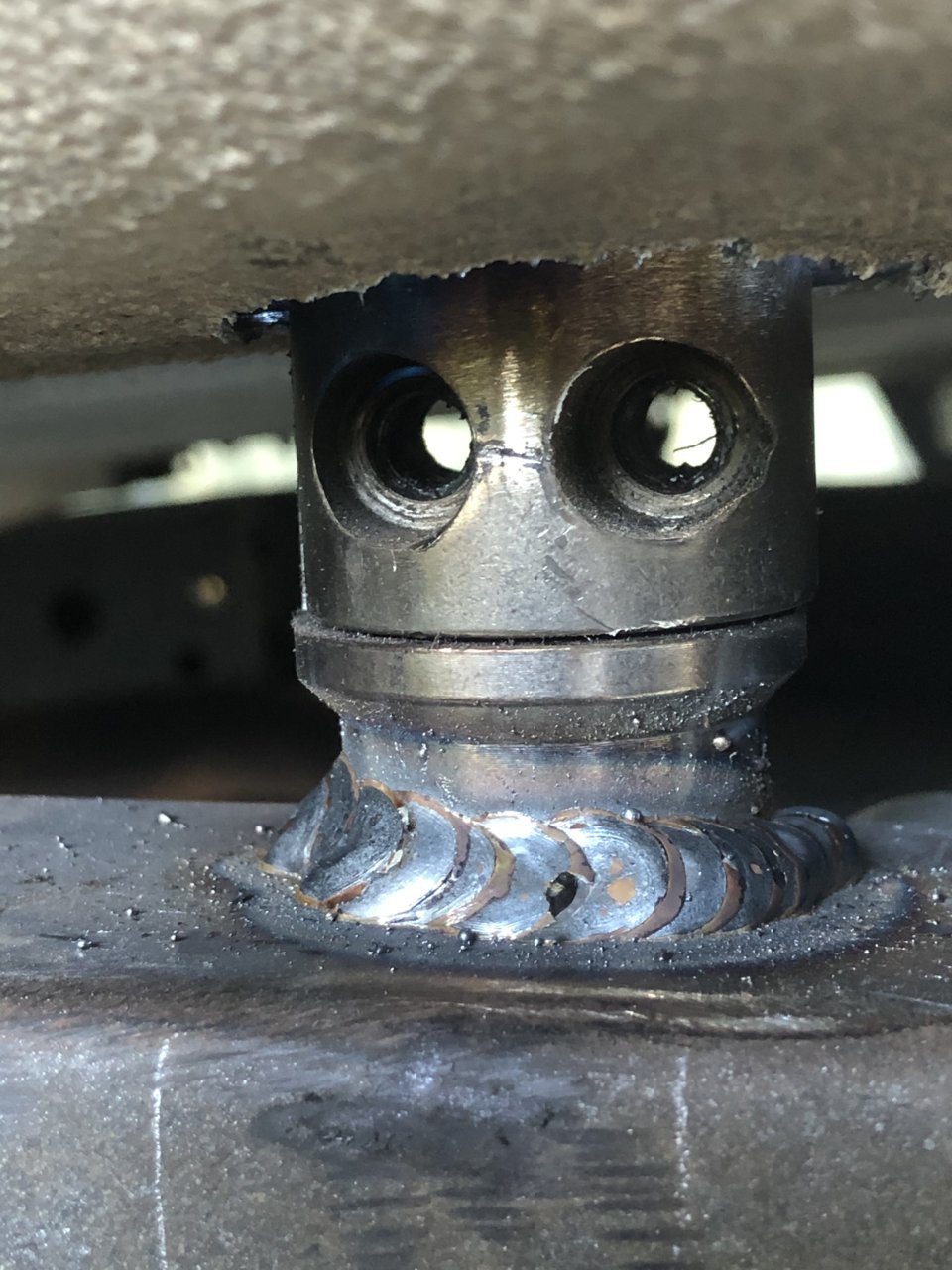

    Also got a little work done on the bed cage.
    tacked on the tube clamps I picked up from latest rage last week. (1.5” .120 wall) so the cage could be removable. My dad bent some tubes up at his work and we got them sleeved in and tacked to the frame.

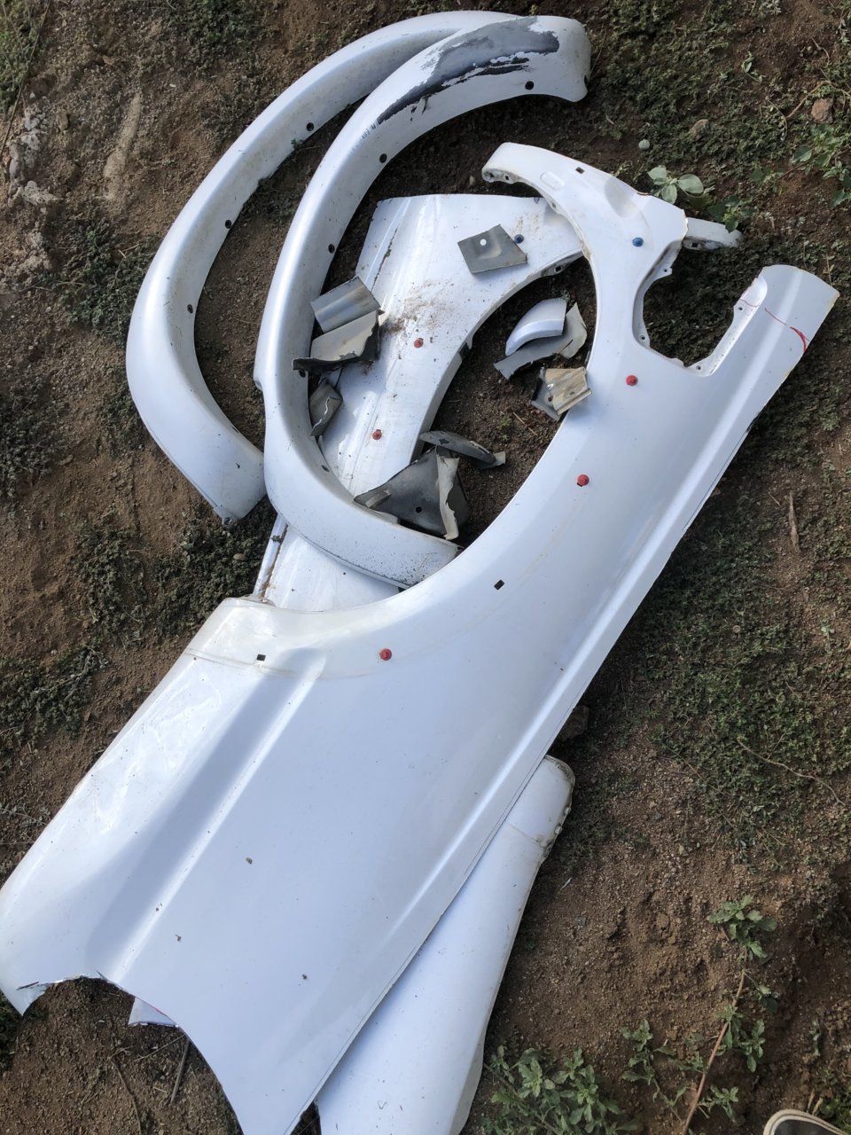

    yeah the driver side bump hit the strike pad at an angle and split the top part off I’m guessing. Haha

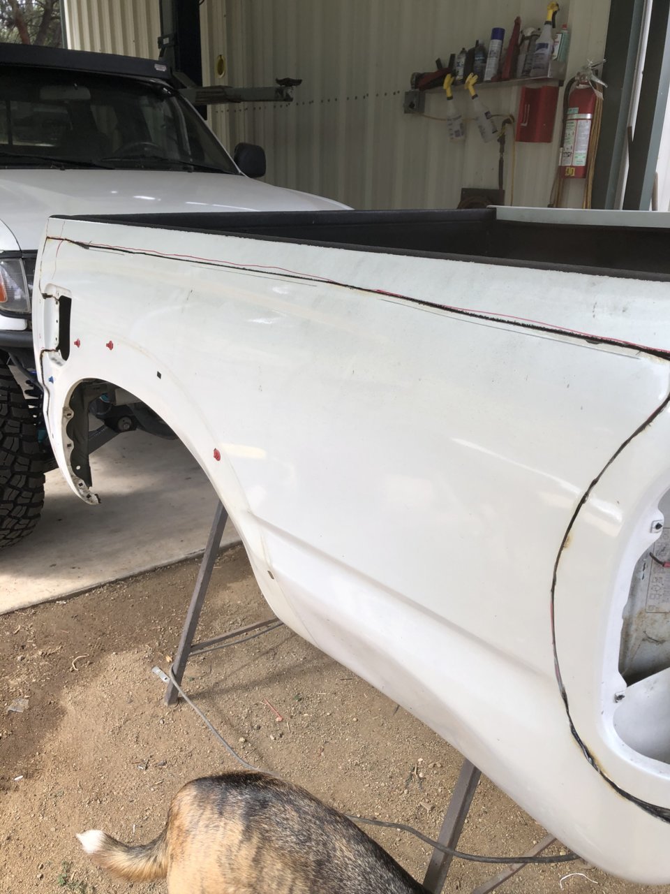

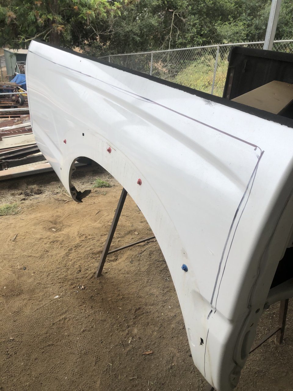

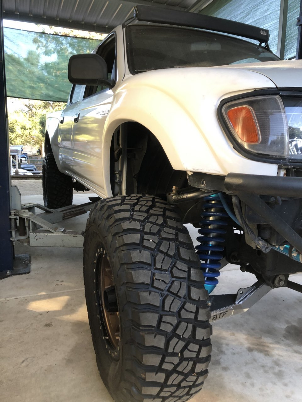

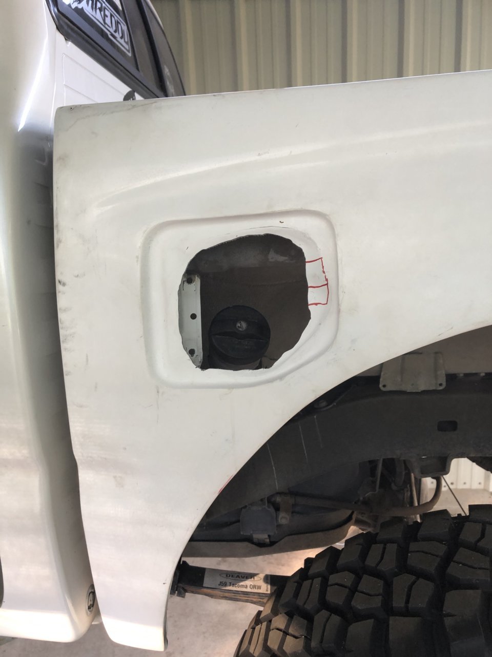

    Ended up getting the driver side glass fitted and both sides mounted. Still need to trim to fit the tail lights and fuel door area but both sides are mounted and ready to go.

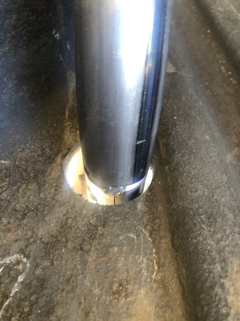

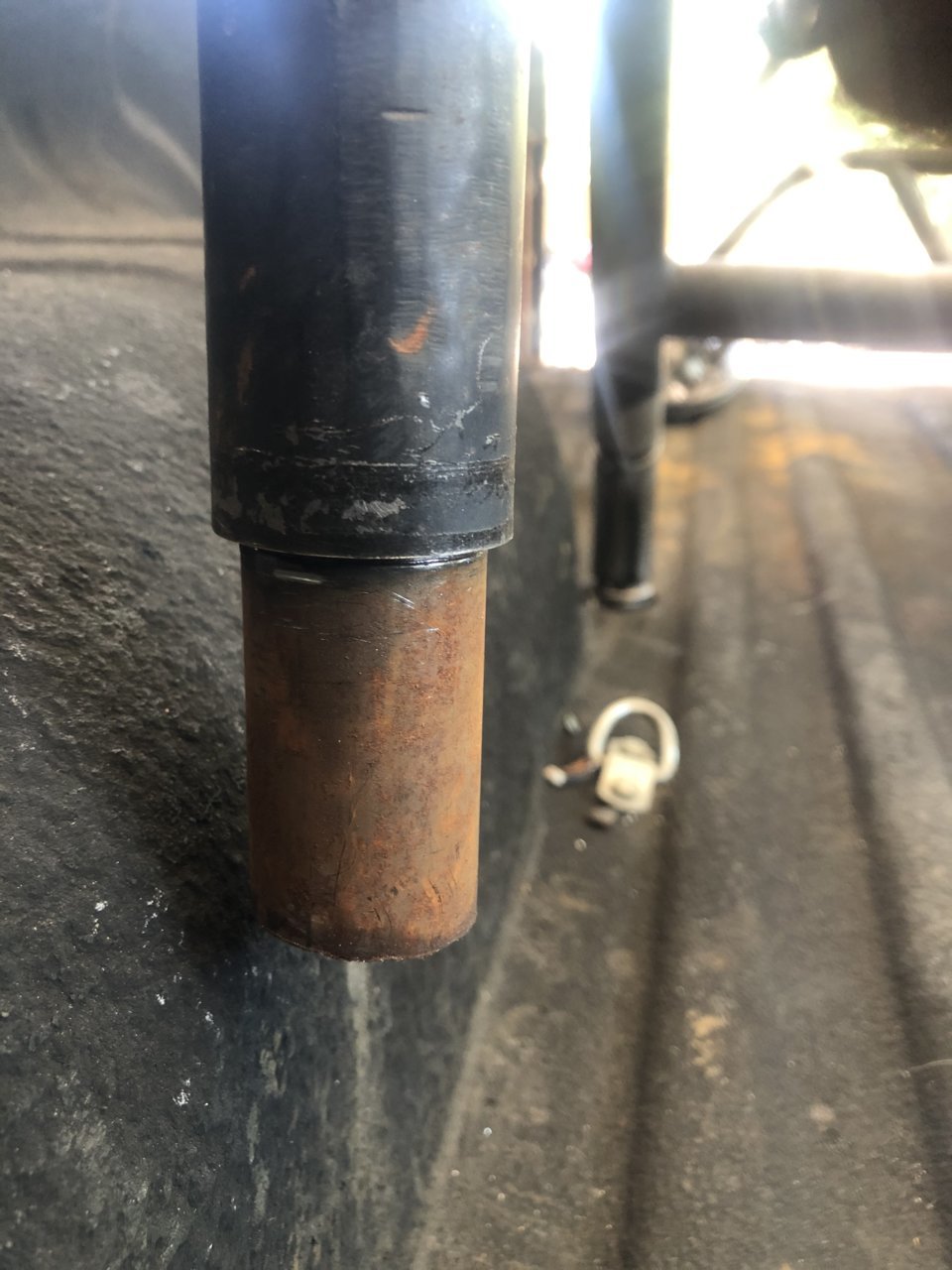

    Today’s progress. Got the cage through the bed and connected to tacked frame pieces

    Once everything was tacked and connected pulled everything apart and burned it 360
