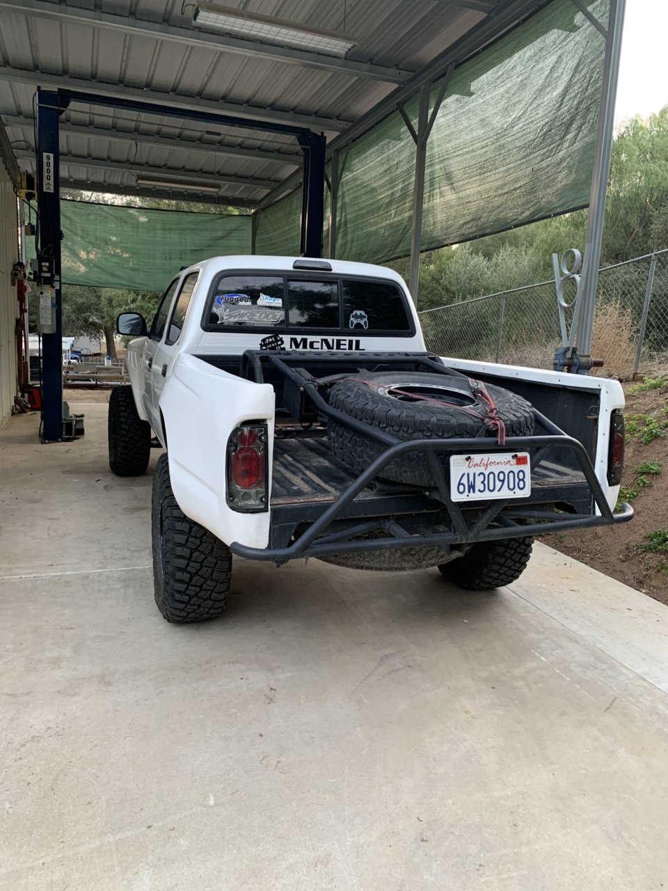

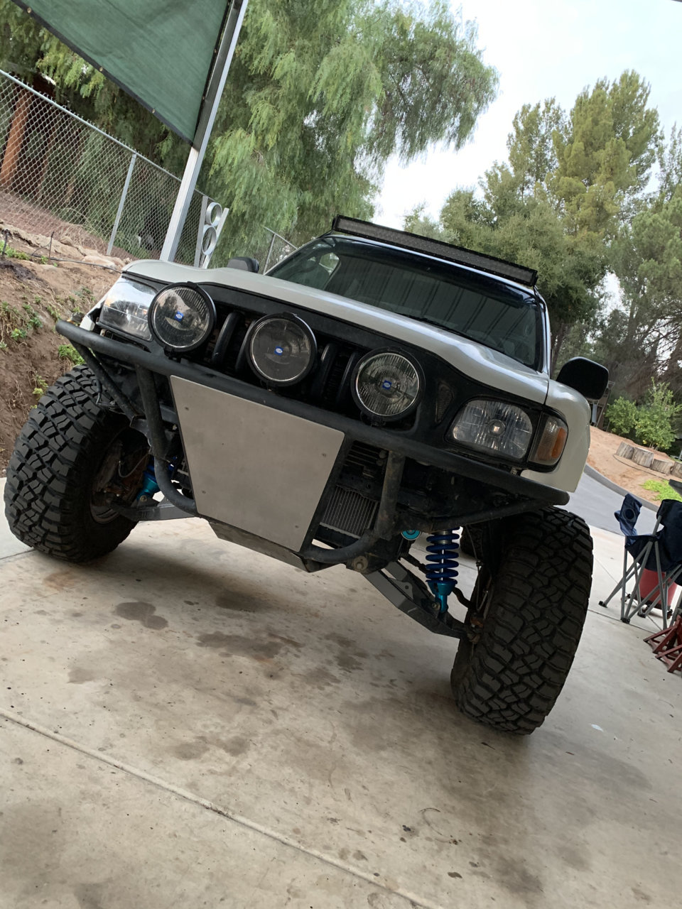

    Back home from transmission shop with new unit. Now the damage assessment begins..
    :frusty:
    DDE99065-5520-4563-9CE7-C8493111DDDA.jpg 296678DB-6419-4942-B1C5-B19CB451C500.jpg
    Ritchie and eccracer104 like this.
