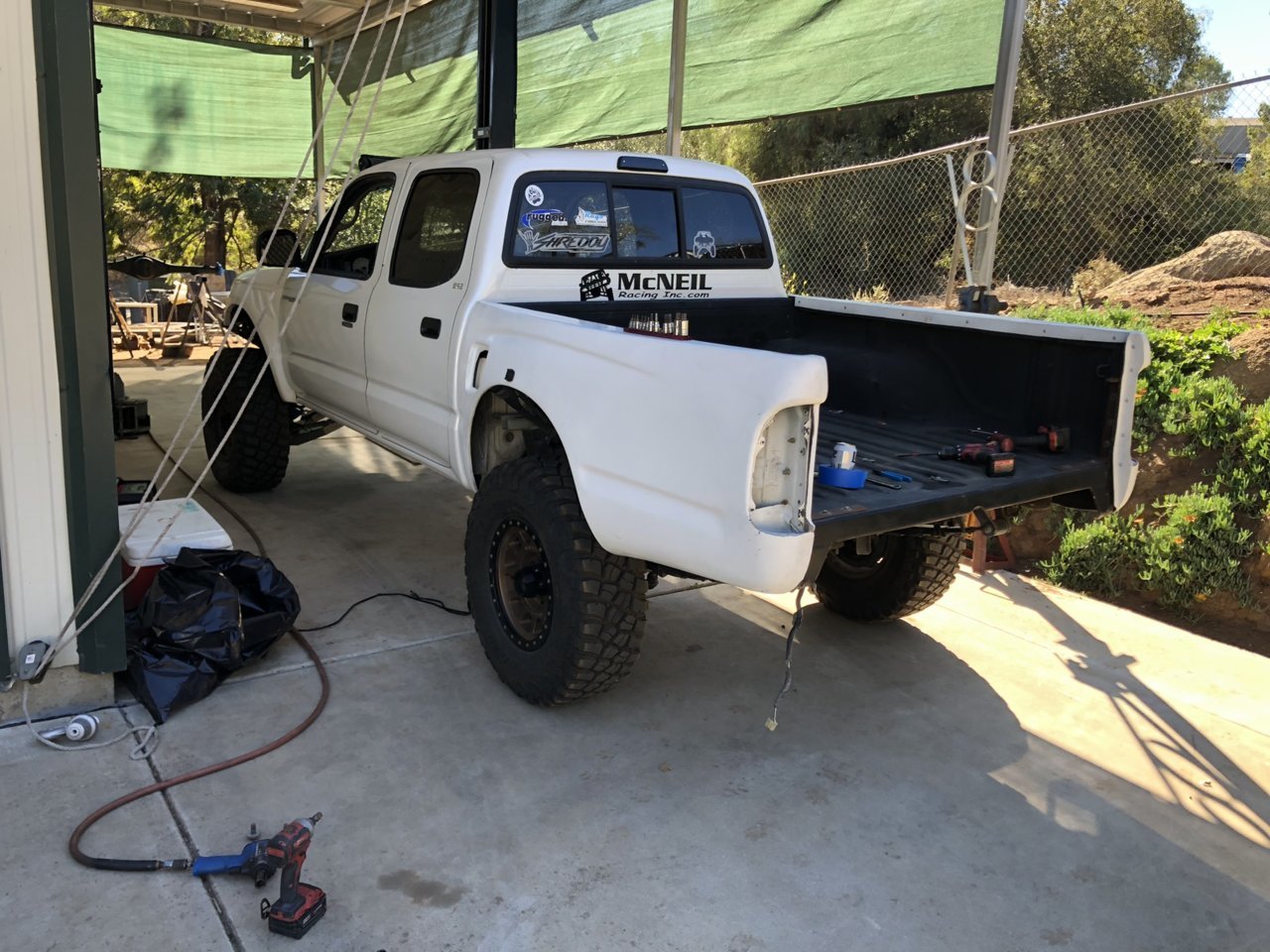

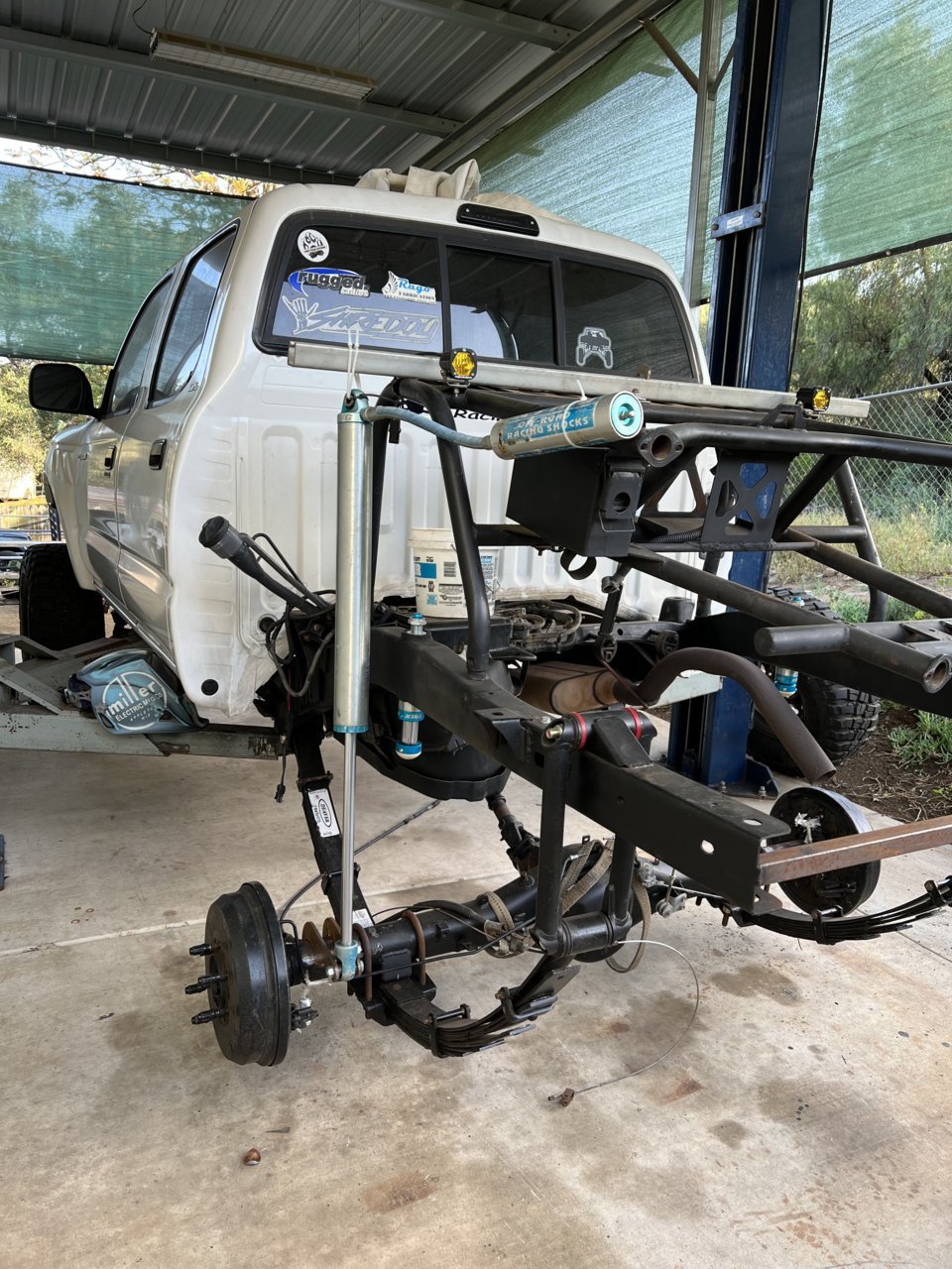

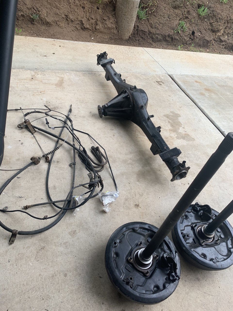

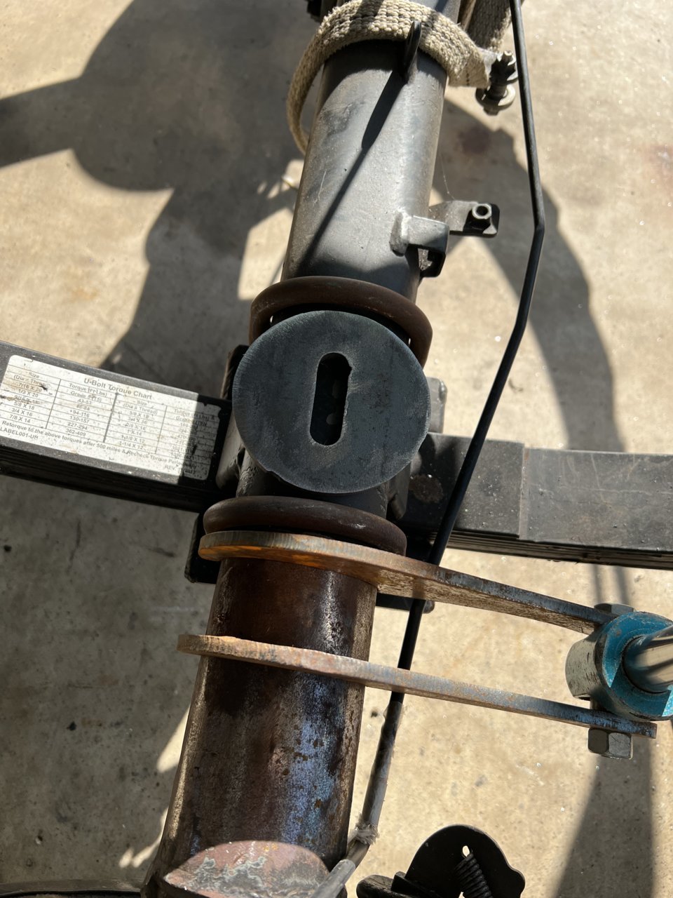

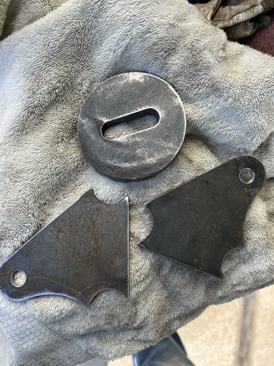

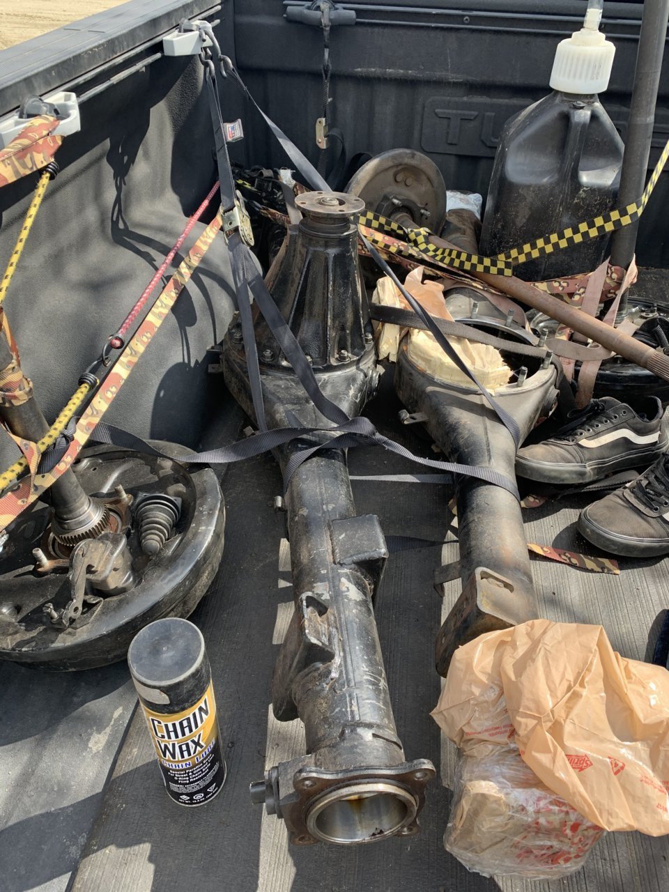

    Haven’t signed on the forum in like 8 months.

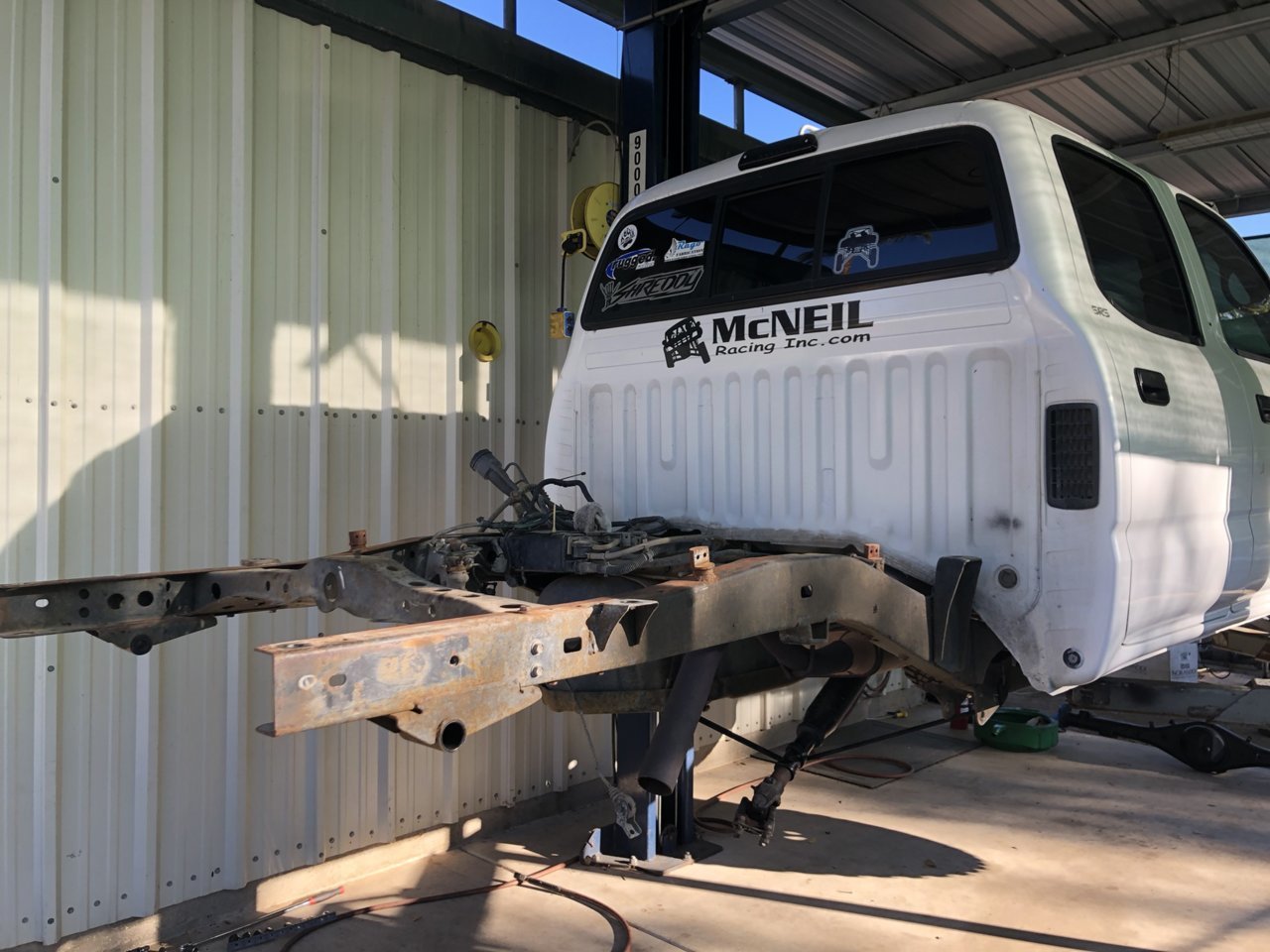

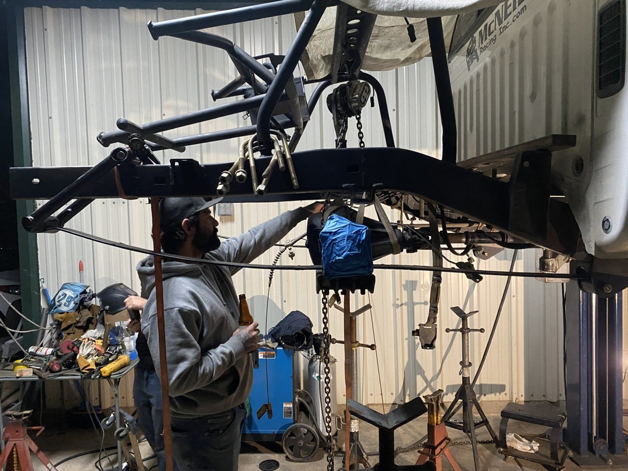

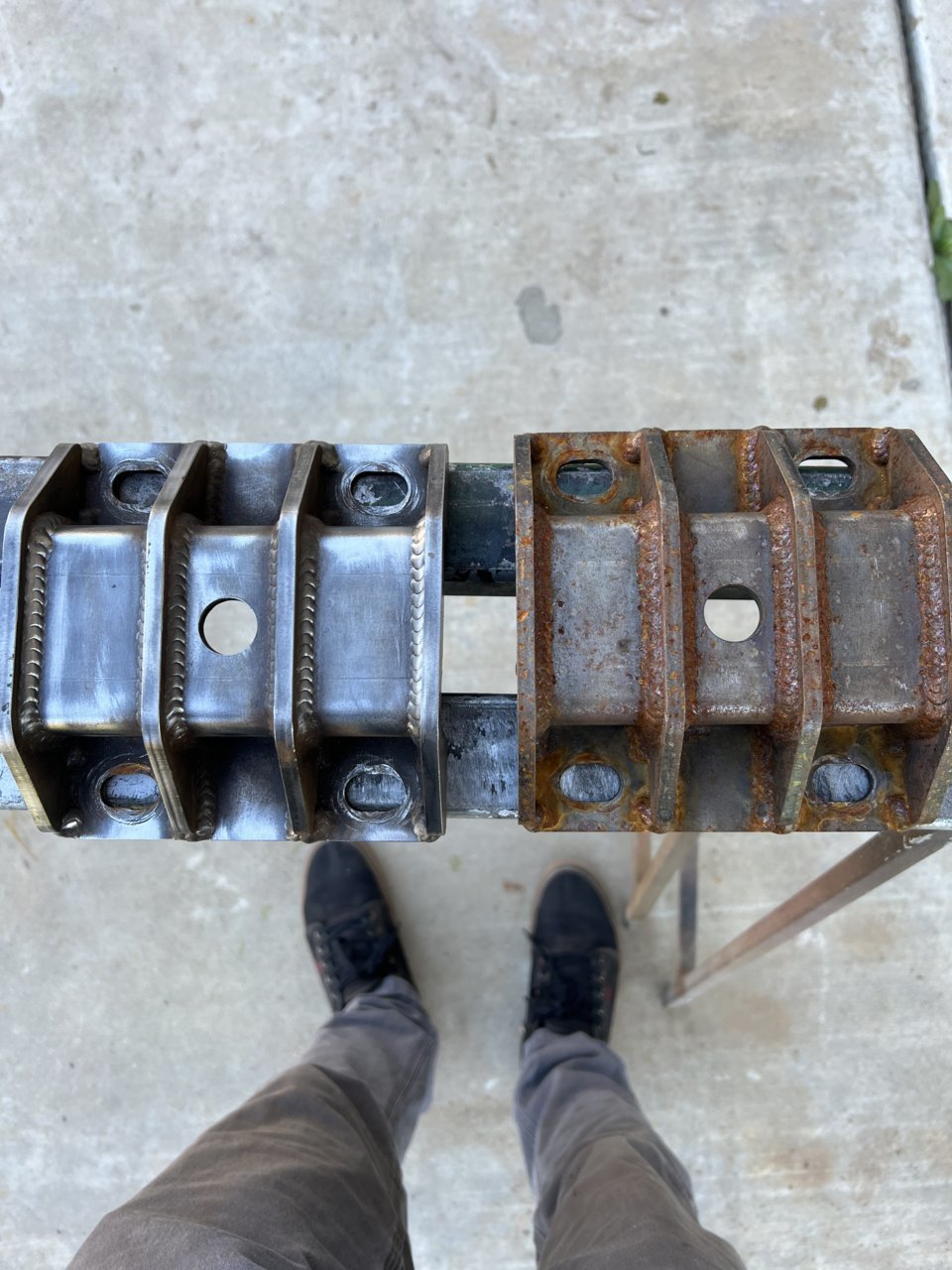

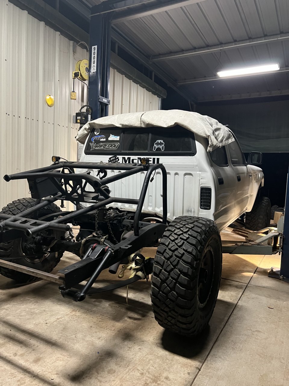

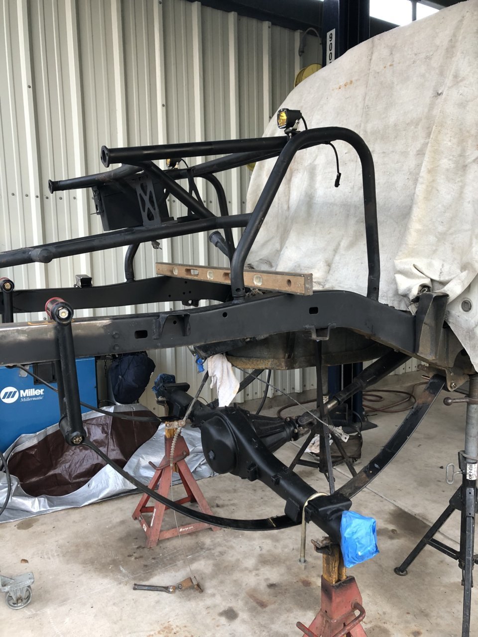

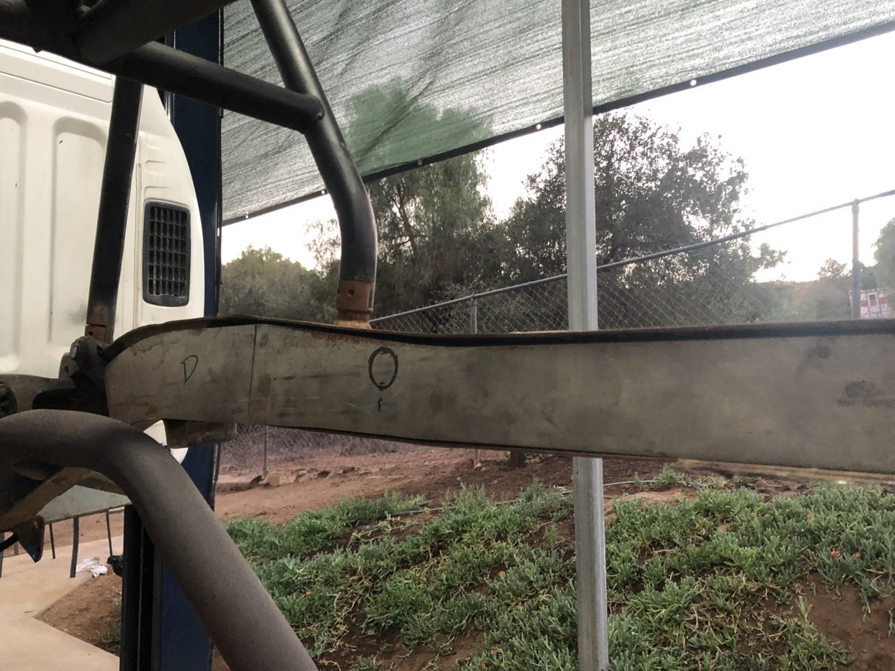

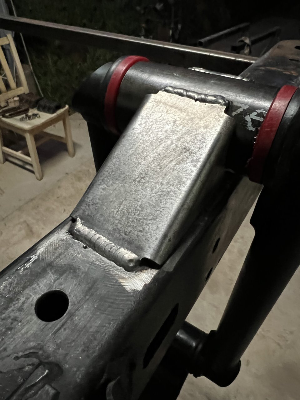

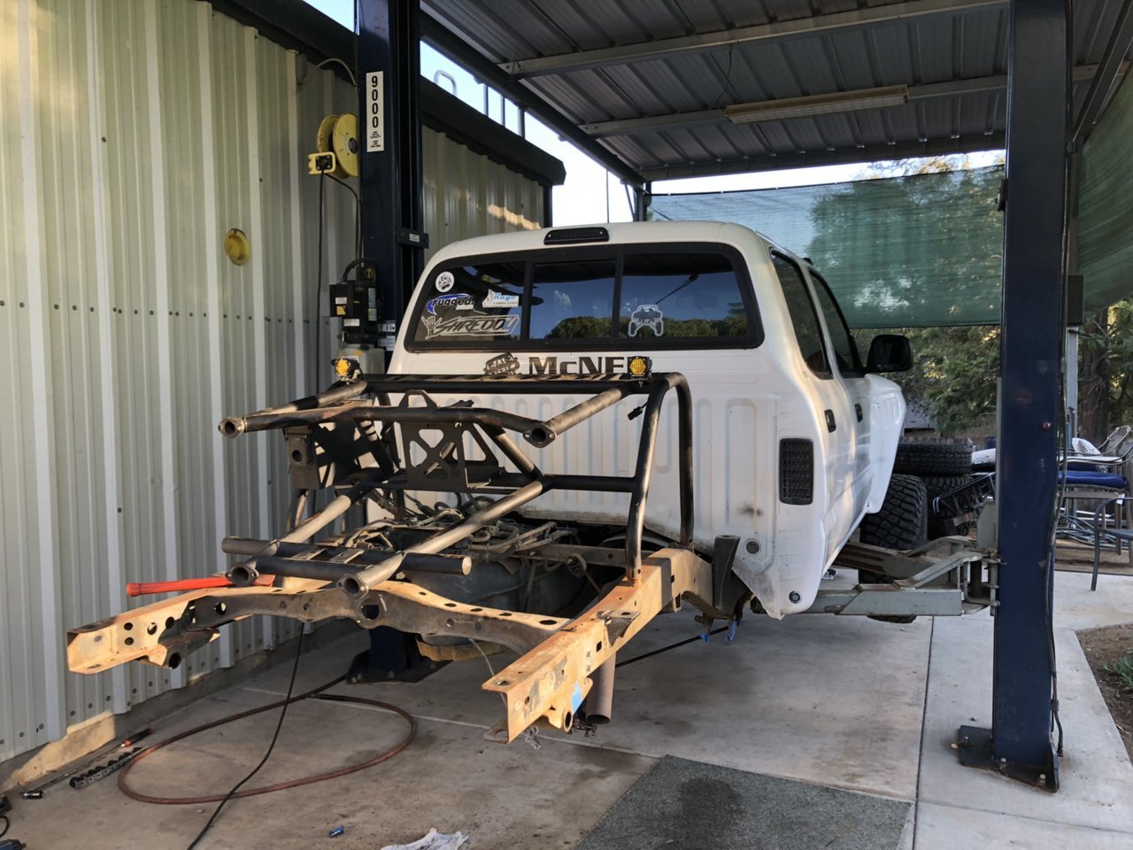

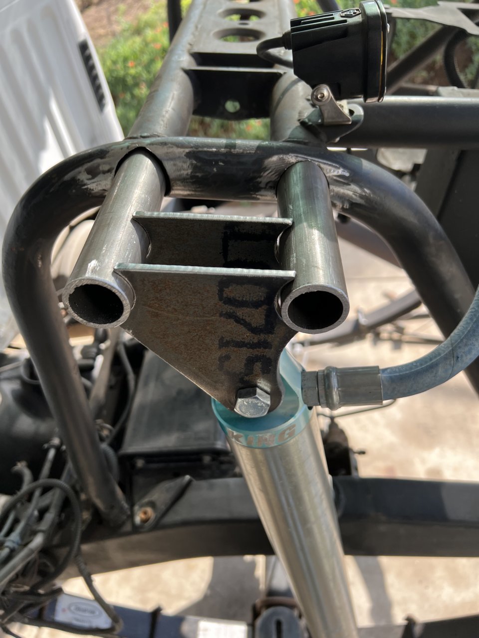

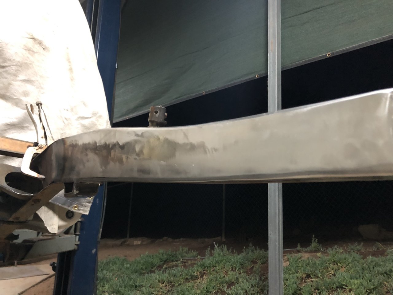

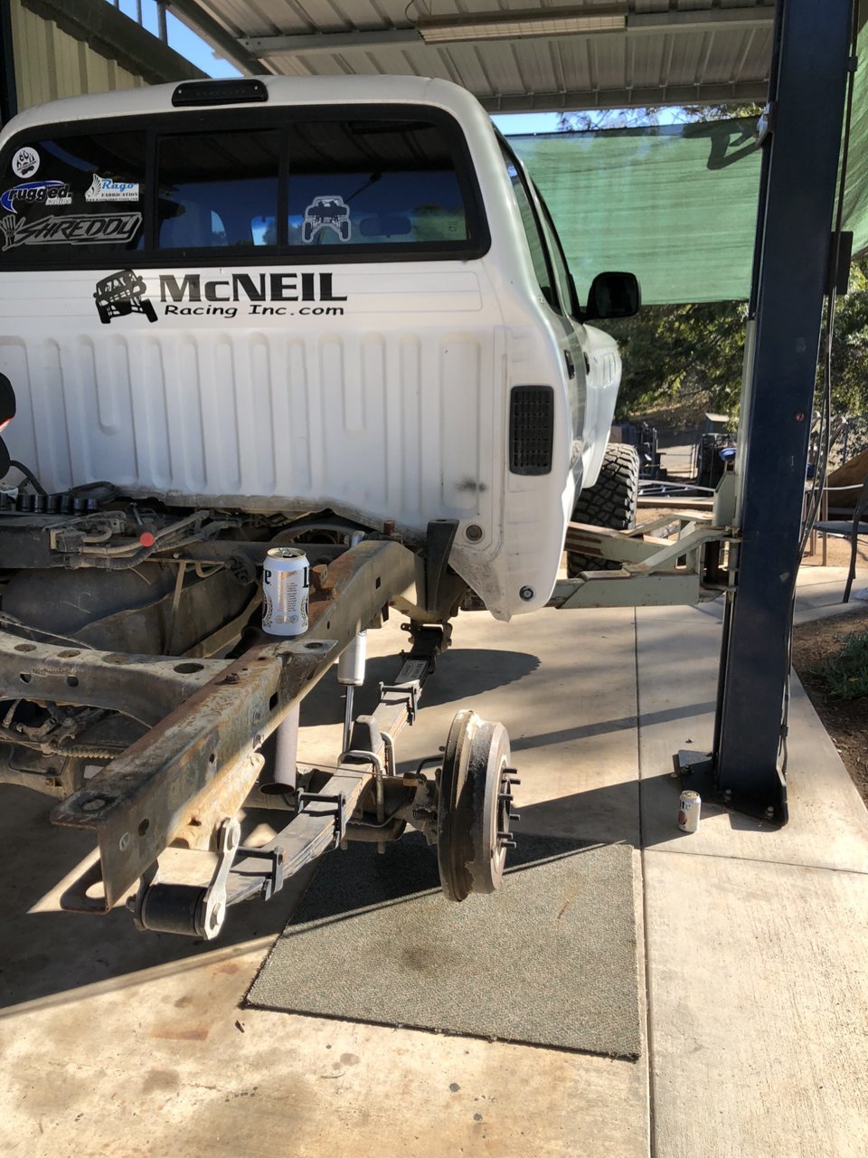

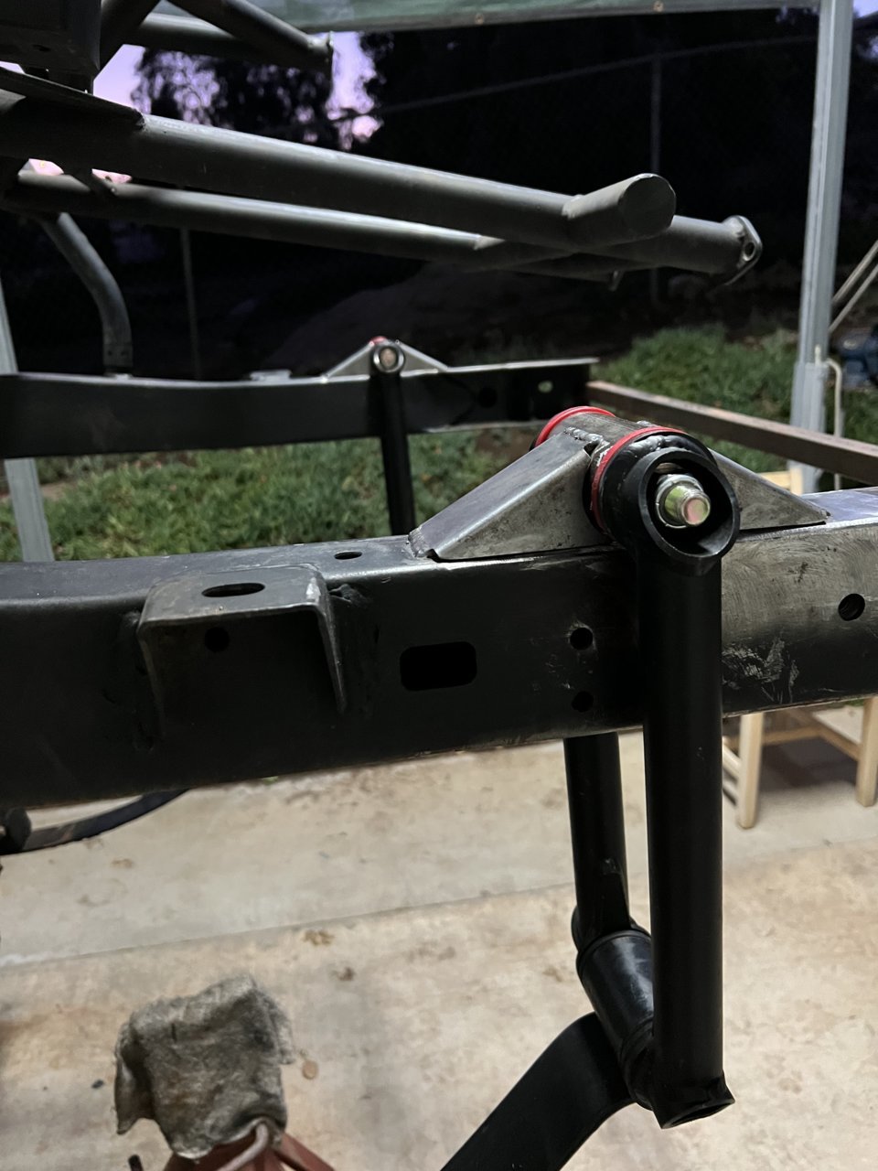

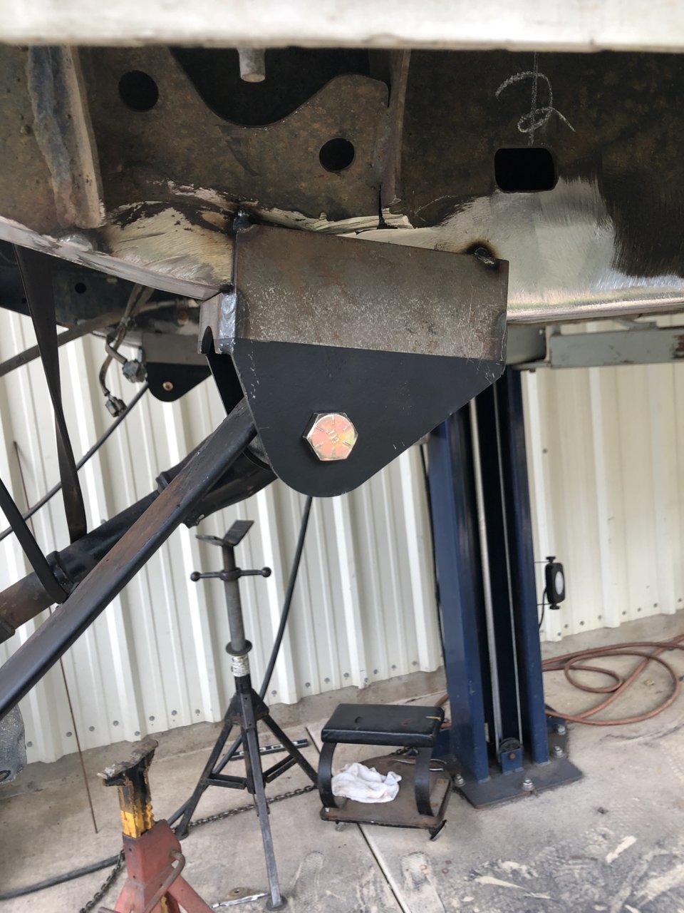

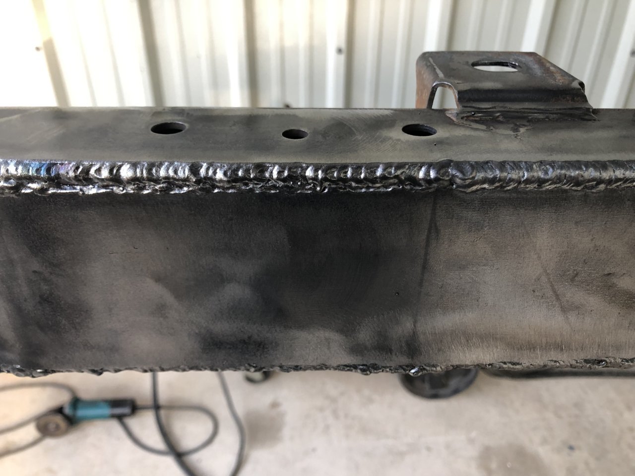

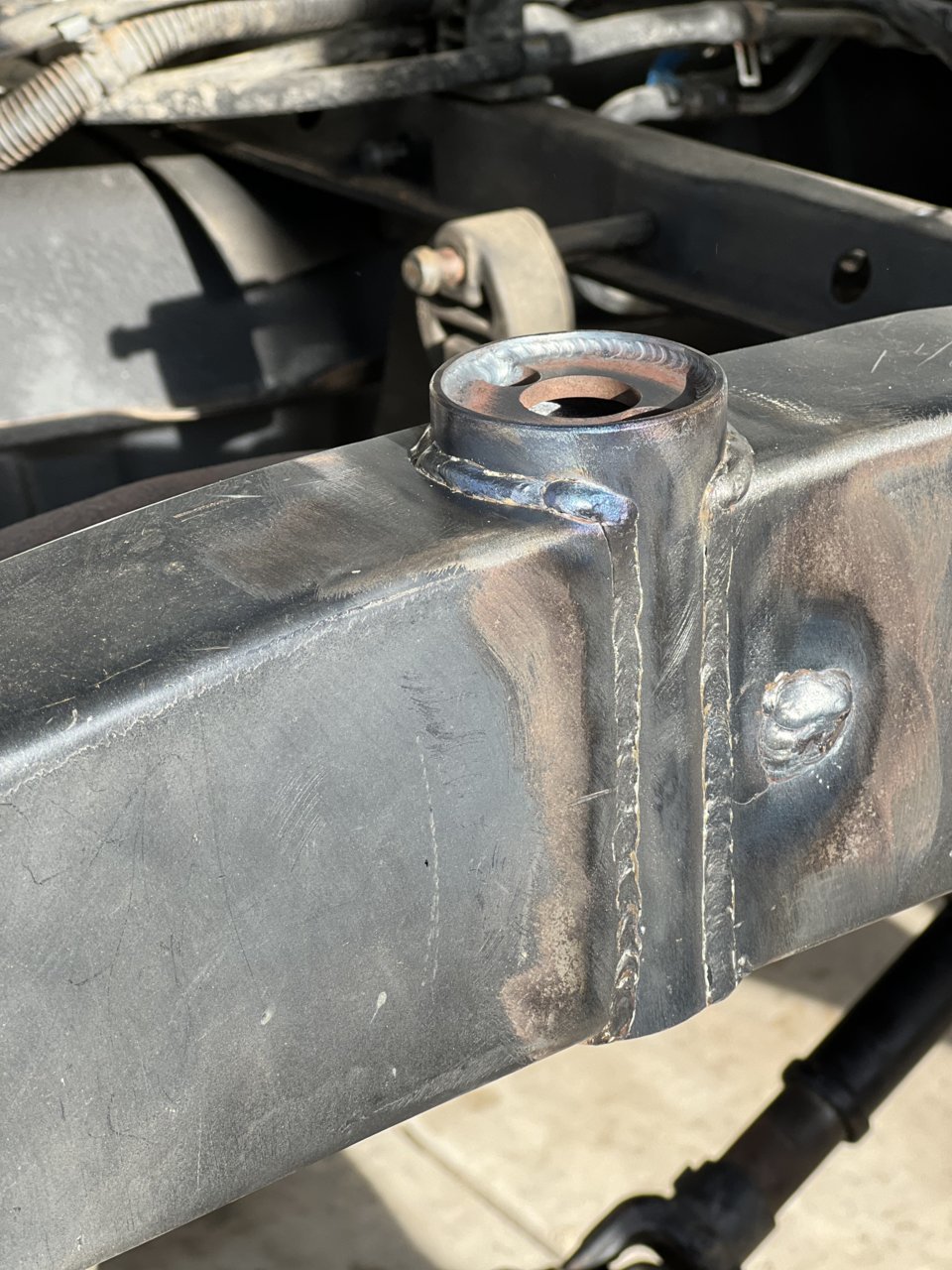

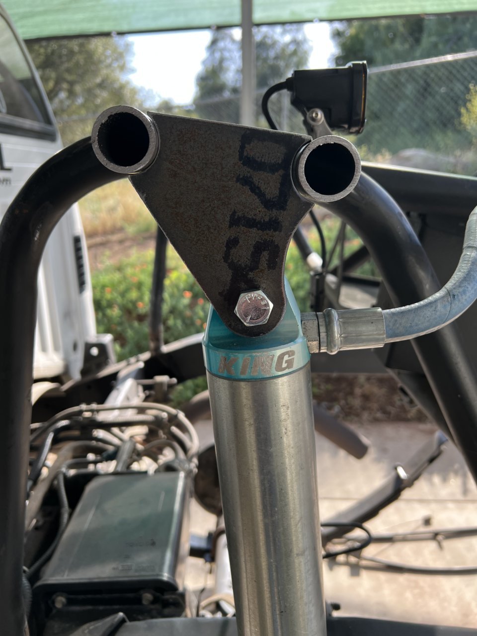

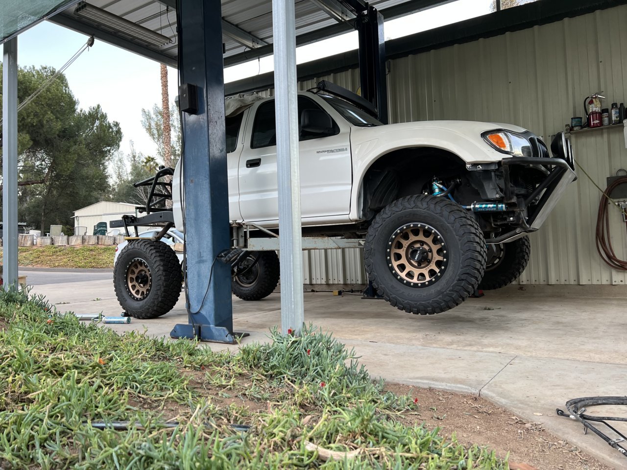

    figured I’d do a photo dump of what I’ve been doing for the last 6 months.
    41626662-CD9C-439D-B535-93E8E2F3ECC1.jpg 757666E5-FE39-4FA6-949A-C3C448C43835.jpg 7F97F2BF-F5B0-4783-9C66-AD82AE51DC16.jpg EC2673E7-AD93-46C5-A1EE-8CEB72CF3FF1.jpg 916E6022-2746-457E-9E75-823597627435.jpg D106362F-519A-4A34-8FED-723DD20C5167.jpg
    D406E2E8-4F77-4DFE-B8A0-4CD36A211E62.jpg 6A71E480-0E5C-4CC8-B574-C57CC3345644.jpg CEEDA385-0B0C-4893-AAAB-6665EBFE50D8.jpg 02A2B122-2230-4590-A10E-B80FEFF2A5A1.jpg 6CBC24DA-39E2-4AB2-A011-E0E790EE1CC6.jpg D2ED35F3-7B9C-4AA6-99F3-B1608A216073.jpg 478B74F0-6FAC-4072-8494-7951879BF701.jpg AE6095C2-B5AA-49DA-95EA-9CDF8B672029.jpg 4A3349BE-DEFF-4B4C-A93F-C19A2117CBD9.jpg 2FECC774-412D-459E-9F98-69D656BD351F.jpg 7140C398-823D-4E95-9F28-74422B902C45.jpg 9D57C86E-D7DE-4C37-B55A-D7A1D26EE276.jpg B06114EA-2185-4DB1-A50C-679EE0A7DF12.jpg FA6E5017-E1CA-4DC5-959F-3791D37213FE.jpg DFDF0826-C1AB-42D6-AE44-1803CE4CB828.jpg BB0EB858-2BC4-47BE-8E81-EEF841CC0E77.jpg DEEFE9C7-D6E7-42B3-9927-BDE772A78011.jpg 1BBD6468-8E8A-4F35-B340-71C1B2FBEF2B.jpg

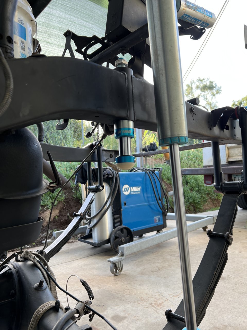

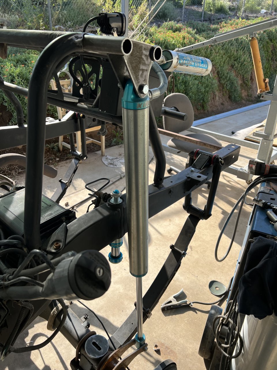

    Looks good! hows the pinion angle at bump, I feel like it could go up a couple degrees to make the droop angle better?

    so far everything has been right on the money. Going to tack everything this week (hopefully) and do a final cycle with a come along and see how she stacks up with the new shock tower design. I’ll report back with official pinion degrees

    Looks like some up travel left in the full bump pic but your spring is already negative. What's your EtE #?

    Love the frenched bump stop btw... Shit is looking good. Love the wheels too. I wish I had that BIG STICK MONEY...

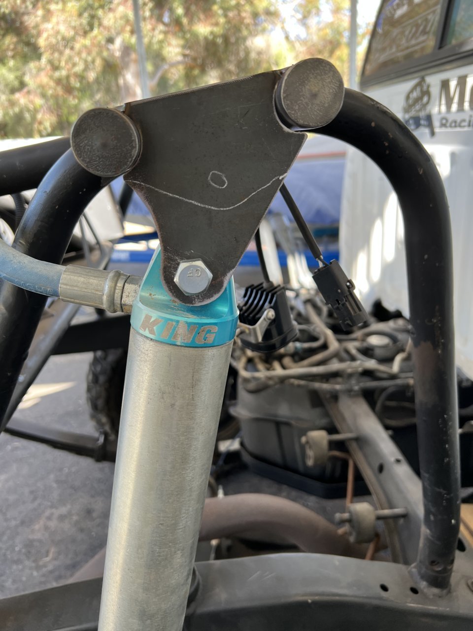

    Going to have to make some changes unfortunately. Not happy with the shock set up.

    What about it dont you like?

    Shocks are mounted to low. Bump stops not running full cycle before shocks bottom out
    BrownMike[QUOTED] likes this.
