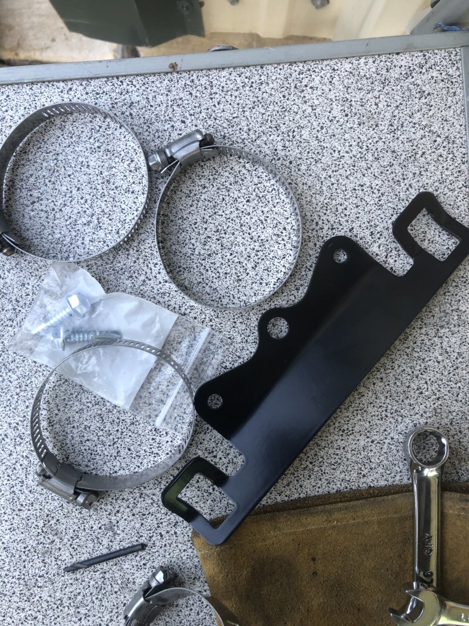

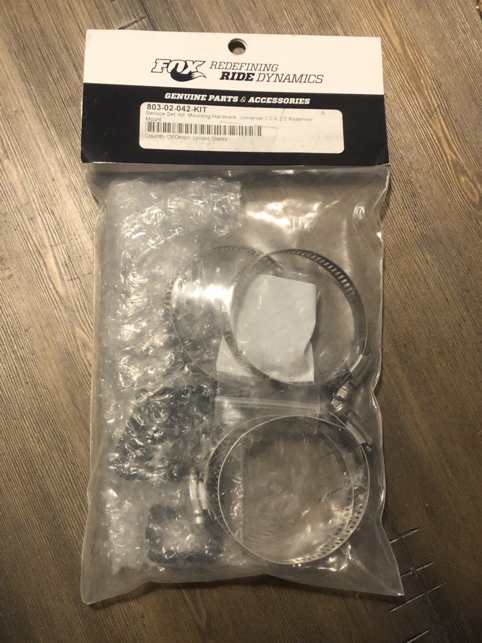

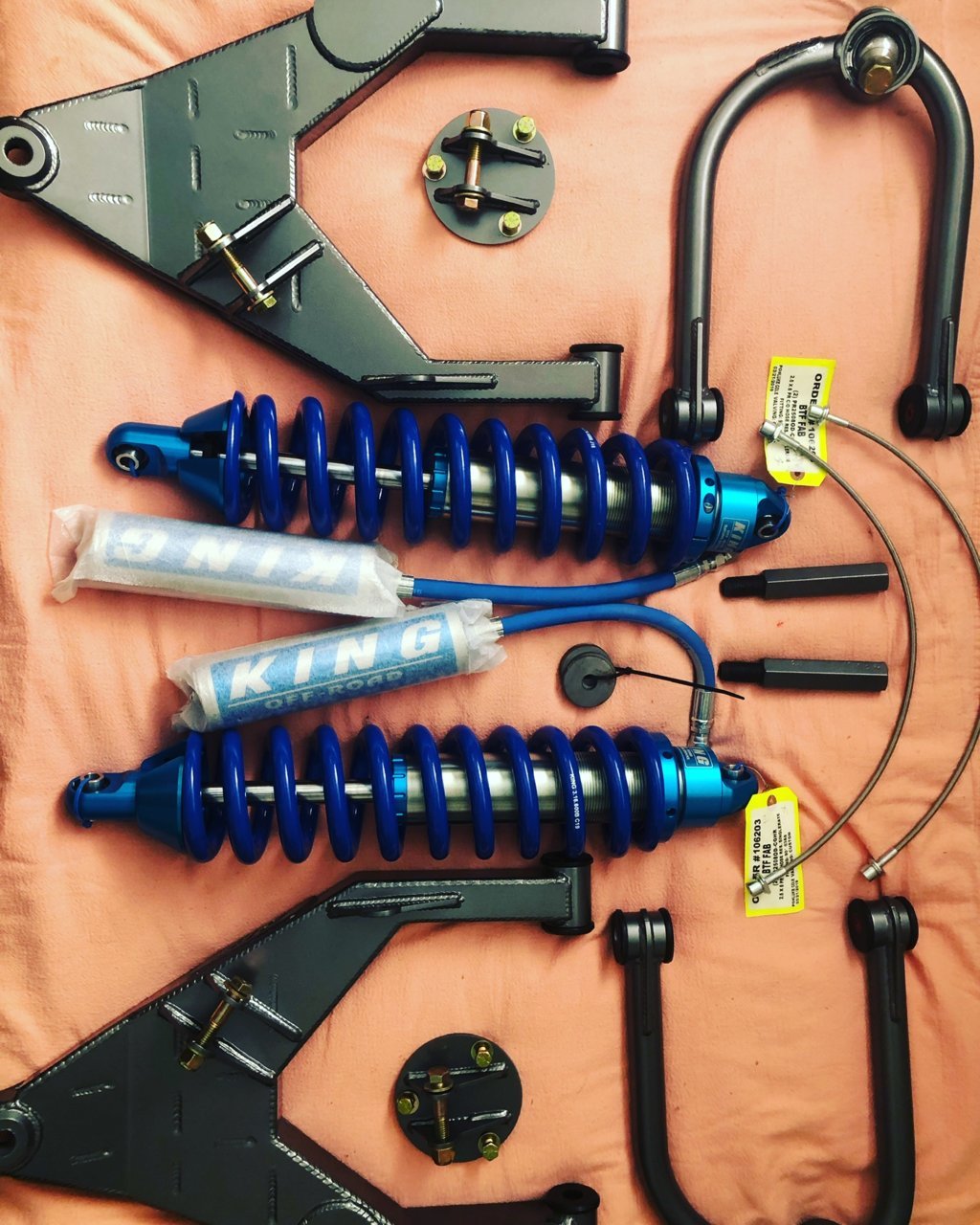

    Resi mounts got delivered.

    What lower control arms are those? Are they the solo motorsport stock length control arms?
    LukeCC[QUOTED][OP] likes this.
  4. Sep 10, 2019 at 10:09 AM
    #44
    LukeCC
    LukeCC [OP] Well-Known Member
    Mar 13, 2017
    #213229
    2,445
    Luke
    Southern California (East County)
    2002 LT DCSB
    BTF 4.5 Long Travel Kit

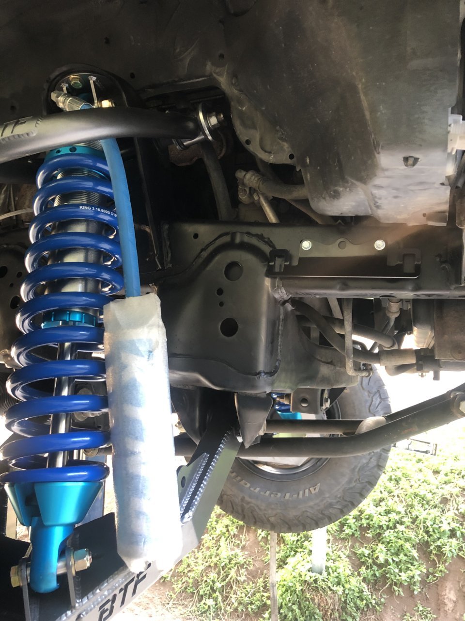

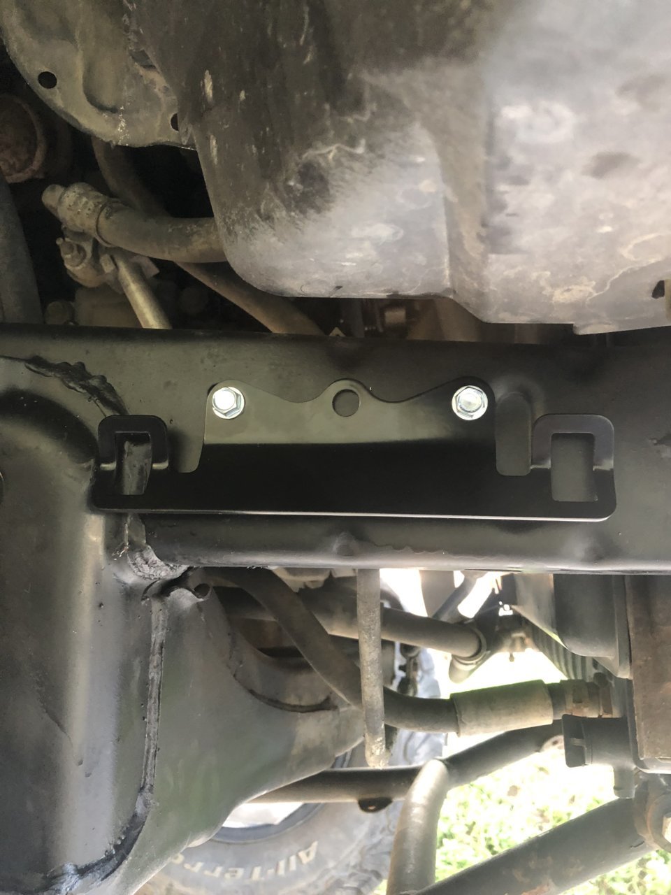

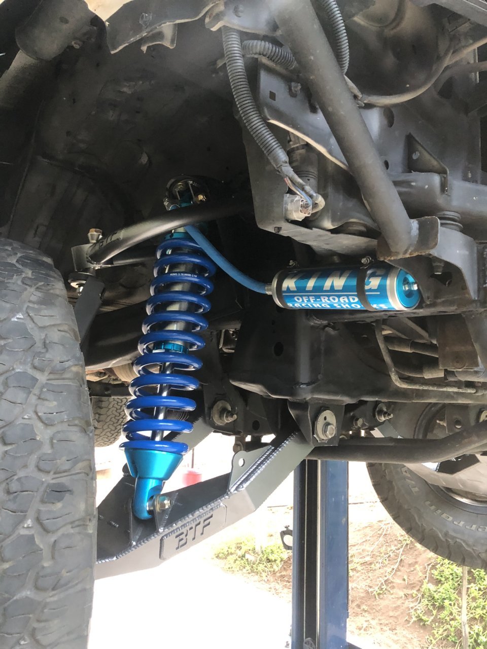

    4C0657FB-2FCC-4DEA-8D71-FEE04791DC8E.jpg B23B65F4-F8CF-439B-86D0-3A7D4F2CB748.jpg 73B2A65E-AF2B-4FF7-821D-6CEEF69EDEA1.jpg ADA8B805-4524-4E3F-B175-FD78828A3ED9.jpg
    Got the cans mounted with the fox kit after work tonight. Really nice for a bolt on resi mount. Clean and tucked away nicely.

    Nice build!
    Does this kit resuse the stock lbj or are they upgraded to uniball? I looked at their website but didn't find any mention of the lbjs.
    Thanks.
    LukeCC[OP] likes this.
  17. Sep 12, 2019 at 11:37 AM
    #57
    LukeCC
    Mar 13, 2017
    #213229
    2,445
    Luke
    2002 LT DCSB
    Thanks dude.
    It uses the stock LBJs. Doesn’t convert the lowers. I replaced my LBJs just because I was there but no, it’s not uniball lowers.

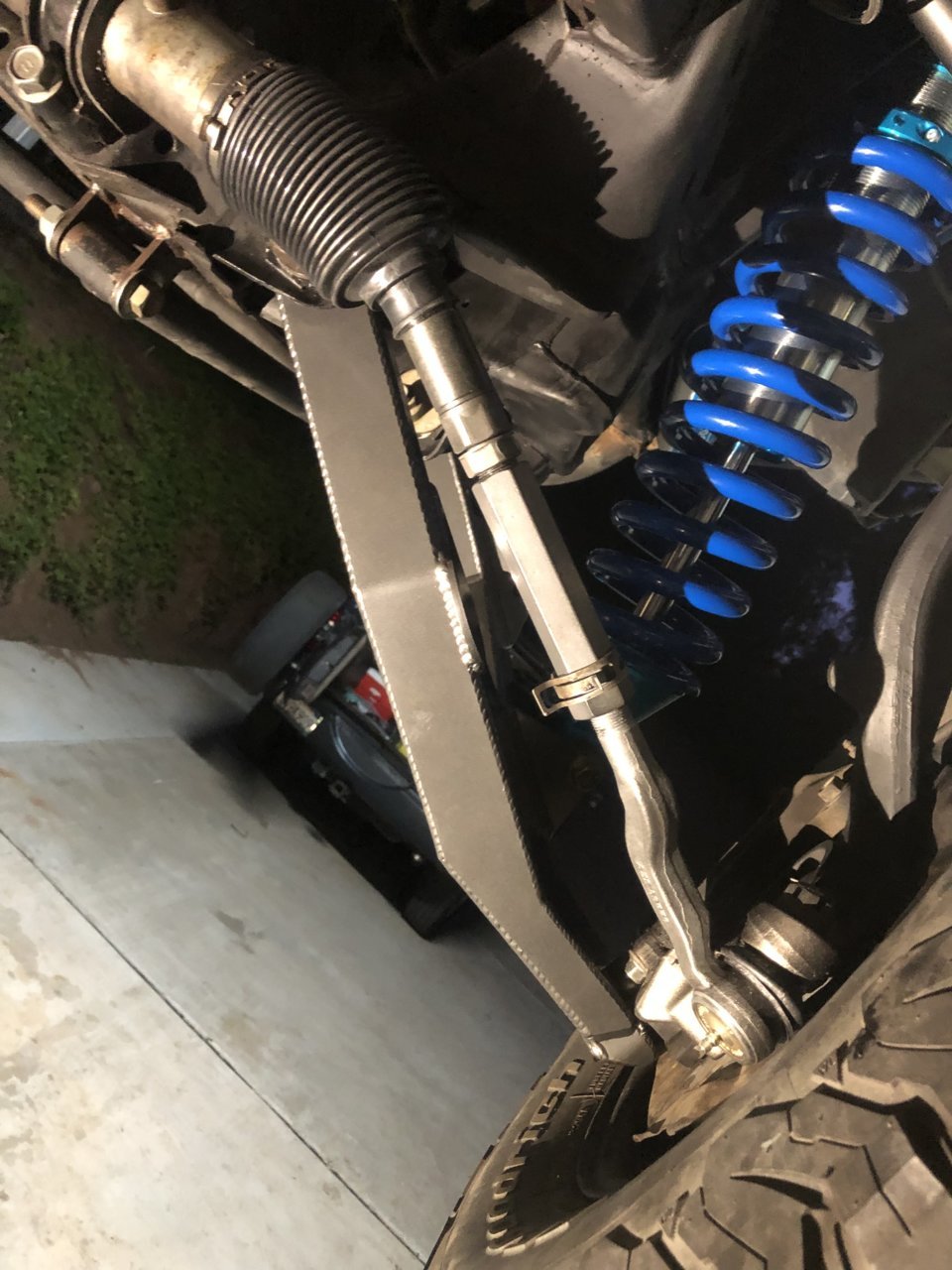

    Installed new tie rods with extensions.
    Steering rack boots.
    Installed upper part of brake lines.
    Need new banjo washers to complete brake line install. Gunna hit autozone in the morning and try and get this thing wrapped up before lunch tomorrow.
    Once the brake lines are installed and bled just gotta grease some fittings and give everything a once over then I’m good for a shakedown.
