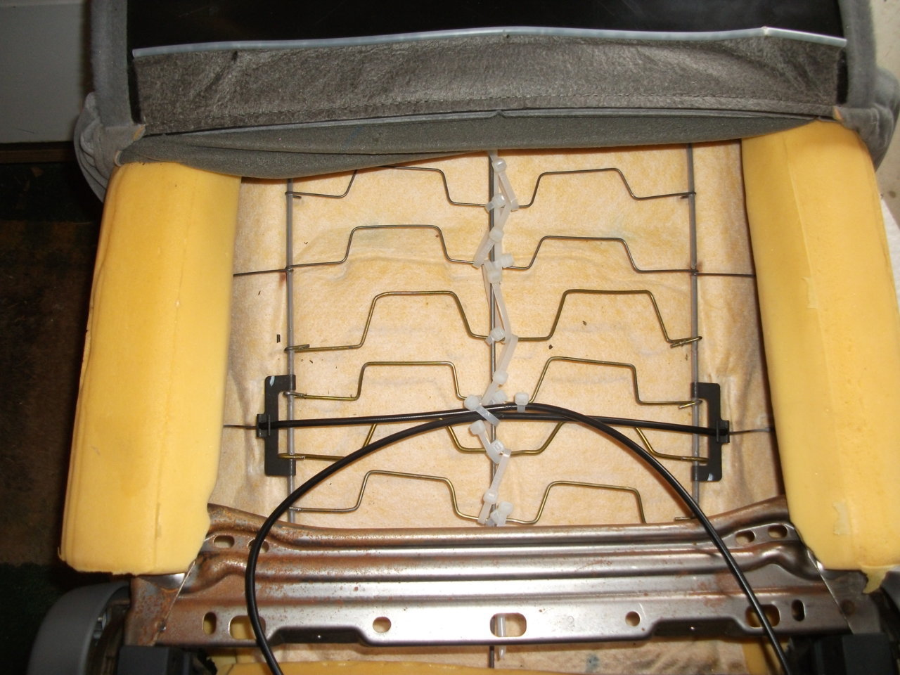

    Hey dudes i think i have an answer for you, similar issue happened in my third gen but the system is the same so i would assume the problem is as well.
    My lumbar used to work but has since stopped, dissasembling the seat shows wires that tighten the lumbar area with the adjustment knob. These wires are way too fragile, and snapped on mine. I plan to replace them, ill let you know if it works.
