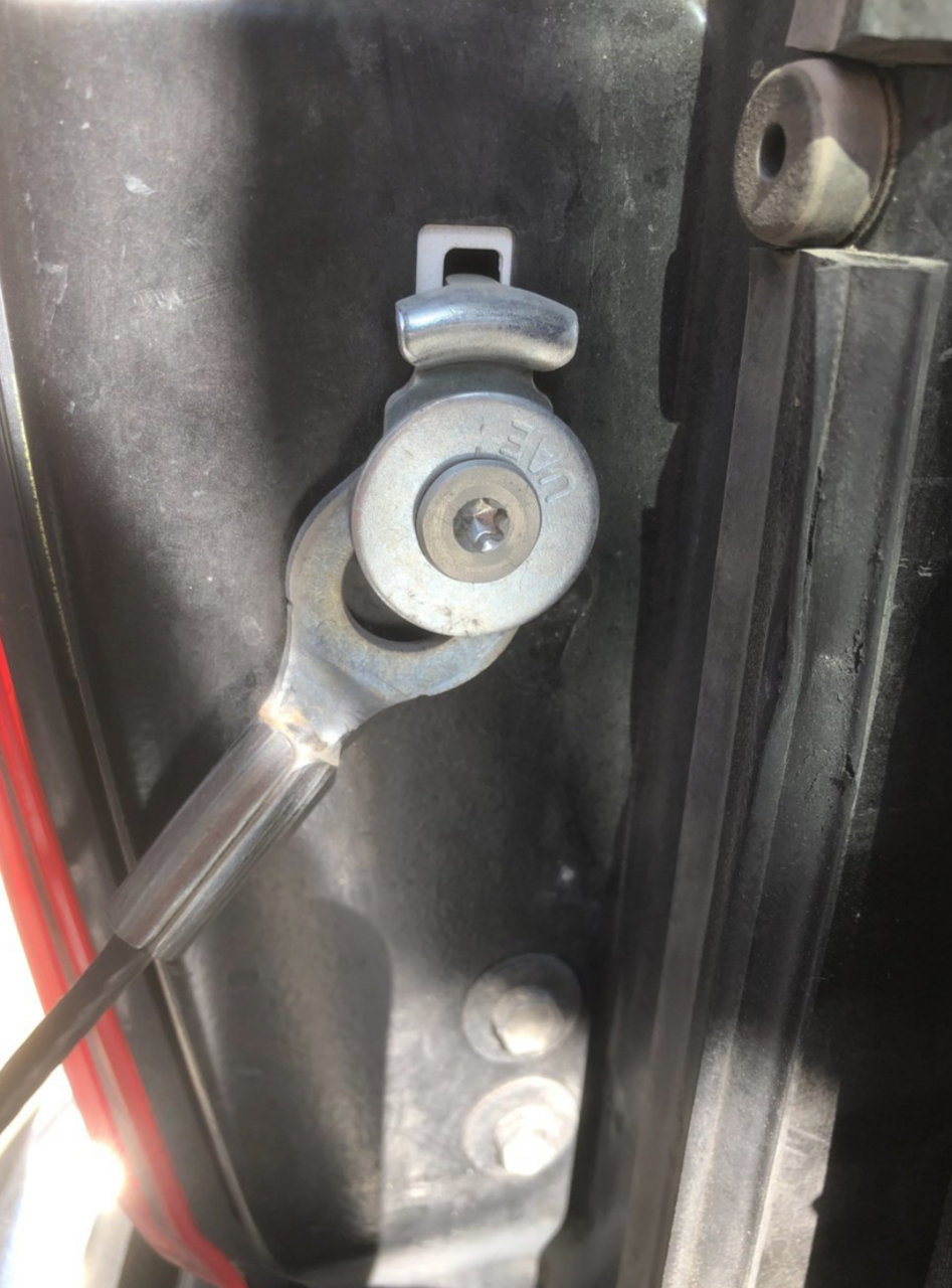

    In addition to the hinge and tailgate lock, put a thick fender washer with a spacer on the bolt that lets the two tailgate support cable eyes swivel but not slip off:638CA47C-D5A8-4E3C-BDD5-206269433B89.jpg
