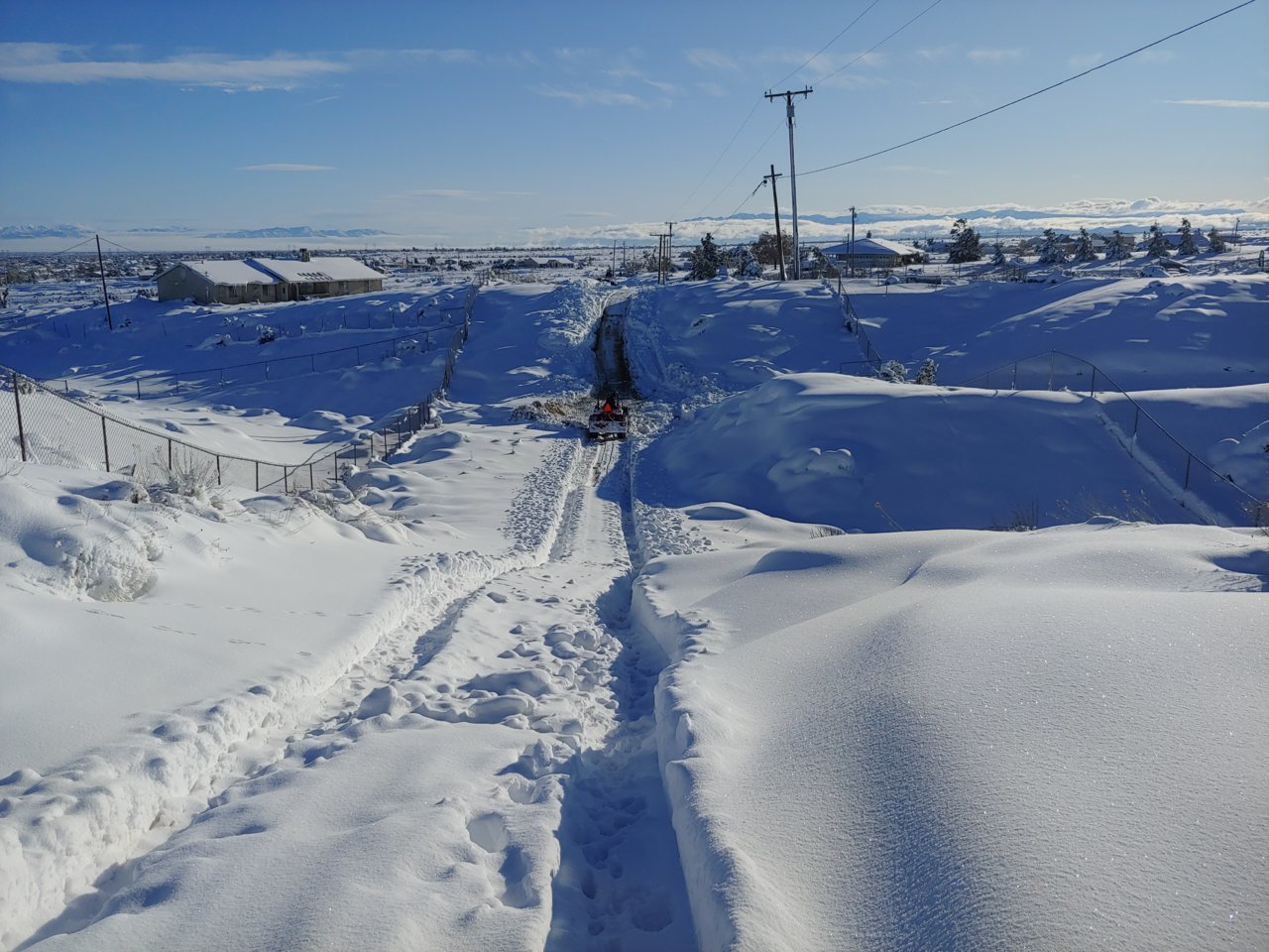

    20191227_083428.jpg This was the day after Christmas. Kinda wish I had a locker then.

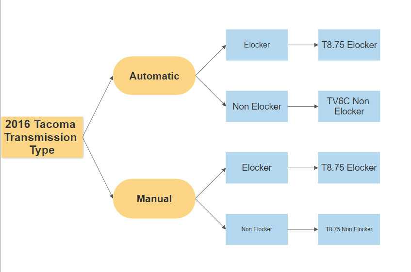

    3rd gen Tacoma has 8" front clam. Depending on which model you have will depend on the rear diff. This chart will help.

    I have the long bed V6 Automatic.So an TV6C rear and 8 inch front then.
