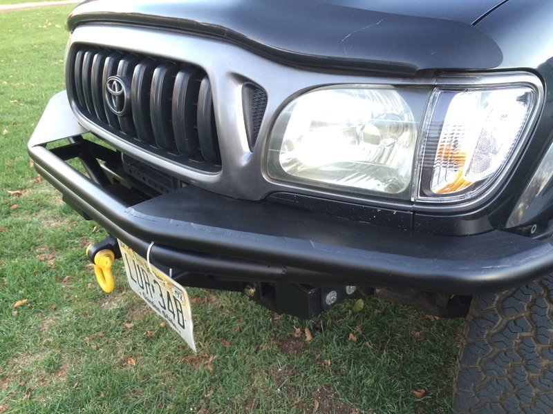

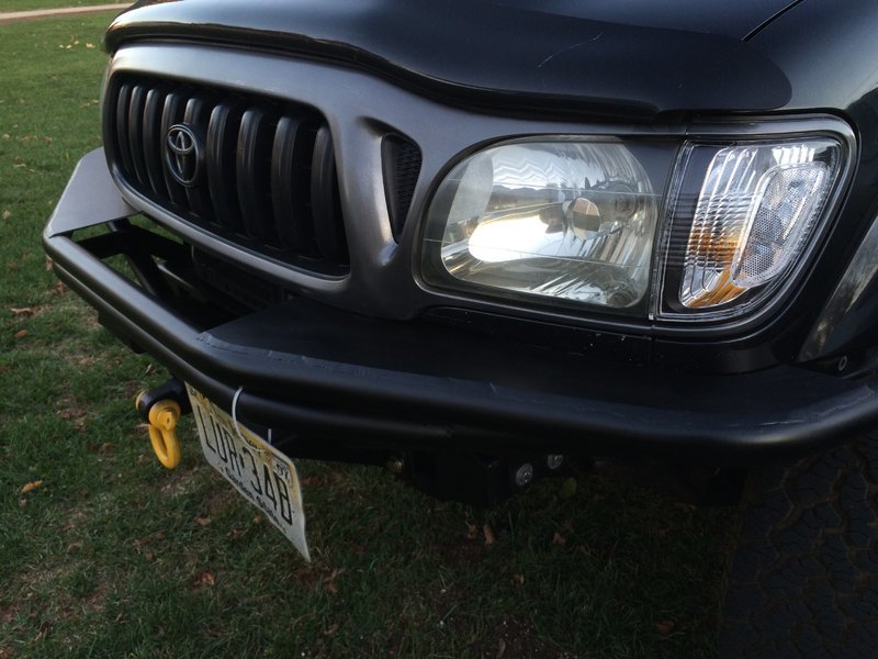

    Alright, got a new bumper and put everything together. It was apparently a returned bumper and had hardly any damage, cost me $150, not too bad. It did get a bit scratched up in shipping but I'm not complaining, looks great. Wish I found a decent aftermarket bumper I liked but oh well, Ill get one later down the road I suppose.

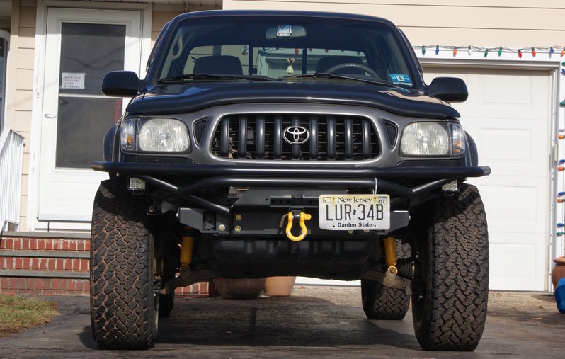

    alright, couple of updates for you guys,
    Got my Trail gear Low profile front bumper a couple weeks ago. The frame was bent where that stupid tow hook thing is so we had to heat that red and bang it back in place, then I had to kinda drill out the outside a bit so I could fit a bolt in there. primed it with self etching primer and painted it satin black. then Changed diff oil for the first time in like 100k miles.
    made a little mount for my new wilson flex antenna, its bolted behind the tie down point on the passenger side.
    Painted my grille duplicolor gunmetal gray, same paint as my wheels, came out nice.

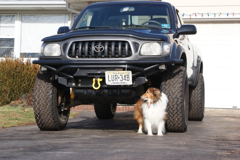

    Bought a front hitch and D-ring for about $25, then had a little photo shoot in an empty lot nearby.
    painted my D-ring with some tractor supply yellow paint that matches the old man emu yellow surprisingly well cost me something like $8 a can though, then went to New York City the next day.

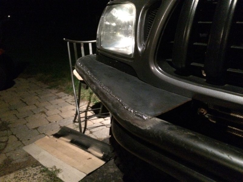

    last weekend I picked up some 1/8" steel for about $25 to start plating the top, traced it all out on some cardboard first then cut using an angle grinder, wasn't fun and took all day. Finally got them done just gotta clean up the edges and do some minor adjustments to make them fit nicely. Ive been a bit sick lately so when Im over it Ill be welding it all up and then I might put my lights back on there.

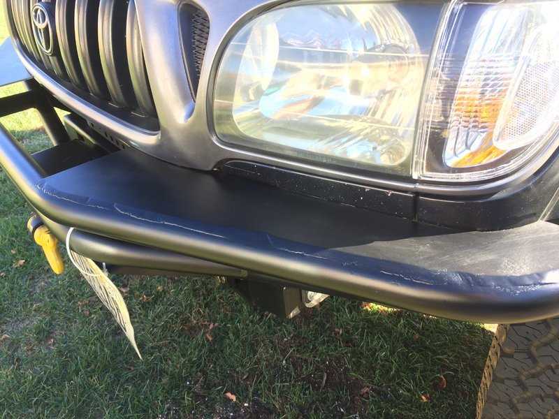

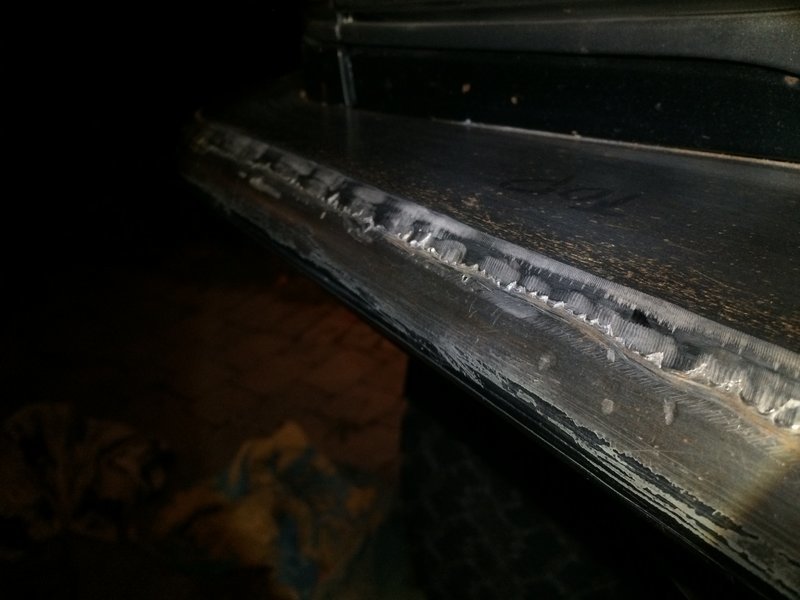

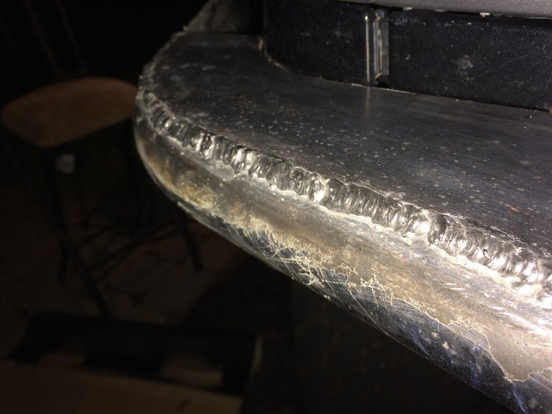

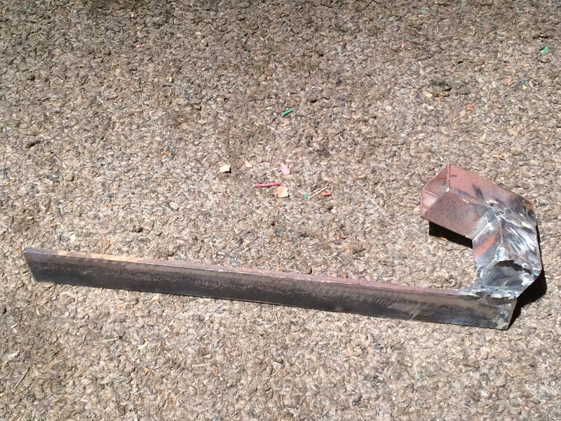

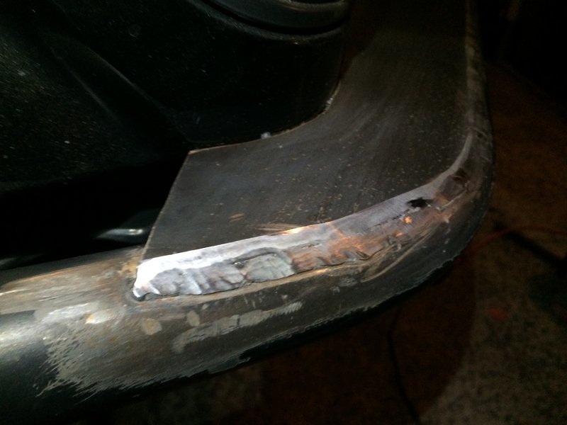

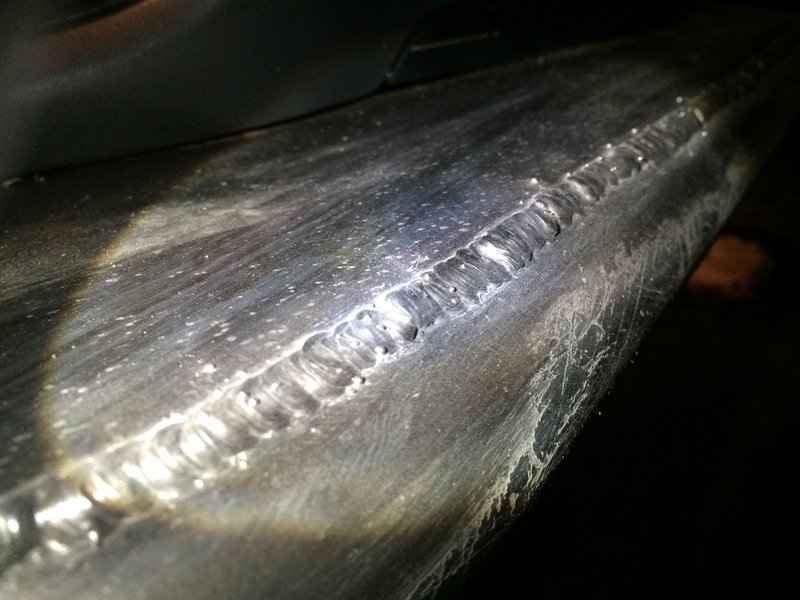

    Finished plating the top of my bumper awhile ago and never updated the thread so heres some pictures. The welds weren't fantastic so I went at it with the angle grinder to try to get it to flow better and made some decent gashes in spots but looks alright I think.

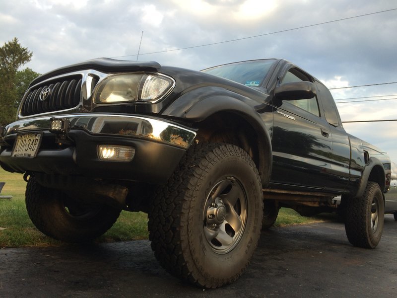

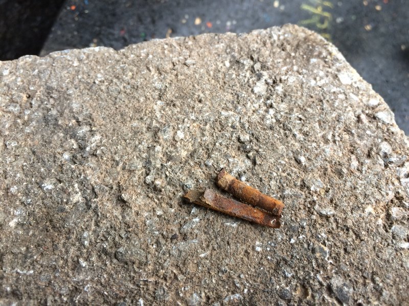

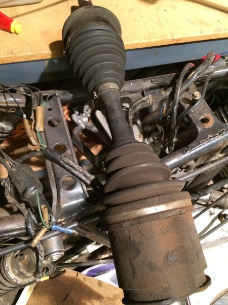

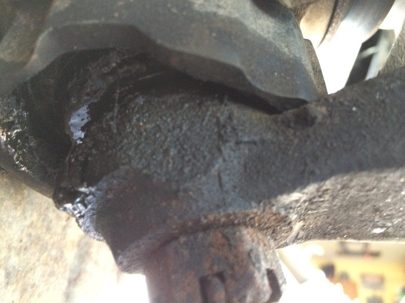

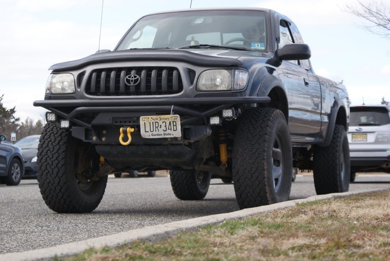

    Updates:
    New Lower ball joints

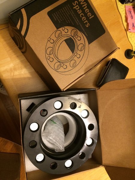

    Spidertrax 1.25" Wheel spacers
    ebay LED flood pods
    Pinch weld mod
    Out with the old / In with the new
    what was left of the cotter pin..
    leaky ball joint

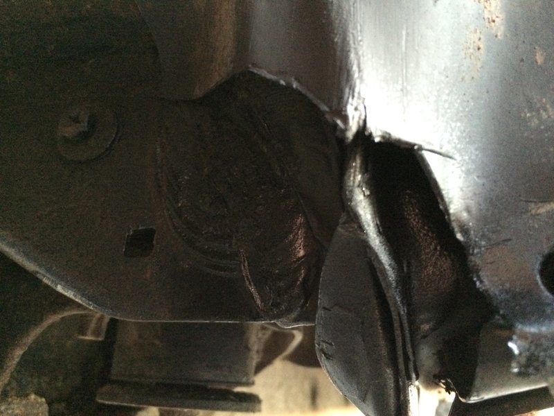

    Here you can see where the tire was rubbing the frame, really badly :eek: (nobody listens to me when I tell them DONT go full lock)
    These should fix it!
    Spacers caused more rubbing on the pinch weld so I bent it out of the way and cut some plastic, needs to be cut more however.

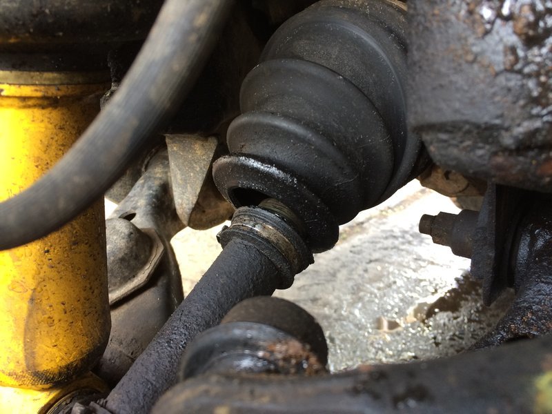

    Still haven't fixed that CV, heres a good shot of it torn open, all the grease is now completely gone
    Picked up a new one today
    Also bought some LED flood pods and made this bracket to mount them on
    Recent pics with most of this done:

  19. Jan 29, 2017 at 5:45 AM
    #39
    04yota
    04yota Well-Known Member
    Mar 12, 2014
    #125177
    1,220
    Angelo
    Central New Jersey
    04 ext cab supercharged 5speed

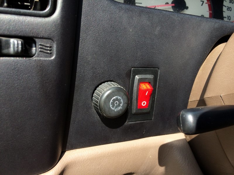

    Good work man, where did you put the switch for the pods?
    #39
  20. Jan 29, 2017 at 8:19 AM
    #40
    Lux
    Lux [OP] @jamesgrouss
    Sep 15, 2014
    #138357
    2,880
    James
    NJ
    2001 tacoma sr5 4x4
    OME 3" lift 881 coils, Dakar's 33" General Grabber AT2's TG low profile front bumper
    where the diff lock should be :rolleyes: I put both sets on the same switch
    04yota[QUOTED] likes this.
