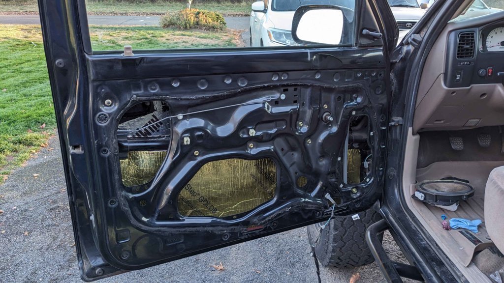

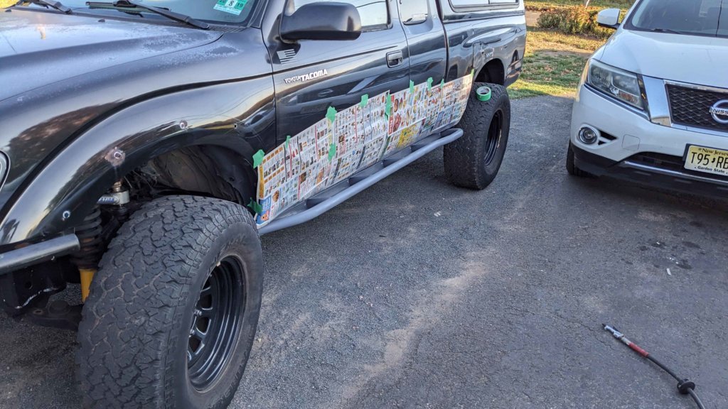

    Been awhile. Last summer I decided to try to sound proof my truck as I was getting tired of having such a hard time hearing people on the phone while driving on the highway.
    I got 36 sq ft of kilmat 80 mil and lined my doors and part of the firewall with it. Installation was pretty straight forward, I put the mat inside and marked where it had to be cut. Then I rolled it on with a sound proofing roller.
    On top of the kilmat I put quietstep gold sheets that my dad had lying around at work. Its fuzzy on one side and a foil like texture on the other. I kept it pressed against the kilmat using strong double sided tape.
    Unfortunately, I really didnt notice a significant difference after doing this, I still have some leftover so this summer I might tear apart my dash and do the firewall. The doors do sound more solid when closing and there is a reduction in noise from the tires. I think MLV would be a big help, I just couldnt justify the cost at the time.

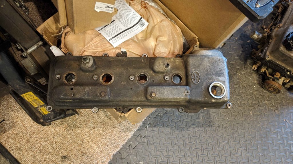

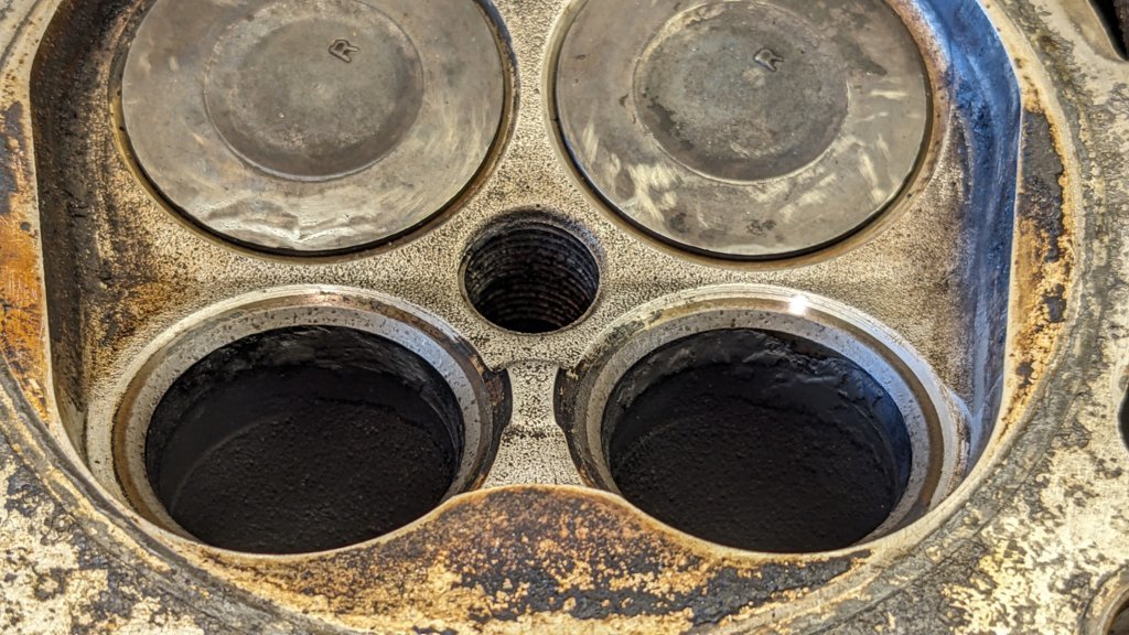

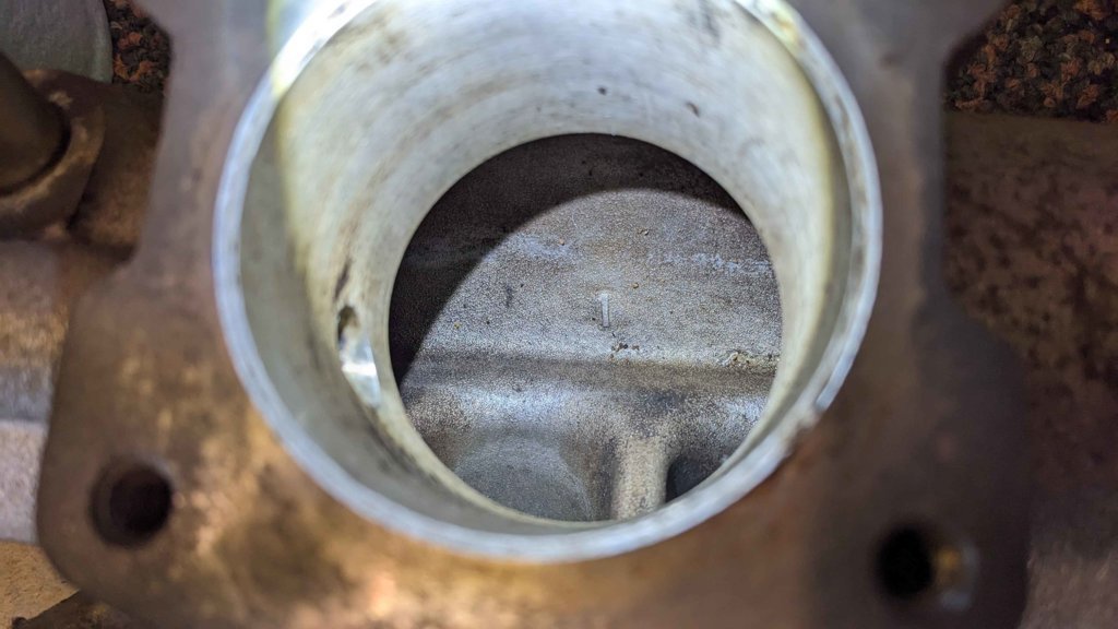

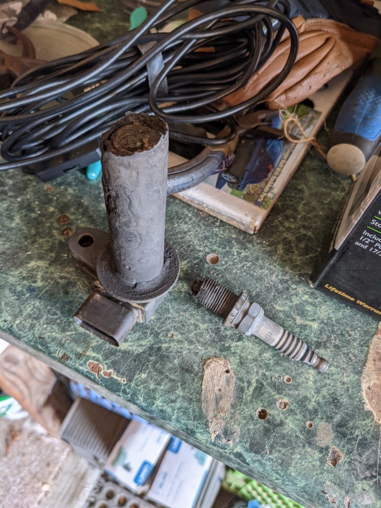

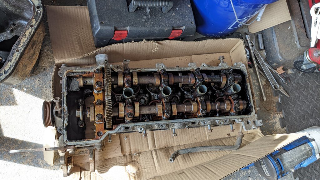

    Once the truck was home I began trying to figure out what happened. Pulled out the coils and immediately it wasnt pretty. The coil had somehow melted and half of it was completely missing, as in it was not even in the spark plug tube. I can only assume it had gotten beat up and melted into the cylinder.

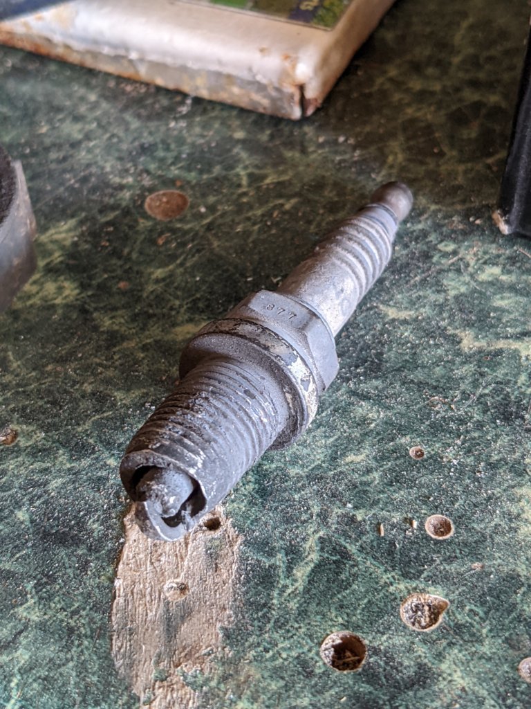

    Then I discovered the spark plug had blown completely out of the head. I have no idea what caused this to happen but it also wasnt pretty.
    The spark plug hole threads were beat up so my first idea was to bore it out and tap it for a threaded insert. It seemed to go ok and I put new coils and plugs and fired it up. It still misfired and had very low compression (I dont have the numbers anymore but some cylinders were >100 psi). At this point I didnt know what to do or what the issue could have been. I lost a lot of motivation to work on it and had gotten extremely busy between school and work.

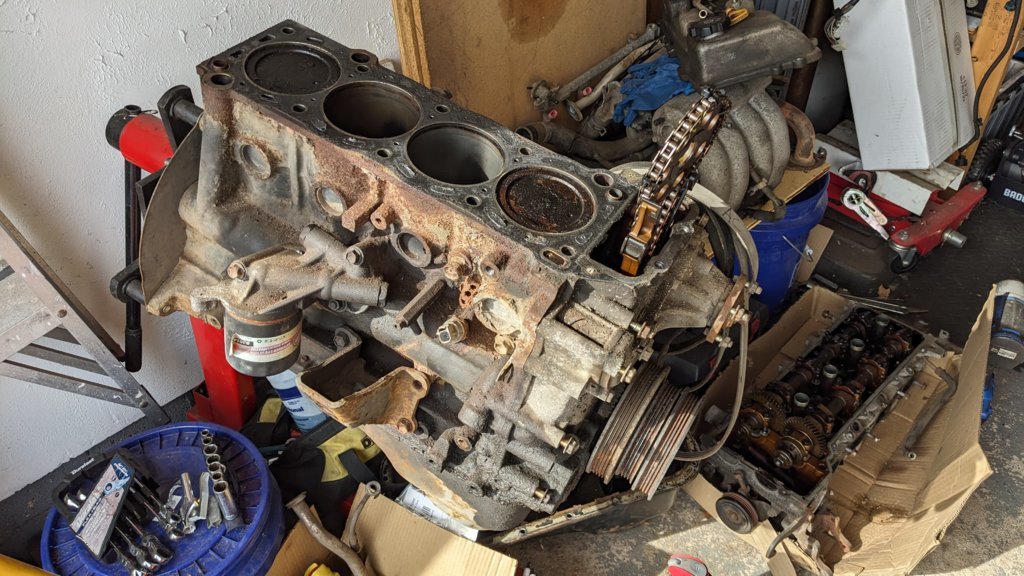

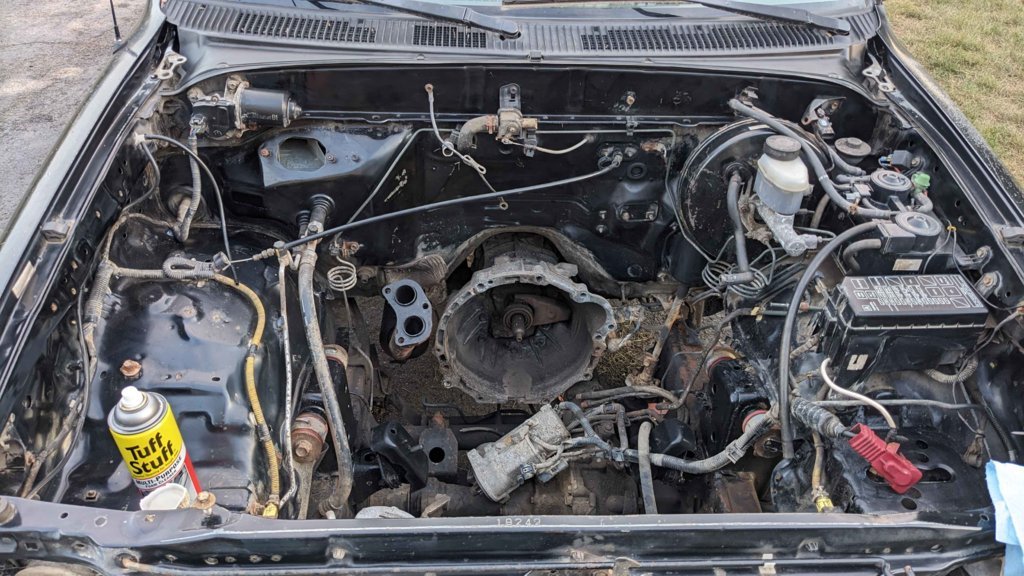

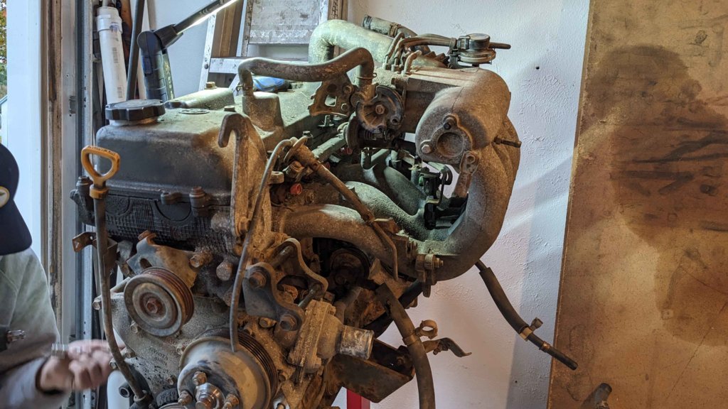

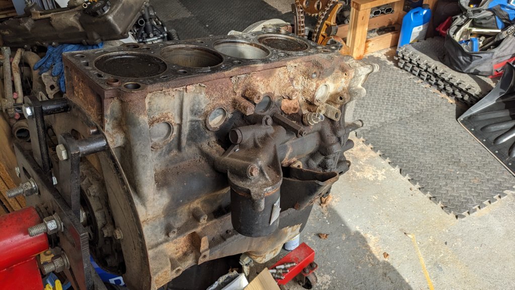

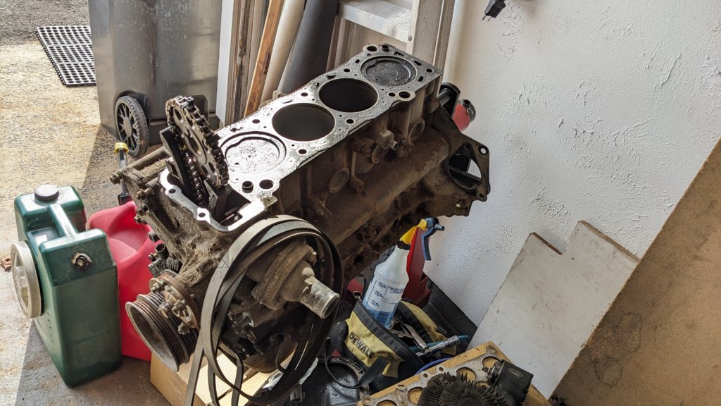

    We pulled the motor in October of 2023 to finally crack it open and go through it. Pulled the motor wasnt very eventful and nothing was really screaming at me as being the root cause of the problem. The motor sat in my garage for another few months as I was then going into another very busy school season.
    Engine Work

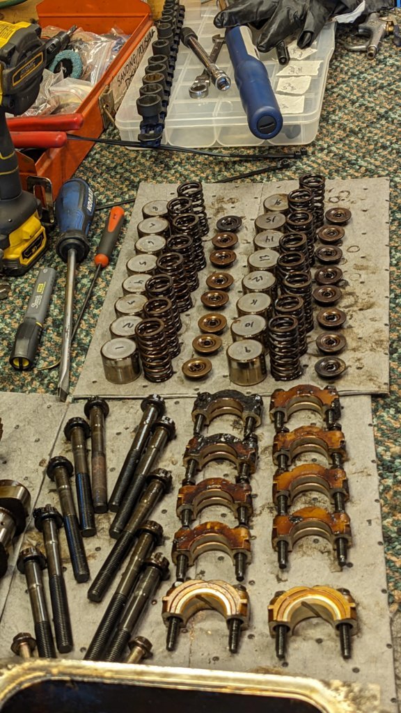

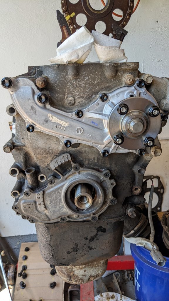

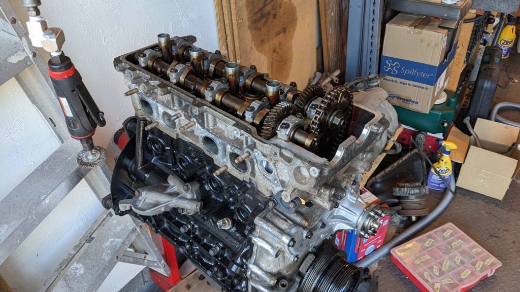

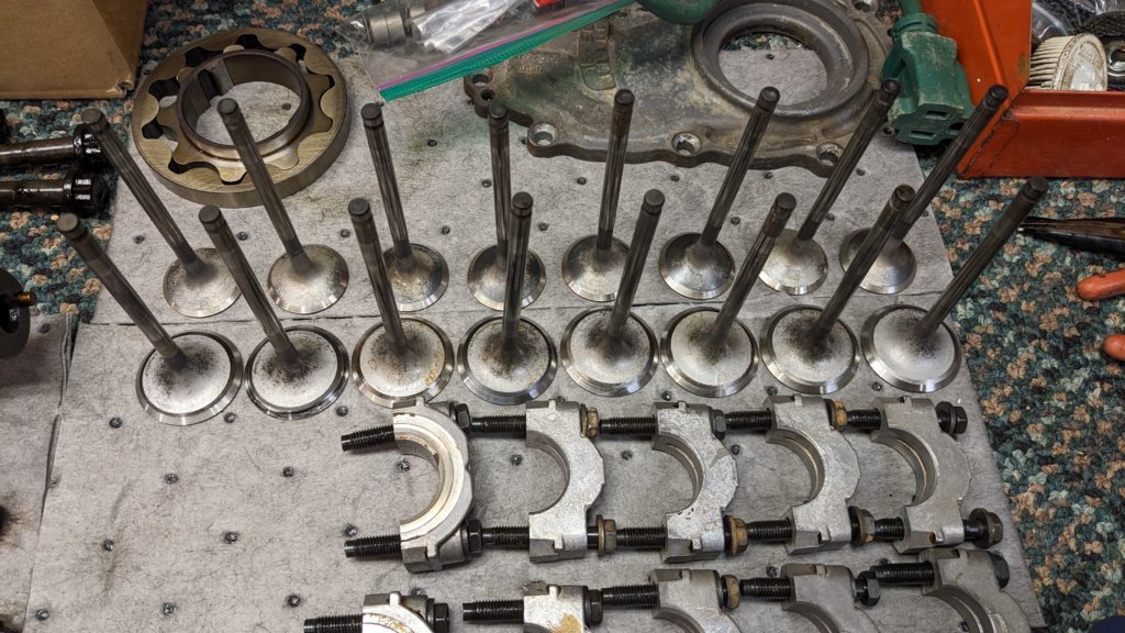

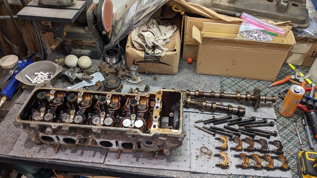

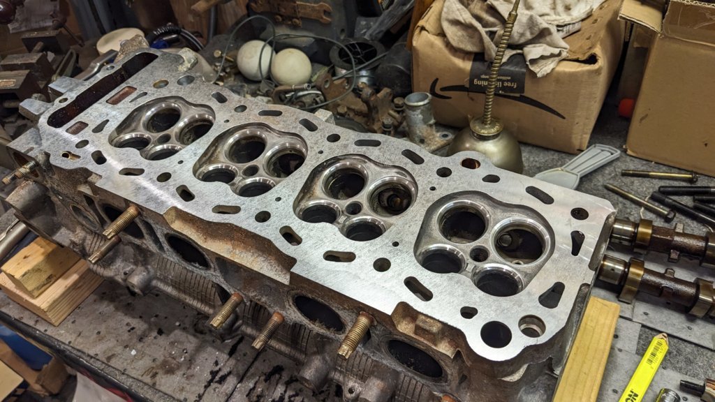

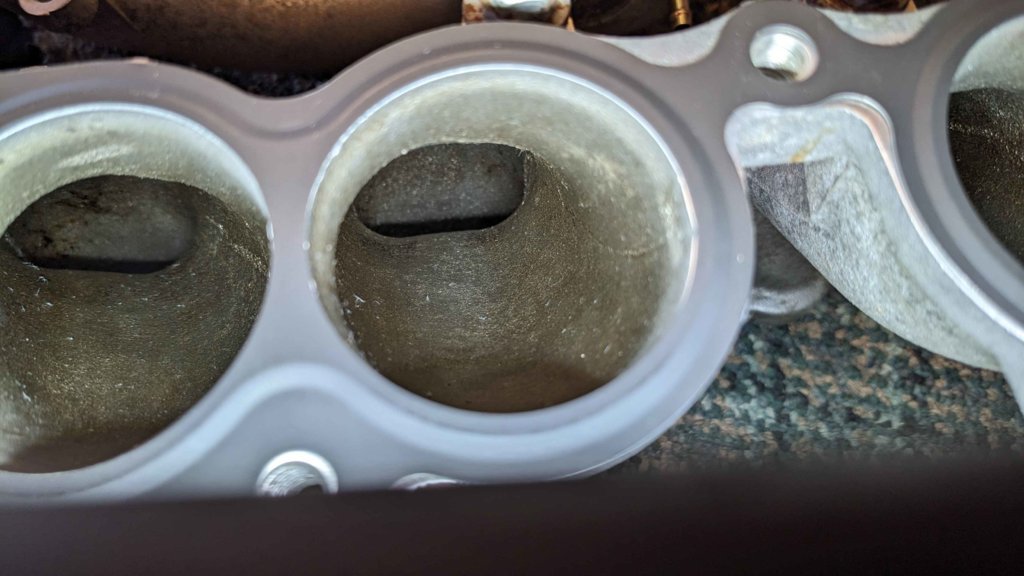

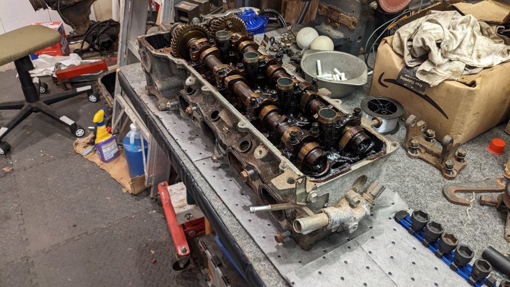

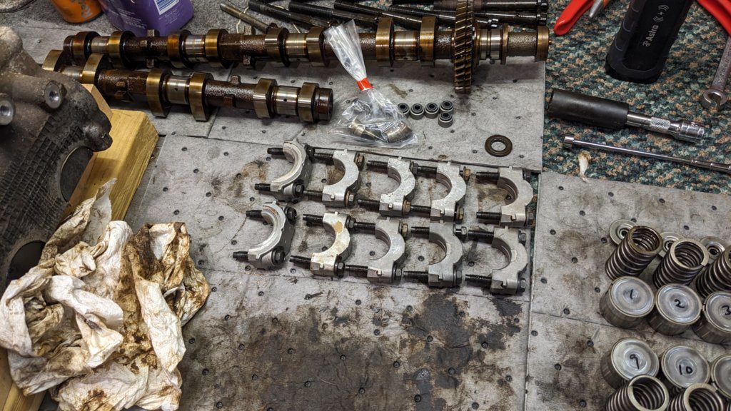

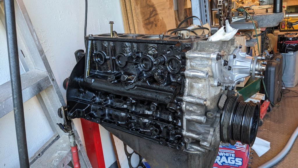

    With the motor out on a stand, I began to tear it apart. I tore the entire motor down to nothing but the block (didnt pull pistons/rings/etc). The main focus was going to be the cylinder head.
    PXL_20240215_175049791.jpg PXL_20240215_175055568.jpg PXL_20240215_175103359.jpg PXL_20240215_175029928.jpg

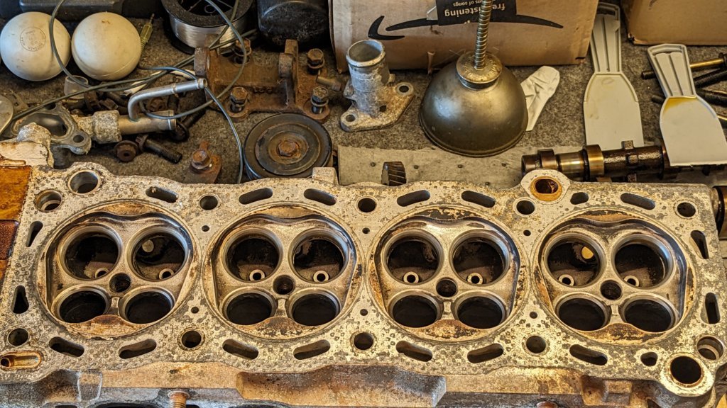

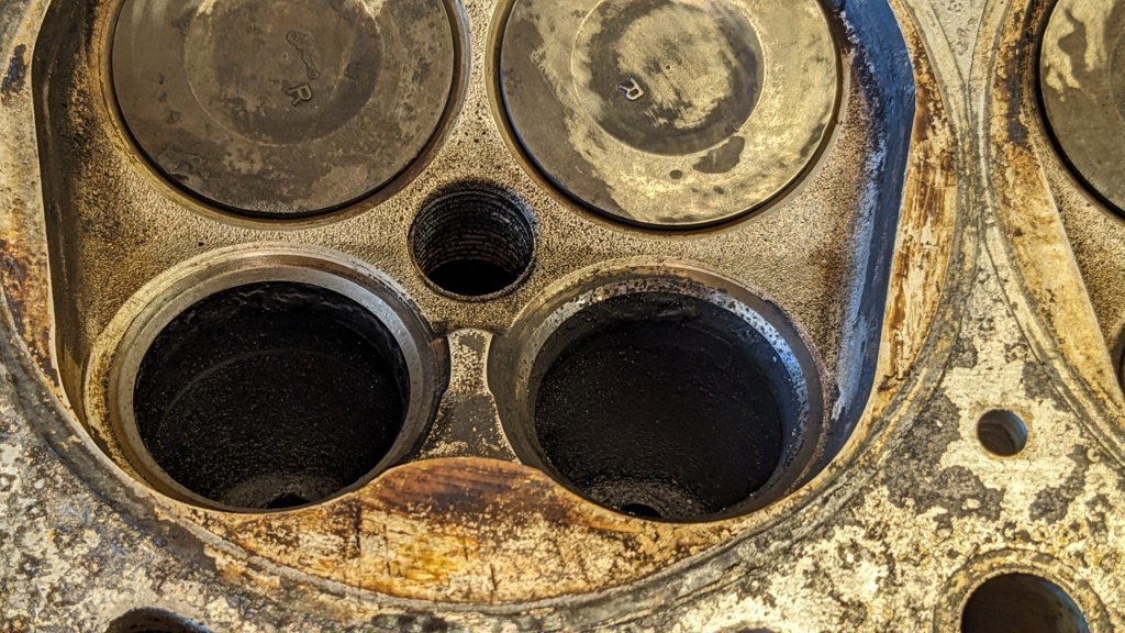

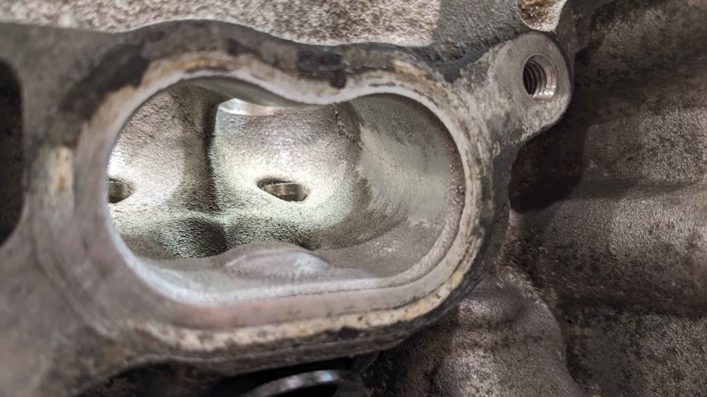

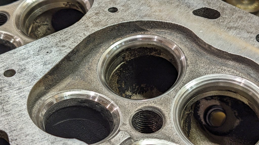

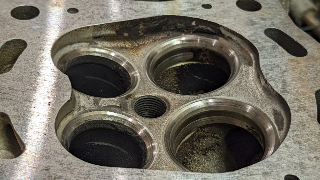

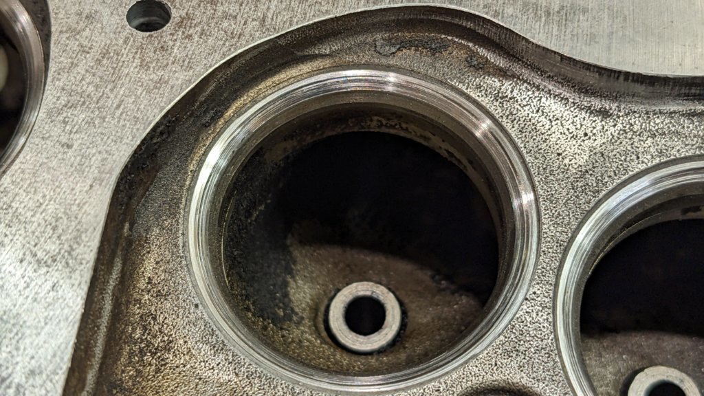

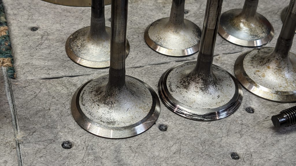

    I took the head to several shops to see what they thought. I actually brought this head and a spare head from my last motor and asked for opinions on which head would be worth fixing. I went to 3 shops who all suggested that fixing the spark plug hole might not be worth it and to instead deck the other head. The last machinist I went to said he would resurface the head for $200. I tested the valves by pulling a vacuum on each intake/exhaust port and found that several were not holding well at all. I tore the head apart including pulling out the valves. I cleaned up pretty much every part I removed by soaking it in Zepp degreaser overnight.

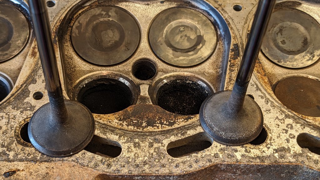

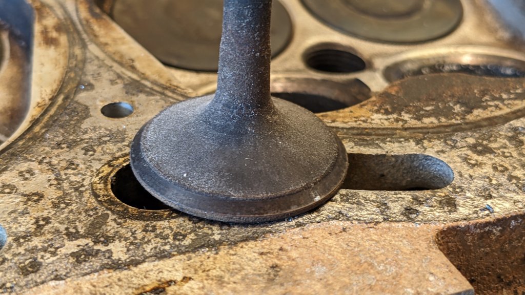

    I decided I didnt want to spend the extra $550 to have a valve job done but wanted a better seal, so I tried to lap the valves myself with just a lapping tool and grinding compound. I only got marginally better results and some valves were even worse. In hindsight, I definitely didnt lap them nearly enough and that is evident in the pictures.
    PXL_20240702_163842535.jpg PXL_20240702_163854446.jpg PXL_20240702_164647123.jpg PXL_20240702_164700123.jpg
    I took it back to the machinist to have him resurface it and told him i tried to lap the valves. He said that was not a good idea and that the valves likely will seal worse than if I had done nothing at all :facepalm: I felt like a total moron standing there and I absolutely didnt have the money to do the entire valve job for $750. But the guy felt sorry for me I guess and said he would resurface and grind the valve seats/valves for $500 total. Still more than I was prepared to spend but I knew it was a decent deal so I went for it. The valves came back looking great and they sealed nicely as well so I was happy, machinist said the guides looked good too. I began to reassemble the head with the newly ground valves and new valve seals.
    PXL_20240704_041611092.jpg PXL_20240704_041620151.jpg PXL_20240704_041629696.jpg PXL_20240704_041536197.jpg PXL_20240704_041542017.jpg

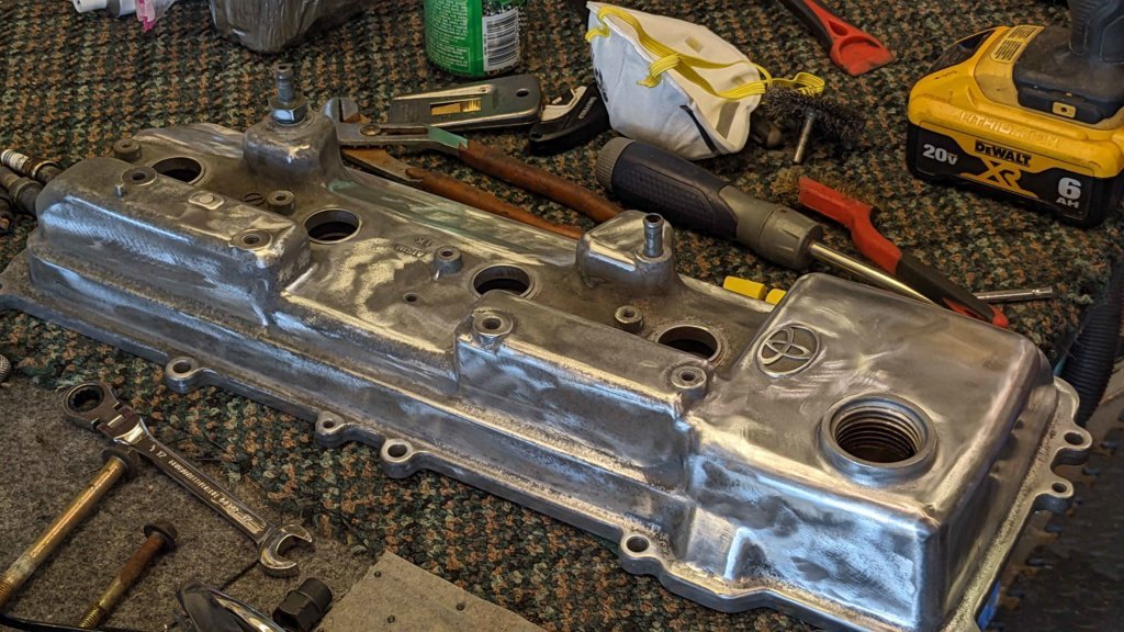

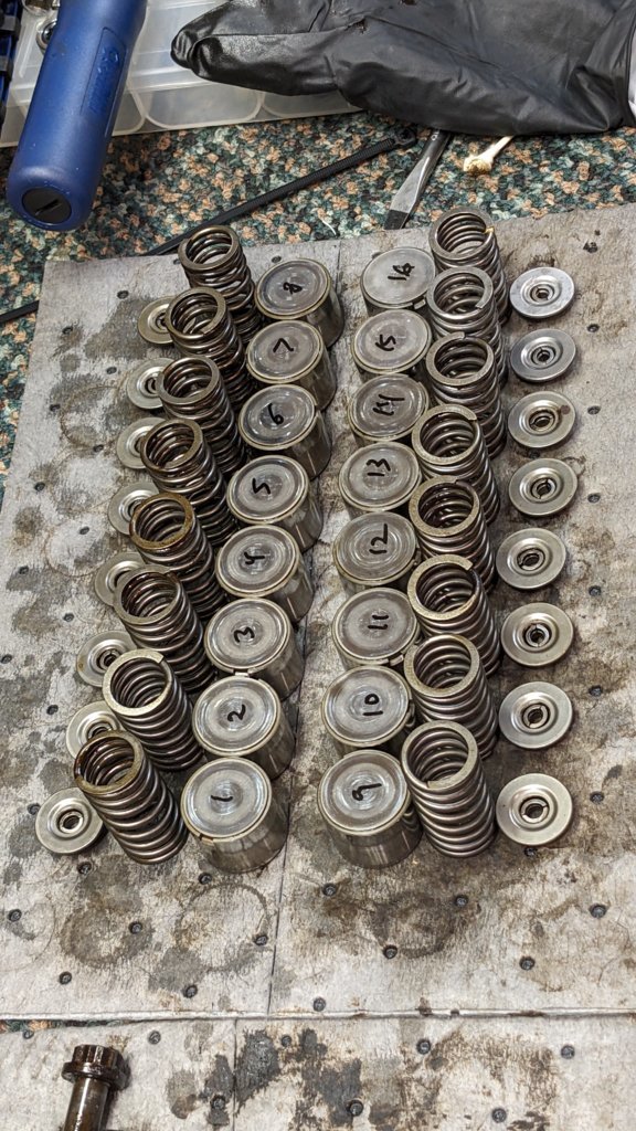

    I also cleaned everything up. I had a newfound love of WD-40 as well. That stuff is an underrated degreaser. I tried everything to get carbon and built up shit off the intake ports and nothing worked but WD-40 worked flawlessly. After cleaning up the ports, I decided to also do some light porting and shaved down some of the casting marks. I totally recognize that this probably did pretty much jack shit to performance, but :notsure: it was nice to look at lol.

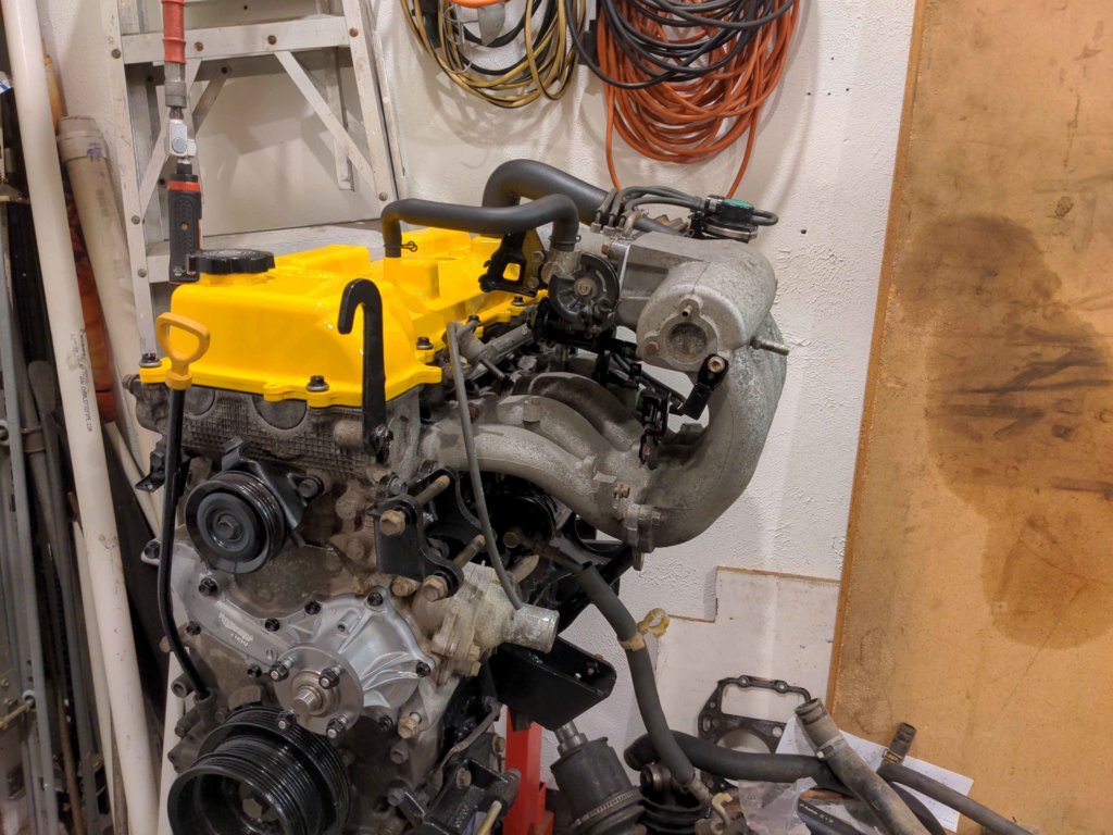

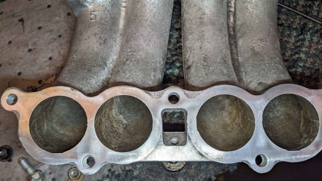

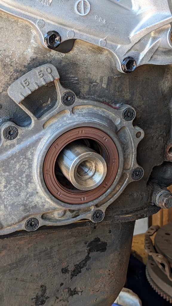

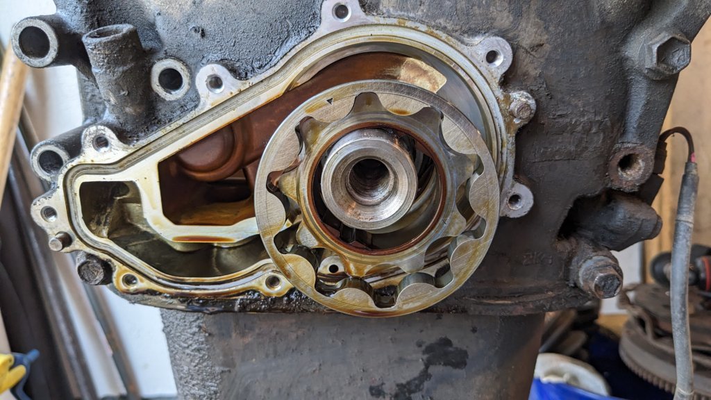

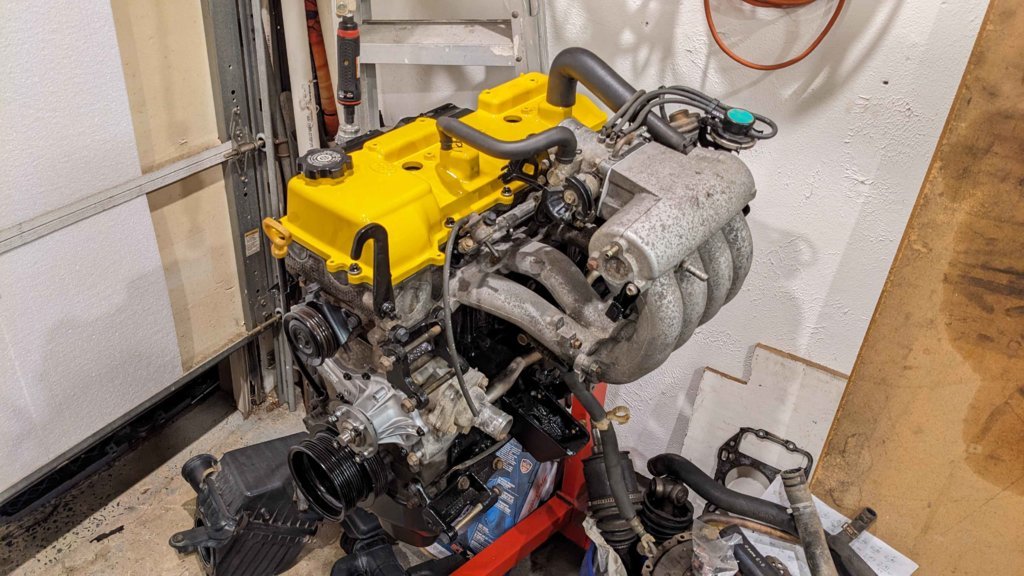

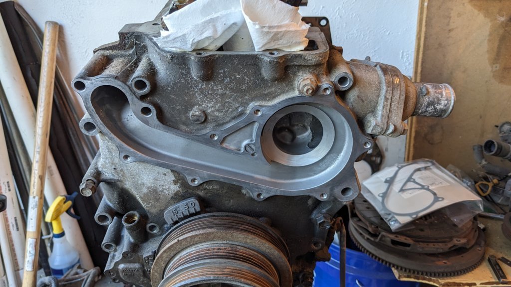

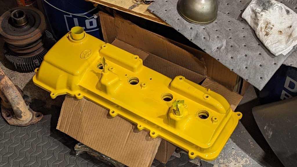

    After getting the head reassembled I turned to basically restoring the rest of the motor. I cleaned up the intake, throttle body, got a new water pump, new fuel filter, new seals and gaskets everywhere including new front and rear main seal, rear seal saver, and new oil pan (old one was patched with JB weld if you scroll back a bit lol). Everything else was thoroughly cleaned, painted if necessary, greased or oiled if necessary, etc etc. I tore almost everything down as much as I felt comfortable and put it all back together. I also cleaned up the block and painted it. Was going to do a new oil pump but the old one looked good.
    PXL_20240627_233515275.jpg PXL_20240719_154148228.jpg PXL_20240702_214242874.jpg PXL_20240719_154914034.jpgPXL_20240903_224531800.MP.jpg PXL_20240906_190119139.jpg PXL_20240903_220743364.jpg PXL_20241001_204627149.jpg PXL_20241001_204701635.jpg PXL_20241001_204714343.jpg PXL_20241002_230606056.jpg PXL_20241004_013052313.jpg PXL_20231021_2032574144.jpg image-2024-10-03_21-33-44.870.jpg

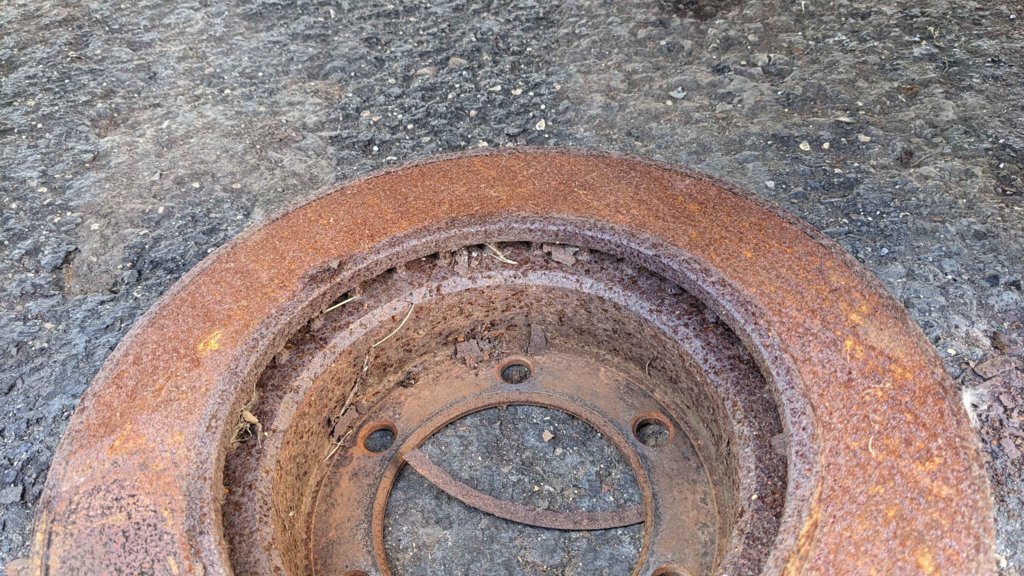

    In addition to all this, the truck had been sitting so long that it needed new pads and rotors and belts so I got those as well.

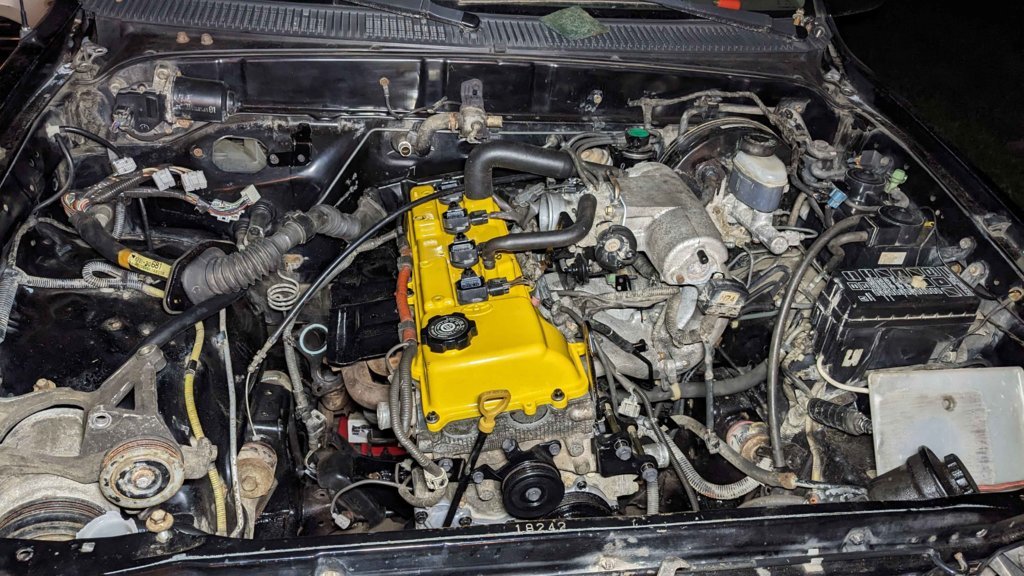

    First Start

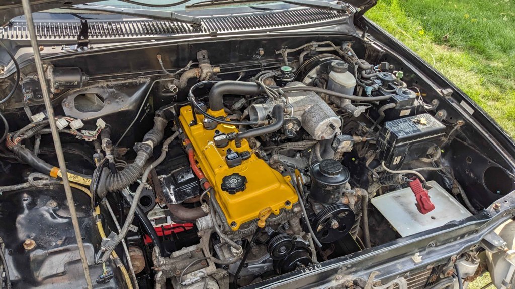

    So with all the engine work done, it was time to put it back in there. We hoisted it up and then did the rear Main seal and seal saver as well as installed a new clutch with new flywheel and flywheel bolts. I cleaned up and painted the engine bay as best as I could in preparation. I also painted the motor mounts and cleaned up crusty hoses. Also cleaned up and painted as many brackets as I could.
    We dropped the motor in without too much of a headache. Oil pan hit the cross member a couple times and had to mess with a combination of engine tilt and height, but finally got it mated to the trans. We put the trans bolts in and began hooking the rest of it up including the harness, hoses, bolts, brackets, etc. I wanted to pump out the old fuel before actually starting it as well so I ran a line into a gas tank. New radiator went in then filled with coolant and oil. I also pulled the plugs and coils and put some oil in the cylinders. First attempt to prime it and the starter didnt seem to wanna move. I pulled the starter, took it apart, and found nothing of note. Cleaned up the commutator and some other bits and reassembled then tested it outside of the trans to make sure it moved. Spun freely just fine then reinstalled. 2nd attempt to prime and it turned over fine. Cranked for a bit to get the fluids moving and to build oil pressure. Then hooked up the Autel to turn on the fuel pump manually to pump the rest of the gas. Luckily the tank was pretty close to empty and only had to drain about 3 gallons. Filled it with fresh gas then tried first start. Truck cranked, but gas began spewing out of the front 2 injectors. Looked to clearly be bad o-rings but they were brand new so mustve been a faulty installation. Next day I pulled the fuel rail out completely and inspected every injector and found the front 2 had pinched o-rings. I let them sit in the sun for a bit then oiled them and reinstalled carefully making sure they spun freely once in the fuel rail. Then reinstalled the fuel rail. Cranked again and this time still wouldnt start. Pulled plugs and coils and found no spark. Inspected the coil plugs and found that they werent grounding properly. Chased that around and could not find an obvious issue so began to clean the grounds up. After cleaning the intake manifold ground she started right up. Idle is high, about 2000rpm but I expect it to settle after a drive cycle.PXL_20241006_233037287.jpg PXL_20241007_174217638.jpg

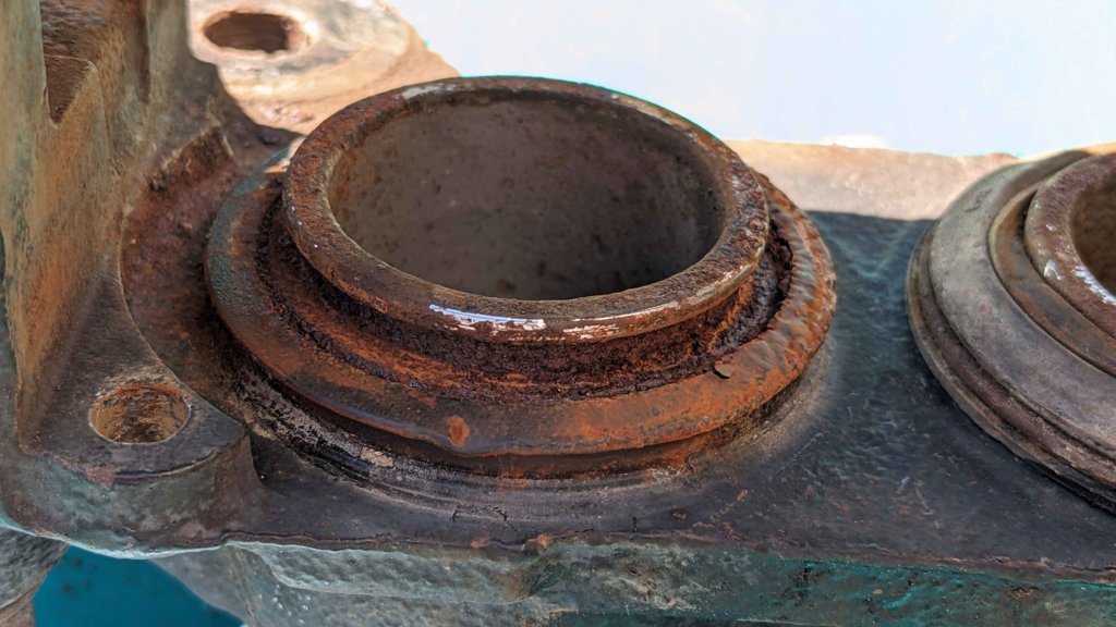

    When doing pads on the Drivers side I found that the caliper seems to have 3/4 of the cylinders seized up, so I will need to get a new caliper before she can drive again. Going to NAPA tomorrow to get one then gonna put new fluids in front and rear diff and trans.

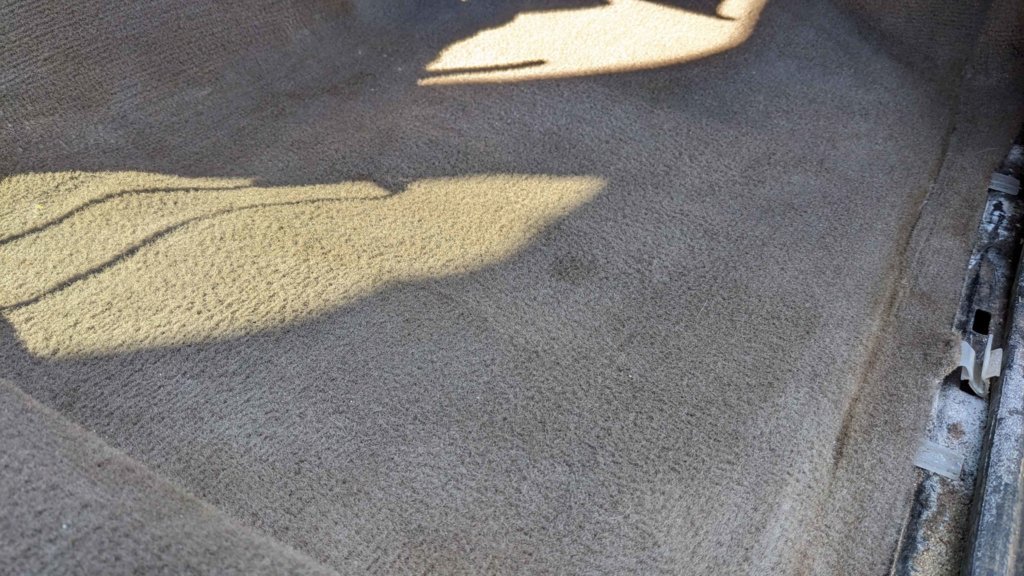

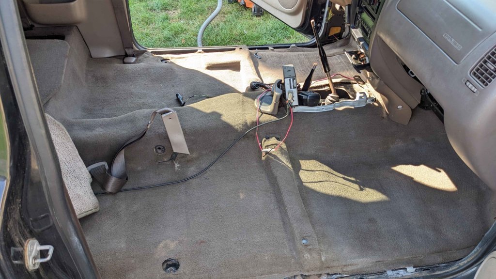

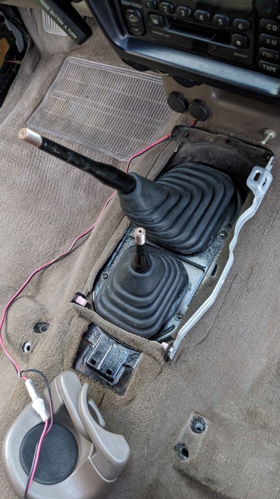

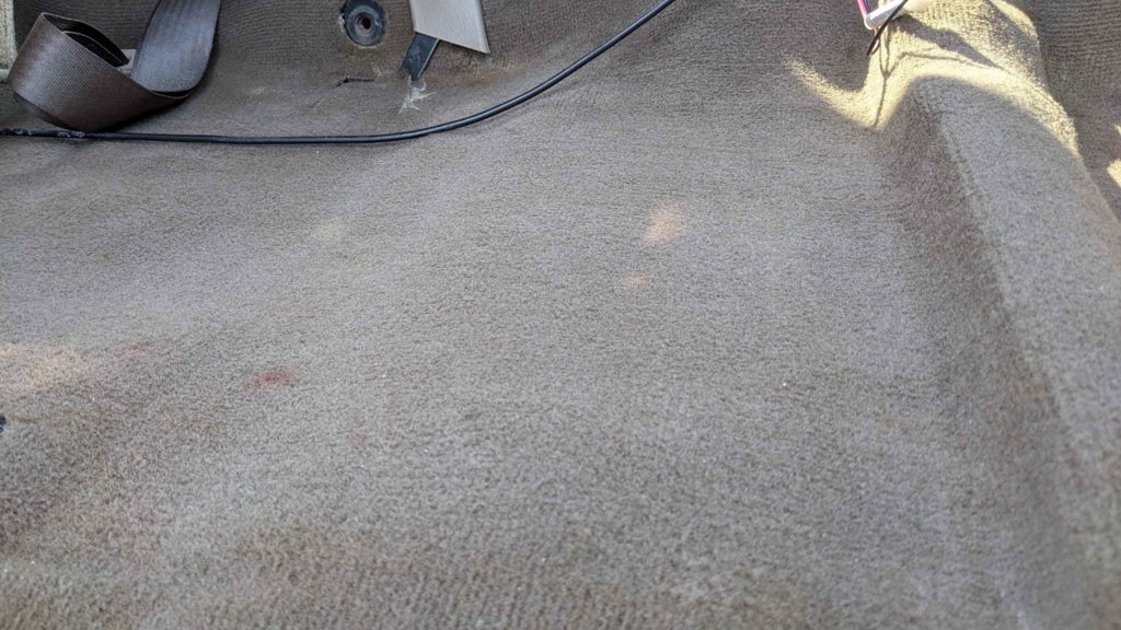

    So since the truck sat so long without being driven, unfortunately, a mouse made its way in there through the transmission tunnel. I caught the thing but not before he had pooped all over the interior. I tend to think of myself as somewhat of a germophobe so I was very upset but nonetheless I wasnt giving up on her. I tore the entire interior apart. I got a HEPA shop vac filter and vacuumed up all the loose poop and debris. I had read that most diseases from mouse poop probably dies within about a week so I didnt really feel like there was a huge hazard here but I took precautions anyway. Once I vacuumed it all up, I sprayed lysol on everything; seats, floor, dash, glovebox, vents. I then got carpet cleaner and soaked the seats and vacuumed them, then the floor and any other fabric surfaces. Then I lysoled the hard surfaces multiple times and also sprayed and cleaned with tuff stuff. Everything got multiple rounds of cleaning. I also put baking soda over the entire carpet and the seats. Any spots I was particularly concerned about got 2 rounds of baking soda and I scrubbed it in with a lysol/baking soda mixture. I also stuck a borescope down the vents to see if the mouse had gotten in there and also inspected wires, no poop in the vents and wires were all good so that was very relieving. Also painted the unpainted shifter boot surround and cupholder bracket.
    PXL_20241007_185031325.jpg PXL_20241007_185522900.jpg PXL_20241007_185529773.jpgPXL_20241008_220821982.jpg

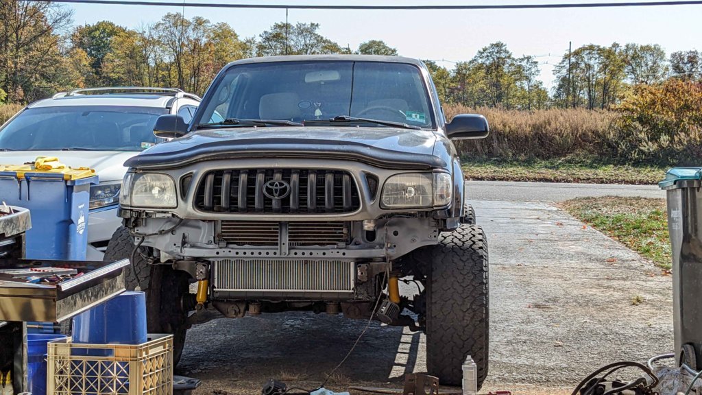

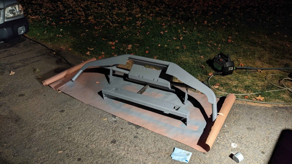

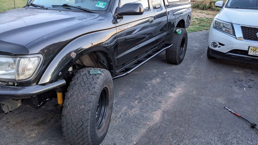

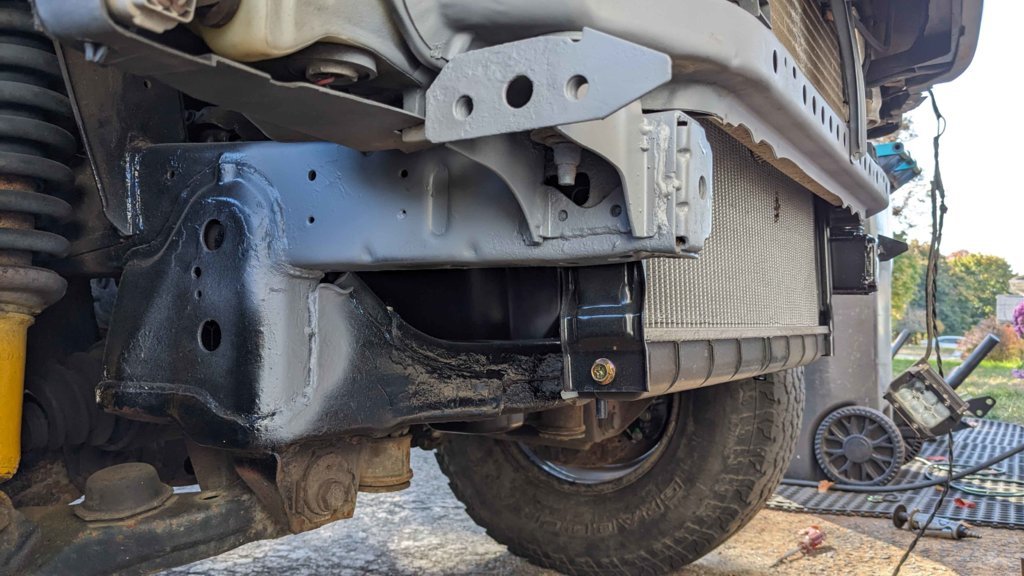

    Repainted my sliders and front bumper. I was going to sand it down a lot more but sanding this thing was more of a pain than I was expecting so I just did a few rounds of sanding and decided to mostly prime over the old paint. Next time I have to do this Ill have to get it sandblasted or something. Used rustoleum primer and satin black.
    I also lightly scuffed and primed parts of the front clip(?) expecting my color match paint to arrive so I could paint it. Still hasnt shown up though so I just put the bumper back on, Ill have to remove it again when it comes in. Also sanded and painted parts of the frame where the bumper mounts and the LCA's. Just trying to keep everything clean and painted to avoid rust.
    Removed the pods for now as well.

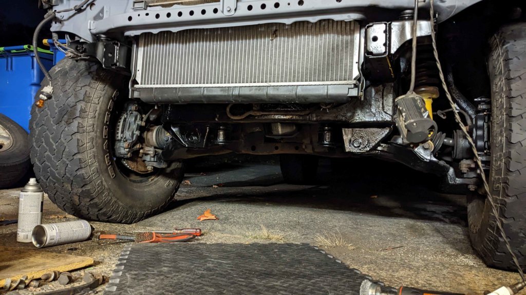

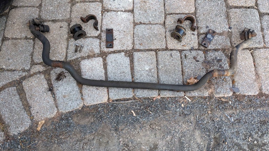

    Small update, pulled my sway bar out. Broke both of the passenger side bolts but drivers side came out no problem. It hasnt been connected in years and I am trying to narrow down where this front end clunk is coming from. Inspected the body mounts as well and they look ok so dont think its the body mounts. Going to check ball joints tomorrow but Ill be surprised if its the ball joints. Also discovered that my exhaust is pretty loose on the front cat and one of the hangers broke completely off.

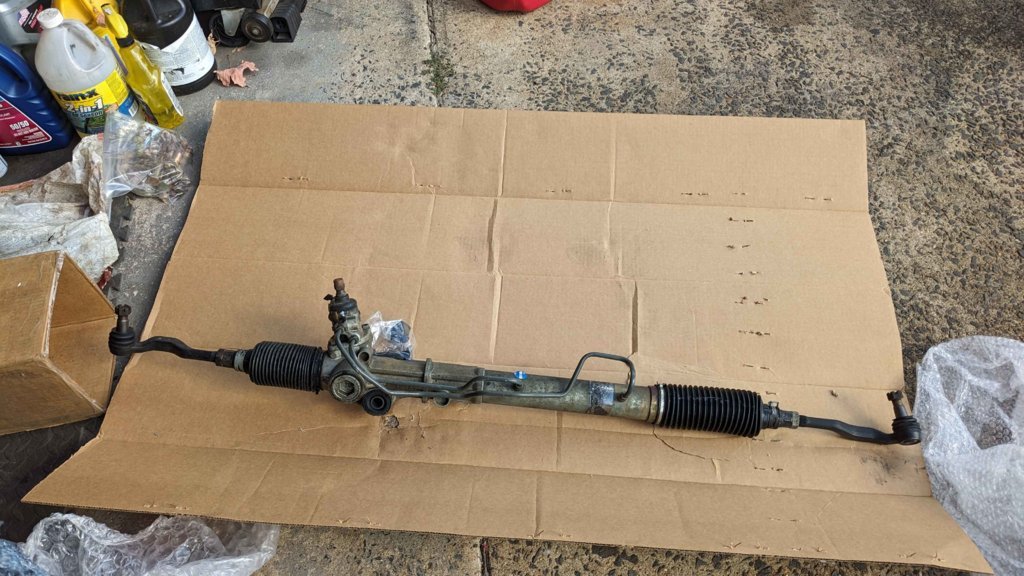

    I also finally got around to opening up my new (to me) steering rack that I bought off @dtxoreo Going to be installing it at some point. This rack has a small leak but itll be an upgrade over the old one which is leaking badly and has a badly torn boot. At some point Ill buy a brand new rack but money is tight and the rack seems worse everyday. I am sort of considering trying my hand at rebuilding this one as well. I dont think my current rack is going to be rebuildable.

    Woohoo! Glad it made it safe, let me know if you run into any issues with it - but I bet you could rebuild it yourself whenever you get around to it!
