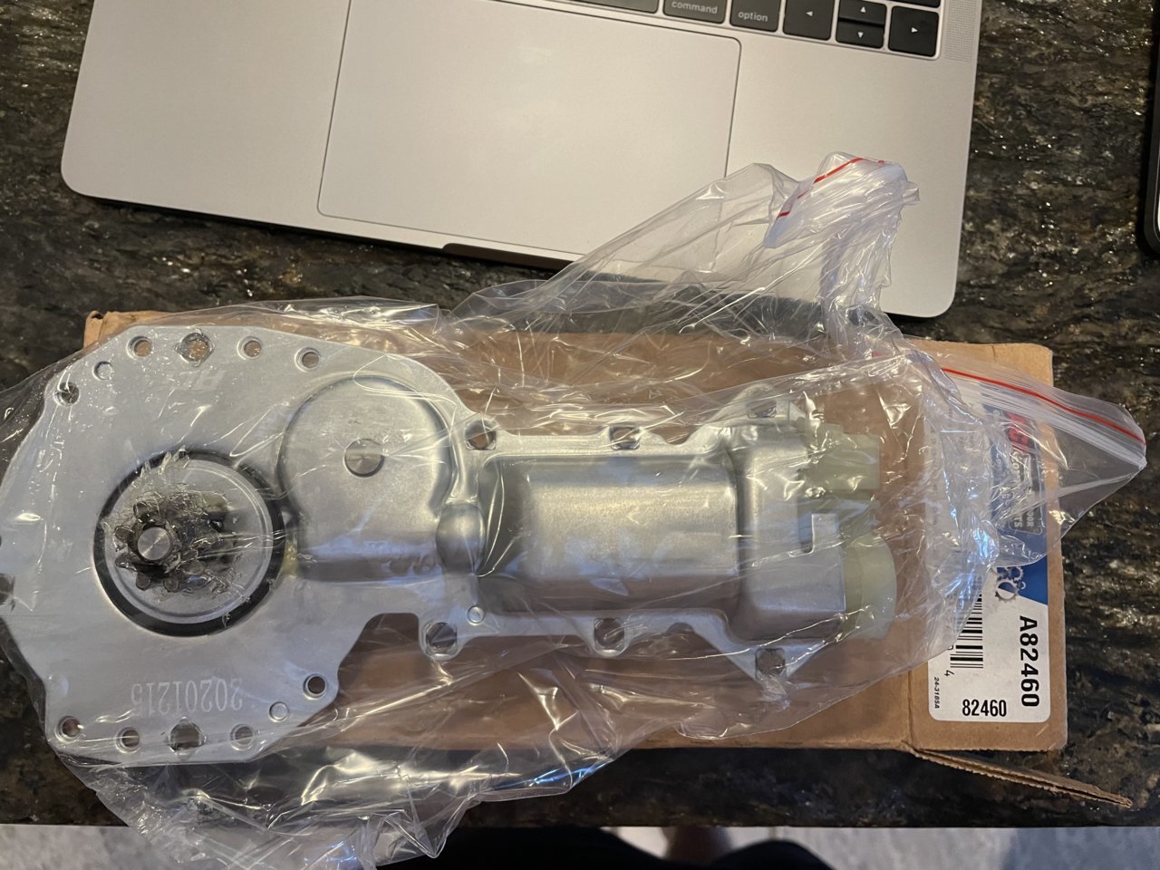

    Here's the driver's side motor. ACI is the OEM manufacturer I think. Part #A82460 and comes with new screws and nuts to replace the factory rivets. Not sure about passenger side #. Rockauto and Amazon are your best bet.

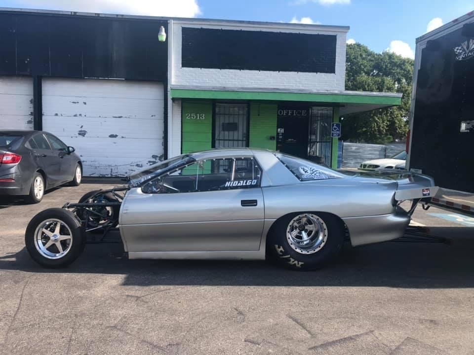

    Nice Camaro!! I’m just now starting to read through the posts on it and I Figured you’d appreciate my cornwell tools guys silver bullet n2O Camaro259724AE-A471-478B-97F5-2B0D91284D32.jpg 3B72ABB6-6925-4B22-9FF3-951CF8AAC986.jpg100ED998-20C7-4125-839E-A218A4451426.jpg

    :eek::eek::eek::eek::eek::bowdown::bowdown::bowdown::bowdown::drool::drool::drool::drool:

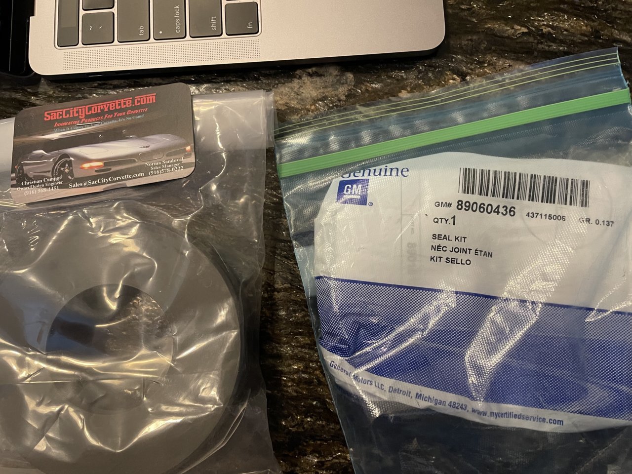

    I replaced the rear main seal when I did the clutch last time. The trans was out and it was super easy to access without having to pull the motor. There's a tool you can buy from SacCityCorvette to hold the rear engine piece in place when you swap the rear main seal. Black RTV is your friend.

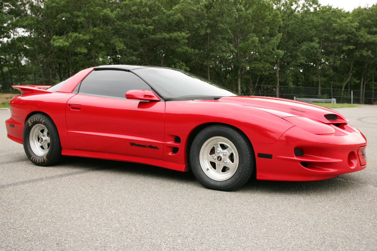

    Nice ride i had a 2000 Trans Am for about 15 years. Started as a bone stock automatic and well you know how the story goes ended up a 6 speed with H/C/I and bottlefed miss that car. Any plans for mods i saw maybe a stall, I had a yank 4000 stall before i did a 6 speed swap it was great from a dig. You dont have to pull the motor to do a real main. Although its pretty easy to drop the engine/trans and subframe together.

    I love the lines on those fire chickens.
