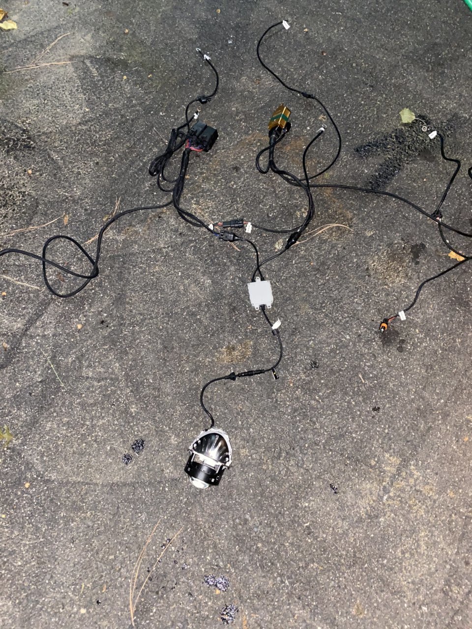

    I have purchased the Morimoto M-LED 2.0 retrofit kit to install into my 1st Gen Tacoma. I also have the Motocontrol Bi-Xenon H4/9003 relay harness.
    The issue I am having is when I plug everything up. With the truck on Low beams, the Projectors are in High beam. If I remove the high beam wire connection, then it reverts to Low beam.
    With parts left over, I can us a 9006 pig tails directly to the Factory H4 socket… I can’t get both beams to work at the same time.
    Anyone have any thoughts on this?

    There isn't a change if I flip the Blue & White, high beam stays on. If I remove either one of the 9006 inputs, the light turns off.
    (I have 2 MotoControls and both do the same thing).
    So I probably need to build a custom harness that takes the Toyota double negative H4 and converts it to "Standard" High/Low 9006.

    I have the factory H4 plug, into the MotoControl H4 that goes into the relay control and then does it thing and splits out into 2 leads ("Ballast" & High beam). I plug the Ballast into Low and and High into High. If I flip to high beams, nothing happens.
    These are set-up like a HID Projector and the high beam is a shield. I don't think the LED power output changes between low & high modes.
    I tagged Andrew, who is with The Retrofit Source in hoping he can shed some light. I also posted on HID Planet and haven't gotten any responses.

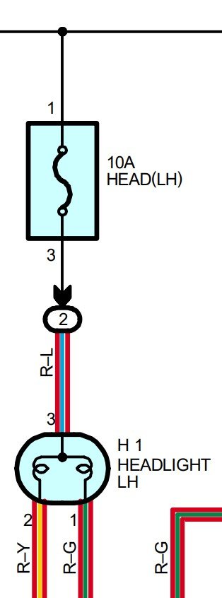

    Ok got it. Do you have a voltmeter? Measure the voltage coming out of the motocontrol high beam connector.
    Here is the wiring for the Driver side headlight (I have also attached the full diagram):
    Pin 1 = Red-Green Low beam ground
    Pin 2 = Red-Yellow High beam ground
    Pin 3 = 12V+ from the headlight fuse
    What I originally suggested is that you may need to switch this R-Y and R-G connection. You should do this on the moto control harness, not the truck. I apologize if you already tried this, I just wanted to make sure you are switching the correct wires.
    Almost all image diagrams that you come up with on google are not correct for Toyota H4 wiring. Most of them imply that the low and high beam wires are 12v+, but they are actually grounds.
    Take this one for instance, on your truck, the spot labeled negative, is actually positive.

    Well I went out and played with them some more, this time I grabbed my old EK Civic retrofit (Mini-H1) headlights and plugged them into the MotoControl that I was planning on using in the Tacoma. They fired up in Low Beam, then I could flip the high beams and highs worked.
    If I flipped the blue & white wires, it would blow the fuse as soon as I hit Highs.
    Conclusion: Did I get a bad batch of MLED2.0s?

    I tried that and the Projector is working fine. I connected Low+ to battery and L/H- to battery (no Highs on). Then I took the High+ and tapped the positive terminal and the highs functioned.
    Which led me to the next thing. Meter the MotoControl outputs. I think I have found the issue; MotoControl has a .5v 'leak' on the high beam (full 12v when the Highs are on).
    So if I take a "HD Relay - 9006" and add it into to the MotoControl high beam path, I'll get Low with functional highs.

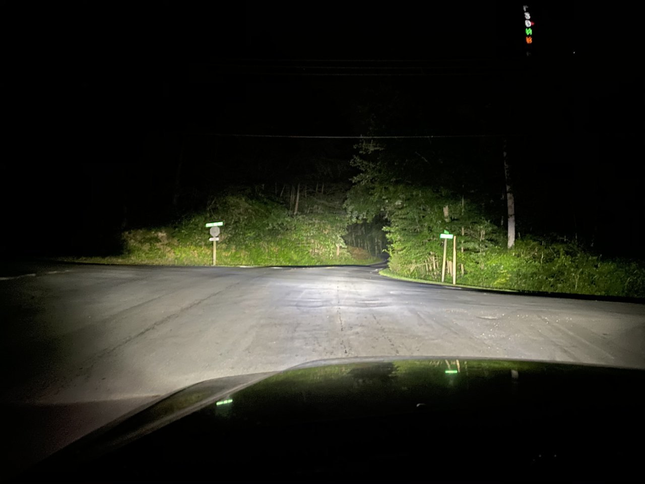

  17. Jul 25, 2020 at 8:55 PM
    #17
    mattvivsound
    mattvivsound [OP] Well-Known Member
    Nov 24, 2009
    #26445
    447
    Southern MD
    '01 Tacoma TRD, 4x4, V6
    Outcome, I am VERY happy!!!
    The projectors are level and that road does go up to the left.
