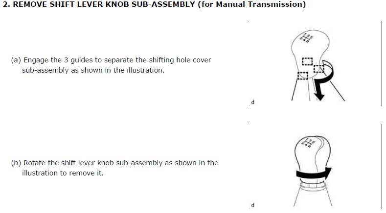

    how do I get the shifter and e-brake boots off? I’ve got some nice leather to make my own.

    in the center console there are two bolts under the carpet (if yours came with that.) the rest is just clips. once you finagle that mf off youll see how the shift boots come off. the one covering the stick shift is secured with clips and the ebrake its pretty much just there, i dont think its secured on by anything. there is a hump that you gotta get that material over at the base of the ebrake rubber. its one speed taking those items off man, no sweat.
