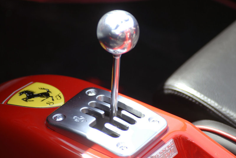

    Just gave the advice a try, and it worked properly for me three times. Sheesh. It never would have occurred to me, and it sure as hell "ain't in da manual." :pccoffee:
    My last truck had one of these, and I rarely missed a shift:

    Gated manuals are awesome; don't know why those went away. Perhaps idiots spilling coffee into them?
