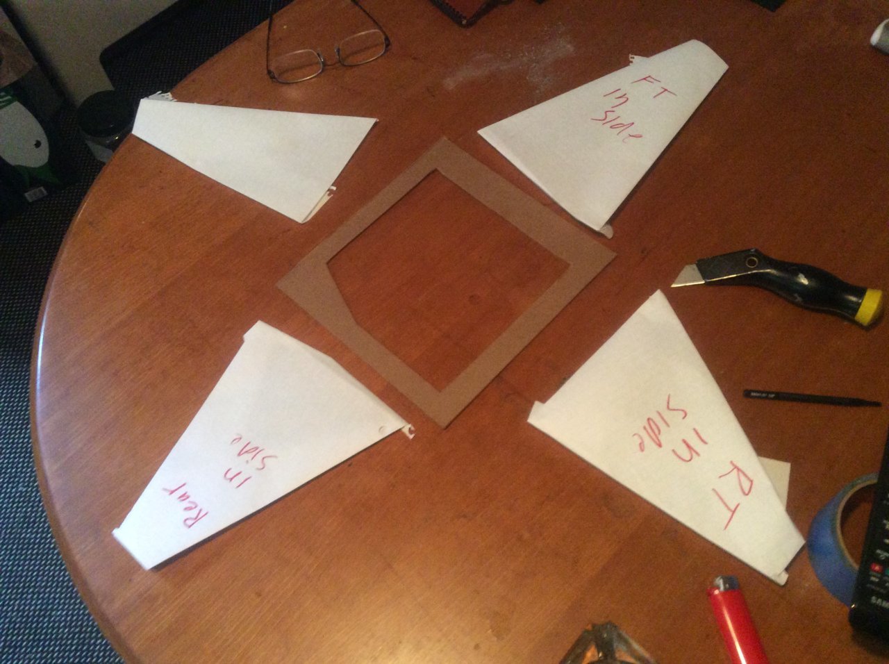

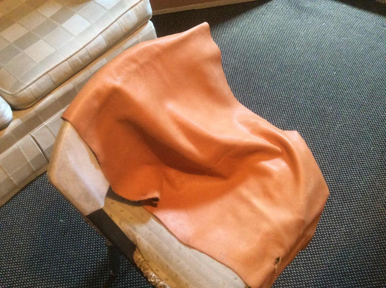

    DCF0C2C6-636B-41C6-8567-8EC9DB822C01.jpg Step one make a pattern. Tape it together and see how it fits.

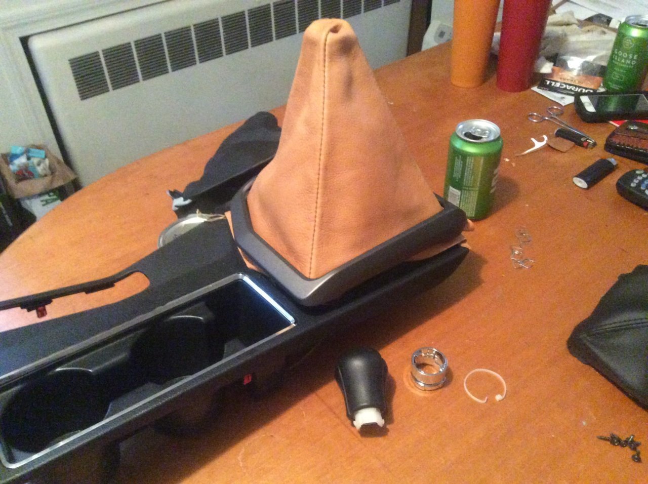

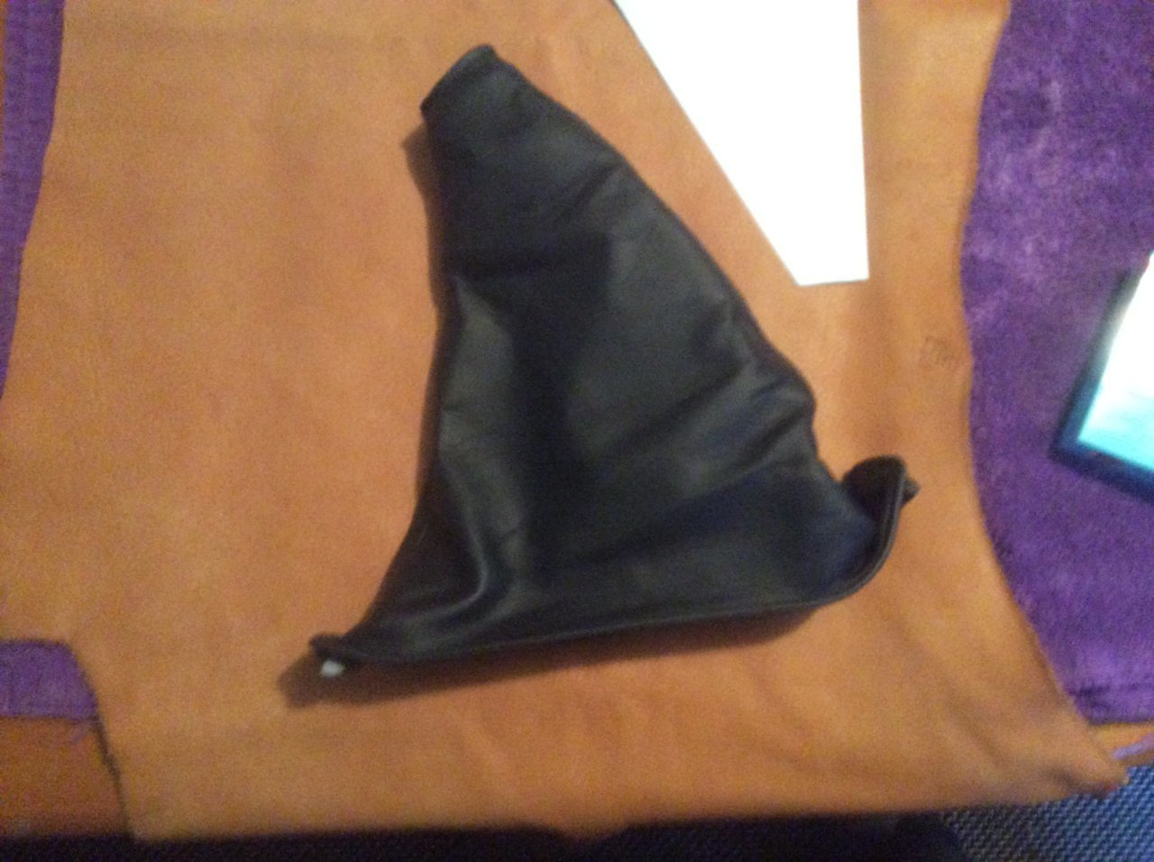

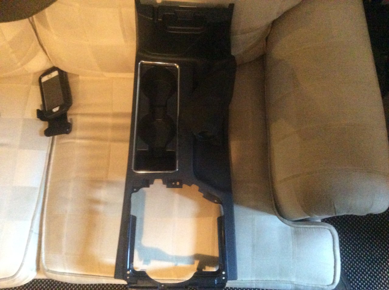

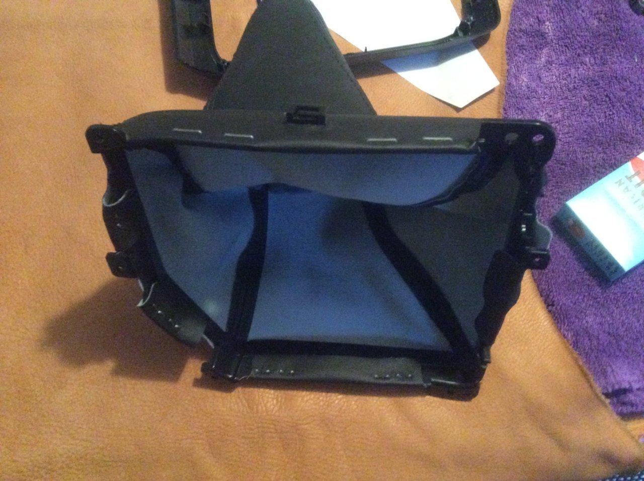

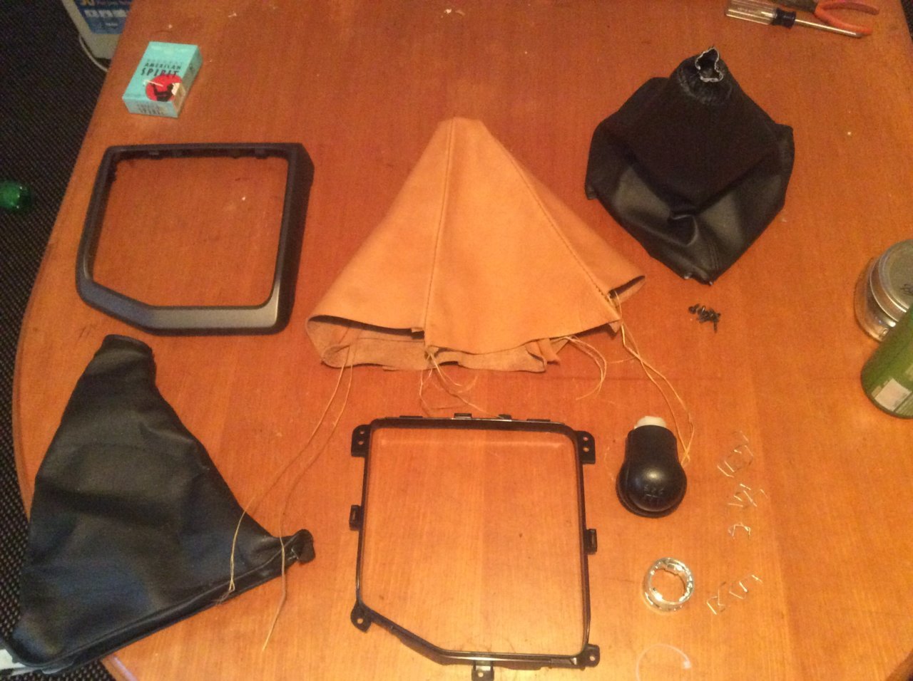

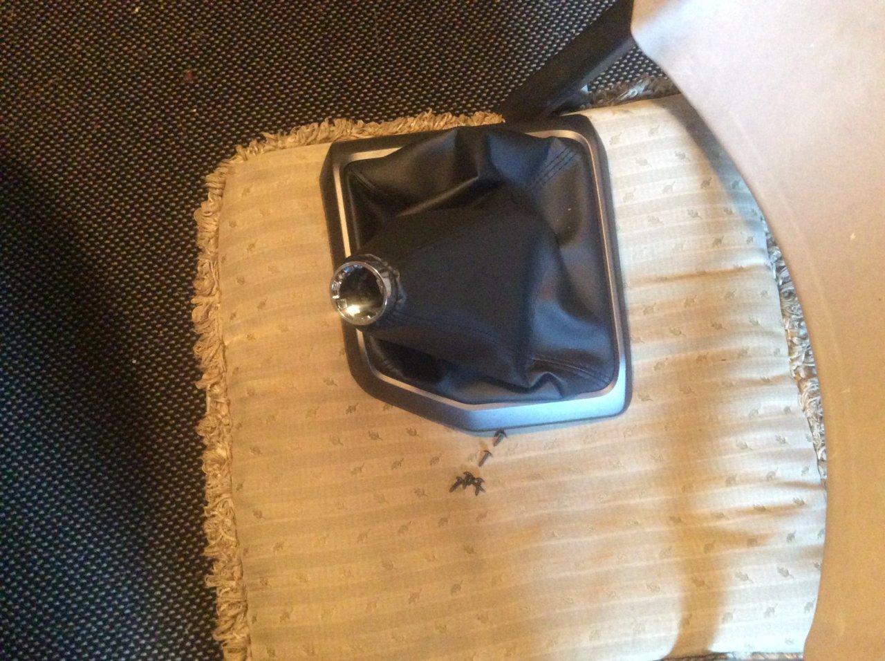

    479E10B4-18C2-4485-8F92-D885BEFD9107.jpg E26819F3-62F2-489B-BFE3-4C994DCE9D82.jpg The console pops up,just clips. Trim ring and boot are held in by 6 small philips head screws. Boot unclips with 4 clips that are part of the trim ring,small and week,broke one. Boot staples to frame.zip tie holds boot top to twist ring. And the e-brake boot with way wore material than needed.087AF366-FE6C-4231-8835-990EA4C317C0.jpg EB6CA8F0-4441-44FC-8B75-82C0651045CC.jpg 087AF366-FE6C-4231-8835-990EA4C317C0.jpg

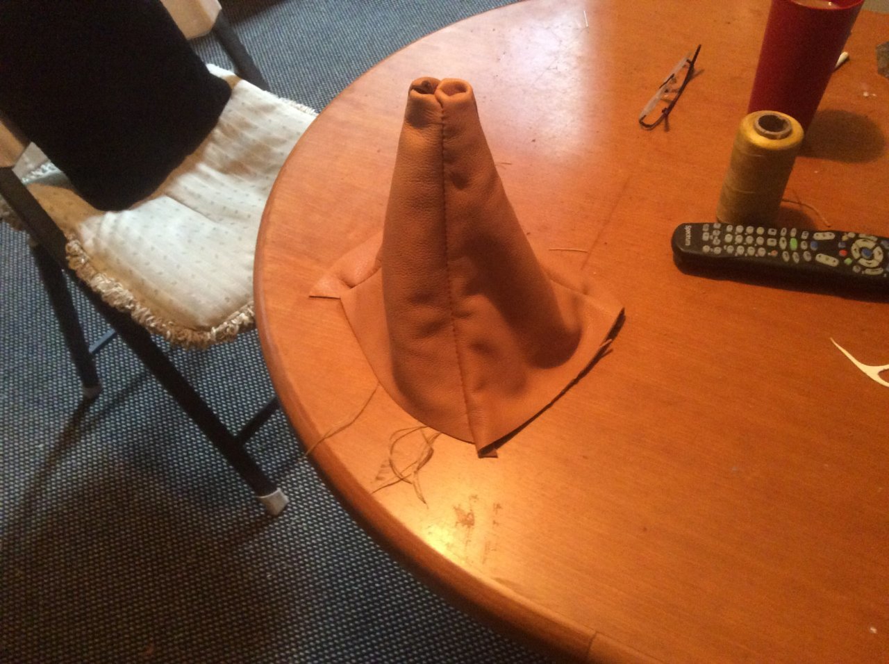

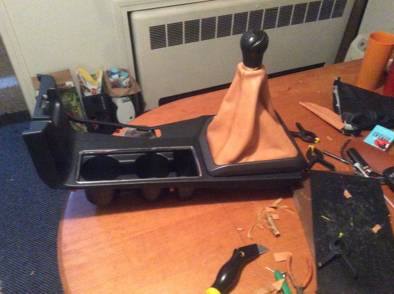

    Got the shift boot sewn up. Gotta glue the seems down on the inside then get it in.image.jpg

    Not attached yet but it fits. Seams are straight. The lock of the zip tie goes into a notch on the upper ring and the tag end goes into the center and gets clipped off inside the ring. Boot is stapled on on the bottom so I’m gonna use the holes from them to stitch through. Wish me luck.image.jpg image.jpg

    O-my god that was fucken scary. The leather is 4x as thick as the original material. Creaking and groaning of it all. I think I am going to have to redo it in thinner leather but now I will be able to cut the exact pattern from the other boot. Gonna but it in and go for a drive.image.jpg

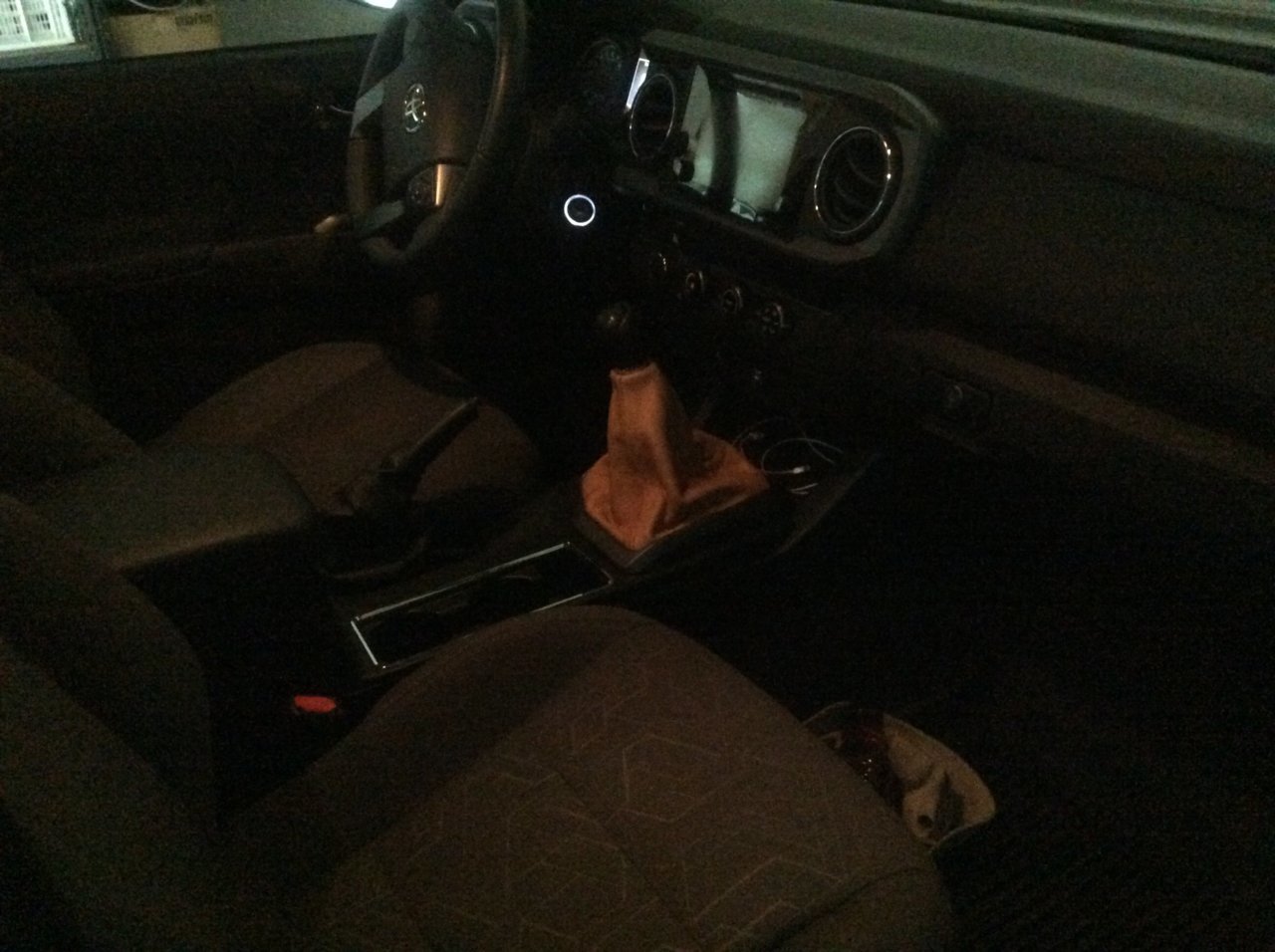

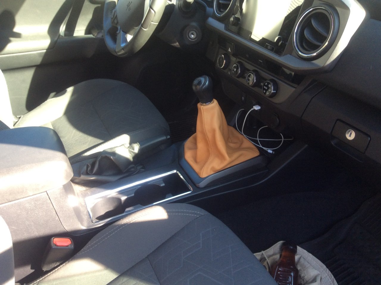

  8. Jul 17, 2019 at 4:36 PM
    TeecoTaco
    TeecoTaco Liberty Biberty
    Feb 26, 2017
    #211739
    11,036
    SW Ontario
    16 Taco DCSB TRD Sport 6MT
    Modified the level of gas in the tank
    Is it like breaking in a new ball mitt?

  10. Jul 18, 2019 at 2:46 PM
    Diddy Spicebush
    Diddy Spicebush [OP] Well-Known Member
    May 23, 2019
    #294136
    238
    Brent
    Saco Maine
    2003 sr5 2wd x-cab,and 2017 6/spd m/t sport
    Yakima roof and bed rack and tubular rear bumper.
