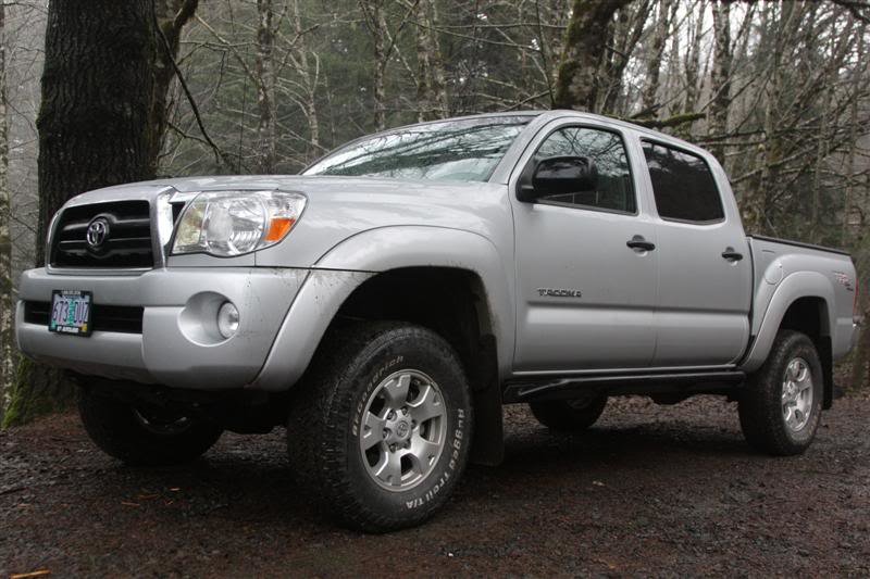

    Put on whatever tires you have chains for. It's maybe not as 'fun', but you get unbeatable traction.
    My area isn't really known for getting snow, but when we do it's a wet, icy snow.
    Last year, I went on a Christmas tree run up a mountain with some other folks. Going back down was really slow. It was very icy, and we had to stop more than once to winch some other groups out of ditches.
    I was the second from the last in our caravan.
    this was me. Basically stock setup with a lift.
    this was the guy behind me. He had his vehicle in the shop and was borrowing this. Decked to the nines, but I'm guessing he wasn't fully familiar with the vehicle. I can't say if the tires are the same as in the pic, but he had some meaty M/Ts
    Since I had them, I put on chains on all 4 wheels. The FJC didn't have any.
    We got to a flat spot to rest and get out. The FJC driver came up to me and asked how I was doing. I told him that going down was very easy, I put it in 4-lo 1st and settled back in my seat. He said that his ABS was chattering the entire time, he was having a hard time keeping it slow enough, and he kept sliding to a stop.
