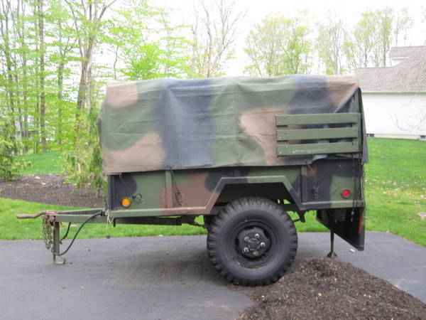

    M101:
    M100:
    M416:
    The 3/4 ton M101 (A1, A2 or A3) is very versatile, but maybe a bit big for a Tacoma. That's one of my questions for TW users. The 1/4 ton M100s and M416s are a bit small, in my opinion, at least for what I do with a trailer, and more suited for the old military Jeep. Lots of off-roaders use the M100s though. Other questions I have are about the hitch.

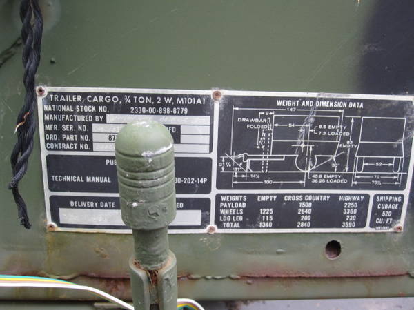

    What is the GVWR of that trailer? I doubt you'd have a problem towing one, but have not done it, so that's just a guess ...
    Edit: looking at the pic above, it looks like the GVW of the trailer is around 3,600lbs with 2,200 lbs cargo. Should work fine I'd say. Sounds like a good utility trailer!

    Empty the trialer weights 1,200 lbs. You can put a load up to 3,600 lbs on the axle of a M101A1. A3's have a heavier axle so one could place more of a load on them.

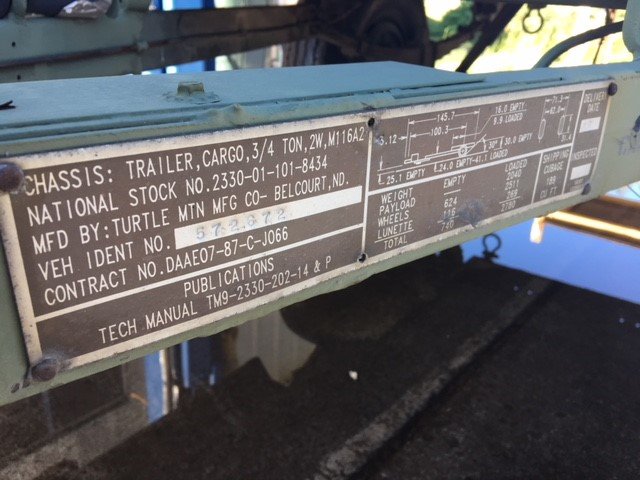

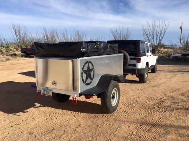

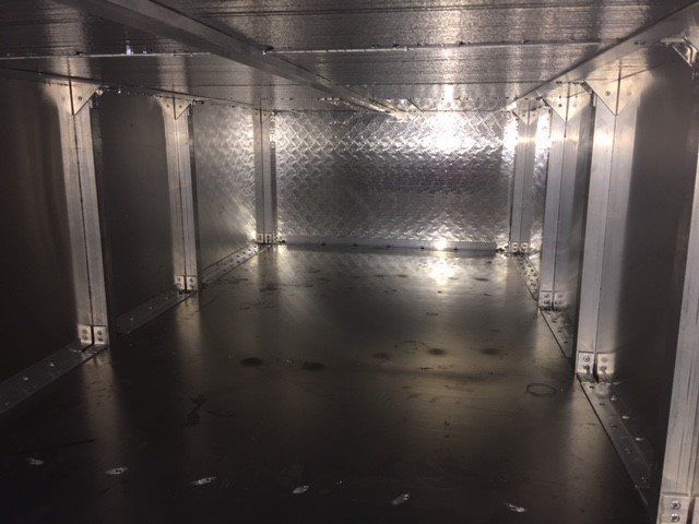

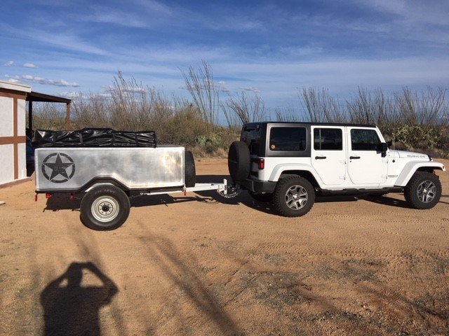

    Here is a pic of my M116A2. I decided to go a different direction and remove the steel top and build an aluminum box. I didn't like towing it with the 2017 Jeep JKU so I bought a 2018 Tacoma off road. Will see how it pulls next month. The Jeep was rated at 3500. The Tacoma is almost twice that. The weight of 740 minus the lunette leaves 624 pounds empty. Really uncle Sam?? and you put 8 lug wheels and a 9k axel on it. These are crazy built!

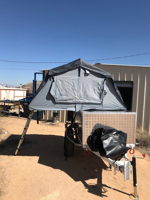

    A few more....
