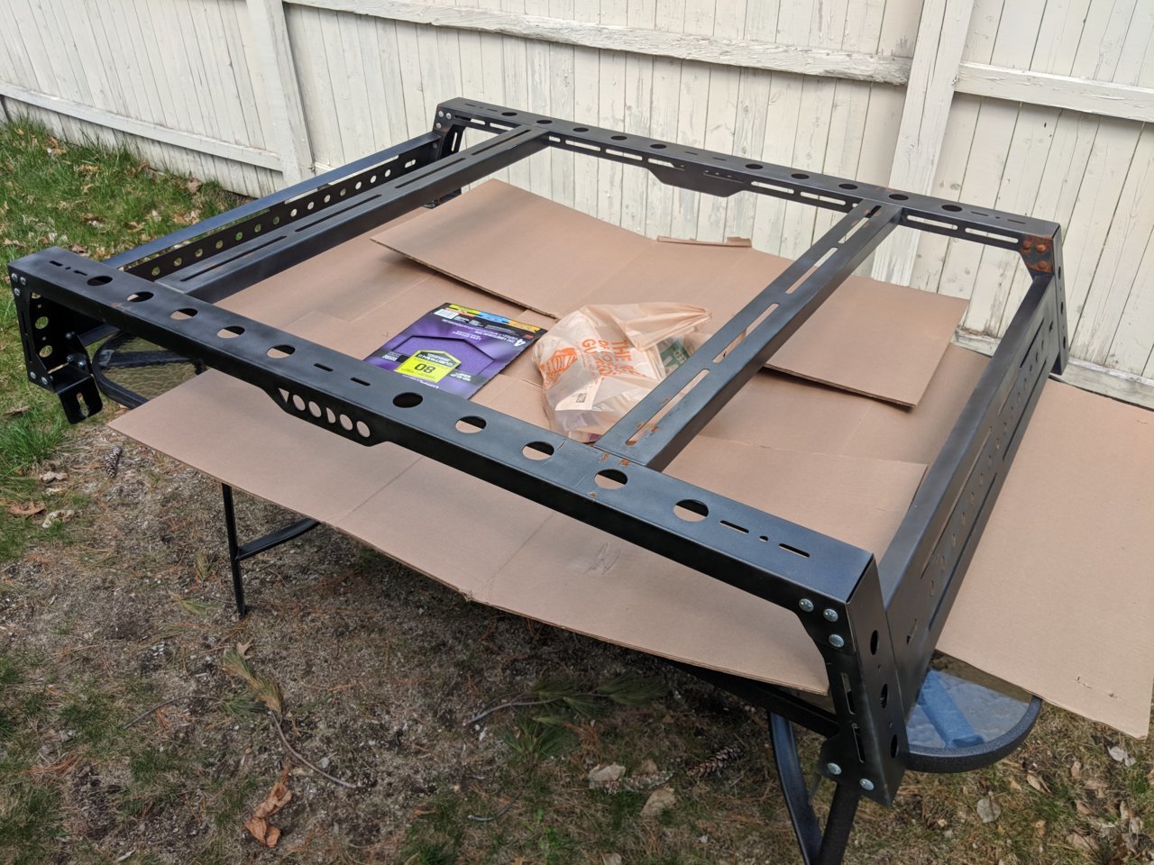

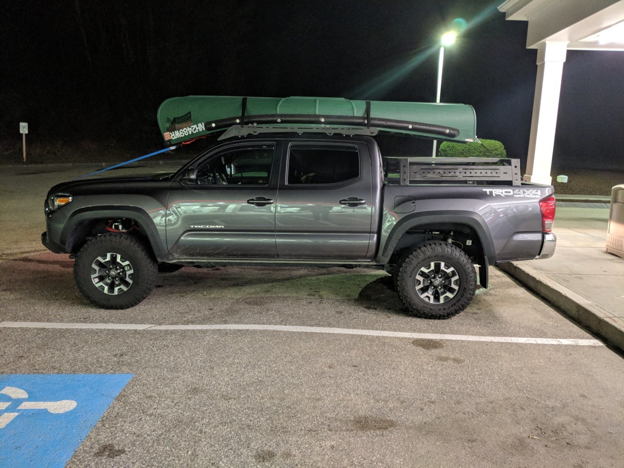

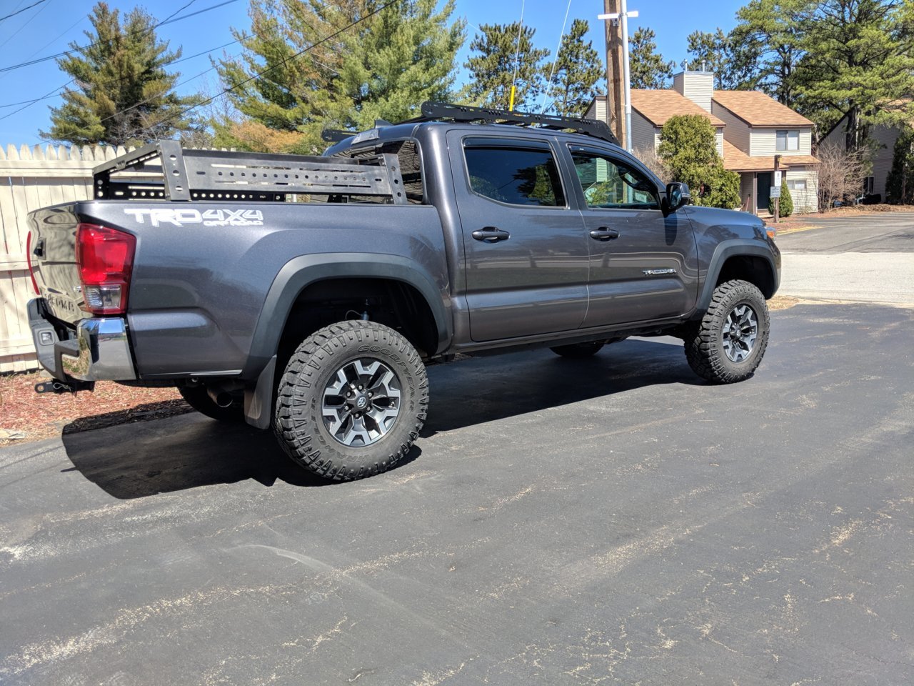

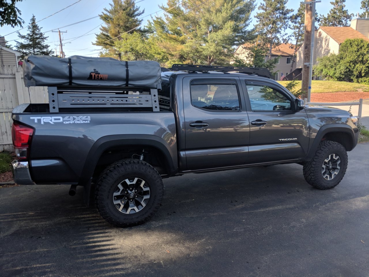

    love the prinsu with the kb voodoo combo look. I have the bed rack on the way.
    how did you mount the tepui to the bed rack? Are the bars on the tent perpendicular to the tail gate or parallel? thanks

    You can mount the rails on the tent any direction you'd like. I put shorter caraige bolts in the slots and just used fender washers and nuts in the rack channel slots

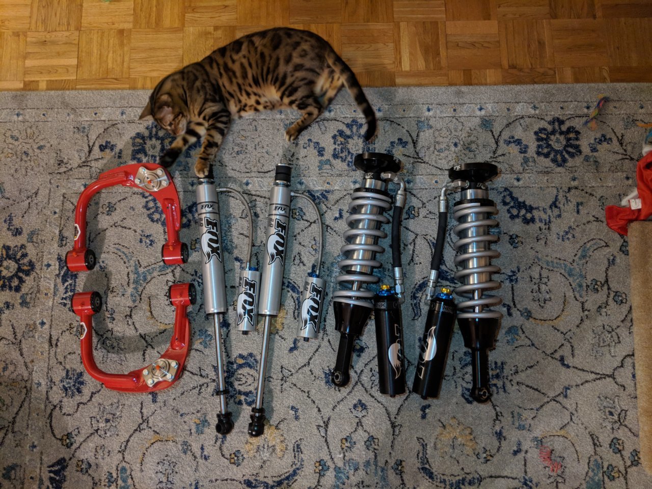

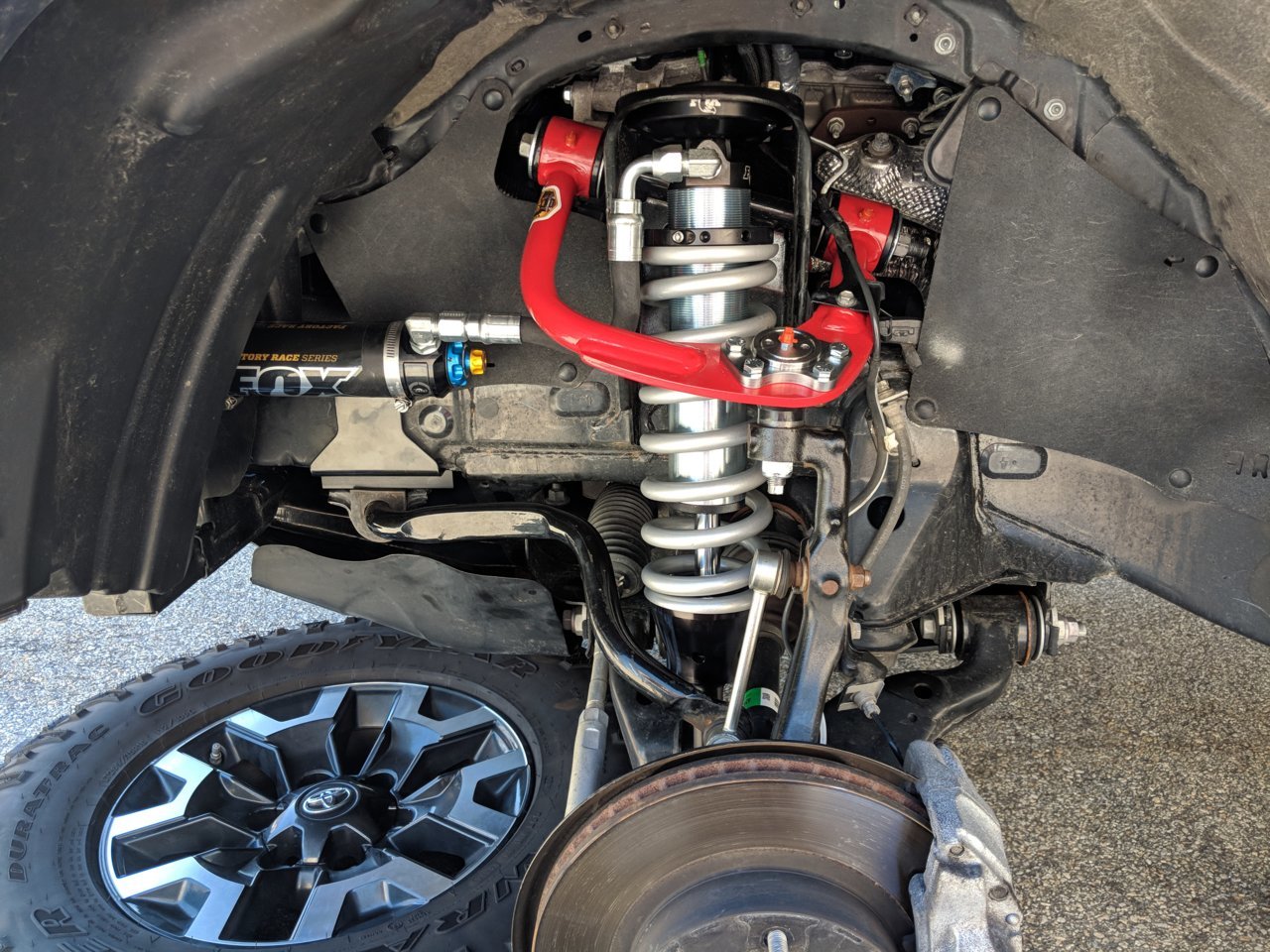

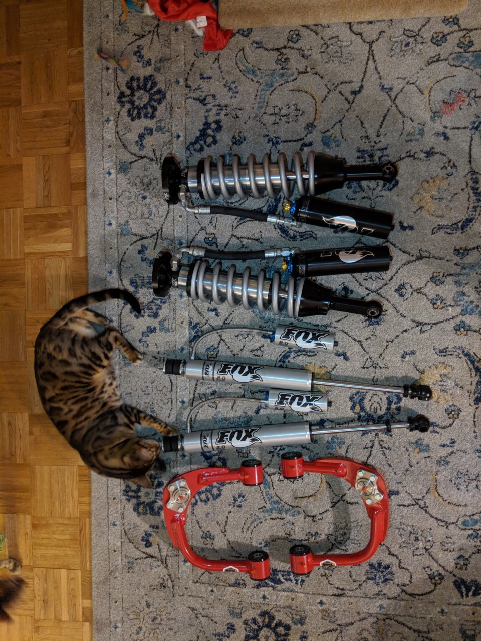

    Cat approved. Fox's going on Friday and Saturday if I can get in for an alignment sat

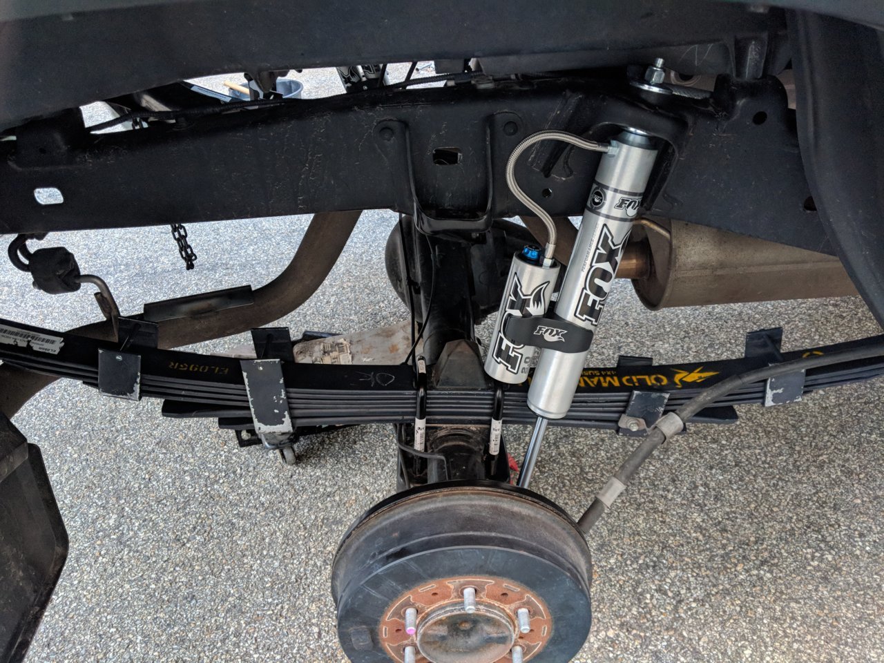

    Busy weekend for sure. Now all that's left is to set the front end up and get an alignment

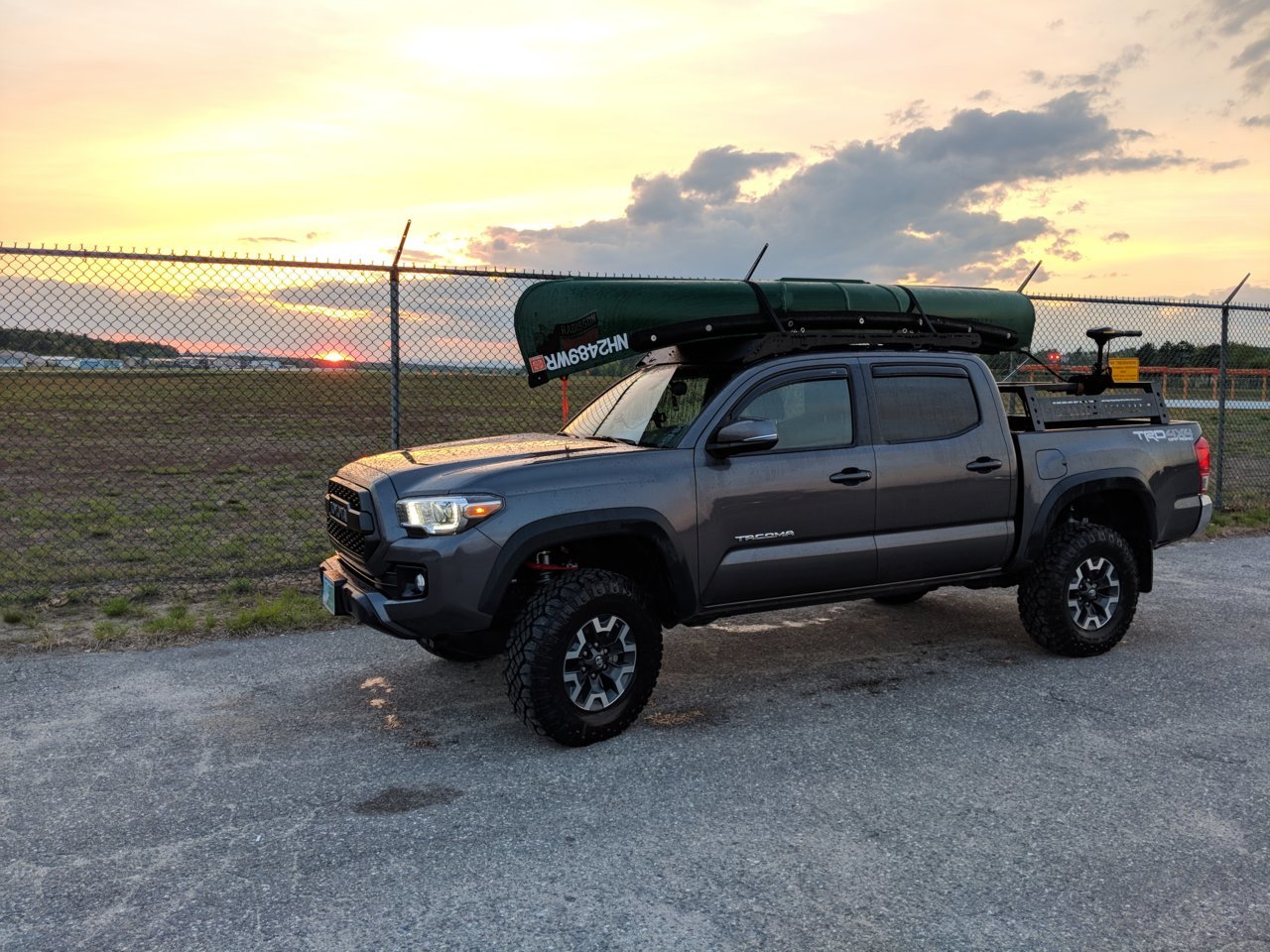

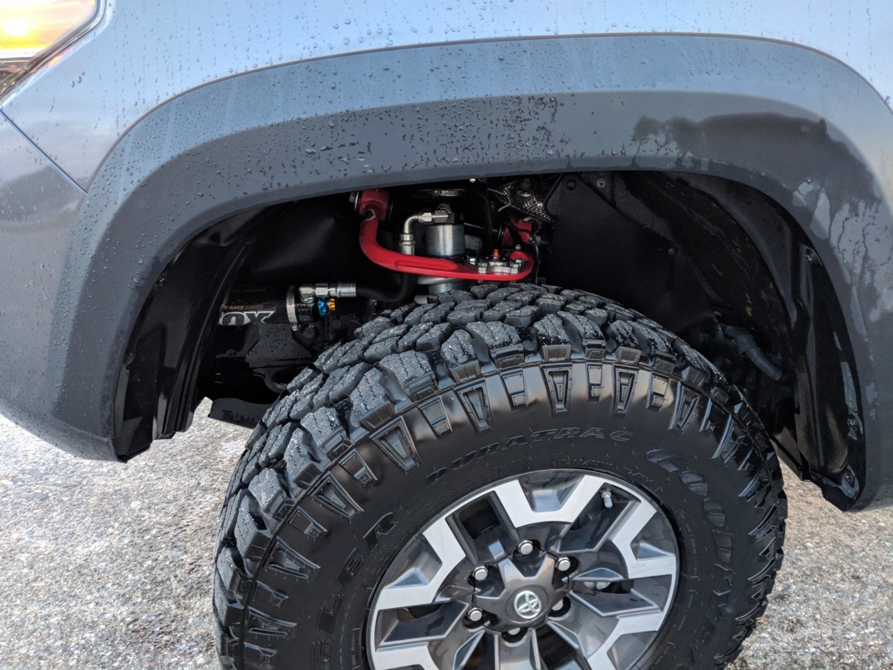

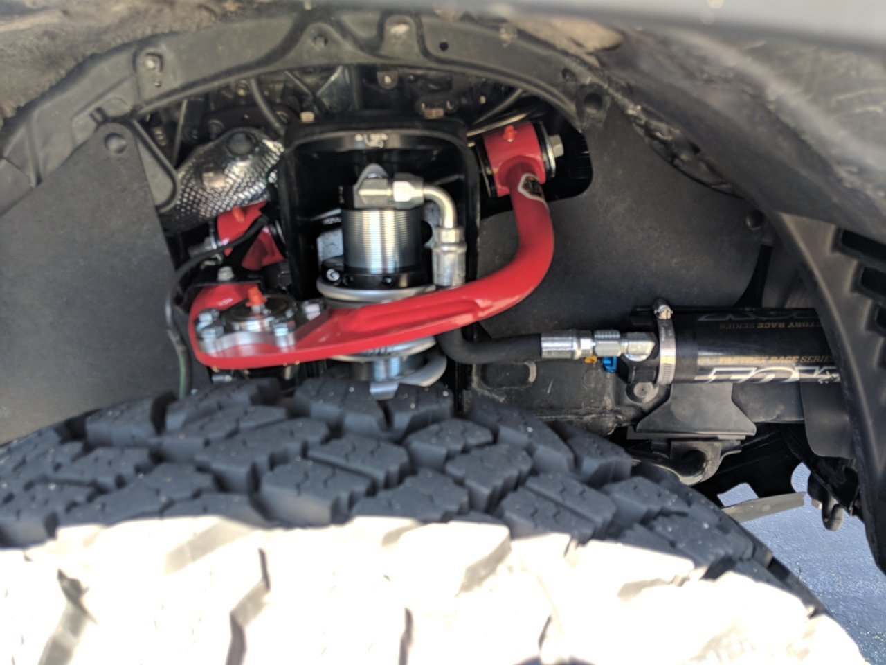

    Well. Here she is. Off for an alignment at 2:30.
    Front went from 20.5 to just under 23 with about 1-3/4" threads showing on the coil overs.
    24.5 in the rear.

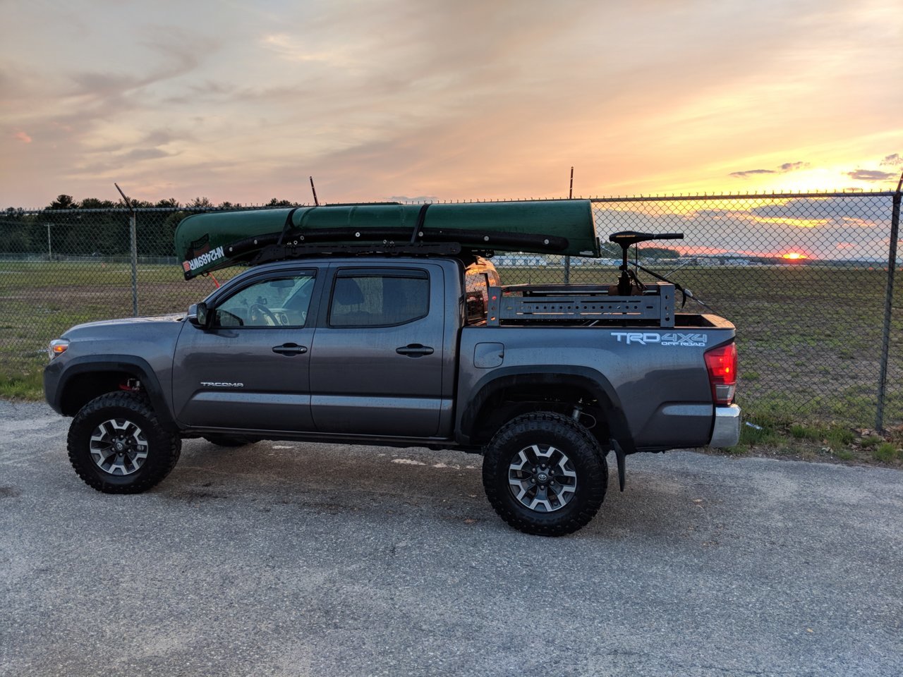

    More updates. Remote lake fishing tomorrow. 9:45-4:45 am shift the running north!

    Did the trolling motor help with any mpgs?
  15. May 20, 2018 at 10:16 AM
    #55
    m603holden
    m603holden [OP] @Koditten Pirate Radio member #063
    Oct 18, 2014
    #140581
    11,480
    Marteeen
    New England
    2017 Tacoma DCSB OR MT
    Lots of sail boat fuel
    For sure. My shoulder got cramped reaching that far back though.
    Was pleasantly surprised with how secure it was going through the trails.

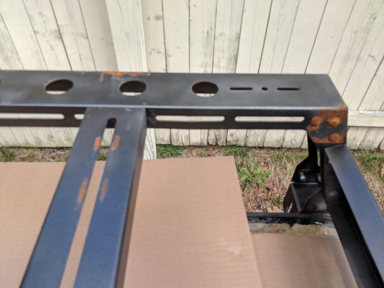

    Almost ready for another year !
    Screenshot_20180602-170323.jpg IMG_20180603_155905.jpg IMG_20180603_174425_1.jpg
