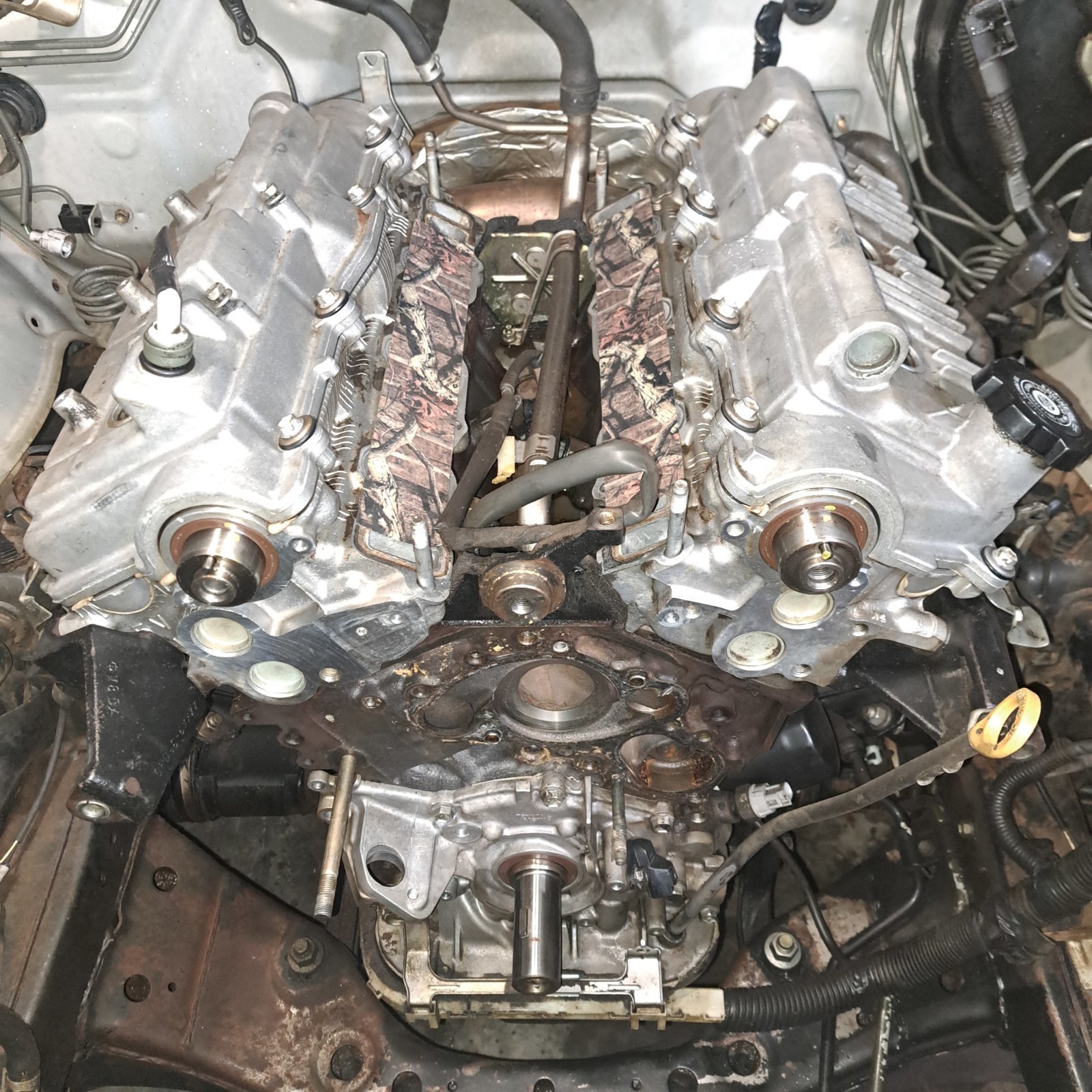

  15. Apr 13, 2024 at 9:36 AM
    88tacorunner
    88tacorunner [OP] Well-Known Member
    Apr 5, 2024
    #447315
    46
    Austin
    97 tacoma r150 lx 4wd
    5100s trd fj wheels sr5 buckets
    the 02 after major cleaning boutta week ago.. heads ready to come off.. i love to get everything spick an span as possible before i start tearing inside.. i cud be ocd... used the old 6 point E6 or E sumthin sockets to remove the manifold bolts an then it just drops down a hair an no exaust removal required..thats awesome...
