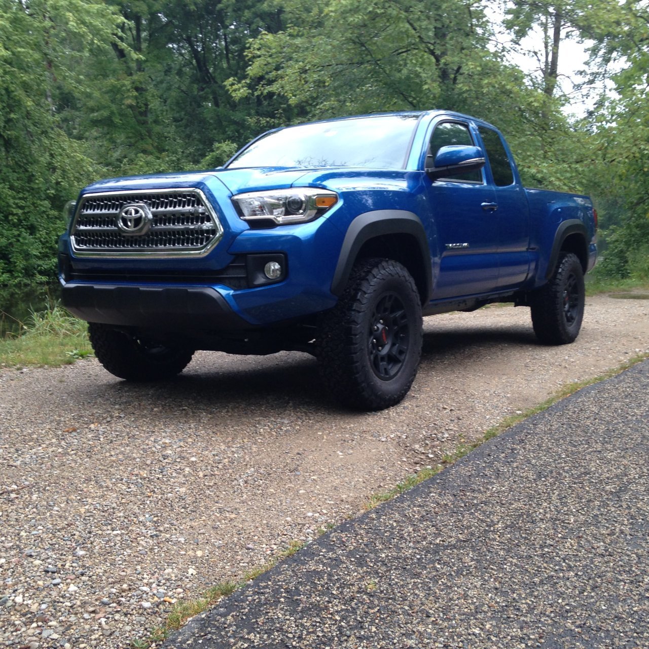

    I entered a local Toyota dealer in the summer of 2016 looking for a TRD offroad, accesscab, in one of 4-5 different color choices. I gave a deposit for the truck, listed the color preferences in order, and left them the job of locating me a truck. For the 2nd time in my life I got the song and dance about ordering a truck, 3 month waits etc. and after reading about Toyota allocations vs orders, I did the work myself. I was on vacation in northern MI and found a dealer in central OH with a BBP accesscab. I worked a deal via email and phone and arranged to drive down with a trade the next week.
    I also ordered a set of 4R TRD Pro wheels after finding one of Ramonortiz55 ebay group buys. This would be just the first of many group buys.
    The wheels arrived on a Wednesday, and I did not even drive down to get the truck until that following Saturday.

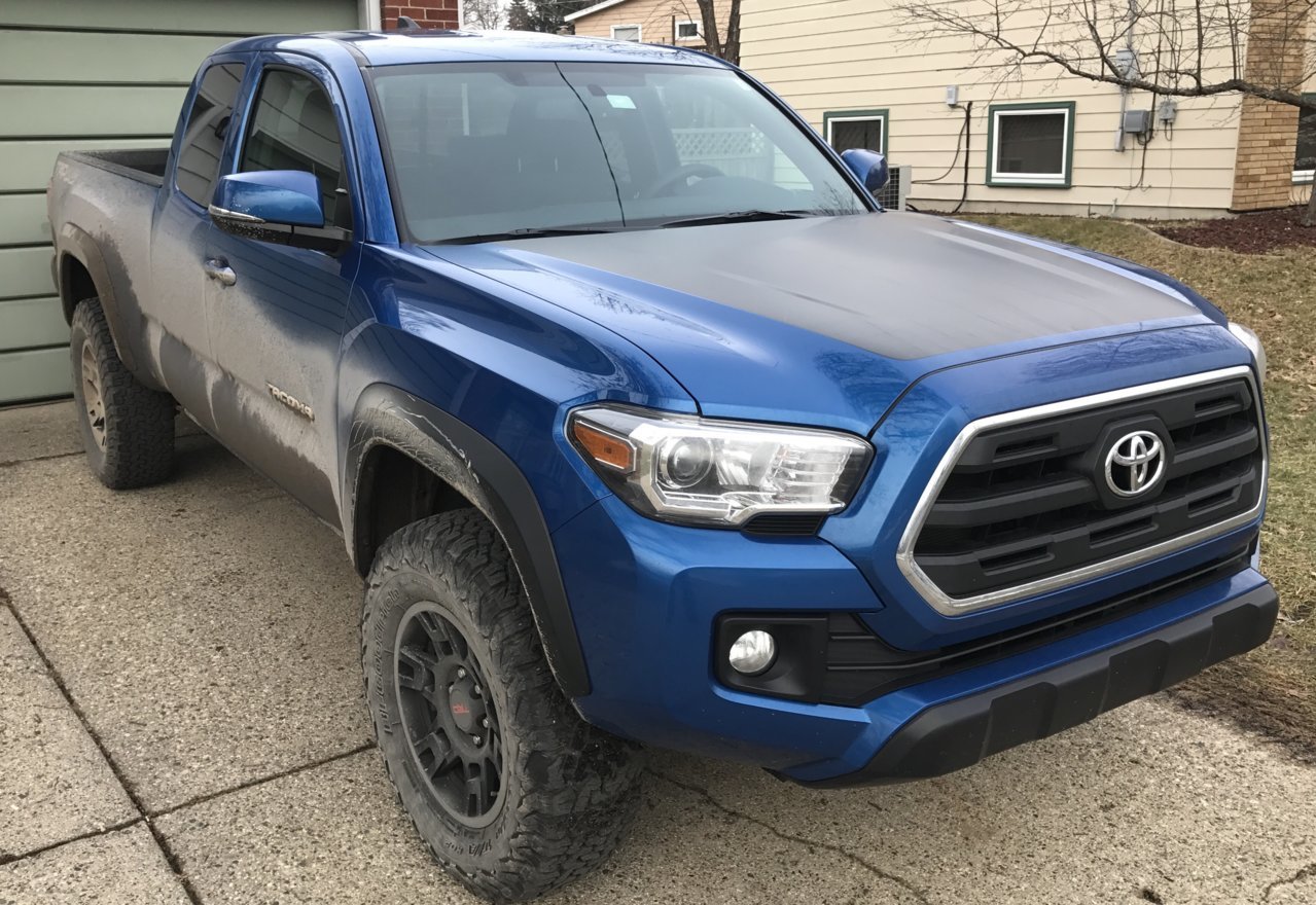

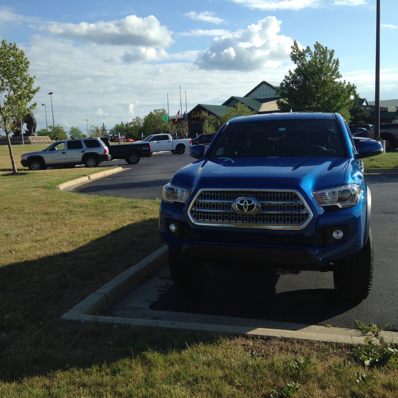

    Last and only real pic I have of the truck stock. Stopped at the biggest of the Cabelas in MI on the way home with the new truck.
    The Monday after I got the truck home was game time for new tires and the 4R Pro wheels. Went with BFG KO2 because I have run about 5-6 other sets of previous vehicles and I am unoriginal as hell.

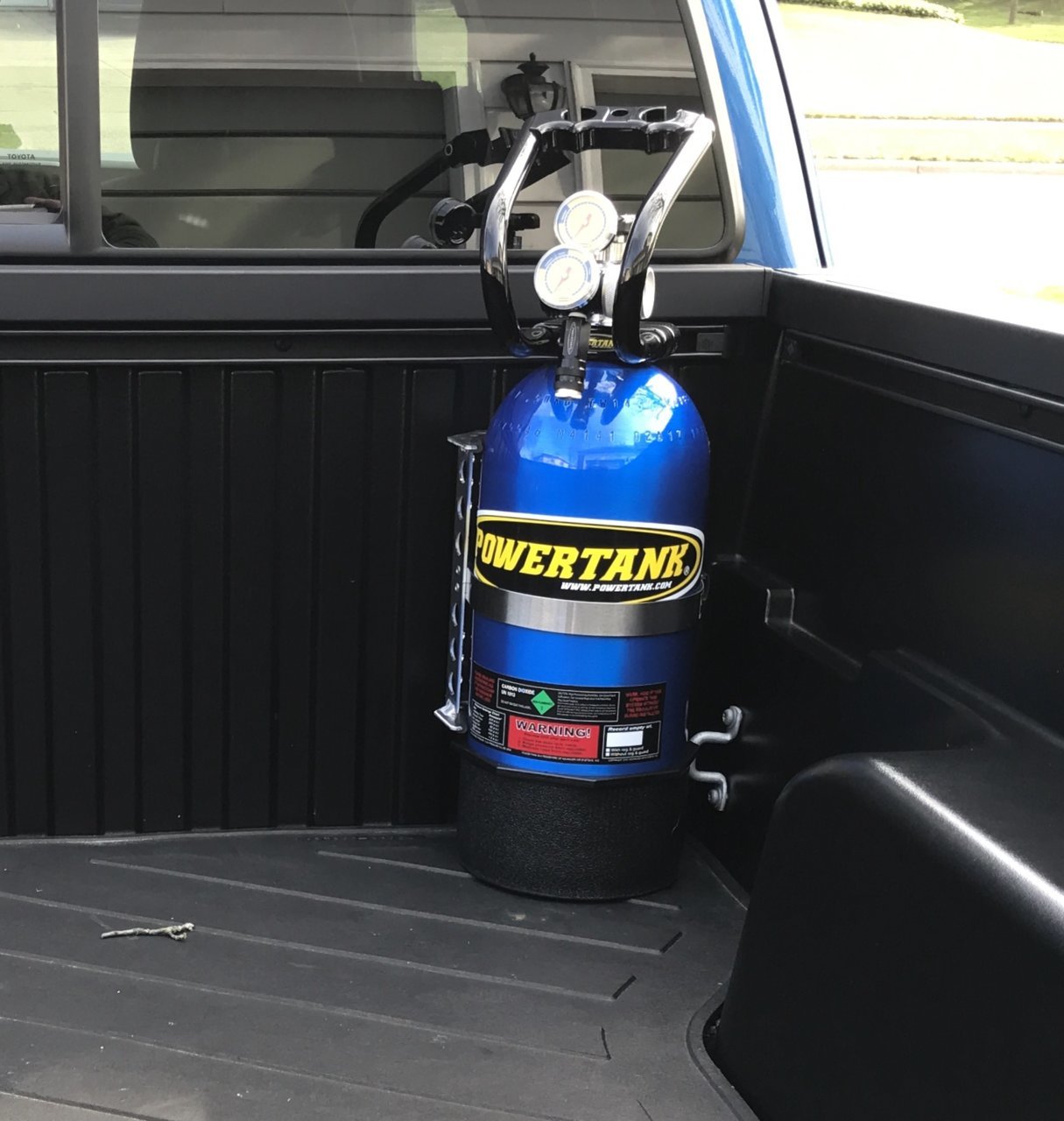

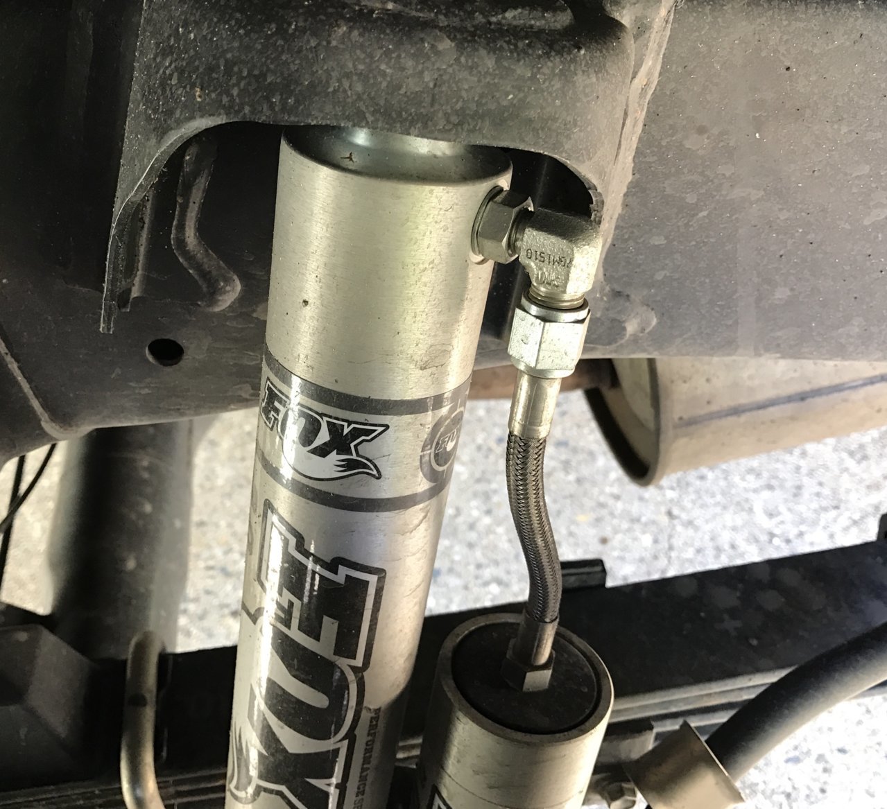

    Time to go suspension, I got ahold of Marie at Headstrong and got some Fox and Camburg. 2.5 Fox DSC extended front and 2.0 Fox rear with Camburg ball joint arms.
    It has been my experience that when airing tires back up from offroad, CO2 is way faster than any compressor. So I picked up a Powertank in a matching blue to carry around.

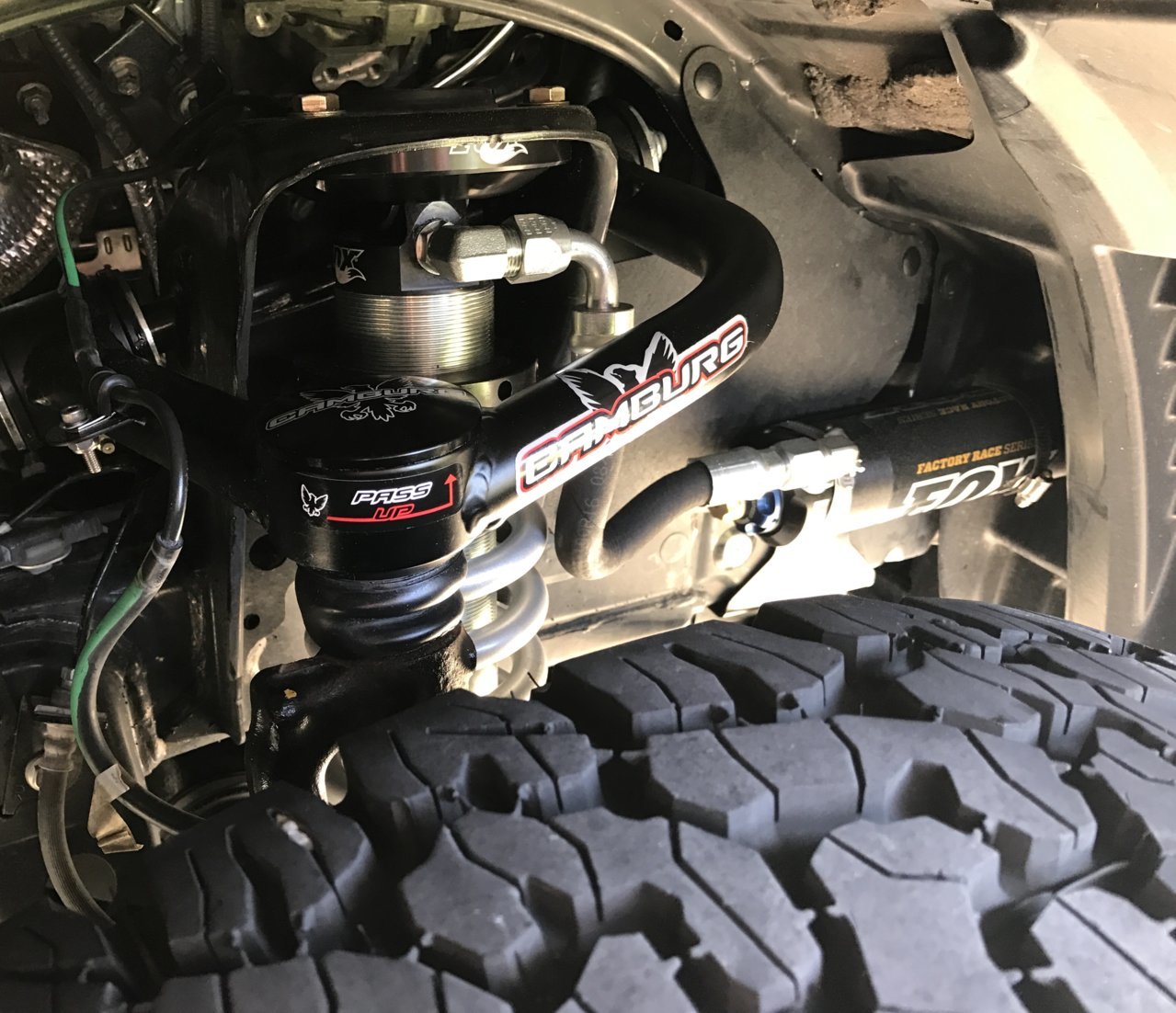

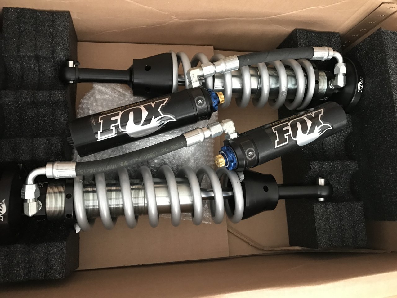

  6. Nov 30, 2018 at 5:13 PM
    machspeed
    machspeed [OP] Well-Known Member
    Jul 2, 2016
    #191087
    437
    Michigan
    2016 Tacoma TRD Offroad 4x4 Accesscab

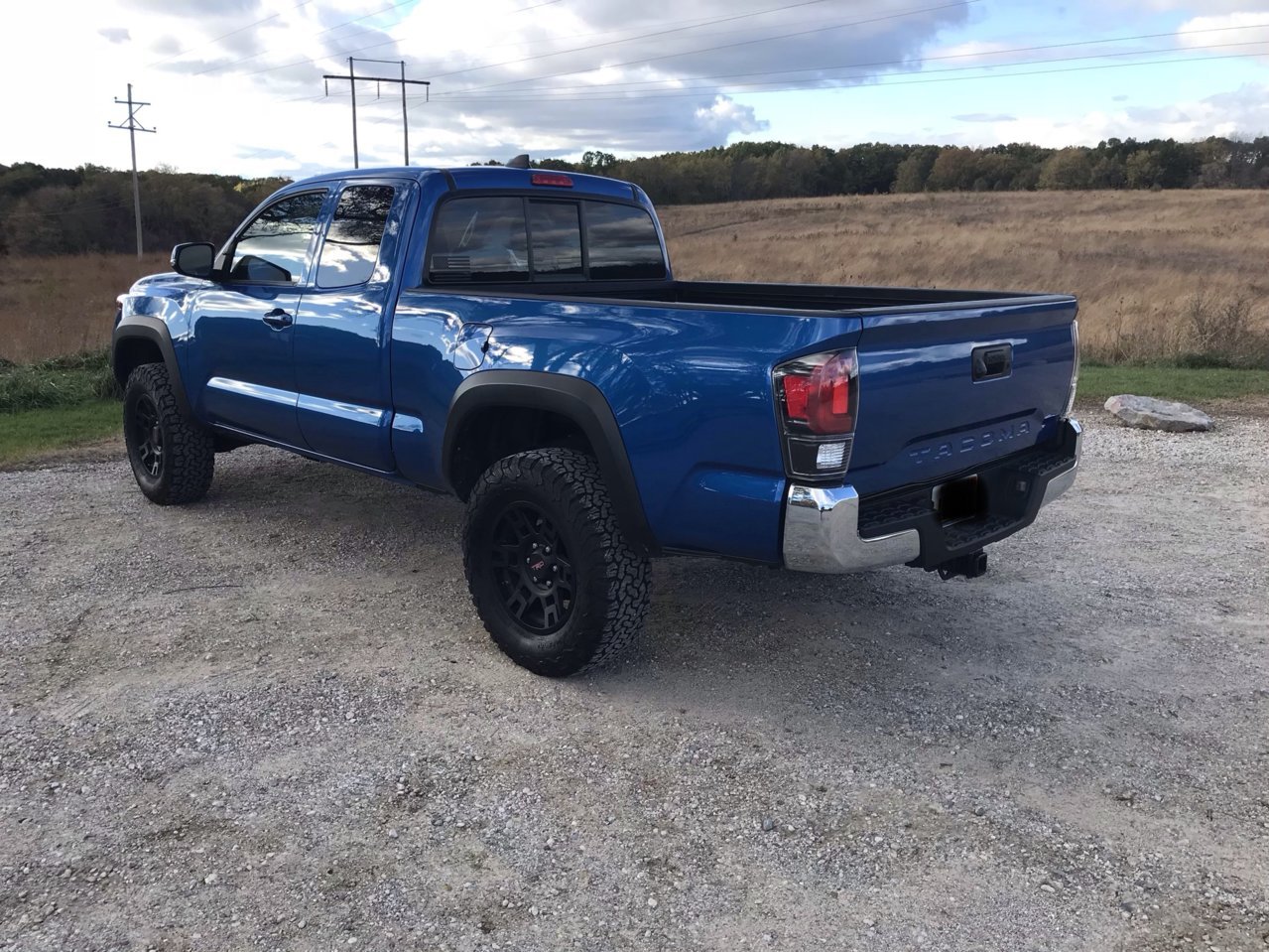

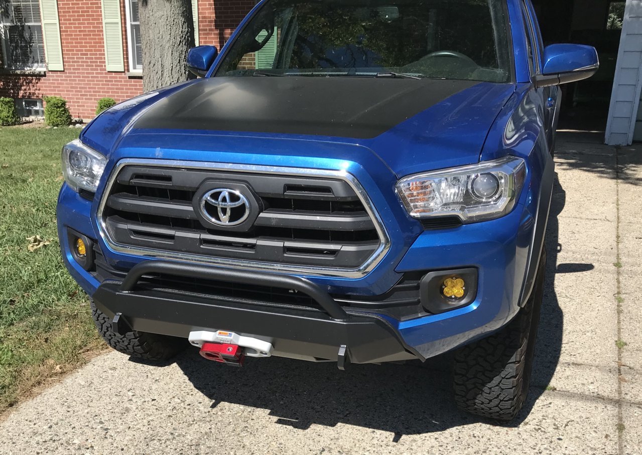

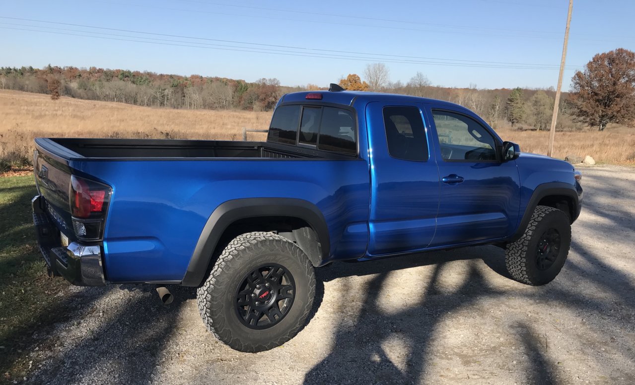

    It took me almost 2 years to get the SSO bumper powdercoated and installed even though I had it and the winch in 2016. Swapped to SR5 fog bezels and added a Factor 55 Flatlink E around the same time. Also installed the Pelfreybilt aluminum midskid to match up with the TRD Pro aluminum front skid I had already installed. Somewhere before there brings the TRD Pro tail lights.
    Now the thread should be mostly up to date. Soon the parts will start to get slightly more custom and away from stock, but mostly keeping the theme for sure.

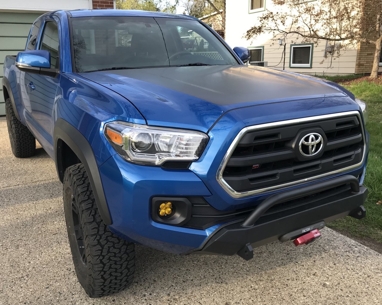

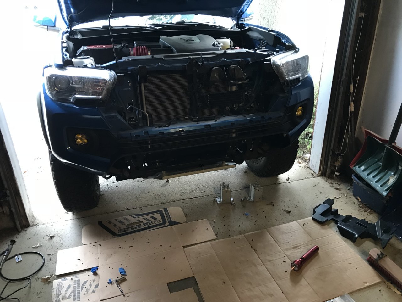

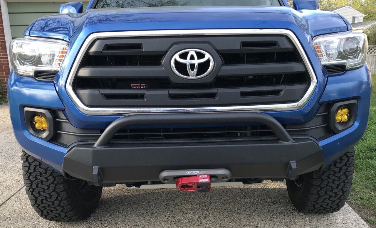

    One of the nicer upgrades I have made. I cut the bumper on the truck, and unbolted the factory parts thru the hole I made.
    Only 2 real issues I had during install were related directly to how I planned it out. Bolting the winch to the bumper was difficult since I have large hands and it’s a tight space. And hanging the bumper/winch on the truck solo was possible, but would have been easier with another person or two.

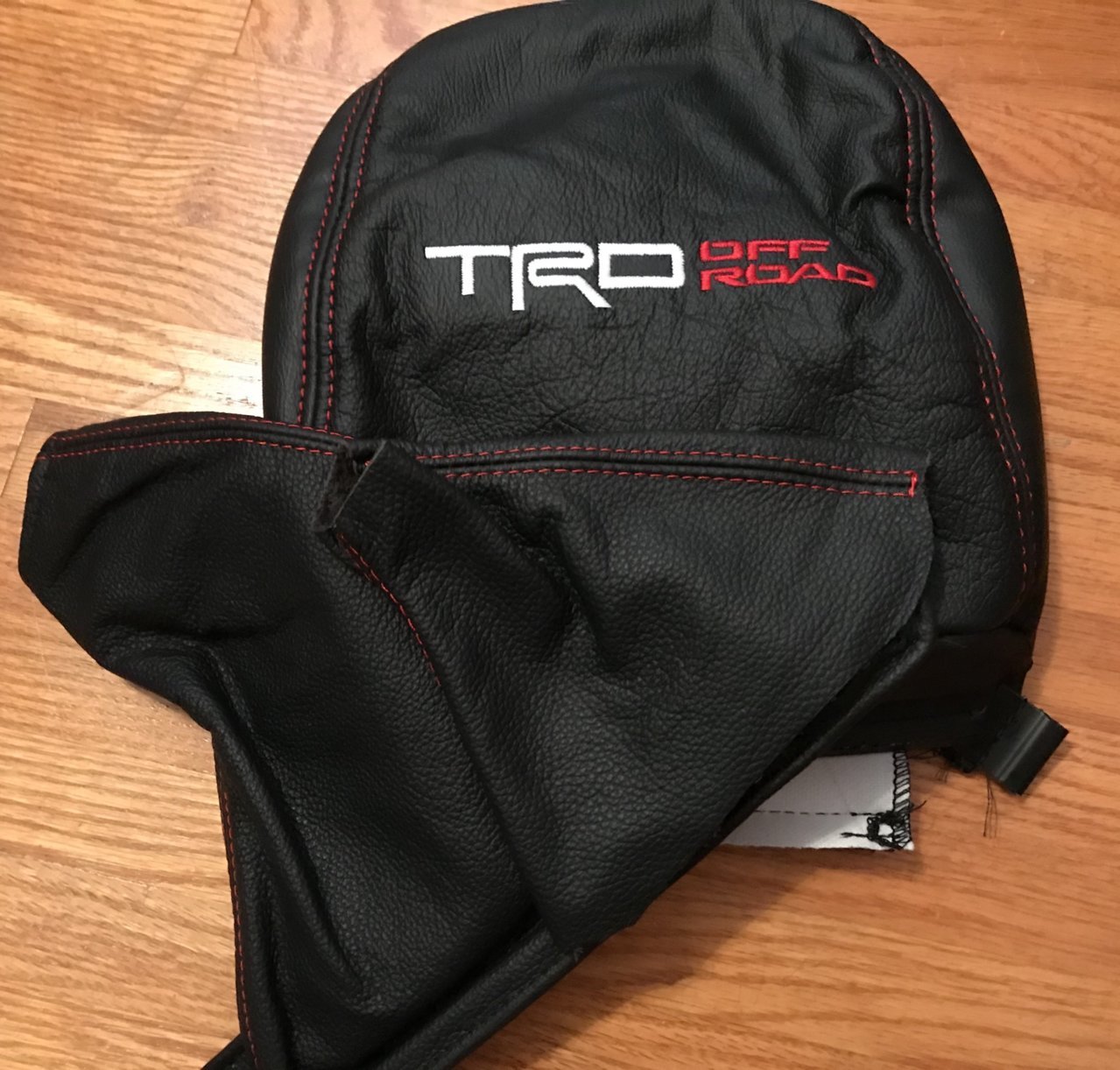

    And the process begins. I am not looking forward to the front seat cover install, but the end result should be worth it.

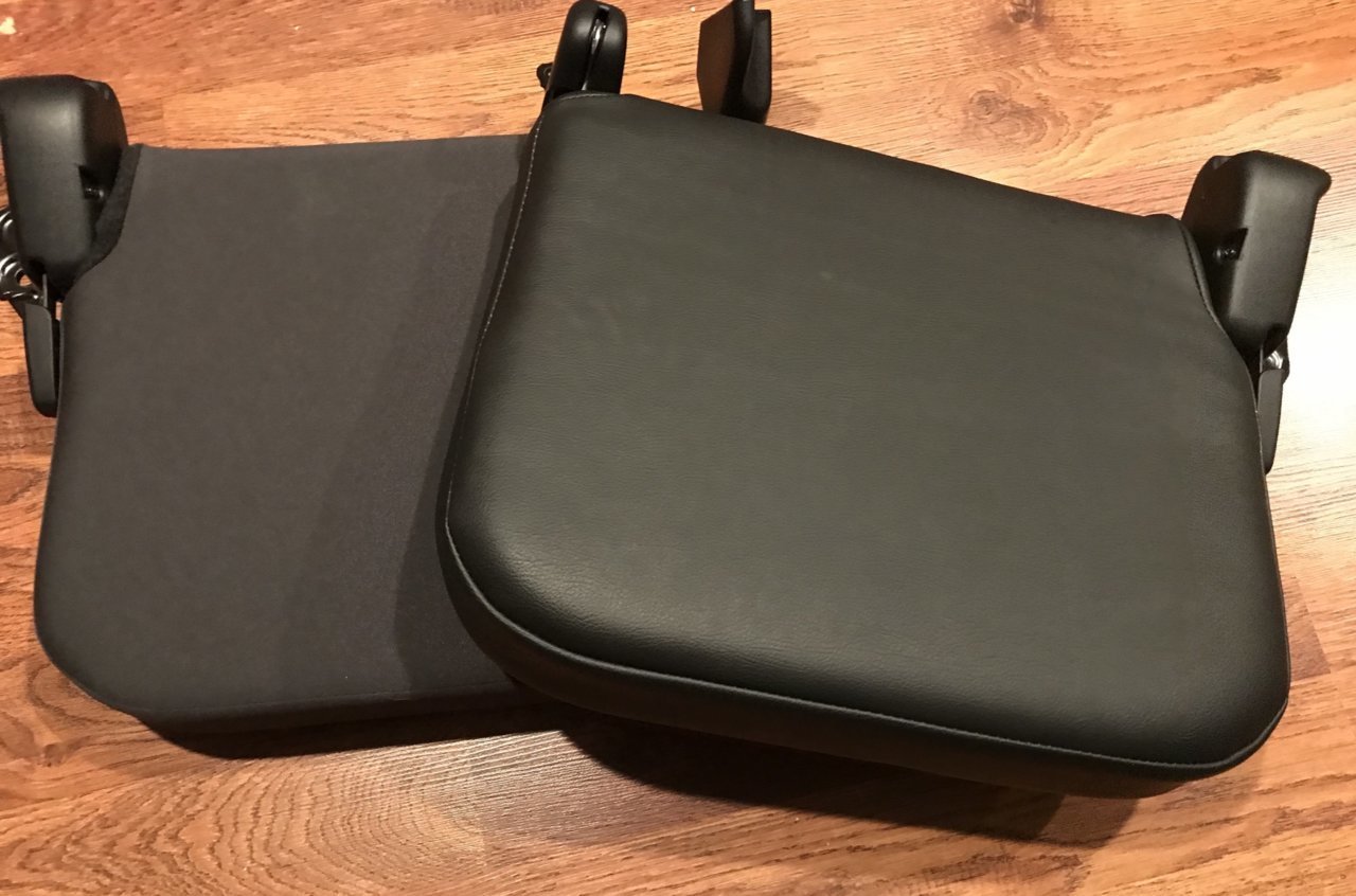

  13. Dec 18, 2018 at 7:00 PM
    machspeed
    Jul 2, 2016
    #191087
    437
    Michigan

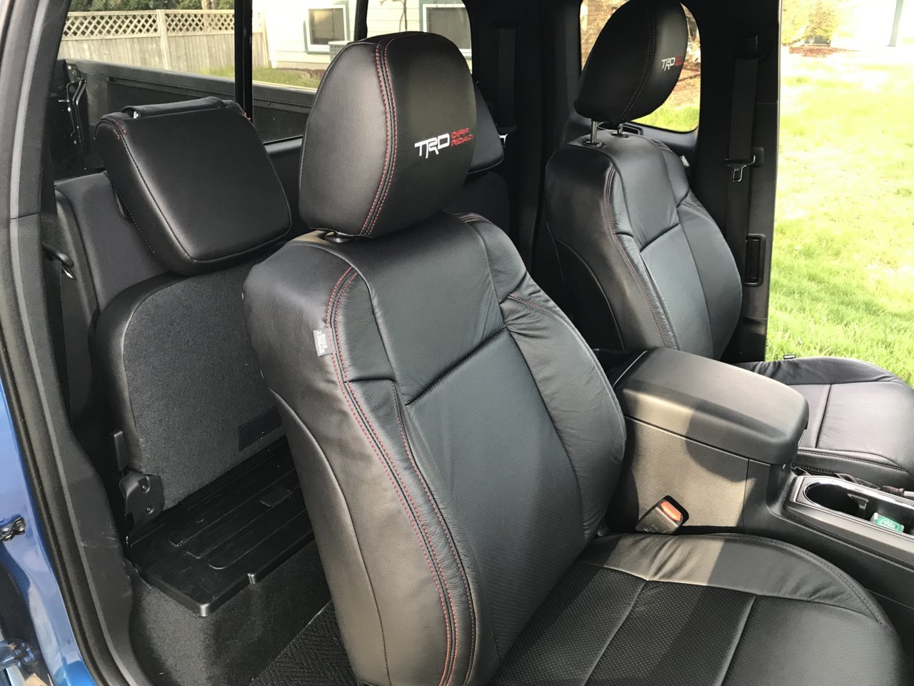

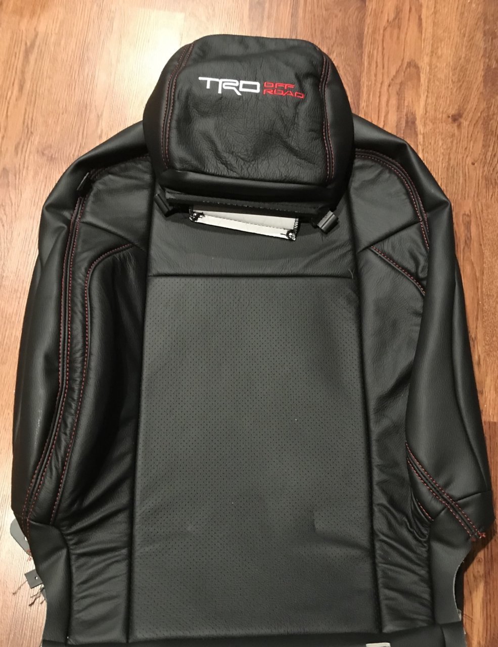

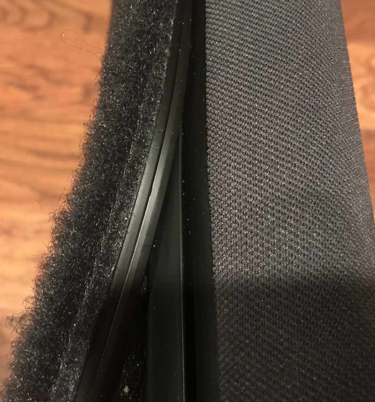

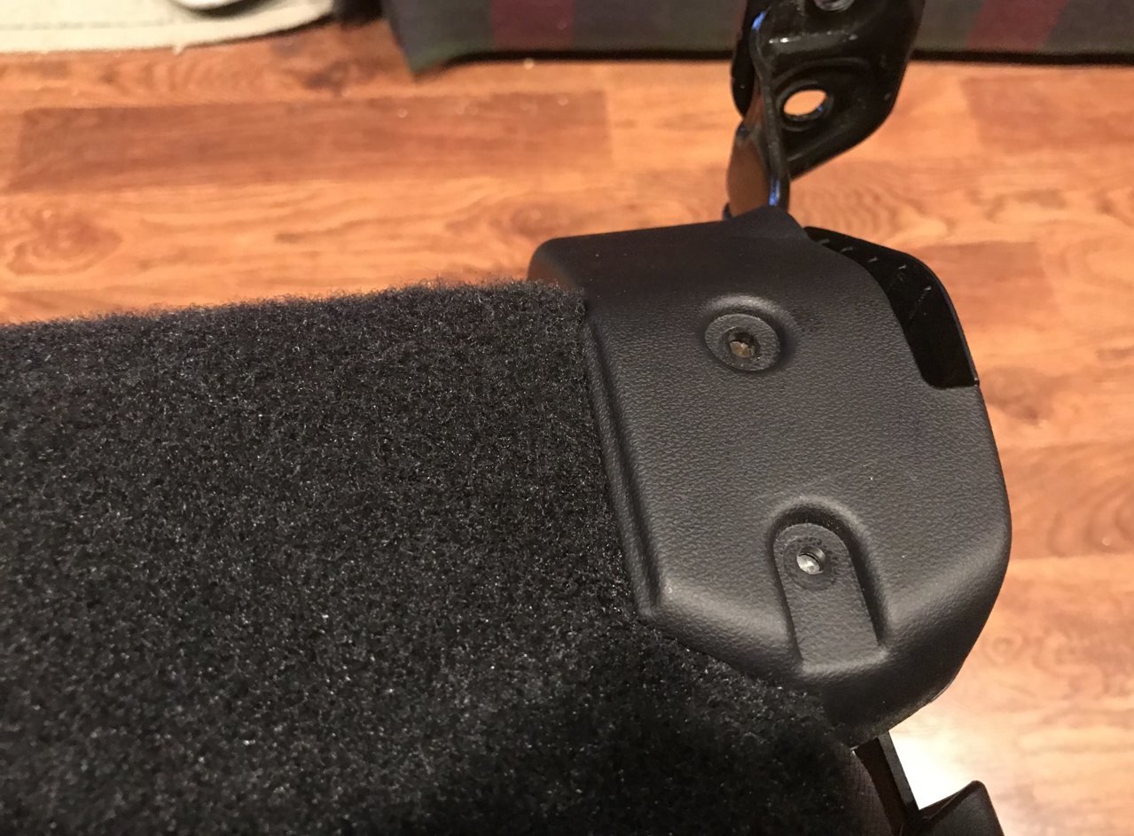

    Since I could not find many / any accesscab Katzkin install pics before I ordered, I will add some info as I slowly move along with this process.
    3rd gen accesscab jump seap bottoms are held in with three bolts each (12mm socket)
    Each jump seat bottom hinge has a cover. The non-lever side uses one phillips screw and removes easily, the lever side has four phillips screws, and it locked together with three tabs inside. You do not have to completely remove this cover, just remove all 4 screws.
    The upholstery just unclips along the tucked in stripped at the rear of the jumpseat, and the Katzkin lower cover is a direct replacement. Note the placement of the extra flaps and tabs in the upholstery when removing the factory cover.

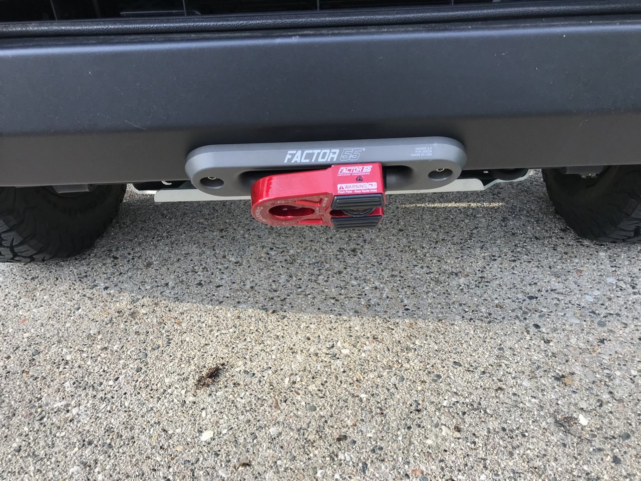

  14. Dec 24, 2018 at 10:47 AM
    machspeed
    Jul 2, 2016
    #191087
    437
    Michigan
    A couple more items I ordered arrived to get the truck tricked a little more. Probably try to install some parts next weekend when I am not so busy.
    The boots are a pretty good match if you ask me.
    And the Factor55 fairlead is a little more low key than the big and bright Warn fairlead

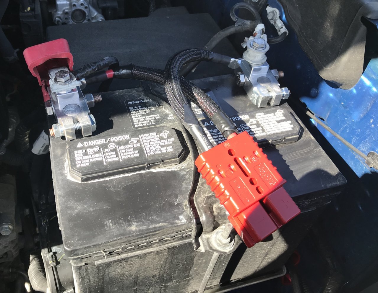

    If anyone else is only a part time wheeler like me, this is a good option to connect or drop power to your winch versus leaving it powered full time. With MI loving salting roads and use/abuse, I always have a distrust of a winch without a quick power disconnect.
    SDHQ battery terminals and a Warn plug and a little wiring makes for a clean connection. I might double back and use drop the negative post for a cleaner install but that was nice to have.

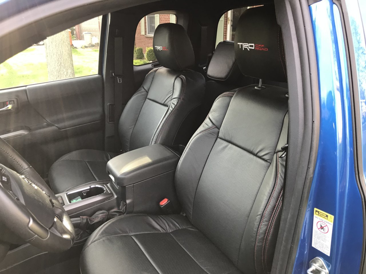

  16. May 5, 2019 at 1:50 PM
    #16
    machspeed
    Jul 2, 2016
    #191087
    437
    Michigan

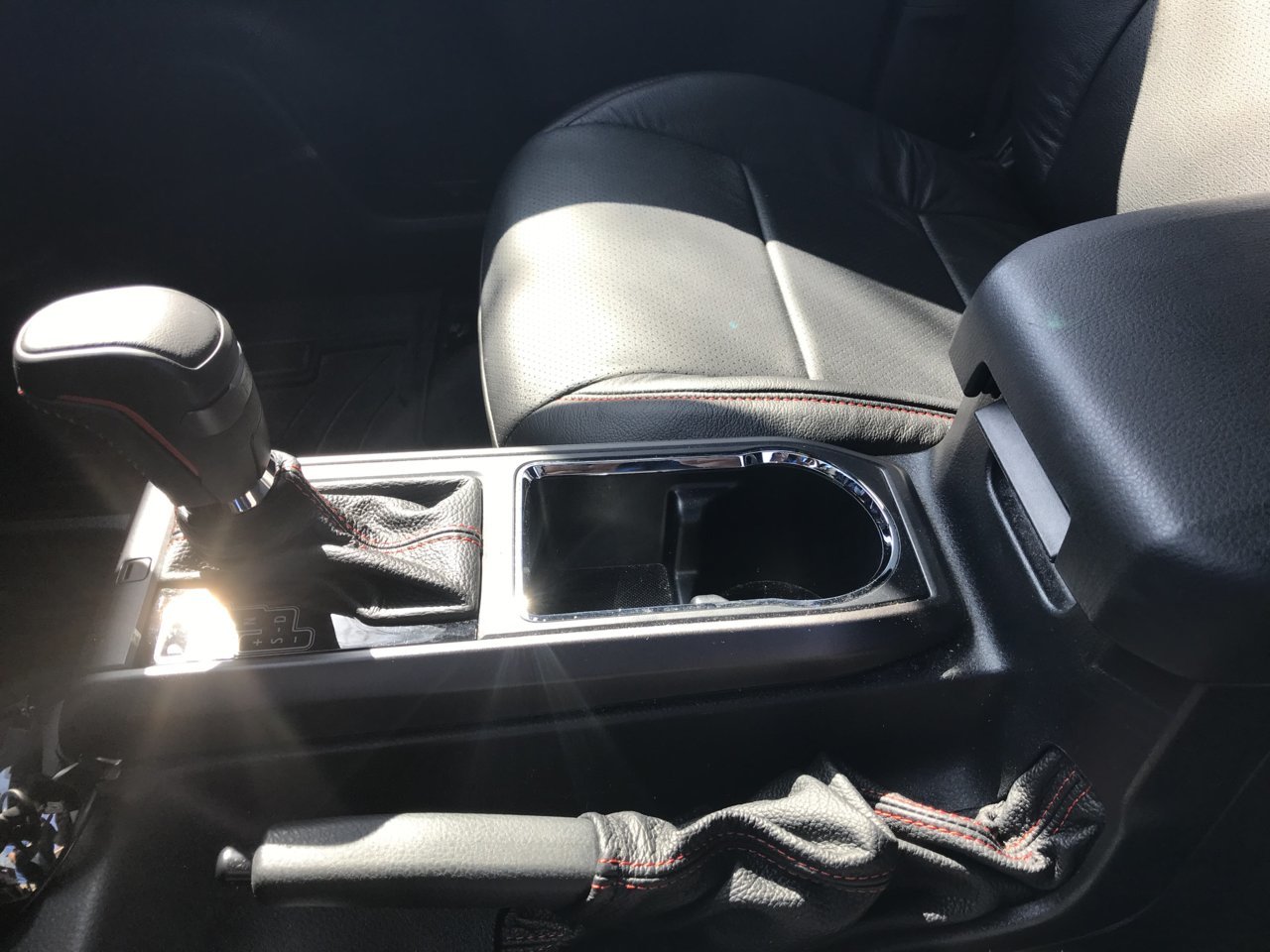

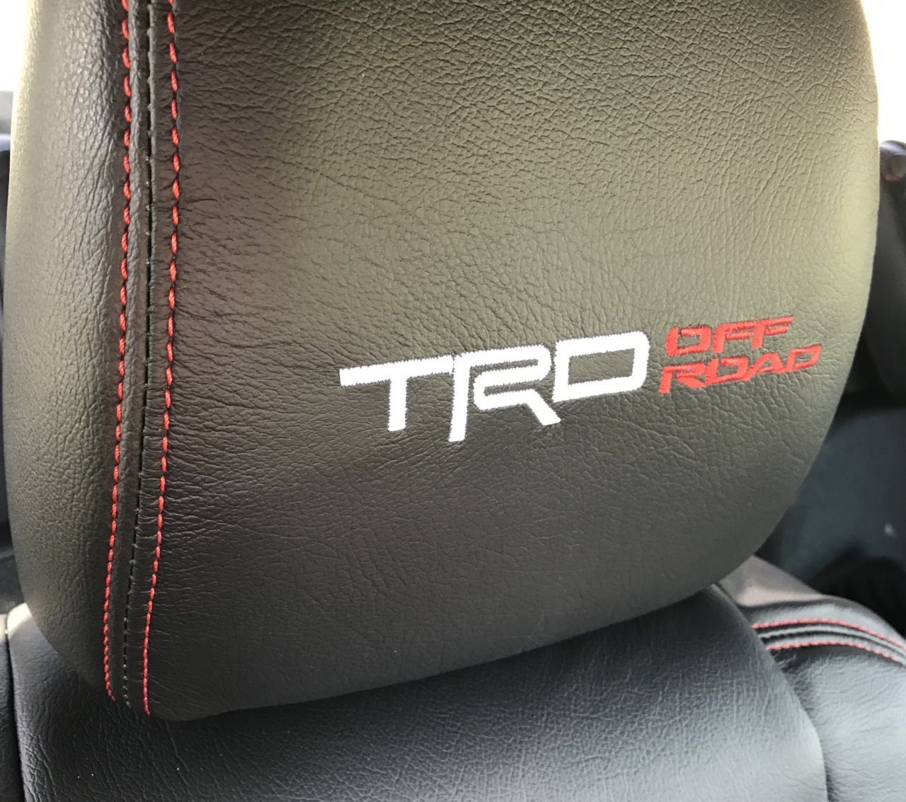

    Finally made progress on the Katzkins. Rear lowers and headrests are done. Passenger front is also done, just need drivers seat to finish.
    Also installed the matching shift and ebrake boots. Installed these first which is how I ran out of time for the drivers front.

  18. May 7, 2019 at 4:25 PM
    #18
    machspeed
    Jul 2, 2016
    #191087
    437
    Michigan
    Finished up the driver seat and now will start working out the wrinkles. Also have to wire in the seat heaters but with summer weather approaching that will hit the back burner.
    Also swapped the Warn fairlead for the Factor55, much better looking imo.

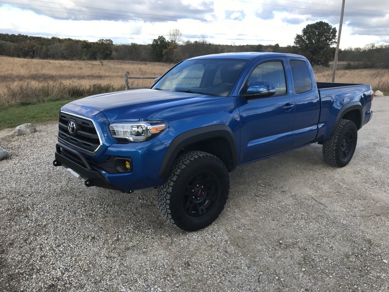

  19. May 7, 2019 at 4:27 PM
    #19
    machspeed
    Jul 2, 2016
    #191087
    437
    Michigan
    Also its impossible to tell at this angle, but the 285/70 KO2 tire are on. Bad driveway pose is all I have for now.
