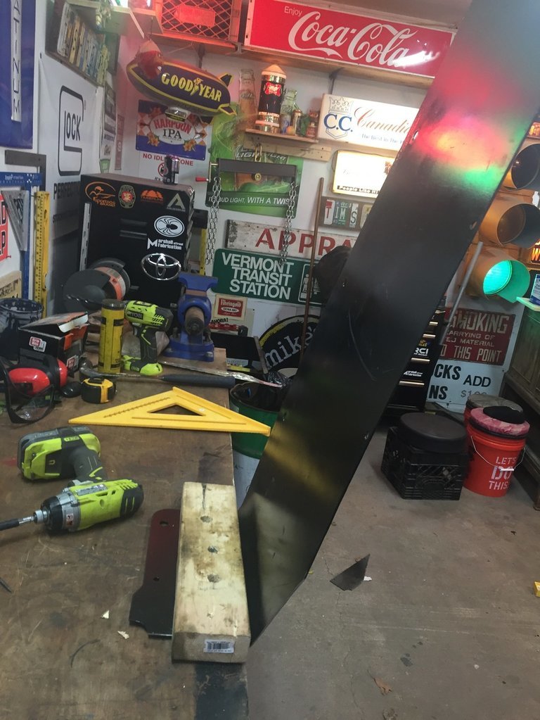

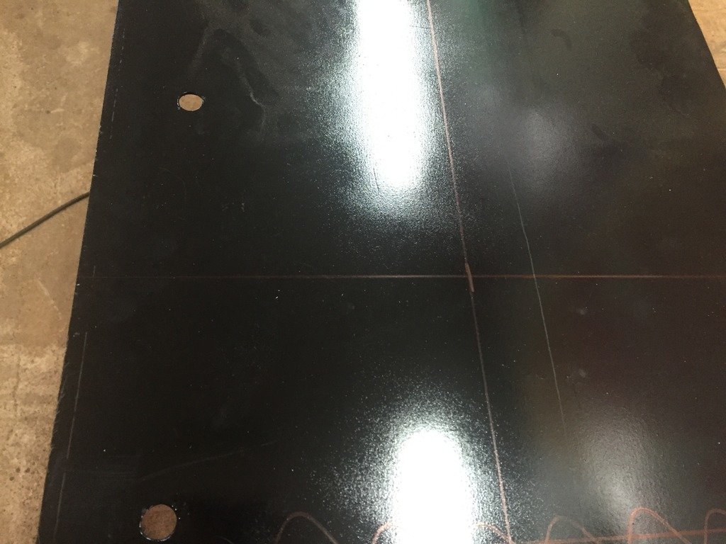

    I had a tailgate skin with the cap part cut off laying around. So, I figured I'd try to make a fuel tank skid out of it. I'm pretty happy with how it turned out.
    What I started with:
    BD04F952-1A26-489C-8C7F-AC336101F719_zps_3788eb07d04c83e5eebb5235274b44e065c83be6.jpg

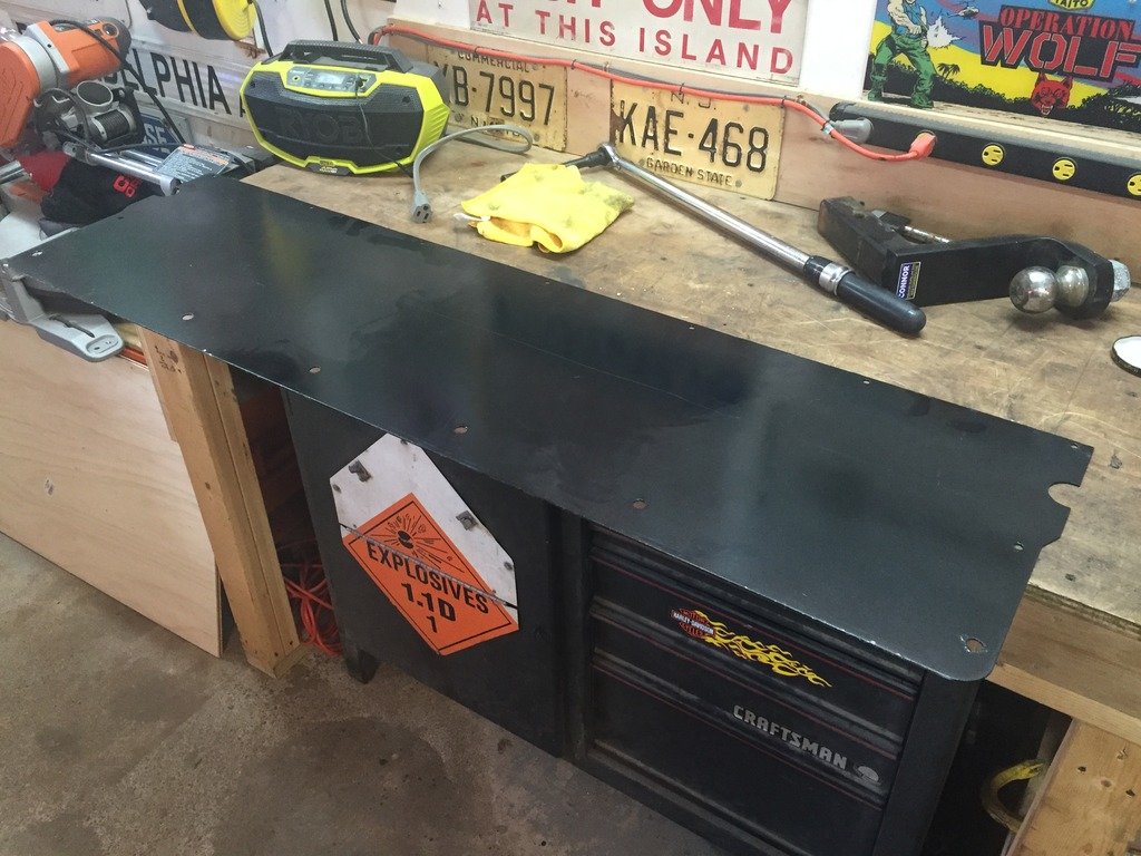

    First I found the centers of the plate and the tank so I'd have points to measure from.
    E48DDE2E-074F-49E1-B28F-95E3C30A1117_zps_95c6466bf7cf74be66e04d73b664dd92fb3bb57b.jpg

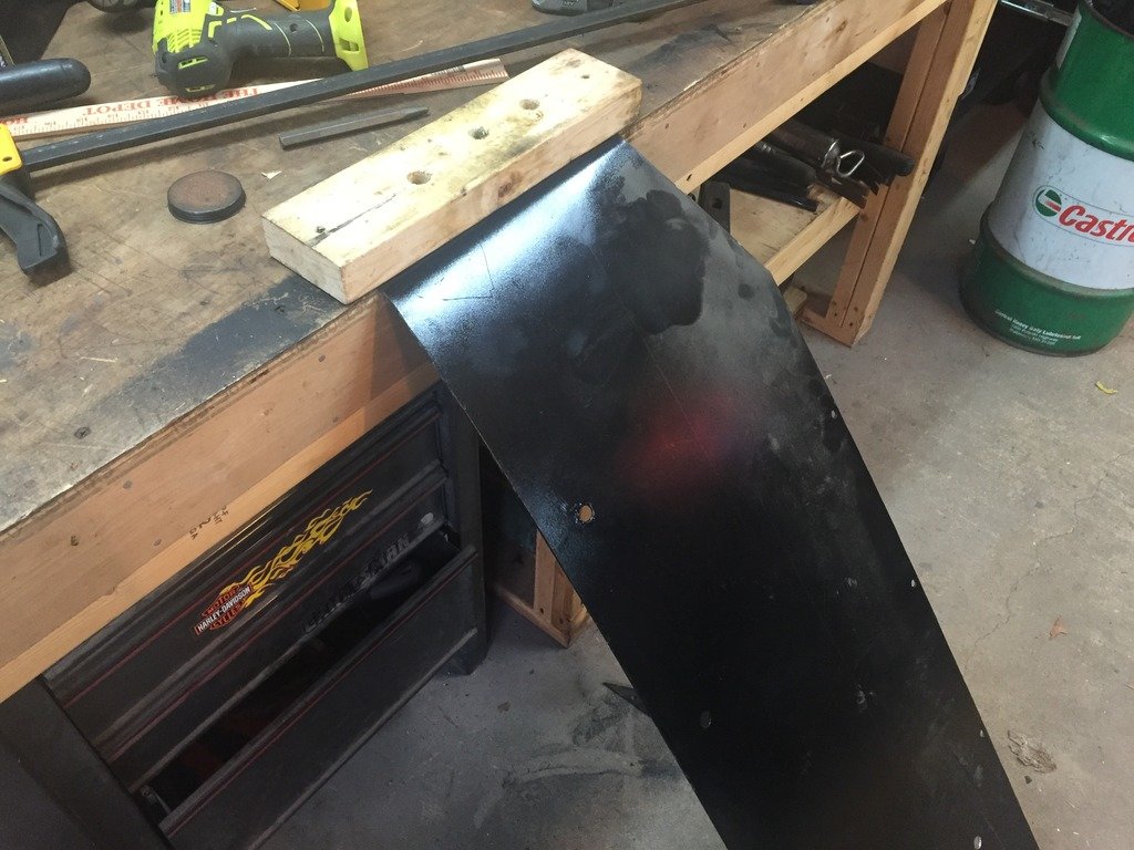

    Poor mans brake:
    002FDBDA-4BC1-4902-92A9-F623EB81516E_zps_00db8e9600e325bfa2fa358cc6a491491ea4af71.jpg
    3692F5F9-D7C7-47F5-9EC7-9240F57228CA_zps_461bb81771471a1258ca88afc2e4df52c8336d65.jpg

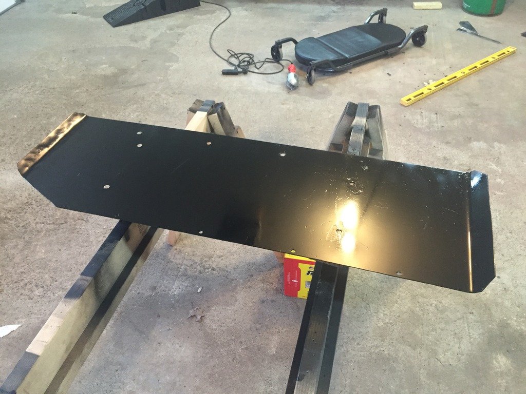

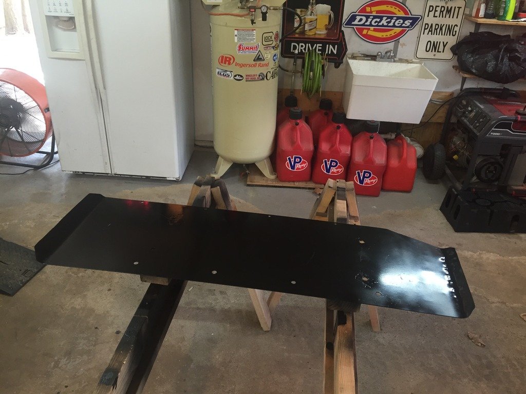

    New holes drilled, angles cut, bends made, fresh paint:
    F6E4EDB3-B771-4875-BCDD-D81E98A7AEB0_zps_4331557db79a00e9fc6270260345a36e968e43c5.jpg
    EEFB9AEC-71C7-43E5-953F-7CFDA07959F9_zps_32c27d56838e3cd30d94a770de9337561cd2067d.jpg
    Tomorrow I'm going to pick up some washers and nuts to bolt it on. The tank is indented where the tank straps are. I'm going to silicone a couple washers on the back side of each mounting point for spacers. I'll also use some weather stripping in a few spots between the tank and the skid.

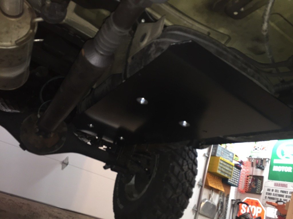

    Well, it's installed. It's not real thick, but I think it'll help the tank getting gouged or punctured. Time will tell...
