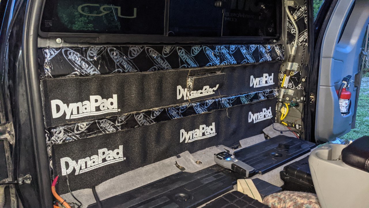

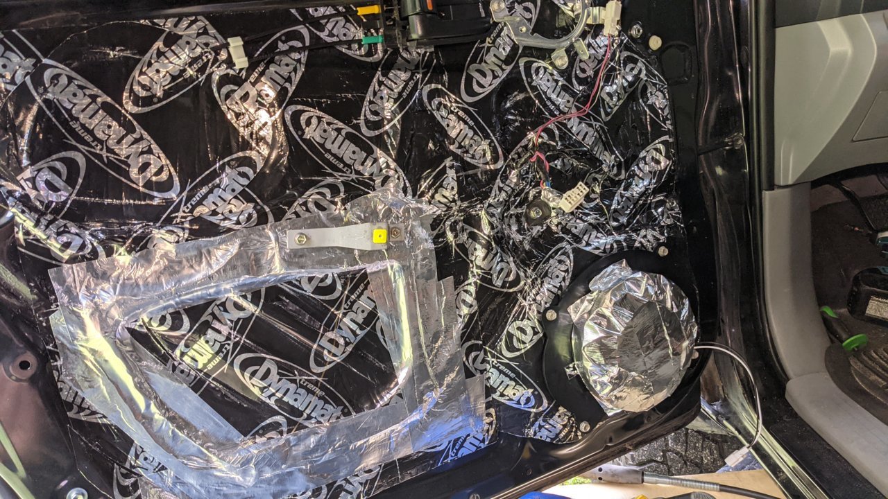

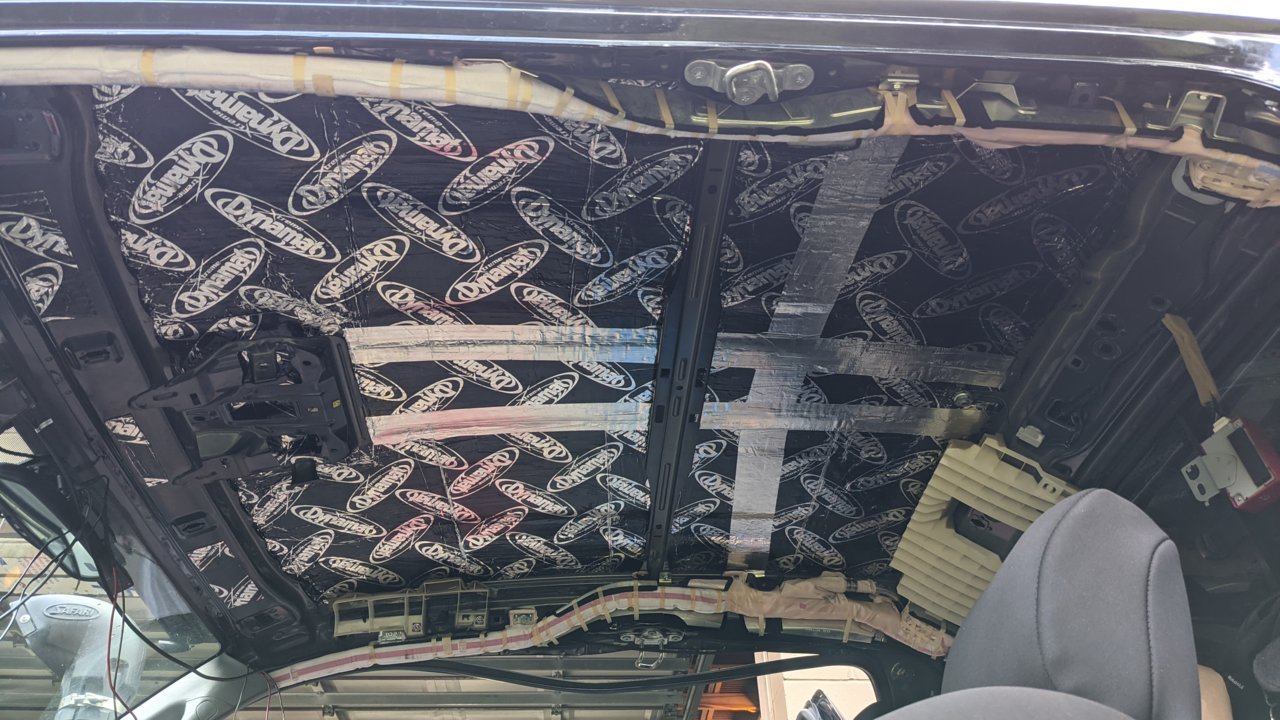

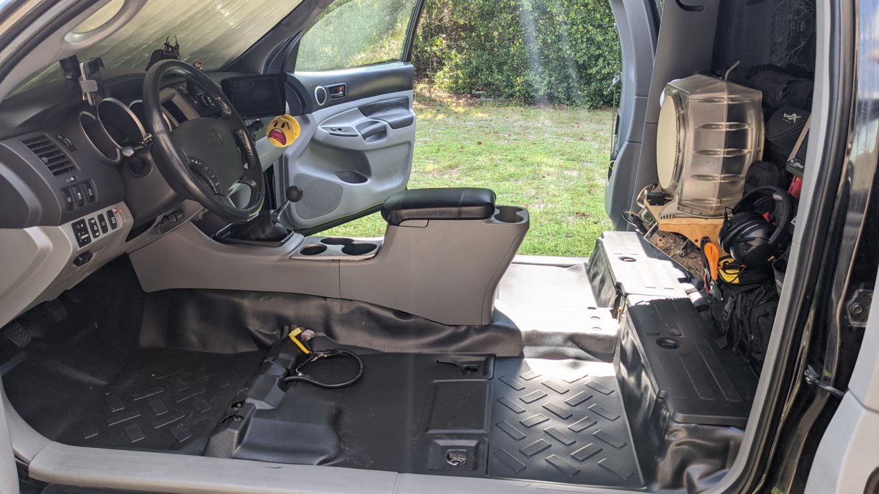

    Locker anytime Fog Lights anytime Full LED light conversion TRD cat back Rear cat delete Exaust Y reroute away from actuator Alloy Clutch master 2000 4Runner "Dog Leg" shift leaver Marlin shift seats and bushing Rear seat delete Rear diff breather extension Chrome grille swap Debadge Rear seat delete Honda blower motor beefy plug and wire mod Anytime 12v and USB with volt gauge in bed Blue Sea fuse box Hella AND 70's Caddy horns Low profile recessed hex drain plug swaps Alluminum battery strap 7pin relocated Backup cam on anytime Various other creature comfort and personal taste mods.
    Highly recommend this but only if you're willing to go all the way (do everything) otherwise the returns are pretty minimal but if you do it all (roof doors floor back wall etc) it's a very appreciable difference and very appreciated mod, especially on long road trips did a 21hr of straight driving and much much less fatigued and irritated vs the same trip before.
    It's not cheap and it's not easy though.
    Pictures ain't even close to showing everything but give you an idea. $1200 or so, and probably 40hrs labor at least, a fair bit of blood too, that foil will cut you ain't you won't even know.
    PXL_20210630_141901351.jpg PXL_20210701_102202070.jpg PXL_20210703_190122573.jpg PXL_20210807_201517599.jpg
    And I only have the TRD cat back and DT's. :rolleyes:

    Wait did it really take 40 hours? I just ordered 50 sqaure feet of it for my single cab, I know for sure it'll take a bit but I didn't think 40 hours lol
