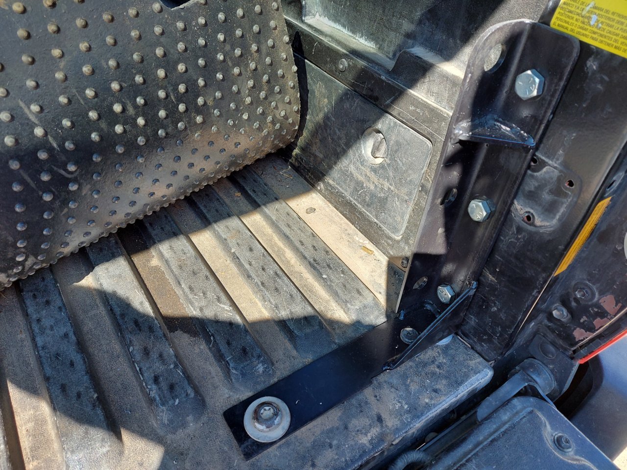

    I've been meaning to make myself a set for a year or two, since I got the canopy, I just haven't got around to it until now.

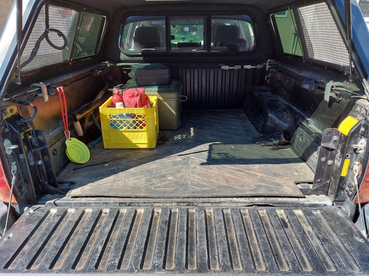

    Made them out of 3/16" plate and 2×2×3/16" angle. I dont think I have to worry about the bed spreading now. I installed them far enough back that I'll be able to reinstall my bed extender brackets a little forward of where they were and still be able to use my bed extender with the bed stiffeners installed. I won't be able to fold it back into the bed, but i can clip it in when I need it, and take it out when i dont.
