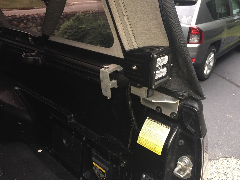

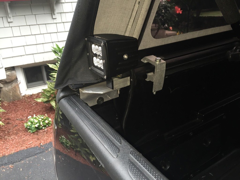

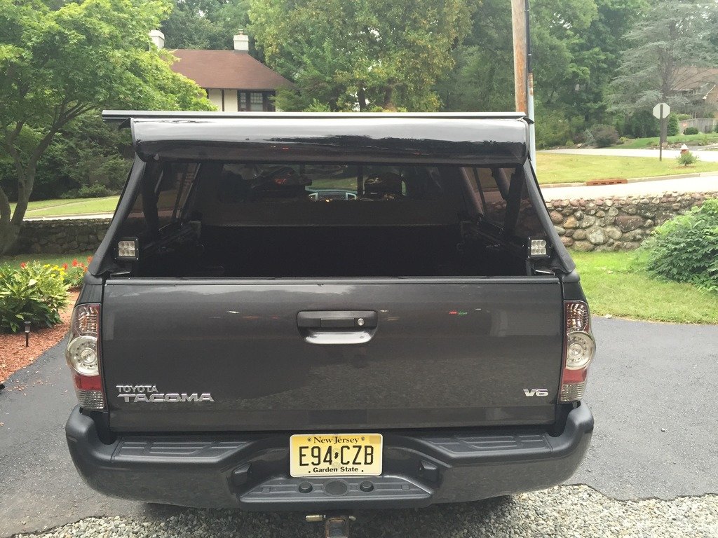

    Thought someone might like the idea. Probably even do it better...
    Anyway, I had my pods mounted on my headache rack. Obviously, THAT won't work with the Bestop...
    So, I made up these brackets real quick today. I might even Plastidip them at some point, but probably not.
    I didn't use the bed rails because I wanted the lights as close to the rear as possible. The existing bolts at the top right there by the tailgate were perfect. It looks a little funny, but I had to set the lights back on the brackets so they wouldn't rub on the top.

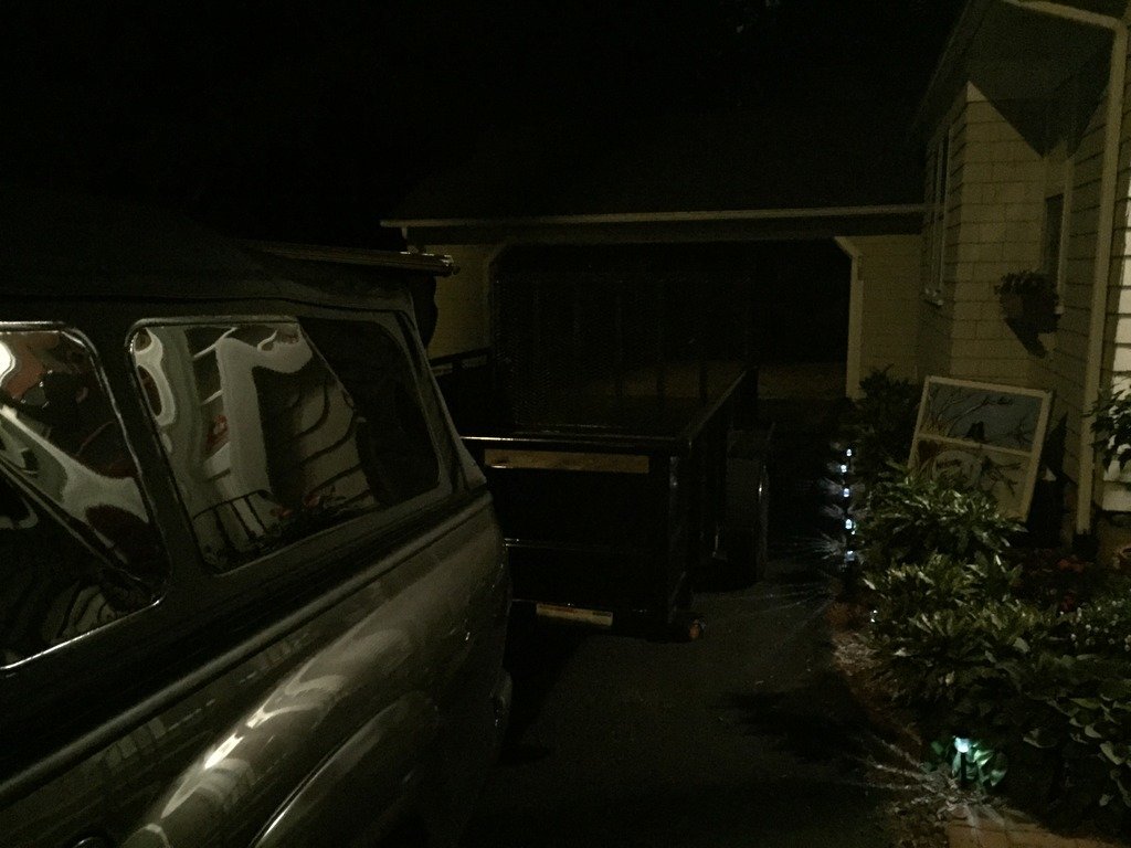

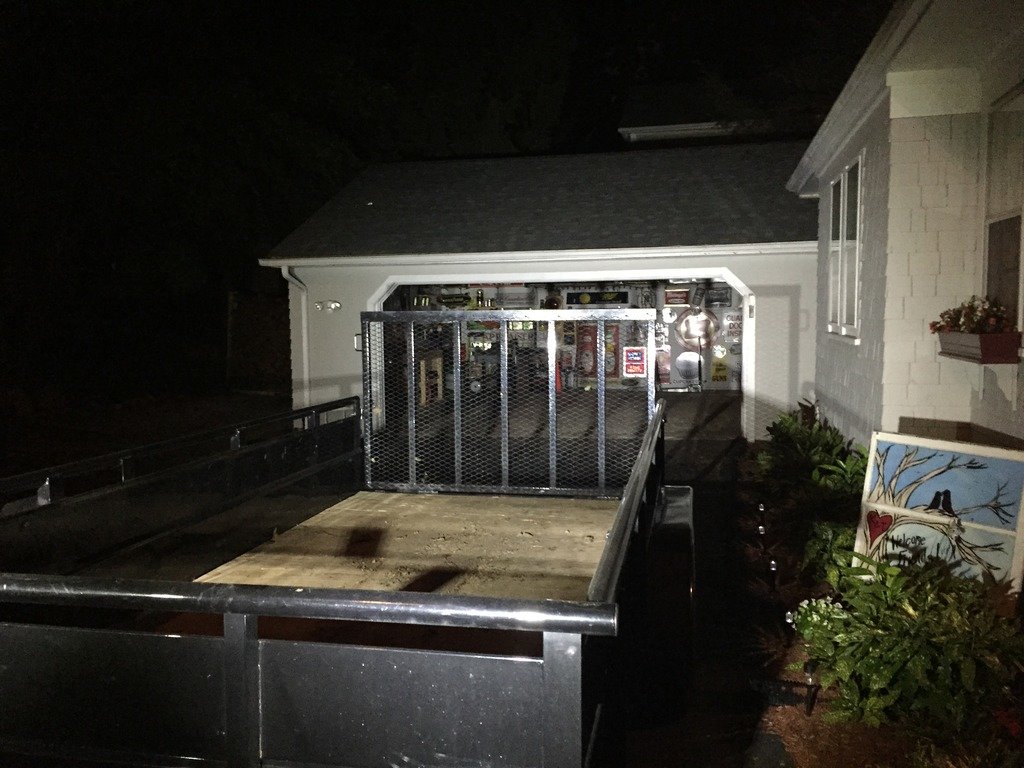

    As you can see, the lights get the job done in this location:
    0AA20C6F-5DC4-4370-9667-A91CD5D72923_zps_4958ab6e3af4b9f3680d41047d5c3f18a0ea5596.jpg
    89570C47-F1DE-4920-85E4-EAF4D024D39C_zps_b55a0830c8ec8a4ed0940a3577d97601b25f66c4.jpg
    As long as your trailer is lower than your tailgate, of course.

    Just ran the wires along the frame. I drilled holes on the composite bed sides to get the wires to the lights. Toggle switch in the cab.

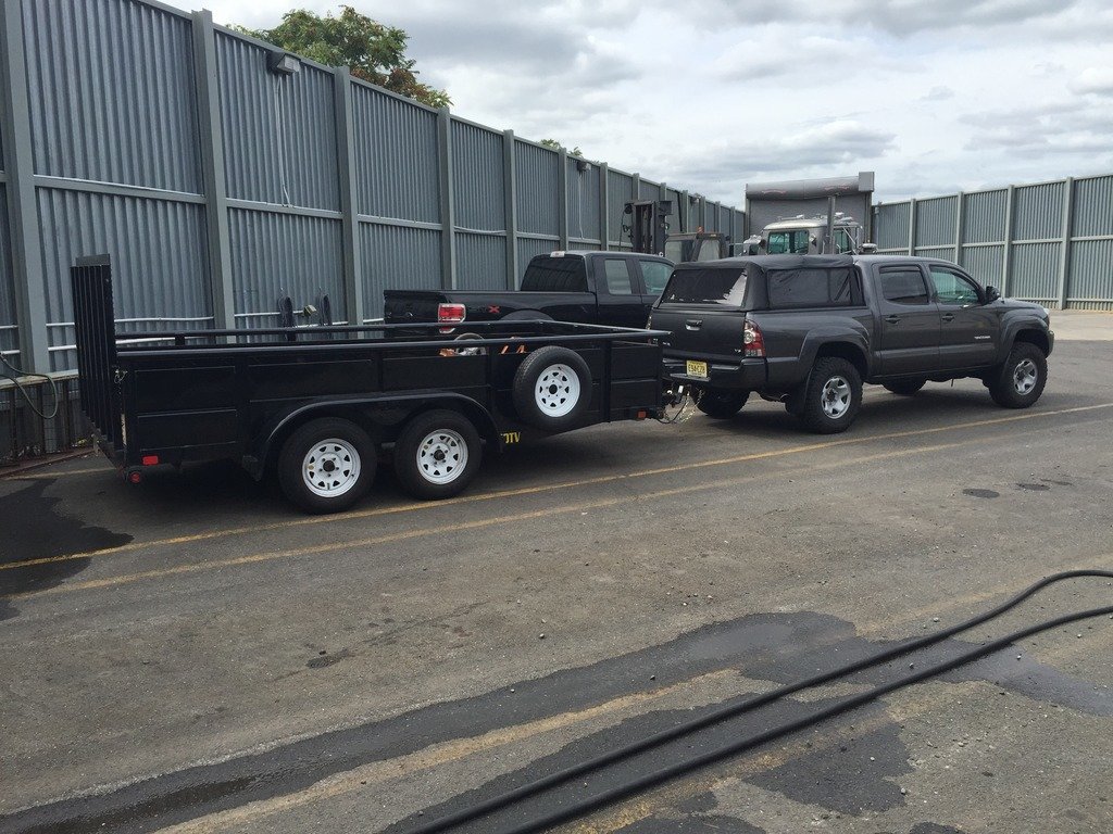

    Nice trailer(and truck).. what do you tow?
    If i had to guess, some sort of lawn equipment or a rzr.

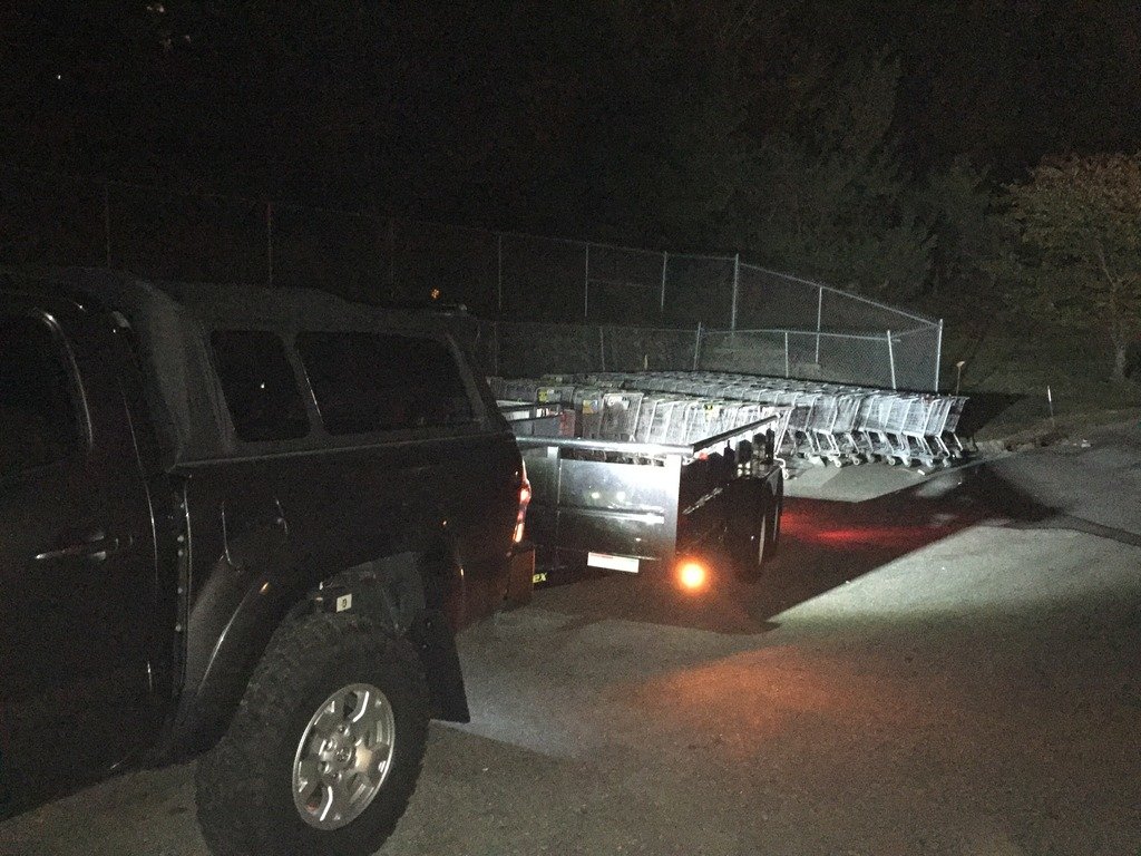

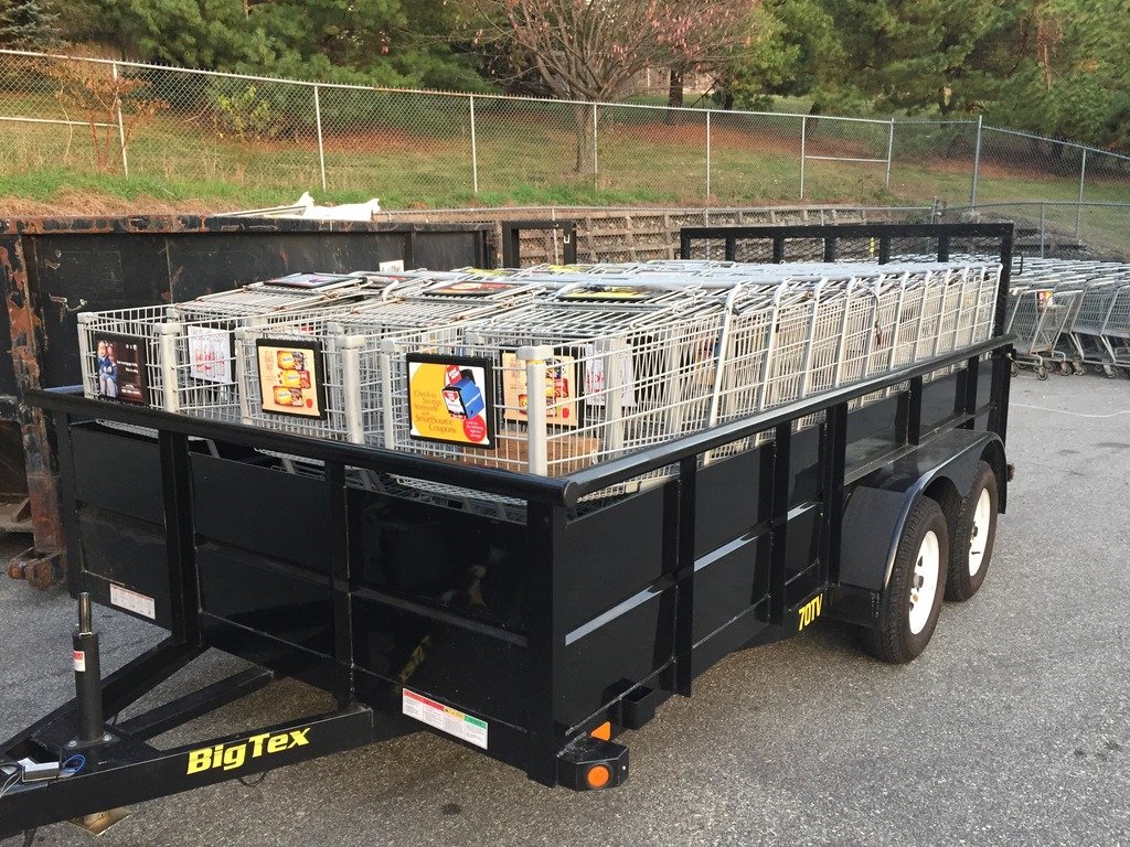

    Cool. Hope you can use this idea. The wires are just run along the frame from the front to the back. Then, I drilled a hole in the composite bed below the light pods to get the wires in. Then, they're operated by a toggle switch in the cab.
    I haul lots of different things. I needed the big trailer for firewood though.
    Today, I was hauling shopping carts! (The truck also grew a little this past weekend :D)
    EA729C9A-40FC-4EBD-9EAB-F16AFE3359DA_zps_93007cce44ad4b47c4387e9b8323a2722b78bd0a.jpg
    36E1022A-09CA-4CB5-919D-A79BA8B45F86_zps_10a5e28f8dd9066b39d7d593034b3b1c69c239e9.jpg
    On my last couple of trips, I even needed my light pods:
    B4E0DDEC-A410-49FA-82B7-B894BA3EC511_zps_cc31d6c703ade05aa1a94c33a330613371058774.jpg
