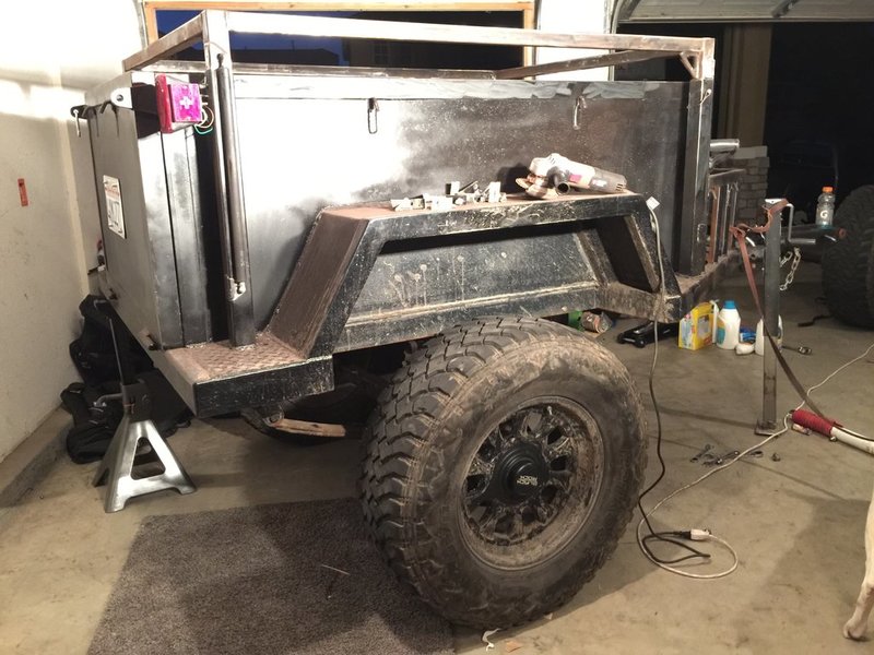

    Just registered the trailer in my name. Get the wheels today and shocks tomorrow. this week is like christmas. I started grinding rust off last night... Its going to be a fun weekend for grinding rust on the trailer

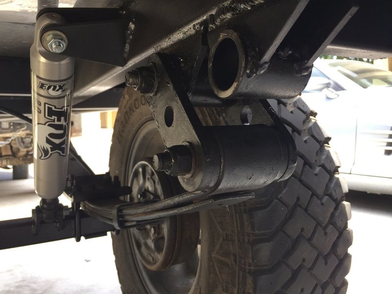

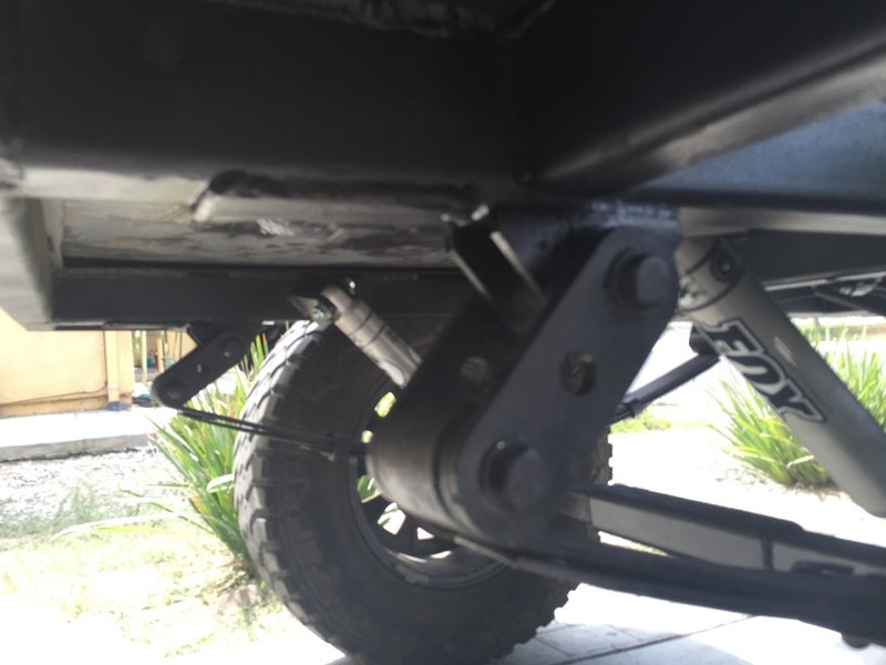

    So after lots of sanding and grinding, and painting, and puting on new wheels and tires, and new shocks I thought the trailer was done.

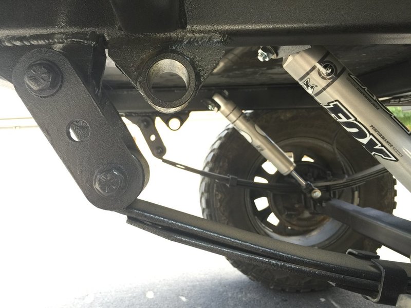

    Then @jberry813 points out my shackles for my leafs springs are negative. so I swap them to the other spot. IMG_5836.jpg IMG_5842.jpg

    But then when the leafs flex the shackle hits the old mounting point. so I cut that off. But now my shocks are to long. Hopefully @JLee can help me move the shock mounts over on the axle this weekend.

    Does it ride better now?

    Dont know the shocks bottomed out pulling out of the driveway so I left it parked. I flexed it out with the highlift and it actually flexed which it didnt do before.

    that sad moment..... when your trailer has better shocks than my truck.
    Realistically id like those shackle mounts on the frame moved back a bit to get the shackle closer to straight up and down at ride height, that will give you most flex. Still have them slightly at a backward angle as they are now but say half as much.
    Either way im just nitpicking as like stated.... your trailer has better shocks than mosts trucks.

    Thanks man. Yeah. Im wondering how far back the shackle will go when the truck is loaded. The Leafs are pretty soft. Ill get the shocks moved and then take it on a couple trips loaded to test it out. I went alittle over board with the shocks on the trailer but why not. The whole trailer is overboard.
