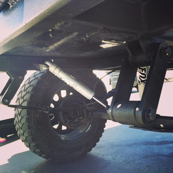

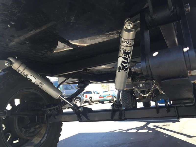

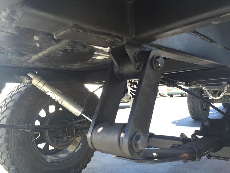

    With some help from @JLee and @jberry813 I got the trailer suspension working. New longer shackles got the shackle angle corrected and new shock tabs allow the trailer to use the full travel of the shocks. Couldnt be happier with the result.
