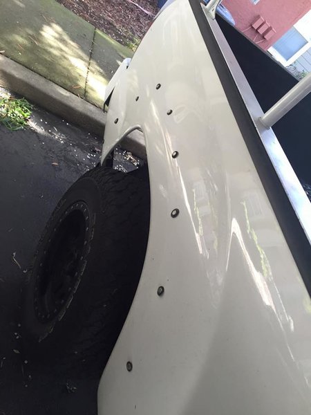

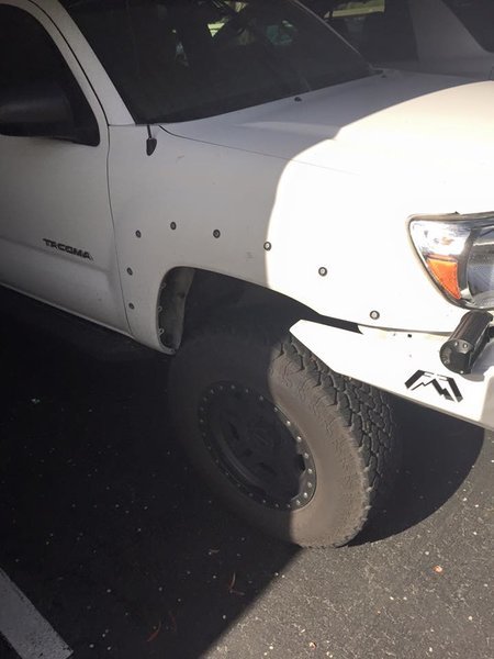

    @Mademan925
    What did you use in the holes on the front fenders?

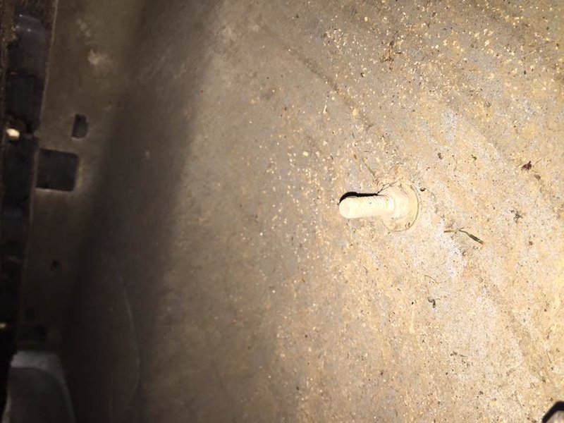

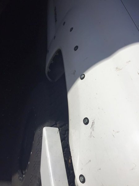

    I don't know what he did but this is what I did.
    I took off the fender flares and the wheel well liners
    And In the square holes I put stainless steal bolts
    I don't remember the size but I know it was a 13mm wrench
    I used rubber washers so I wouldn't scratch the paint
    I did from out side in
    Bolt, rubber washer, through the truck, normal washer, nut
    All total it was about 30-40 bucks (I liked that better then new bushwhackers)

    I used neoprene washers with black bolts.

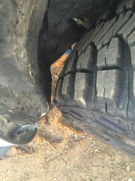

    im rubbing on the corner of the pinch weld area. going to try my best with a BFH this weekend. Otherwise very pleased with the 315s, glad you did them and "pushed" me into them.
